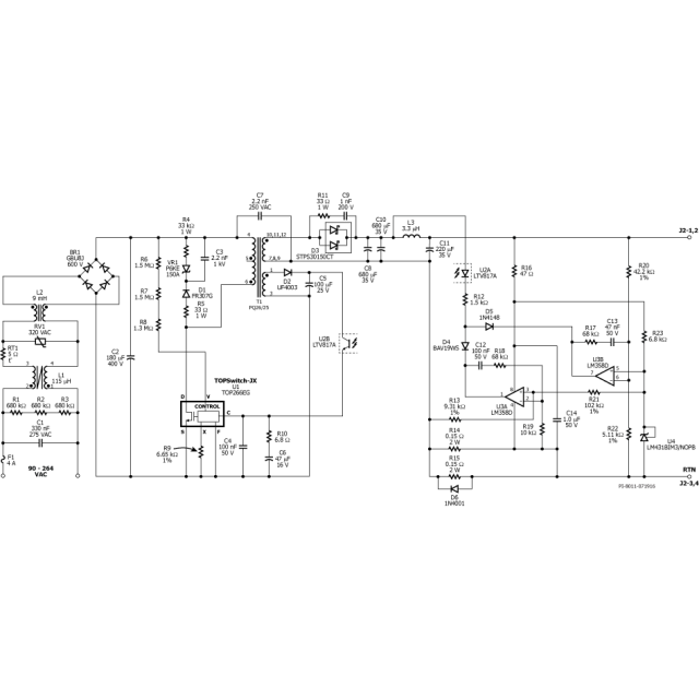

This engineering report describes a 23 V (nominal), 70 W flyback reference design suitable for operation from 90 VAC to 264 VAC supplies. The power output is designed with constant voltage/constant current characteristics for battery charger applications. The design is based on the TOP266EG operating with a universal input and no PFC input stage. It operates at maximum power at 90 VAC, room temperature, and requires no fan.
