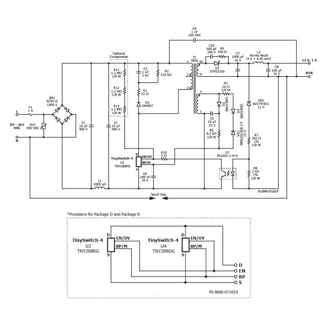

RDR-839 - 12 W power supply for devices using TinySwitch-4
RDR-839 - 12 W Power Supply for Appliances Using TinySwitch-4
This engineering report describes an isolated flyback converter designed to provide a nominal output voltage of 12 V at a 1 A load over a wide input voltage range of 85 VAC to 265 VAC. This adapter uses the TNY288P from the TinySwitch-4 series of ICs and is available in D and K packages on top. The document contains complete power supply specifications, bill of materials, transformer construction, circuit schematic and printed circuit board layout, as well as performance data and electrical waveforms.
