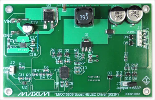

Figure 1. MAX16809-based driver circuit board
Detailed image (PDF, 468kB)
