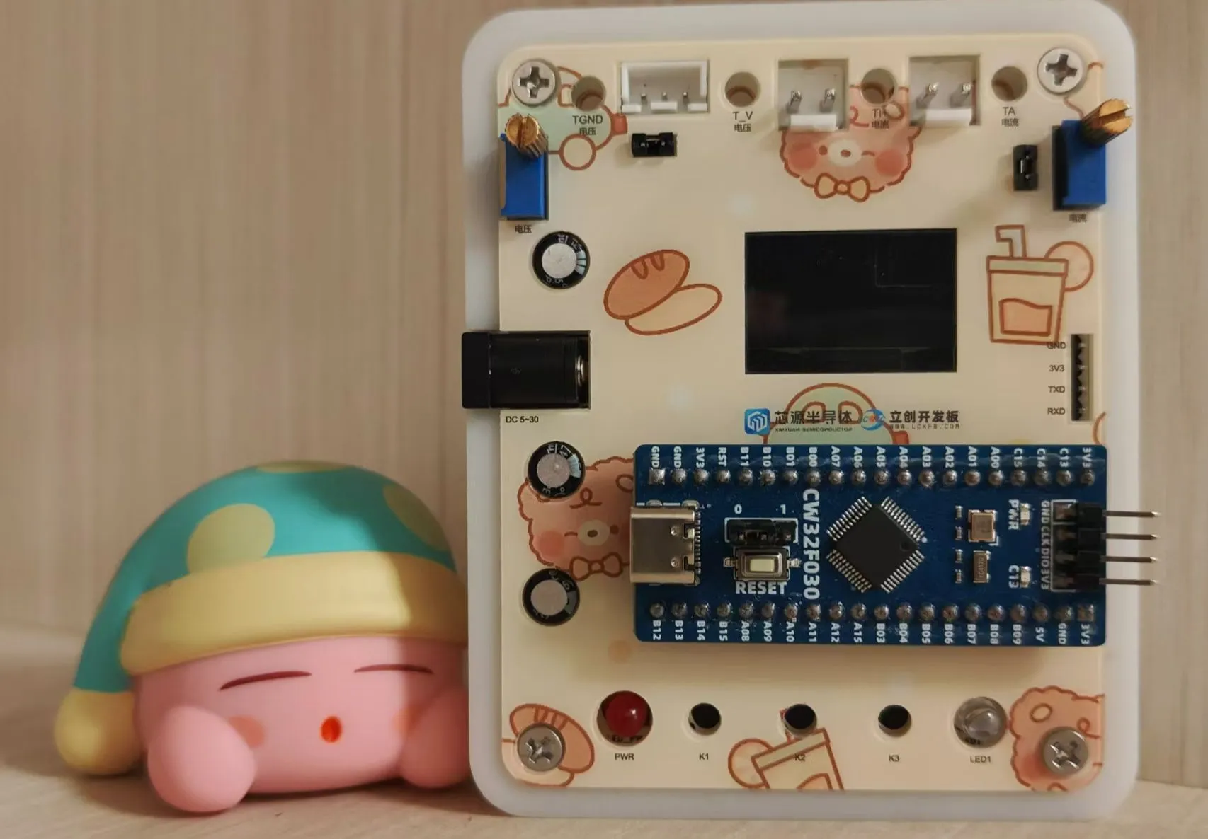

Diwenxing CW32 Digital Voltage and Current Meter Expansion Board
I. Design Background
An ADC (Analog-to-Digital Converter) is an indispensable key component in electronic systems. It converts continuous analog signals into digital signals, enabling digital processing and analysis. ADCs play a crucial role in signal conversion, measurement and data acquisition, control system input, and communication and signal processing. Their widespread application promotes the intelligent and precise control of electronic equipment across various industries, and is one of the key factors driving modern technological progress. A
digital voltmeter and ammeter combines ADC technology with circuit measurement principles, accurately converting analog voltage and current signals into digital displays for easy reading and analysis by electronic engineers. This device not only improves the accuracy and efficiency of circuit measurements but also helps engineers better understand circuit behavior, serving as a powerful tool for electronic design and troubleshooting, and playing a vital supporting role in the work of electronic engineers. In product applications, digital voltmeters ensure the accuracy and safety of circuit design, while also providing strong support for product quality control and subsequent maintenance.
Learning to design and build a digital voltmeter and ammeter is highly beneficial for improving one's professional skills. This digital voltmeter and ammeter project covers multiple aspects, including the design and implementation of microcontroller circuits, the design of signal acquisition and processing circuits, the development and optimization of the user interface, and the design of the product appearance. It integrates knowledge from multiple fields such as electronic technology, microcontroller programming, circuit design, and industrial design.
The project has the following highlights:
It adopts a core board plus expansion board design concept, making learning simpler and exploration more in-depth.
The core board uses the domestic Wuhan Xinyuan Semiconductor CW32 as the main controller, while also being compatible with other similar development boards;
the project has a high degree of integration and strong practicality, and can be used as a desktop everyday instrument after completion.

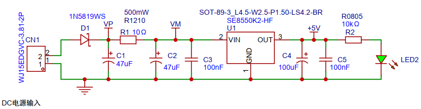

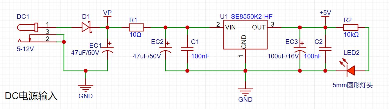

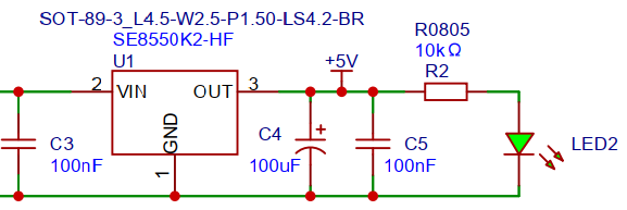

1. Power Supply Circuit
LDO (Low Dropout Linear Regulator) Selection
This project uses an LDO as the power supply. Considering that most voltmeter products are used in industrial scenarios with 24V or 36V power supplies, this project selected the SE8550K2, which has a maximum input voltage of up to 40V, as the power supply. The main reason for not using a DC-DC step-down circuit to handle the large voltage drop is to avoid introducing DC-DC ripple interference during the design process; a secondary reason is to reduce project costs.

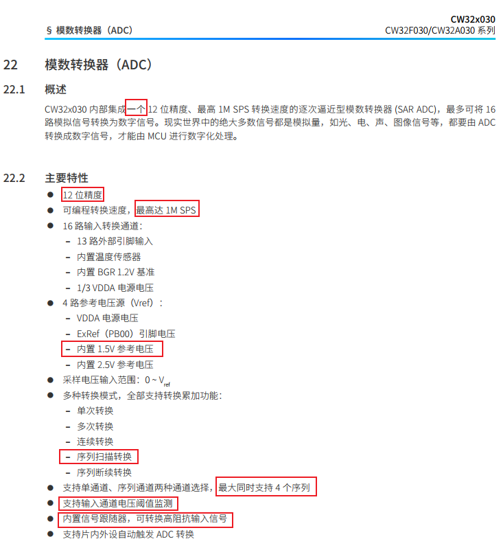

It also boasts a superior ADC: a 12-bit high-speed ADC achieving ±1.0LSB INL 11.3ENOB, multiple Vref reference voltages (STM32 only supports VDD=Vref),
and stable and reliable eFLASH technology.

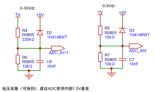

3. Voltage Sampling Circuit:
The voltage divider resistors in this project are designed to be 220K+10K, resulting in a voltage division ratio of 22:1 (ADC_IN11). The maximum measured voltage is 30V, and the reference voltage is 1.5V. This reference voltage can be configured through the program. An additional voltage sampling circuit is added to this project. When initially using the ADC_IN11 channel to measure voltages below 30V, if the measured voltage is within 0~3V, the ADC_IN9 channel is used for measurement. At this point, due to the reduced voltage division ratio, the measurement accuracy is greatly improved.

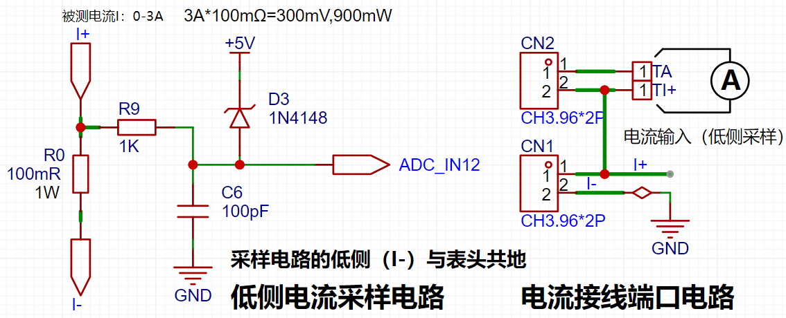

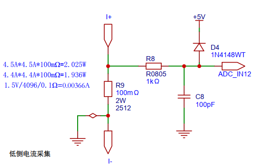

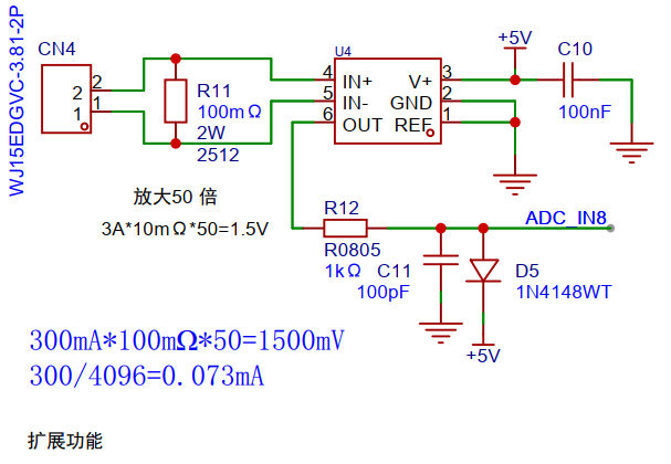

4. Current Sampling Circuit
: The sampling current designed for this project is 3A. The selected sampling resistor (R0) is 100mΩ. Based on the above data, a 100mΩ current sensing resistor was chosen. According to the formula, 3A*100mΩ=300mV, 900mW.

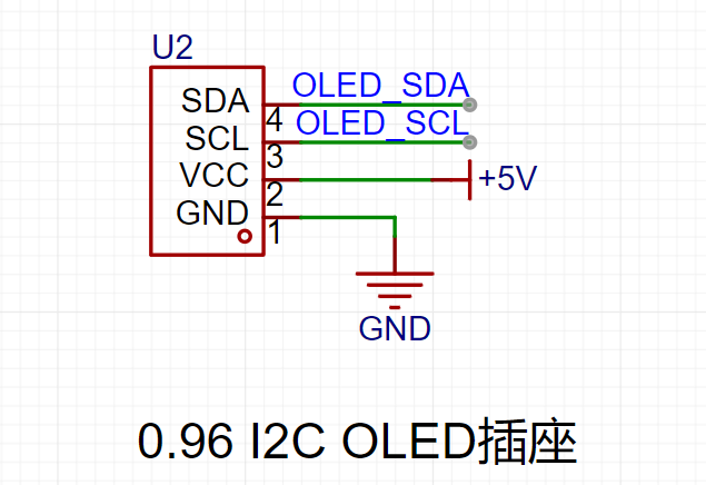

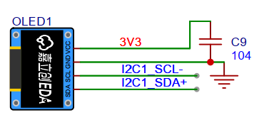

5. OLED Display:
This project uses an OLED display screen as the display unit.
This project uses a 0.96-inch OLED display as the display device. Compared to a digital tube, the OLED can display more data content, and the displayed data content and display method can be changed at will according to the actual use environment. Although the display is easily damaged by external force, this project designed a 3D shell and panel to protect the display. The OLED software is ported from Zhongjingyuan's code.

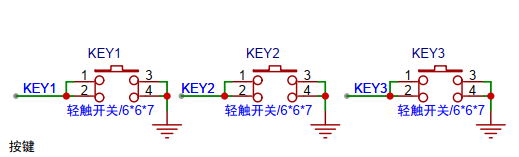

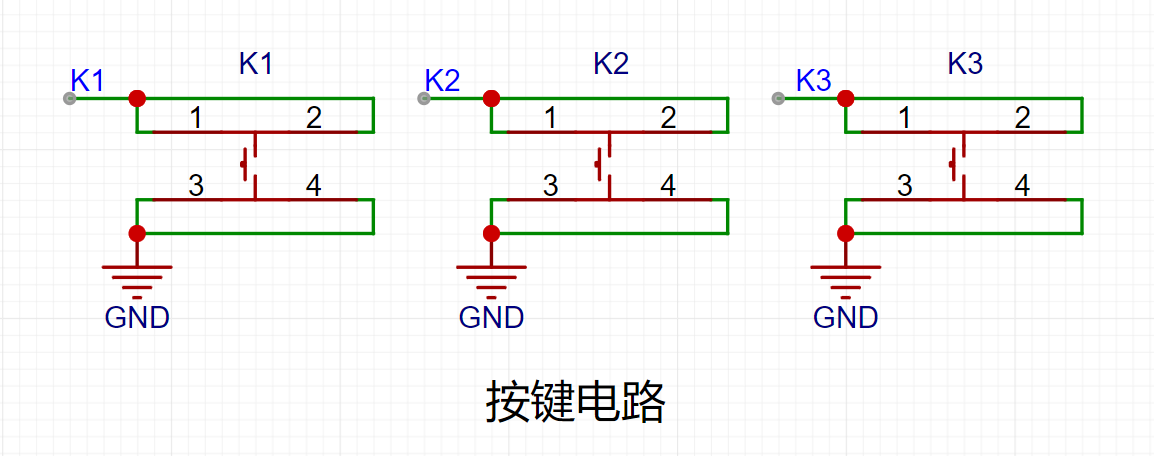

6. Other circuit
button software design is ported from Anfulai Electronics' scanning independent button, which has a software filtering mechanism and a button FIFO. It can detect the following events:
button press,
button release
, long press
, automatic continuous firing.
Project button function description:
K1 is used for mode switching,
K2 is used for data storage of calibration mode,
and K3 is used to control LED indicator.

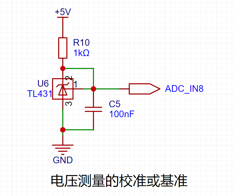

This project added an extra TL431 circuit to provide a 2.5V reference voltage, which can be used to provide an external voltage reference for the chip to calibrate the AD.

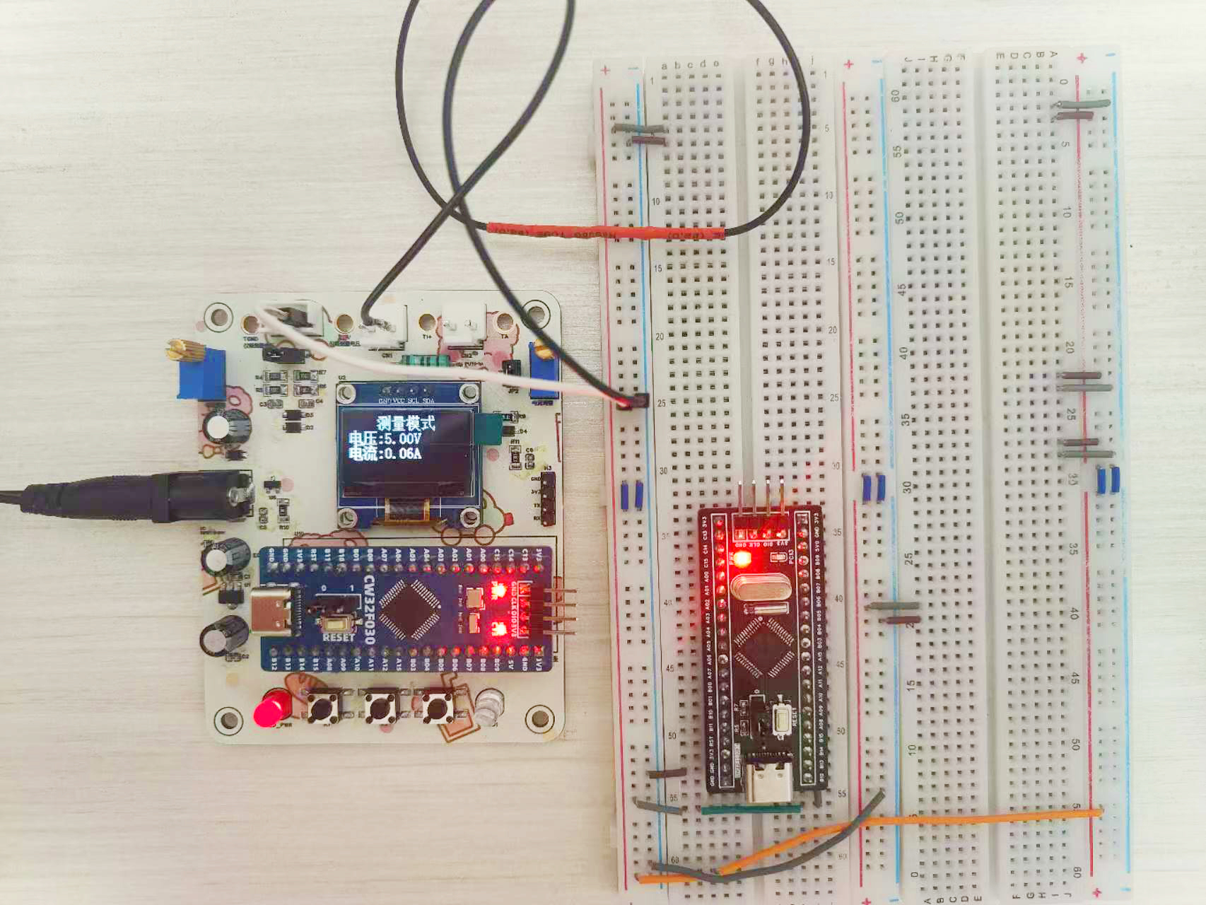

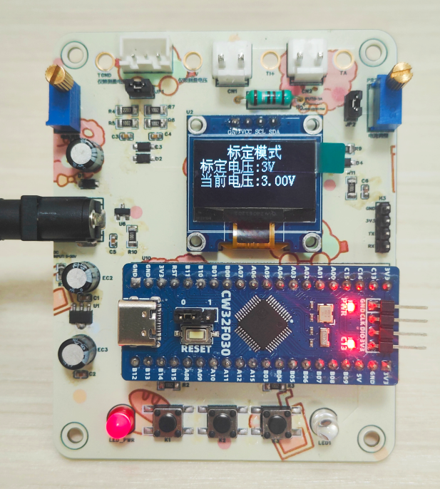

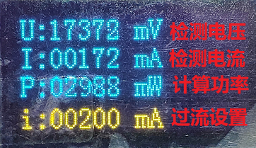

Voltmeter and Ammeter Training Camp
LCSC GeoStar CW32 digital voltmeter and ammeter expansion board. The display uses a 12864 OLED with an IIC interface. The current sampling expansion adds an amplifier, allowing for the acquisition of smaller currents.
Participating in the CW32 Voltage and Current Meter Training Camp to
become familiar with LCSC EDA and Chipsource Semiconductor's CW32 products.
In electronic systems, voltage and current are two fundamental quantities of analog signals. To process these analog signals in digital systems, we need to use an ADC to convert them into digital signals.
ADC, short for Analog-to-Digital Converter, is used to convert analog signals (usually continuously changing voltage or current) into digital signals (usually binary code).

4. Current Sampling Circuit:
INA199A1DCKR was selected here to amplify the current sampling by 50 times before measurement.

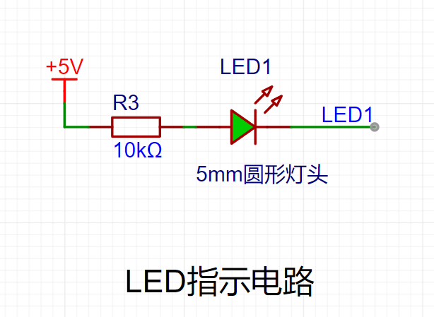

6. LED Indicators:
This section includes a power indicator and an IO operation indicator.

: Buttons are used for overcurrent settings: KEY1 sets overcurrent to -, KEY2 sets overcurrent to +, and KEY3 restores the default 200mA overcurrent setting. KEY1 and KEY2 have long-press and short-press functions.

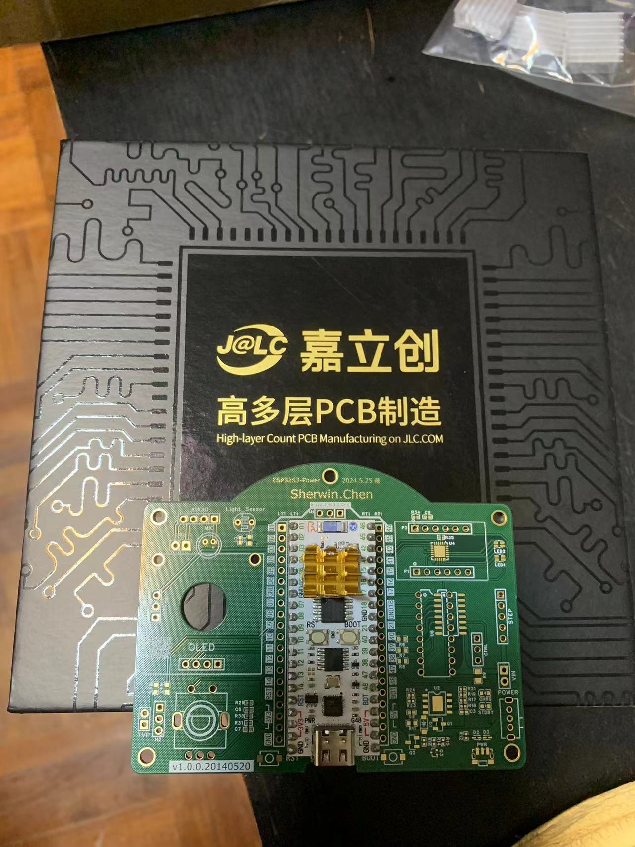

LCSC ESP32S3R8N8 Expansion Board V1.0
LCSC ESP32S3R8N8 Expansion Board V1.0 (Replica Version)
This is a reference to an open-source solution: https://oshwhub.com/nan_sheng/esp32s3-tuo-zhan-ban-v1-0.
It describes
an expansion board specifically designed for the LCSC ESP32S3 development board, including USB and lithium battery switching, battery charging, a 0.96-inch OLED, stepper motor driver, LED tri-color lights, digital tube, temperature and humidity sensor, photosensitive sensor, rotary encoder, EEPROM, infrared, and other functional expansions. The video demonstrates software power-on/off, OLED display, and photoresistor ADC voltage reading.
New features:
1. All pins are brought out for easy self-outlining.
2. A 6-layer board is used, with the following layer layout:
signal layer
GND,
5V
GND,
3.3V
GND.
3. Text uses reverse annotation.
4. Originally for personal use and not intended for public release (a copy of someone else's), it is shared here because some group members requested it. Criticism and corrections are welcome.
5. Copyright belongs to the original author. Please go directly to: https://oshwhub.com/nan_sheng/esp32s3-tuo-zhan-ban-v1-0
6. The image below shows a 6-layer precast component, not yet welded; more will be added later.

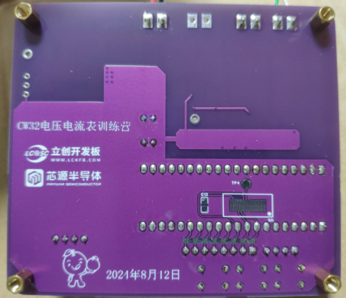

Diwenxing CW32 Voltmeter and Ammeter Training Camp Replica
CW32 voltage and current, replica of the Earth Star development board design
An ADC (Analog-to-Digital Converter) is an indispensable key component in electronic systems. It converts continuous analog signals into digital signals, enabling digital processing and analysis. ADCs play a crucial role in signal conversion, measurement and data acquisition, control system input, and communication and signal processing. Their widespread application promotes the intelligent and precise control of electronic equipment across various industries, and is one of the key factors driving modern technological progress. Digital voltmeters and ammeters combine ADC technology with circuit measurement principles, accurately converting analog voltage and current signals into digital displays for easy reading and analysis by electronic engineers. This device not only improves the accuracy and efficiency of circuit measurements but also helps engineers better understand circuit behavior, serving as a powerful assistant in electronic design and troubleshooting, and playing a vital supporting role in the work of electronic engineers. In product applications, digital voltmeters ensure the accuracy and safety of circuit design, while also providing strong support for product quality control and subsequent maintenance. Learning to design and build a digital voltmeter and ammeter
using a benchtop digital multimeter (Agilent 34401A)
is highly beneficial for improving one's professional skills. This digital voltmeter and ammeter project covers multiple aspects, including microcontroller circuit design and implementation, signal acquisition and processing circuit design, user interface development and optimization, and product appearance design. It integrates knowledge from multiple fields such as electronics, microcontroller programming, circuit design, and industrial design. Considering the learning pace and knowledge absorption capacity of beginners, we have specially launched this introductory-level digital voltmeter and ammeter project, which is very suitable for beginners in electronics and those who want to learn more about microcontroller applications. This project has the following highlights:
it adopts a core board plus expansion board design concept and uses plug-in components, making learning simpler and exploration more in-depth;
the core board uses the domestic Wuhan Xinyuan Semiconductor CW32 as the main controller, while also being compatible with other similar development boards; however, the CW32 has advantages.
The project is highly comprehensive and practical, and after completion, it can be used as a desktop instrument;
the project has abundant learning materials, including circuit design tutorials, PCB design, code programming learning, and training for engineers' debugging skills.

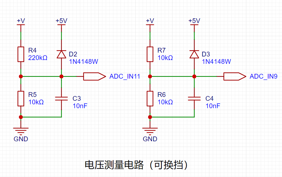

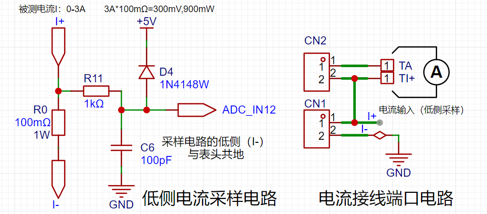

The voltage divider resistors in this project are designed to be 220K+10K, therefore the voltage division ratio is 22:1 (ADC_IN11).
The voltage divider resistor selection
is designed to measure the maximum voltage. For safety reasons, this project uses 30V (the actual maximum display value can be 99.9V or 100V).
The ADC reference voltage is 1.5V in this project, and this reference voltage can be configured through the program.
To reduce the power consumption of the sampling circuit, the low-side resistor (R7) is usually chosen as 10K based on experience.
Then, the high-side resistance of the voltage divider resistor can be calculated using the above parameters.
The required voltage division ratio is calculated, i.e., the ADC reference voltage. The input voltage is designed; using known parameters, 1.5V/30V = 0.05 can be calculated.
The high-side resistance is calculated as the low-side resistance/voltage division ratio; using known parameters, 10K/0.05 = 200K can be calculated.
A standard resistor is selected: a resistor slightly higher than the calculated value of 200K is chosen. We usually choose E24 series resistors; therefore, in this project, 220K, which is greater than 200K and closest to the calculated value, is selected.
If, in actual use, the voltage to be measured is lower than 2/3 of the module's design voltage (66V), the voltage divider resistor can be replaced and the program modified to improve measurement accuracy. The following example illustrates this:
Assuming the measured voltage is no higher than 24V and other parameters remain unchanged,
calculations show 1.5V/24V = 0.0625, 10K/0.0625 = 160K. 160K is a standard E24 resistor and can be directly selected, or a higher value 180K can be chosen with some redundancy.
If, in actual use, the voltage to be measured is higher than the module's 99V design voltage, a different resistor can be selected. To expand the voltage measurement range, you can choose to replace the voltage divider resistor or modify the reference voltage. The following example illustrates this:
Assuming the measured voltage is 160V, we can choose to increase the voltage reference to expand the range.
Given that the voltage division ratio of the selected resistor is 0.0145, we can calculate 160V * 0.0145 = 2.32V using the formula. Therefore, we can choose a 2.5V voltage reference to expand the range (increasing the range will reduce accuracy).
Considering the potential fluctuations in the measured power supply, a 10nF filter capacitor is connected in parallel with the low-side voltage divider resistor in the circuit design to improve measurement stability.
(Range switching )
In this project, an additional voltage sampling circuit was added. Therefore, we can discuss the significance of range switching for improving measurement accuracy. Multimeters often have multiple range settings to achieve more accurate measurements. By adjusting different ranges, the optimal measurement accuracy of the measured point within the corresponding range can be obtained.
This project uses a low-side current sampling circuit for current detection. When learning the common ground between the low-side of the sampling circuit and the development board's meter interface, please do not solder R0!!!
The design analysis
for this project involves a sampling current of 3A, and the selected sampling resistor (R0) is 100mΩ. The selection of the sampling resistor mainly needs to consider the following aspects:
the maximum value of the pre-designed measurement current;
the voltage difference caused by the 3A current sensing resistor in this project; and
the power dissipation of the current sensing resistor, which should generally not exceed 0.5V. A suitable package should be selected based on this parameter. Considering the power dissipation (temperature) issue under high current, a 1W metal wire-wound resistor package was chosen
. The voltage amplification factor across the current sensing resistor is also important. Since no operational amplifier is used to build the amplification circuit in this project, the factor is 1.
The current sensing resistor value can then be calculated using the above parameters
. Since no amplifier circuit is used, a larger sampling resistor is needed to obtain a higher measured voltage for measurement.
Considering that a larger resistor would result in a larger voltage drop and higher power consumption, an unlimited selection of a larger resistor is not feasible.
This project uses a 1W package resistor, corresponding to a power consumption of 1W.
Based on the above data, a 100mΩ current sensing resistor was selected. According to the formula, 3A * 100mΩ = 300mV, 900mW can be calculated.
To cope with different operating environments, especially high-current scenarios, the R0 resistor can be replaced with constantan wire or a shunt. The replacement can be selected according to the actual application scenario. For safety and educational purposes, this project will not discuss measurements exceeding 3A in detail, but the principle is the same.

6. LED Indicators
This project additionally designed a power indicator and an I/O operation indicator.
LD_PWR is the power operation indicator
. Since the chip's I/O often has a greater current sinking capability than a current pulling capability, LED1 is designed to be active low (on).
To reduce the current consumption of the LED, some LED brightness is sacrificed, the number of component parameters is reduced, and the current-limiting resistor for the LED is selected as 10K.
7. Button Circuit Design
There are various design methods for the button control circuit. Thanks to the fact that the CW32's I/O port can be configured with pull-up and pull-down resistors internally, the button control circuit on the outside of the chip does not need to be configured. One end of the button is connected to the MCU's I/O, and the other end is grounded. When the button is pressed, the I/O is pulled low.
8. TL431 Circuit Design for Voltage Measurement and Calibration:
This project adds an extra TL431 circuit to provide a 2.5V reference voltage. This can be used to provide an external voltage reference for the chip to calibrate the AD converter. From a product design perspective, due to the inherent ADC performance advantages of the CW32, this circuit is not necessary. This circuit is designed on the development board to learn the relevant application principles.
The TL431 is a relatively "old" device, a classic, and widely used one, still found in many electronic products.
Many beginners may be encountering this device for the first time, so we will briefly explain its principles to help everyone better apply the TL431.
TI defines it as a "Precision Programmable Reference." On the first page of the references, we can focus on several key characteristics.
Precision: Precision indicates that its output voltage is very accurate. I used a ±0.5% accuracy TL431, which measured 2.495V on the board at room temperature. Compared to common Zener diodes, the accuracy is vastly different. In the application circuit diagram, the TL431 is represented by a Zener diode symbol.
Adjustable Output Voltage: The adjustable output voltage is between Vref and 36V. In our project, we use the output Vref voltage, which is approximately 2.5V. Therefore, we use 2.5V in the description, which is approximately equal to Vref.
Sinking Current Capability: This refers to how much current the output voltage pin can provide. This is greatly influenced by the resistance value (R13) in the application circuit. It should not be less than 1mA. If there is no need for sinking current, do not design the current to be too high, as this will cause unnecessary power consumption.
