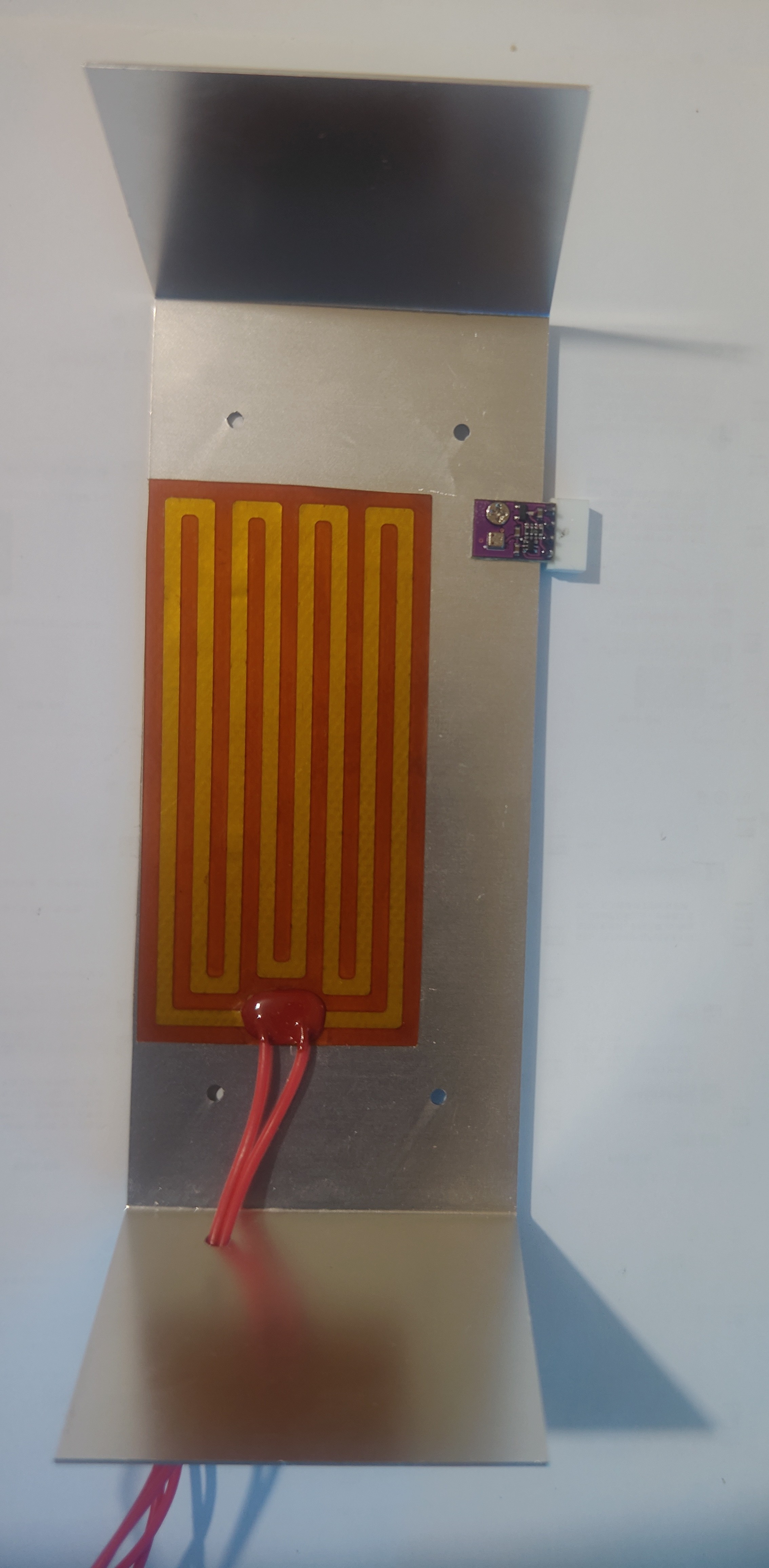

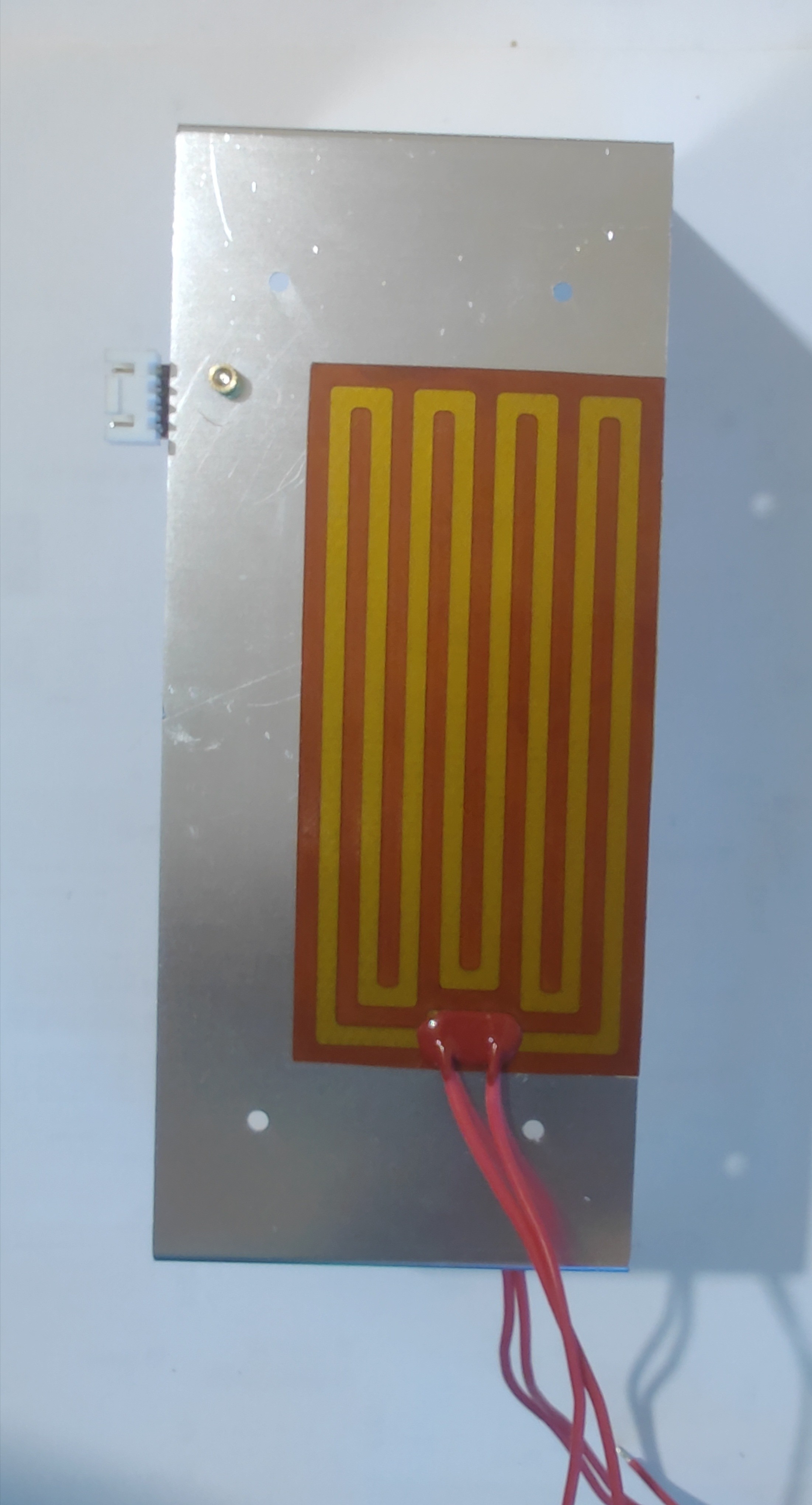

3. Uses a PI polyimide heating film to heat the aluminum plate, providing a large contact area for even heating.

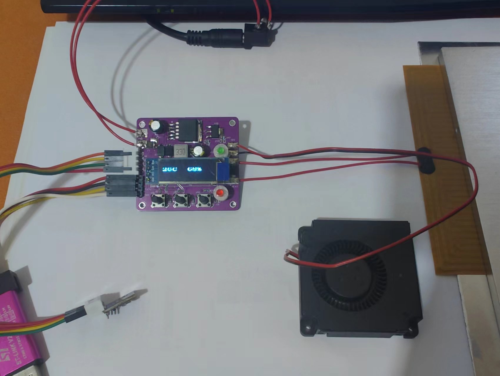

2024.8.15
1. Soldering completed, program burning completed, function verification completed.
2. Replace D2 with SS54 during soldering. A heating film with a maximum current of 5A can be used (AO3400-HXY maximum current 5.8A).
Solder the two heating films in parallel to the motherboard.
3. The original heating time determination logic: defined a variable that incremented every hour and was then compared with the target time. The working time setting interface always displayed the set working time and did not decrease with the working time.
This logic made it impossible to know how many hours of heating had been completed and how many hours remained. The time determination logic was modified to: decrement the target temperature every hour; this allows the working time setting interface to display the remaining working time.
4. Power-on debugging

Aluminum sheet metal parts
: Outsourcing the custom-made aluminum sheet according to drawings is expensive. You can buy a finished product of similar size and cut it yourself.
For example, I bought a 300x200x1mm 1060 model on Taobao; one piece only cost two or three yuan. Once home, you can cut, drill, and bend it according to the drawings.

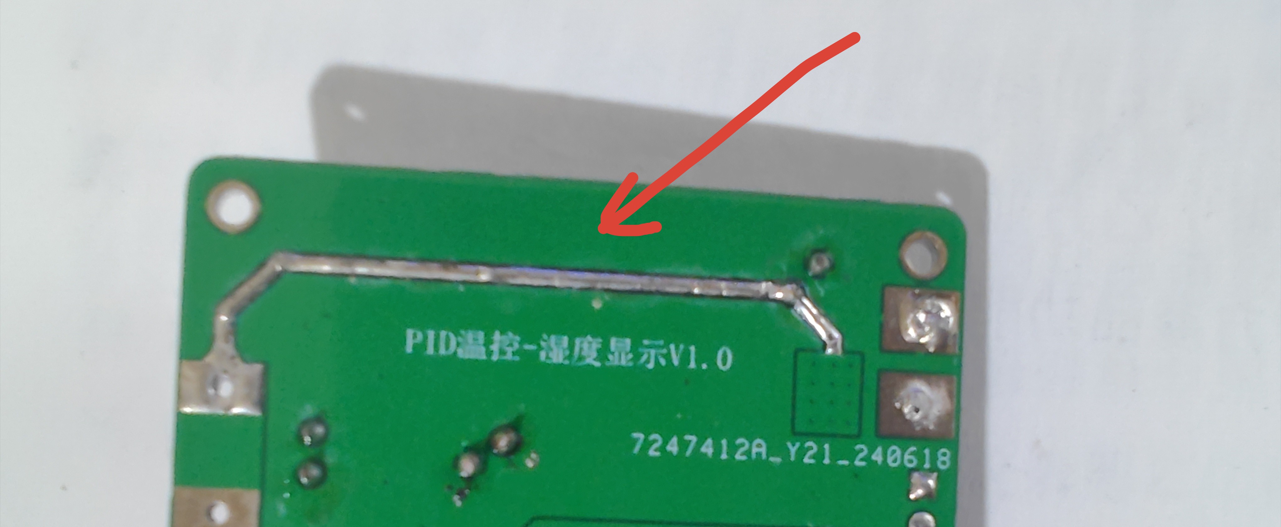

Welding precautions:
1. Pay attention to the direction of SS54 and SS34. Do not weld them incorrectly, otherwise, components may burn out when powered on. For example, if D1 and D2 are reversed, it will burn out the AO3300-HXY.
2. The exposed solder areas on the back of the board need to be soldered to increase current carrying capacity; otherwise, the board may burn out.

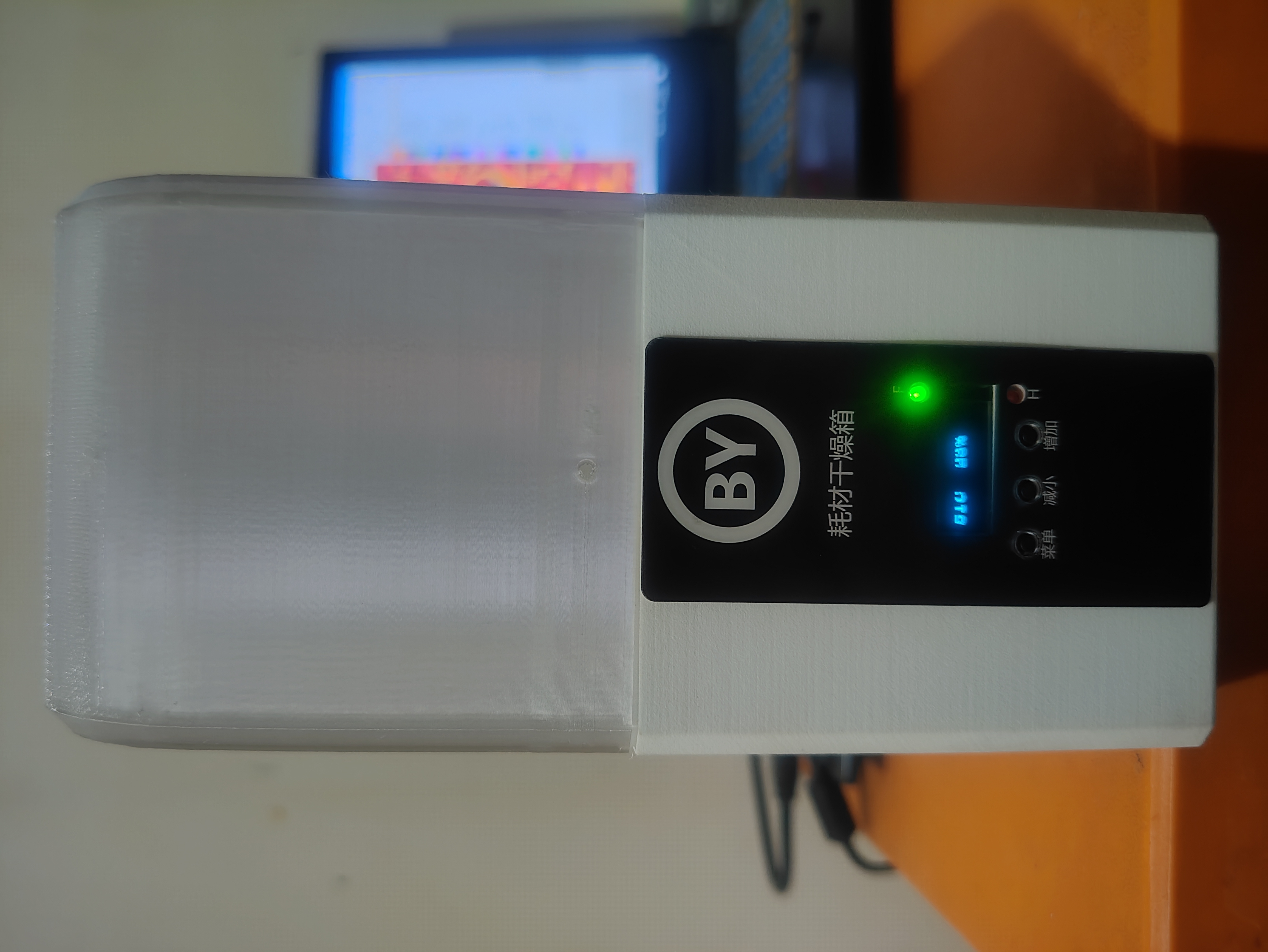

Operating Instructions

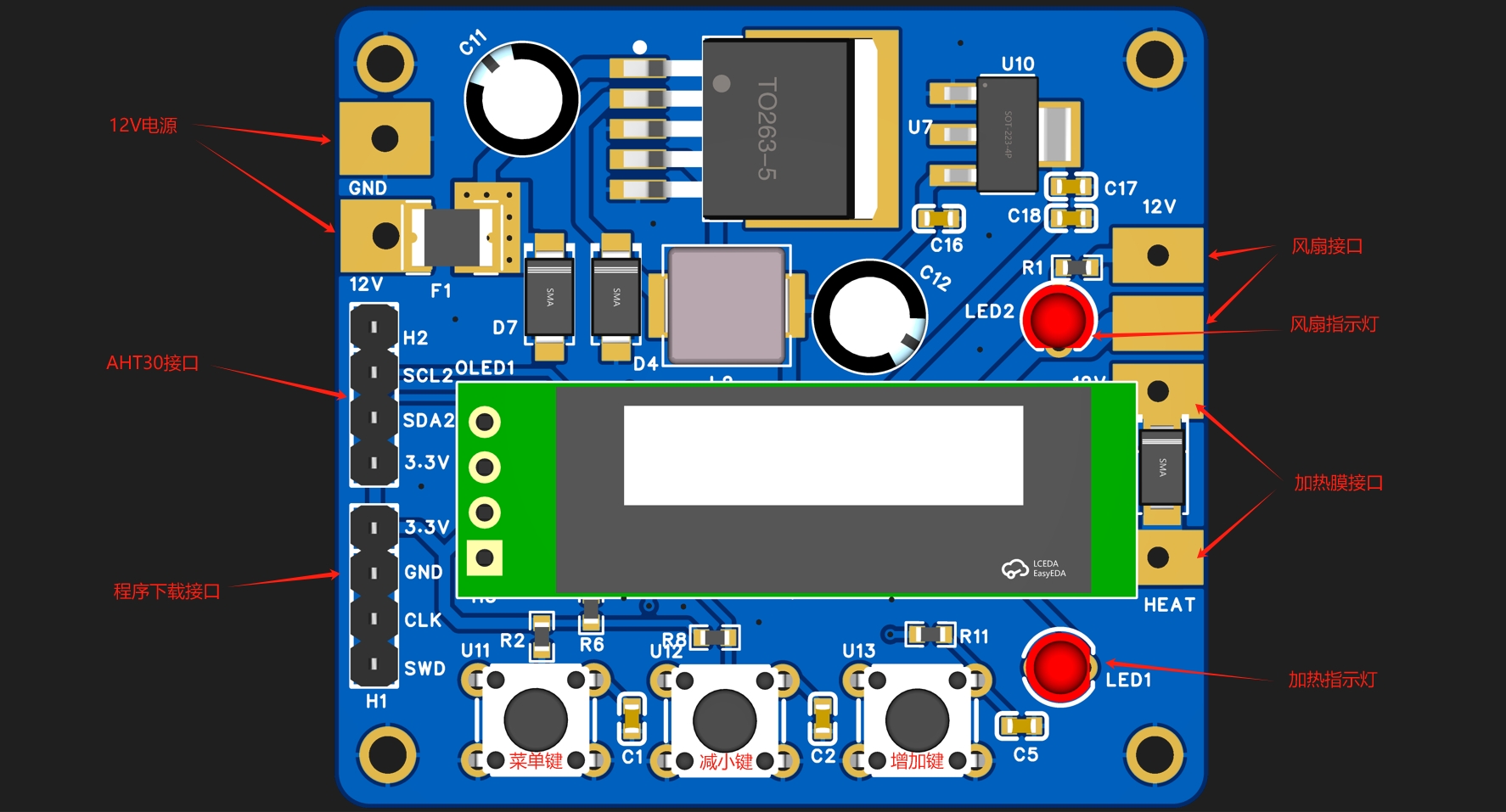

: 1. PCB Introduction
2. After power-on, during program initialization, the fan and heating indicator lights will illuminate simultaneously; they will turn off simultaneously upon completion of initialization.
3. After initialization, press the menu button to select the function
. Temperature Selection: Press the menu button once to enter the target temperature selection interface. The default is 50 degrees Celsius. Press the increase button once to switch to 60 degrees Celsius, and press the increase button twice to switch to 70 degrees Celsius. The maximum temperature is 70 degrees Celsius. Press the decrease button to reverse the temperature range, with a minimum temperature of 50 degrees Celsius.
Fan Power: Press the menu button again to enter the fan power setting interface. The default is 100%. Use the increase and decrease buttons to adjust the power in 10% increments. Maximum power is 100%, minimum power is 0%. At 0%, the fan output is off.
Heating Duration Setting: Press the menu button again to enter the heating duration setting interface. The default is 0 hours. At 0 hours, both heating and the fan stop working. Use the increase and decrease buttons to adjust the duration in 1-hour increments, with a maximum of 72 hours and a minimum of 0 hours.
Normal operation: Press the menu button once more to enter the default display interface, which displays the current temperature and humidity values ​​and starts working (if the heating time is not 0).

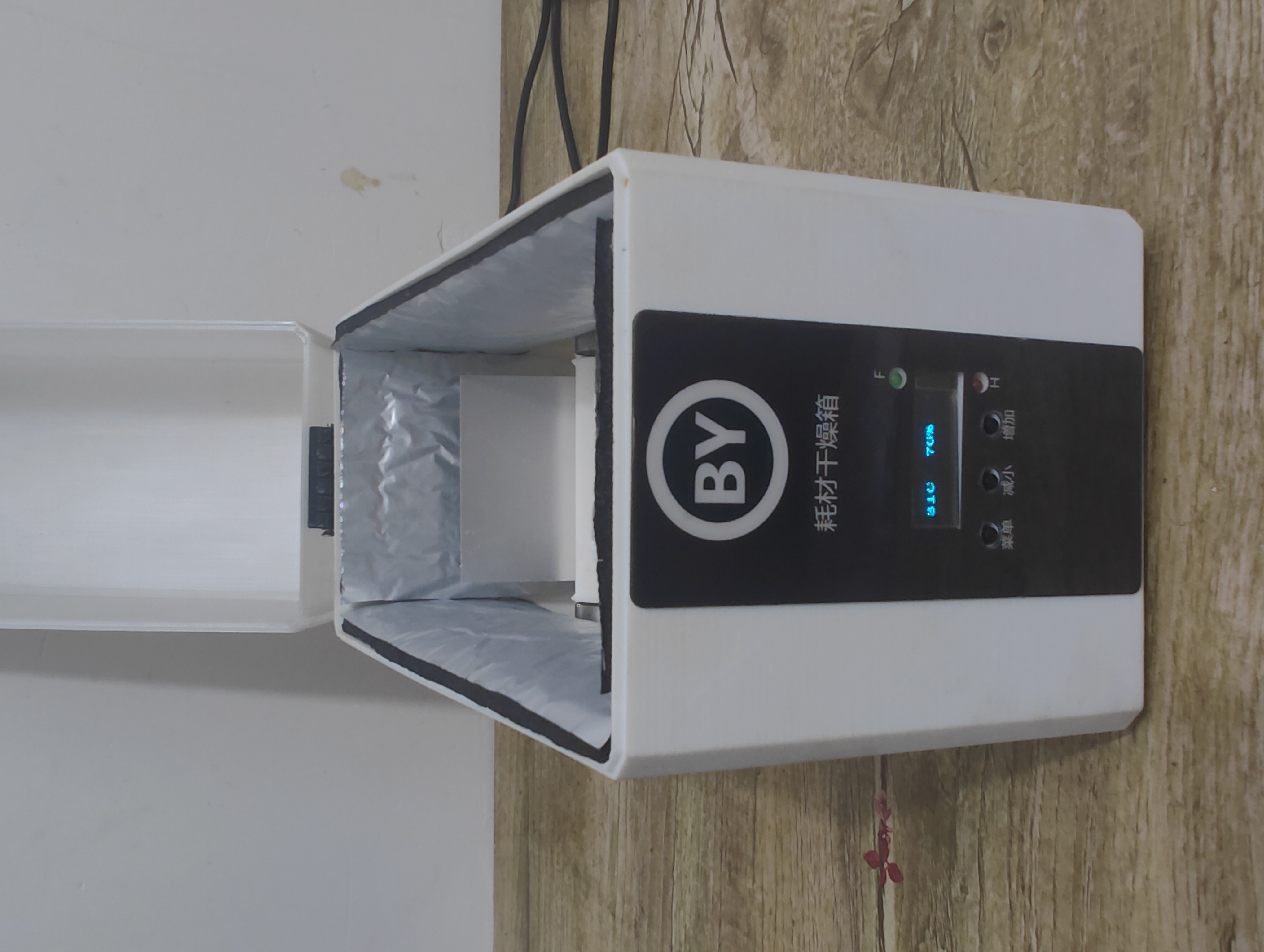

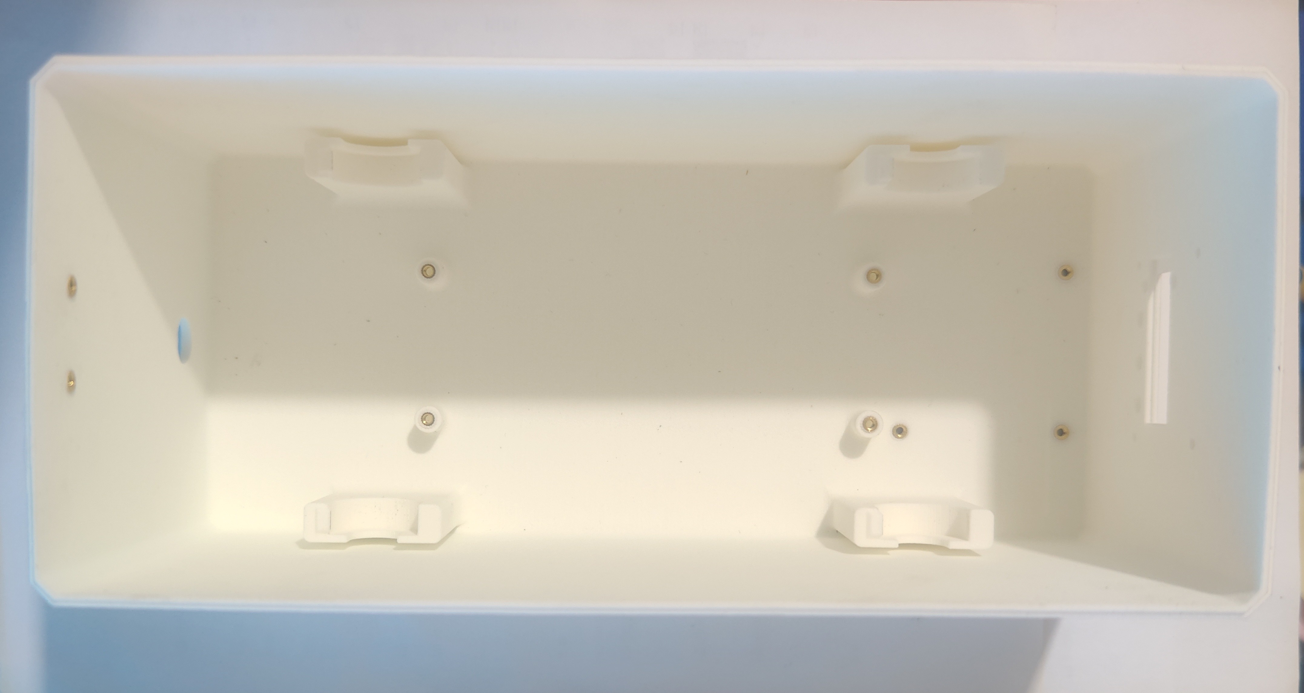

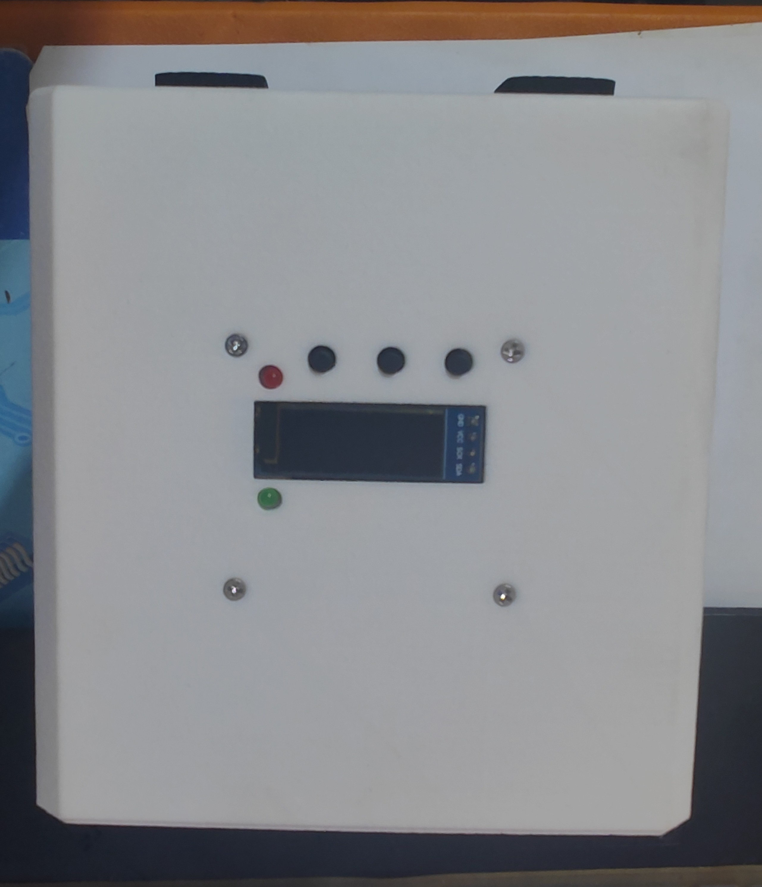

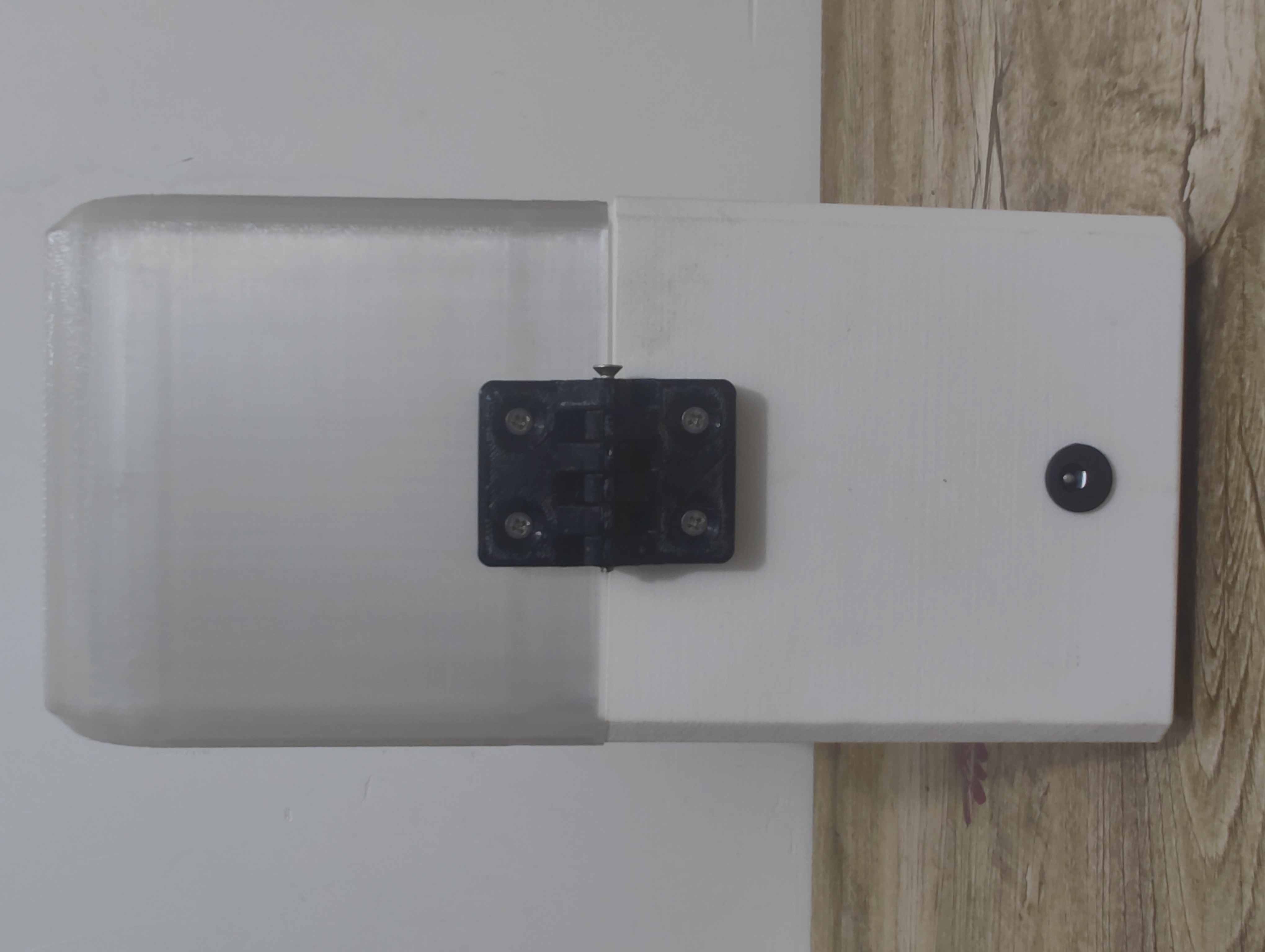

Actual product display:

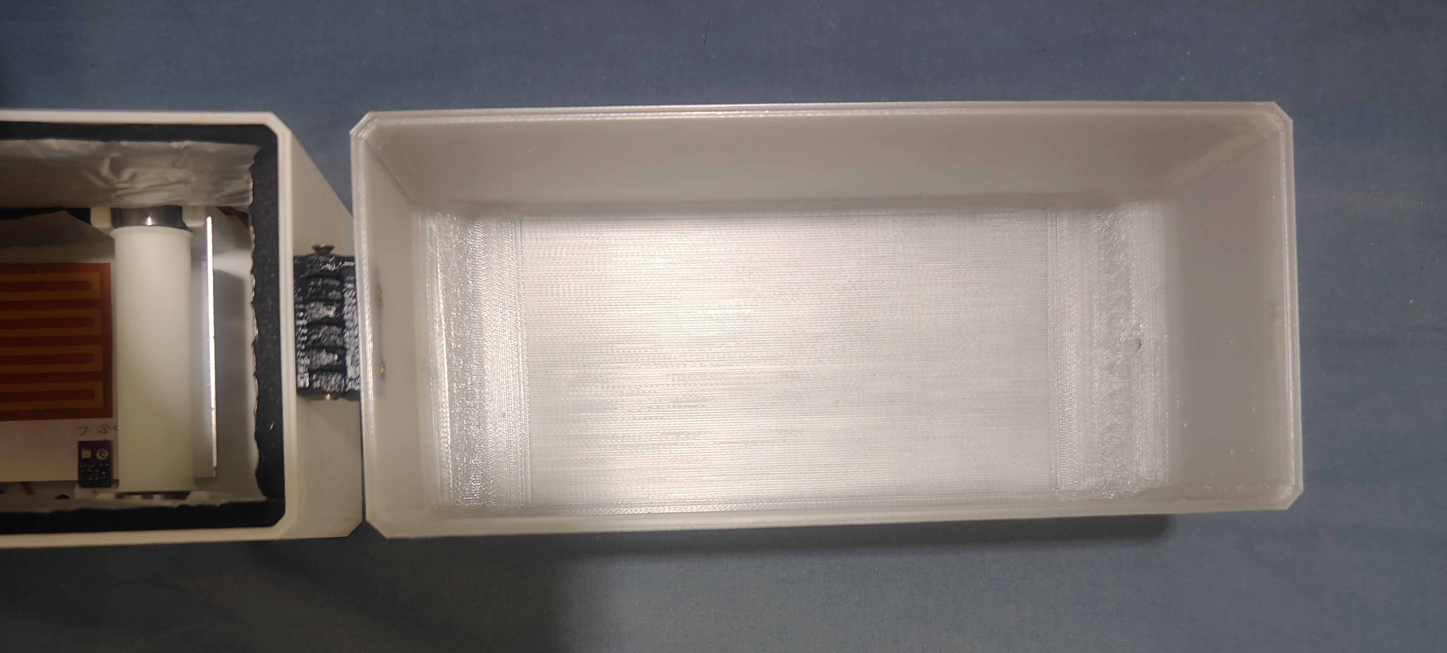

1. Bottom shell
2. Top shell

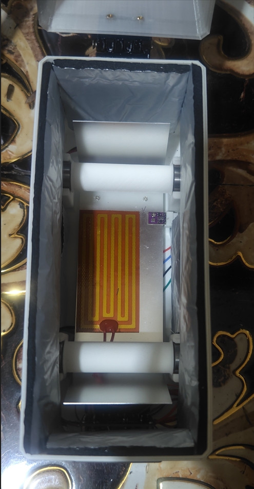

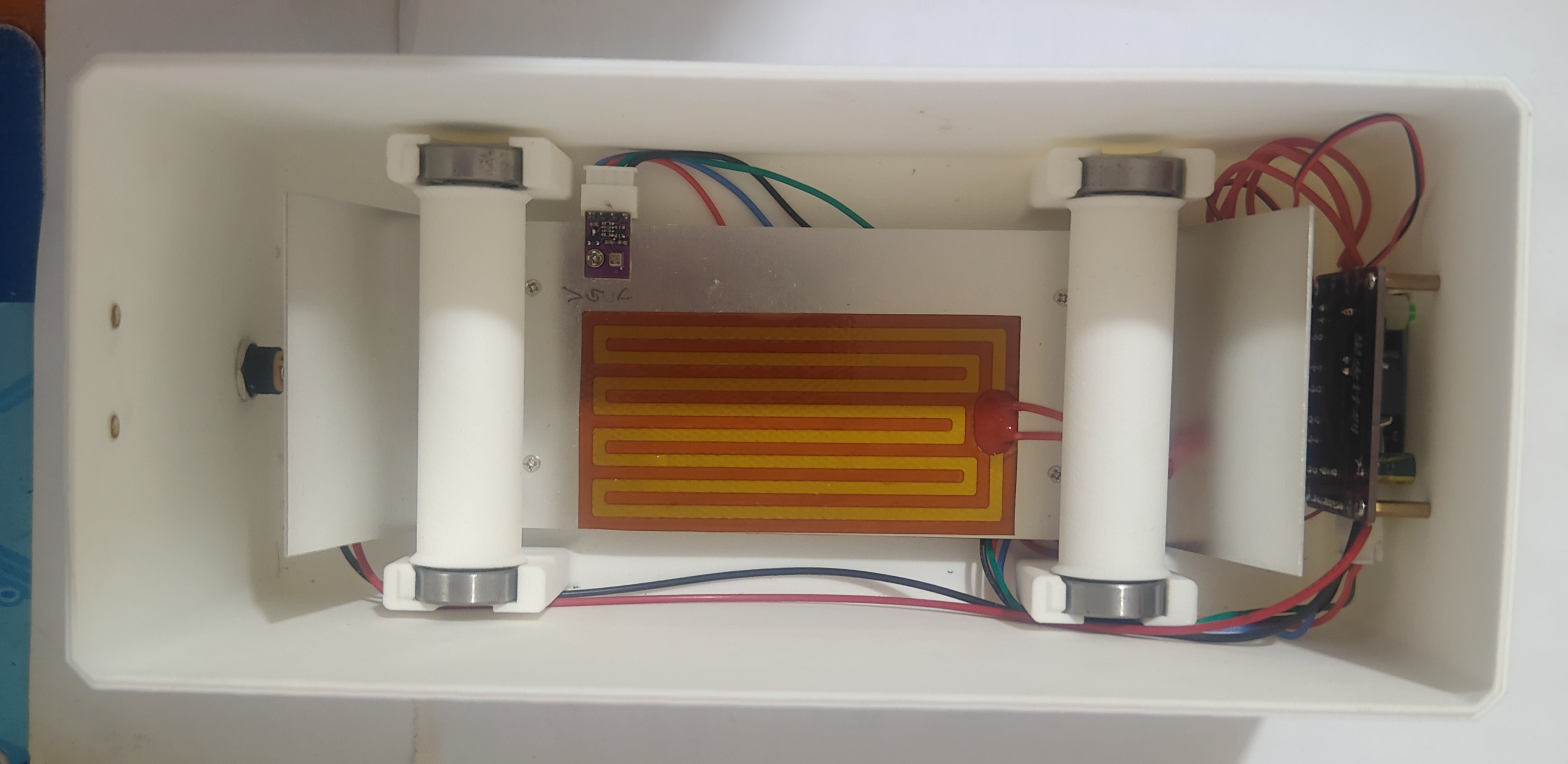

3. Heating film installation
4. Bottom shell assembly complete
5. Insulation cotton pasting

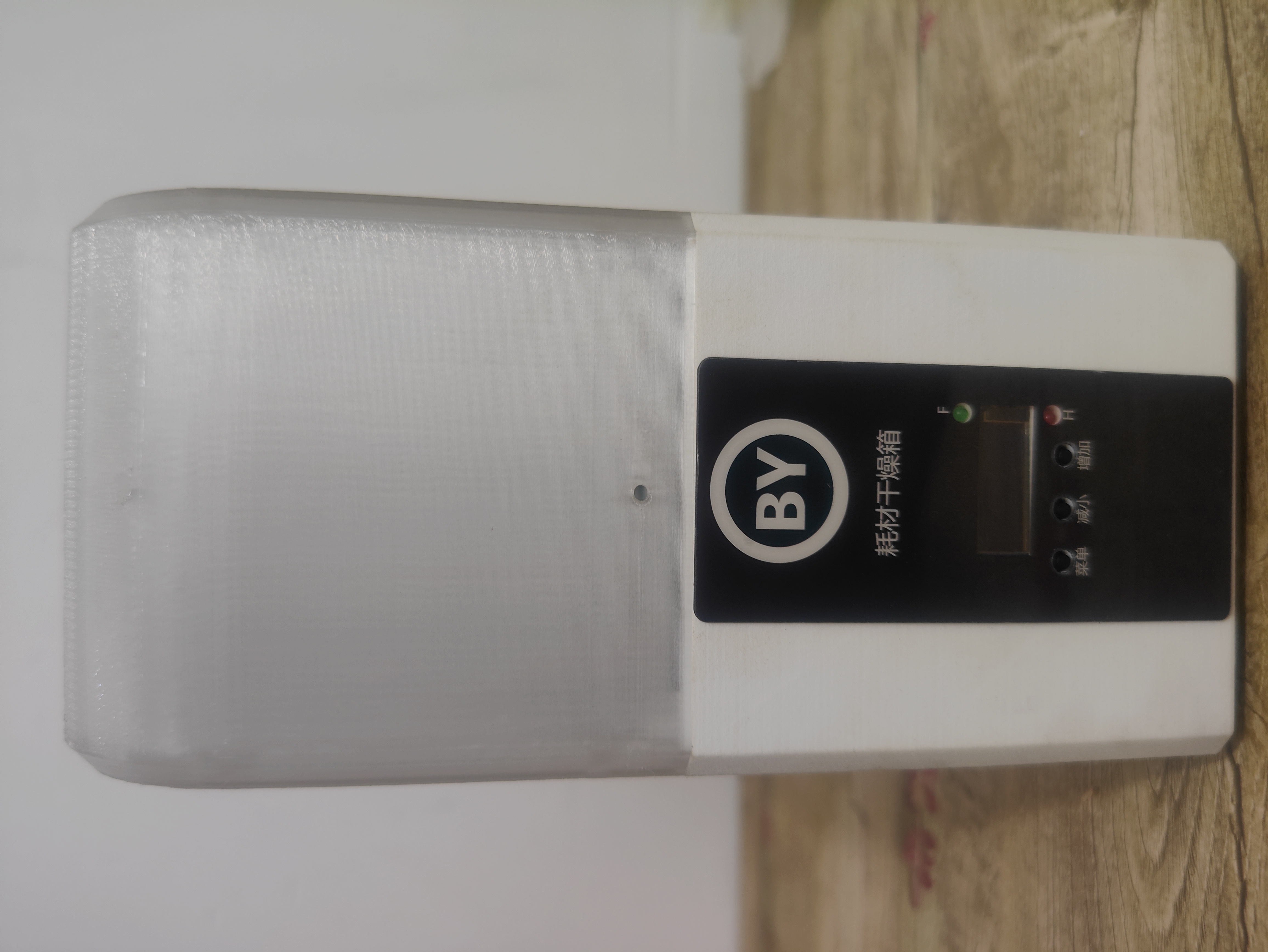

6. Front panel pasting

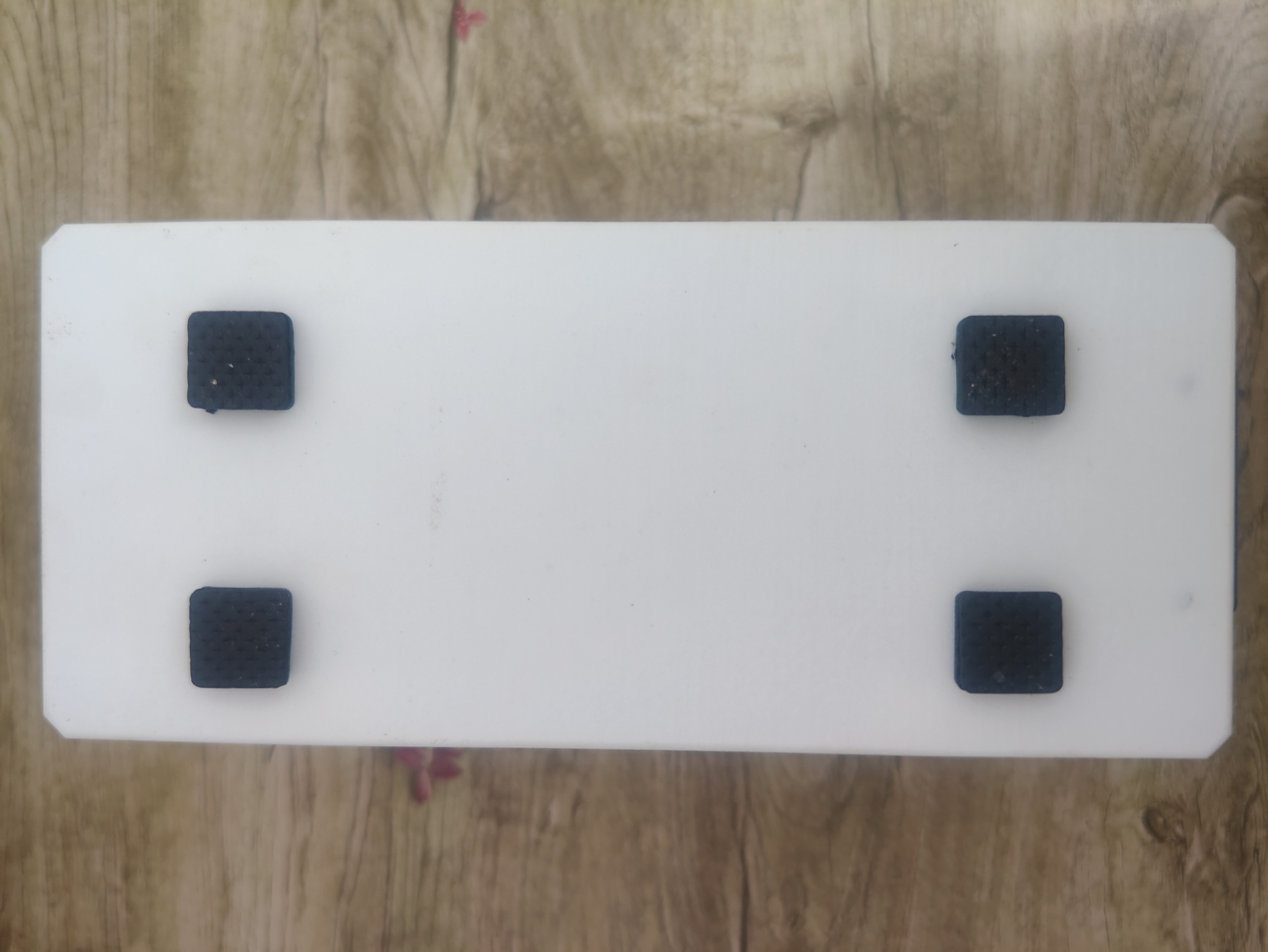

7. Foot pad pasting.
I chose relatively thin foot pads, and pasted two on each foot. You can choose suitable foot pads according to your preference.
8. Heating in progress

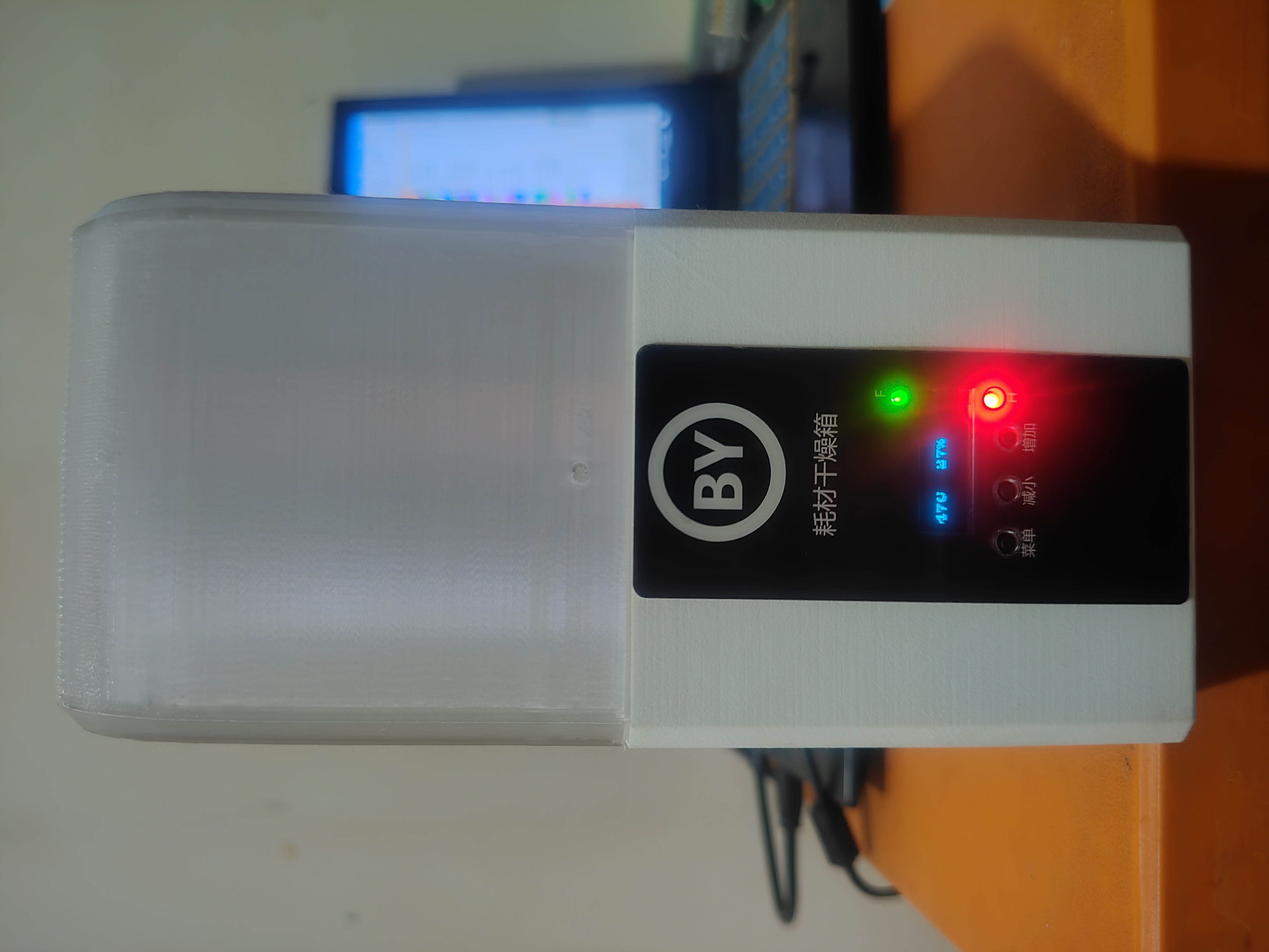

9. After reaching the target temperature, the heating power will decrease or turn off, and the heating indicator light (red) will turn off. When the temperature drops and heating resumes, the red light will light up again.
10. Other images show the back view

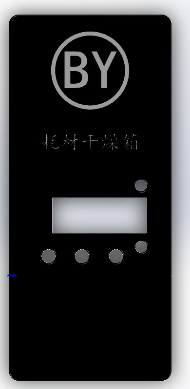

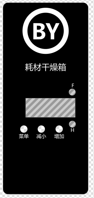

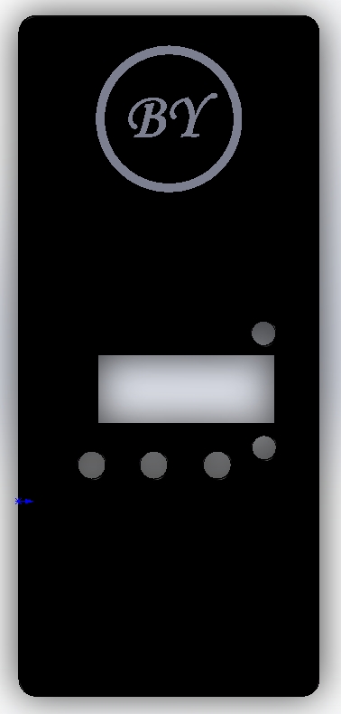

when powered on and without parameters set. 11. The panel can also be printed by yourself. There is also an EDA acrylic version available. You can order from LCSC Panel. LCSC Panel Design Effects 3D Printed Panel with Text 3D Printed Panel without Text QQ Group for communication : 698205066. See the attached "Demonstration Video.mp4" and "Complete Setup Video.mp4" for demonstration operation .
