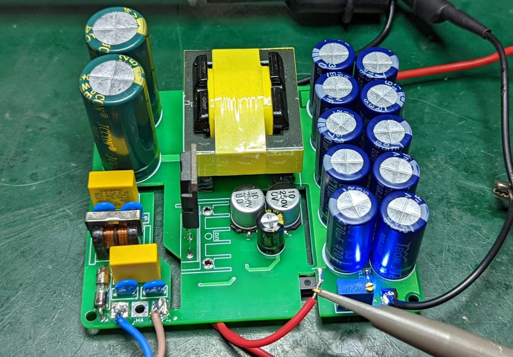

Key point 1: The four pins need to be raised with copper pillars to avoid short circuits caused by metal impurities on the table. I couldn't find copper pillars, so I cleaned the table and used that instead.

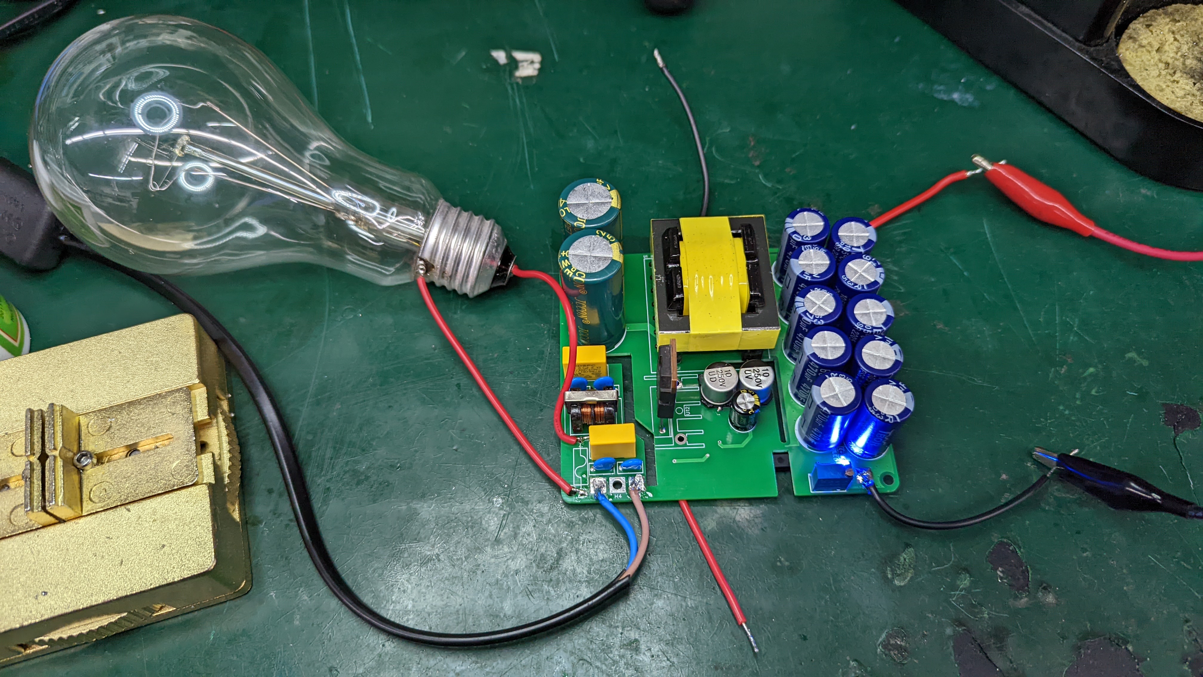

Key point 2: The fuse can be replaced with an incandescent bulb. The brightness of the bulb can be used to determine the problem. Generally, the brighter the bulb, the more severe the short circuit. If it doesn't light up, it's normal. You can test with the bulb under light load. Under heavy load, you cannot use an incandescent bulb because it will be too bright and consume too much energy.

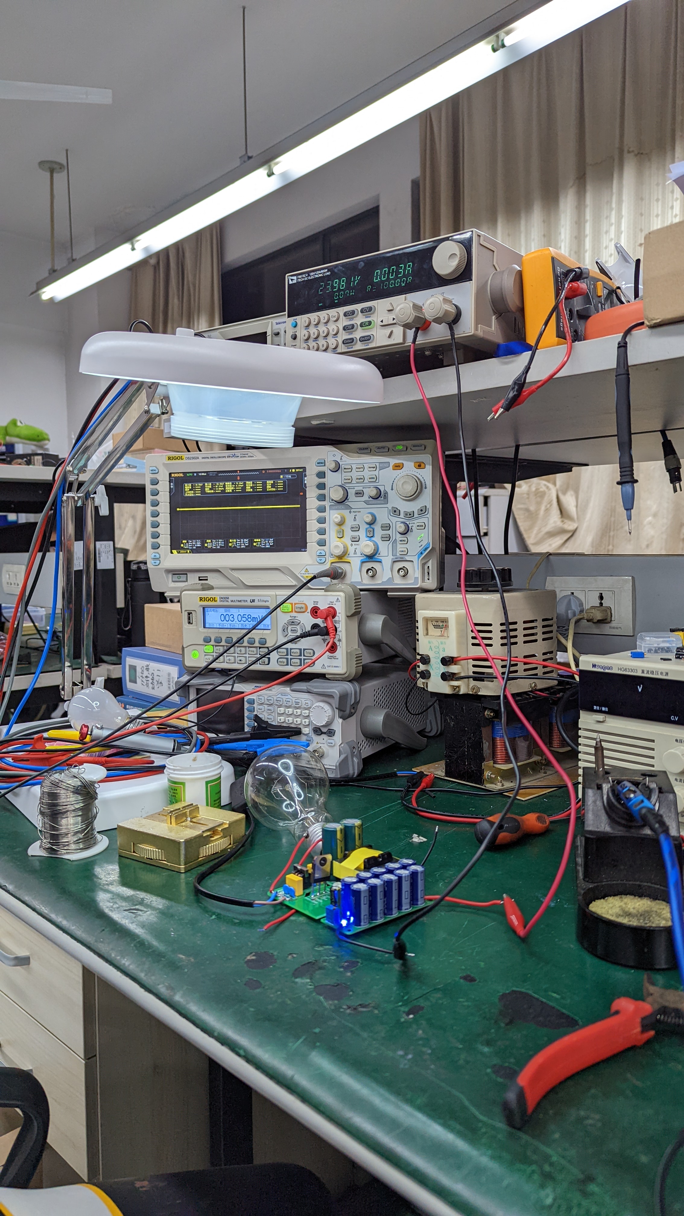

Key point 3: An isolation transformer must be used. Ideally, the oscilloscope should also be powered by an isolation transformer.
Feasible test results (note the electronic load above):

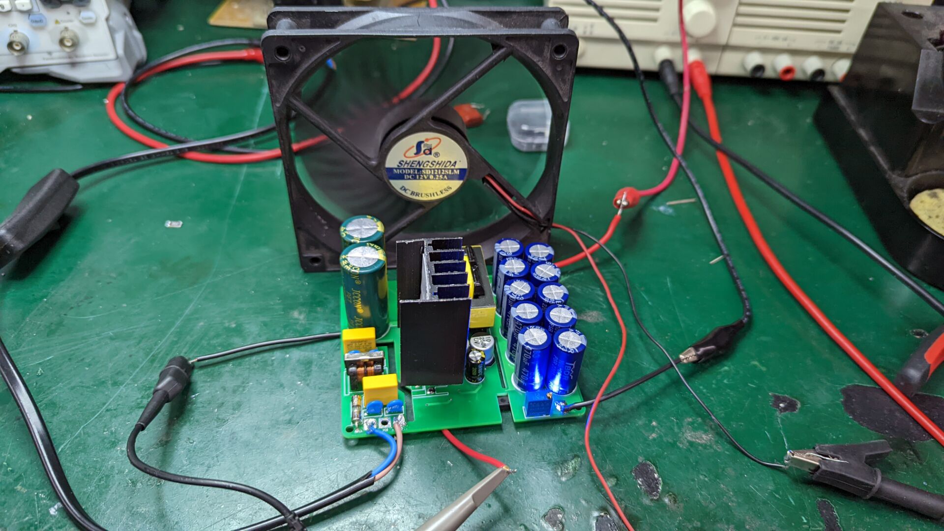

Key point 1: The MOSFET needs a heatsink, and a small fan can be added to help dissipate heat.

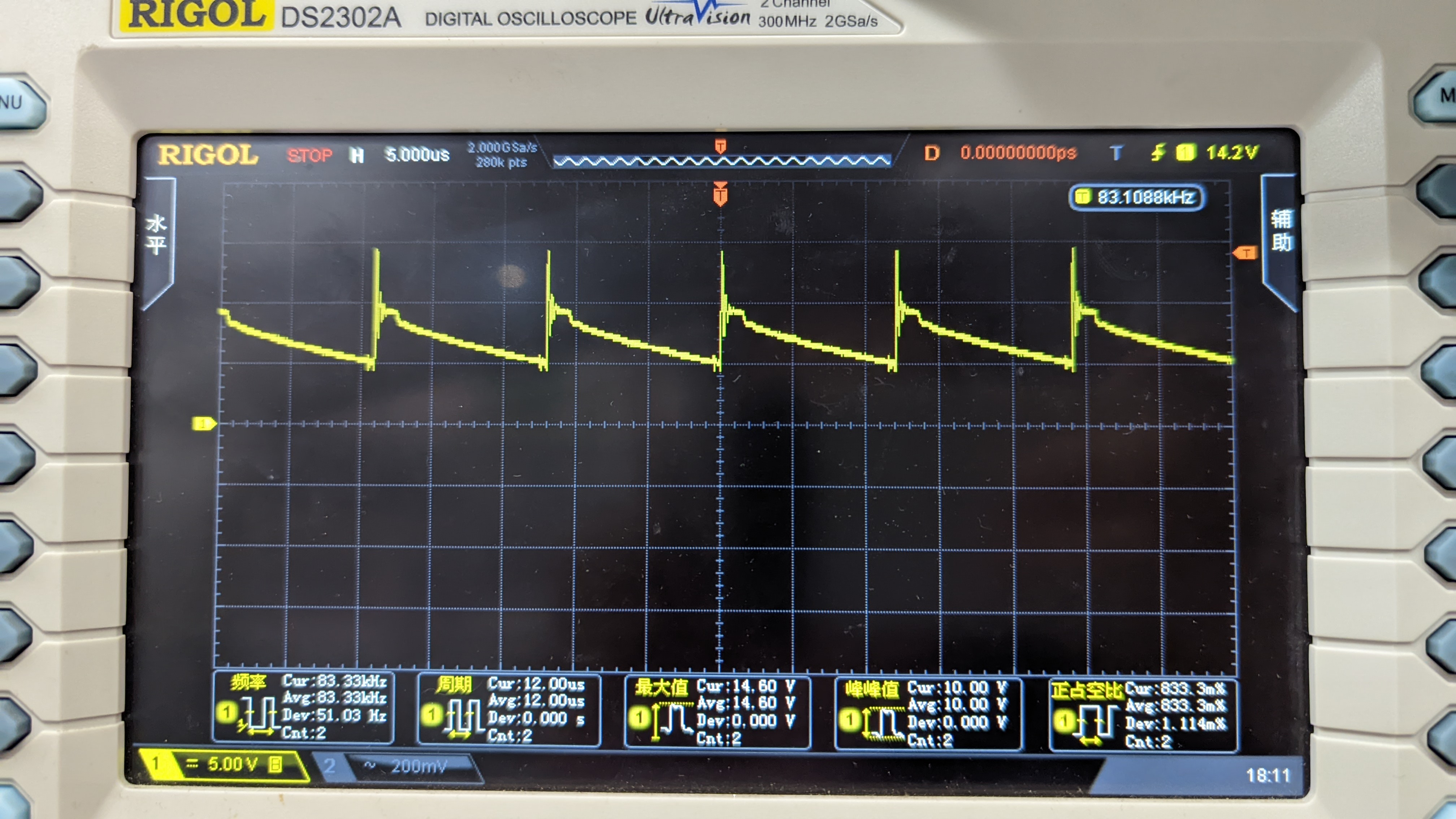

MOSFET drain waveform and RCD capacitor waveform:

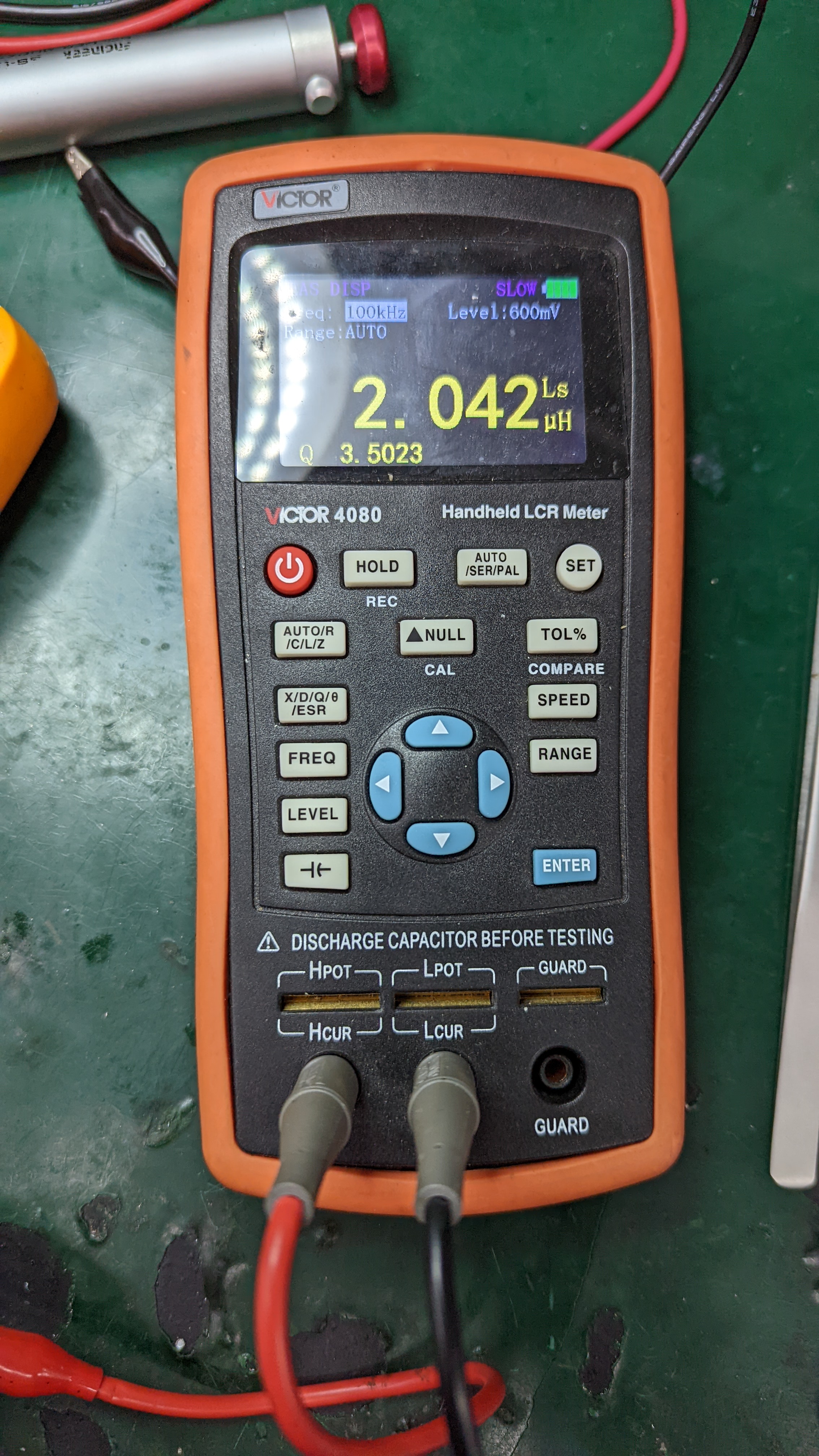

The peak voltage of the RCD is closely related to the leakage inductance, so we can test the leakage inductance.
Method for testing leakage inductance: Short-circuit all ports except the one under test, and directly test the inductance. Here, the inductance is 84uH, and the leakage inductance is 2uH.
RCD calculation (using MATLAB):
Vdsmax = 650 Vclamp = 0.9*Vdsmax - 374.767
Lk = 2.042*10^-6 Rc =(2*[Vclamp-19/5*(0.7+24)]*Vclamp)/ (Lk*Ip*Ip*fs)
Ip = 7.573 Cc = 2*Vclamp/(Rc*Vclamp*fs)
fs = 100*10^3 Pc = 0.5*fs*Lk*Ip*Ip*(1+(100/(Vclamp-100)))
Dmax = 0.4625
Results obtained: Capacitor and resistor selection: C=4.7nF, R=4KR.

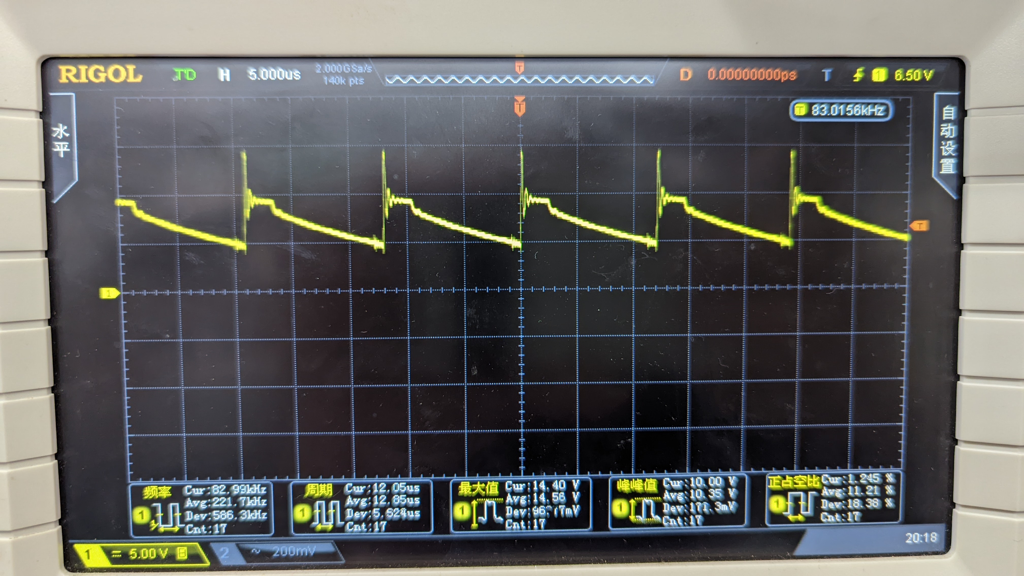

MOSFET drain waveform (half-load and full-load) and RCD capacitor waveform:

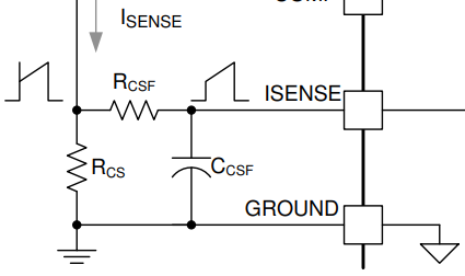

The output power only reached 180W. After reaching 180W, the output voltage dropped to maintain the output current. According to the official chip datasheet, a filter capacitor can be connected in parallel with the peak current sampling resistor to prevent voltage spikes. My peak current sampling resistor design also has some issues.
The actual output ripple is not large, but the output spike is particularly large. This may be because even though the output capacitor is large, no small capacitors to filter high frequencies were added.
