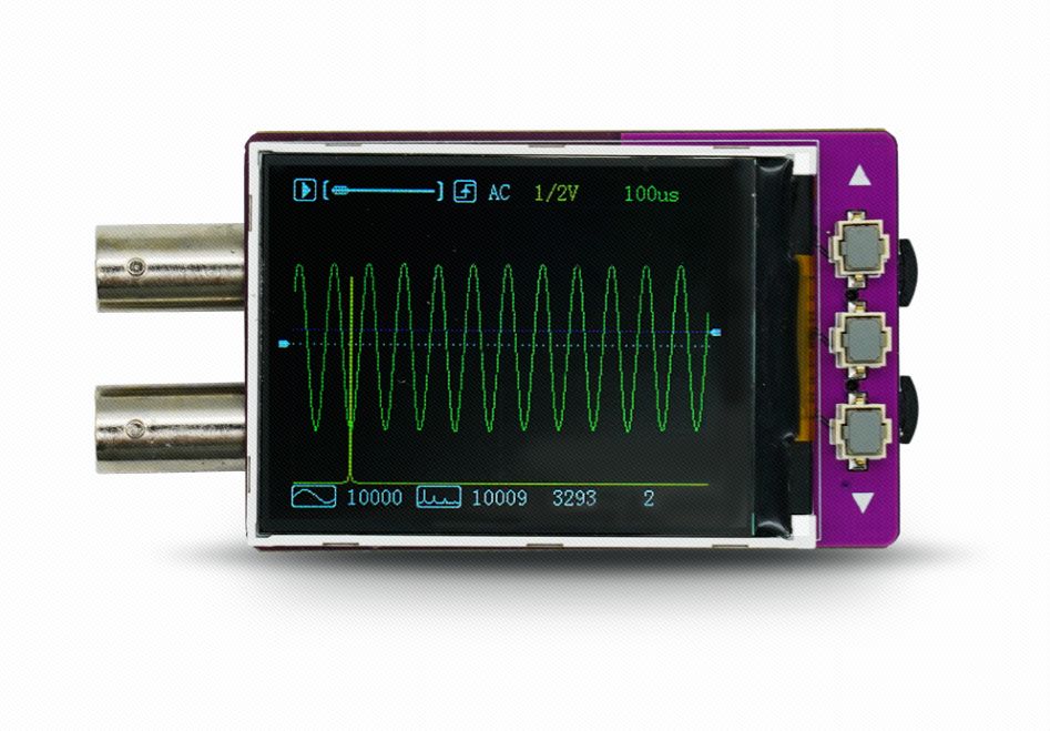

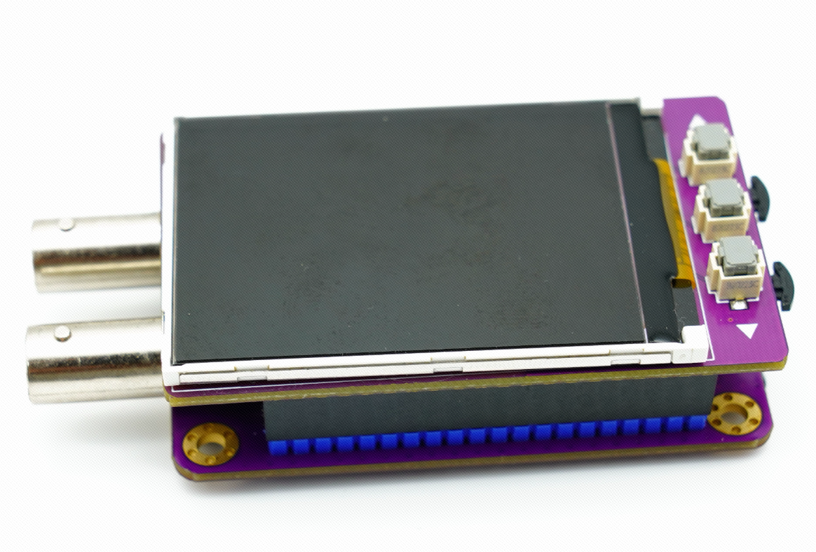

4. Several highlights of the Liangshanpai development board oscilloscope module:
4.1 Compact and convenient, putting the tool in your pocket.
4.2 Highly developed software framework, learning advanced development skills.
4.3 Simple circuit design, quick start-up for oscilloscope DIY:
Adopting a learning-level oscilloscope design scheme, combined with the built-in ADC and DAC of the Liangshanpai GD32F450, this DIY oscilloscope is made. (The analog circuit design section deeply studies and references the open-source oscilloscope module circuit of Anfulai, and a usage license has been obtained from Anfulai.)

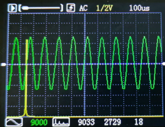

5. The Liangshanpai development board oscilloscope module's implemented functions are
fully open source in both hardware and software, allowing for free definition of more interesting functions.
Sampling start/stop: Starts and stops the ADC trigger timer; when pausing to view, detailed information such as maximum and minimum values ​​can be seen.
Buffer Scroll Bar: Displays the acquisition status by calculating the waveform trigger position; displays the pause status by adjusting the offset position.    
Rising/Falling Edge: Determines and displays the position when the sampled value and trigger condition are met through software comparison.    
AC/DC: Controls the on/off state of the oscilloscope's pre-amplifier coupling relay via I/O.    
Voltage Scale: Assigns voltage values ​​per 1/2V/div increment; controls the operational amplifier multiplier via I/O using an analog switch.    
Time Scale: Changes the sampling time scale by controlling the ADC trigger timer cycle.    
Trigger Amplitude: Sets the trigger value and draws the horizontal bar position using software; indicated by a blue dashed line.    
Waveform Offset: The display position is offset vertically by software processing; indicated by a white dashed line.    
Waveform Display: No longer uses the traditional two-point slope calculation (neither X nor Y coordinates are used); instead, only vertical lines are drawn between adjacent points, reducing code computation.    
Waveform Generator Type: Automatically generates the corresponding waveform output by changing the single-cycle data in the DAC's buffer.    
Waveform Generator Frequency: Automatically generates the corresponding waveform cycle by changing the DAC's time trigger period.    
FFT Measurement Switch: Software controls the display of the FFT spectrum waveform.    
FFT Frequency Measurement: Calculates the frequency using the maximum frequency percentage point, which may differ slightly from the actual frequency.    
FFT Spectrum Scaling Factor: Scaling by the maximum value based on the required display height of 150 pixels.    
Display Coordinate Offset: Displays the triggered position value in sampling mode and the manual offset position in pause mode.
