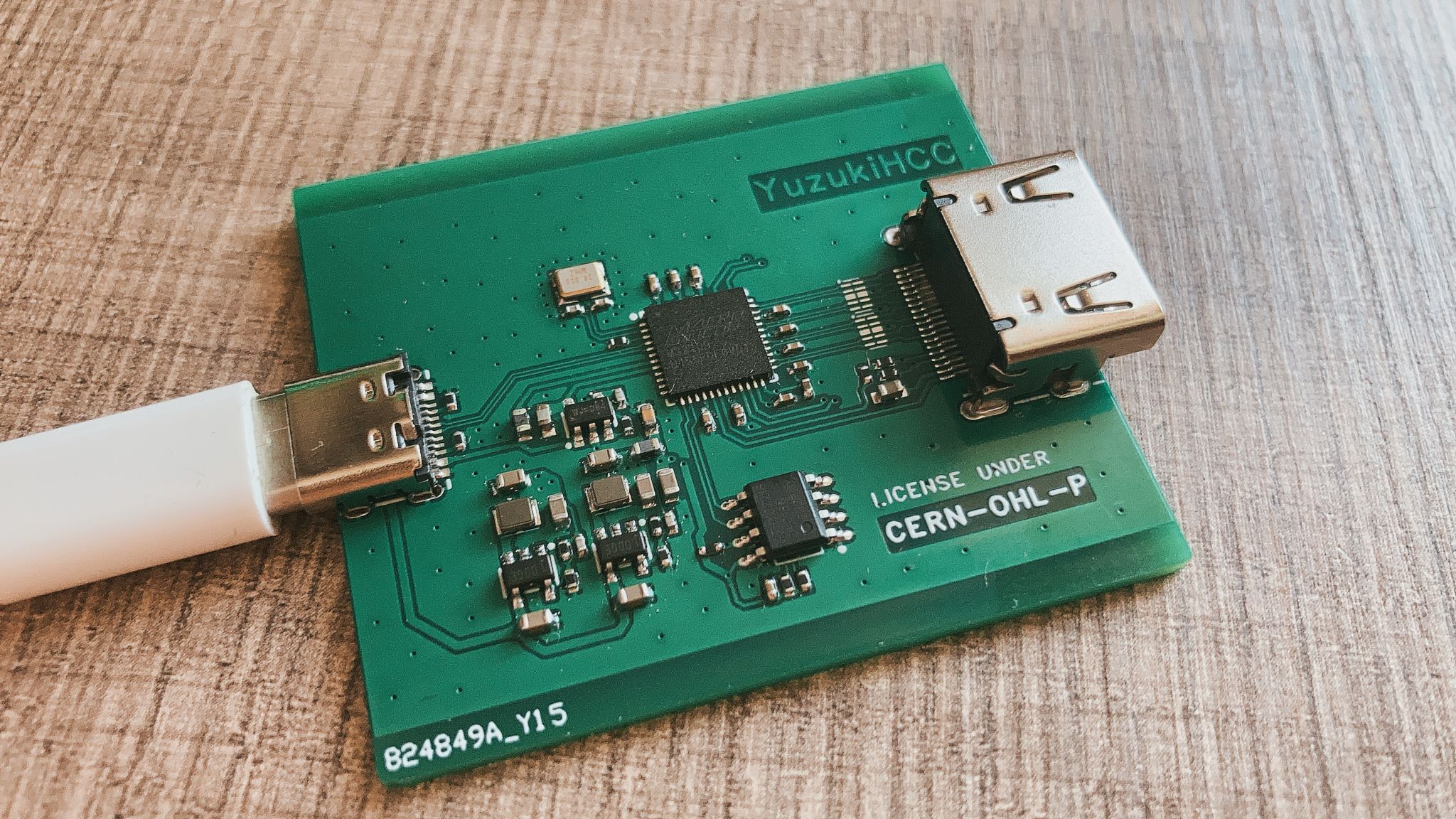

Yuzuki HCC HDMI Capture Card
A low-cost HDMI capture card based on the MS2109, costing only 23 RMB. Features
a Type-C USB 2.0 interface,
full-height HDMI
compatibility, DVI 1.0
support, HDCP 1.4 support (the firmware does not provide an HDCP key; please apply for one yourself),
YUV & JPEG output
compatibility, UVC 1.0
support, audio capture
, and video capture.
Maximum video input resolution is 3840x2160@30,
and maximum output resolution is 1920*1080@30.

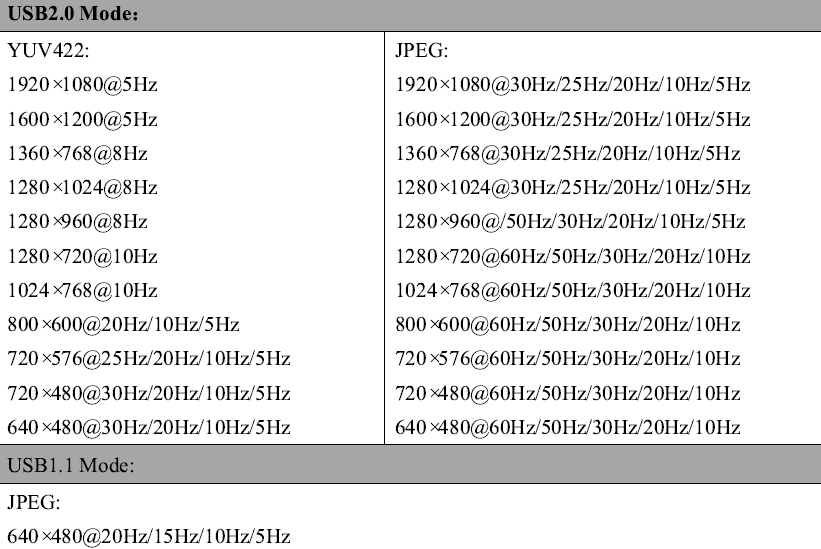

(Image attached:
After firmware flashing, two devices will be displayed, one audio input and one video input.
Supported USB output resolutions are listed
