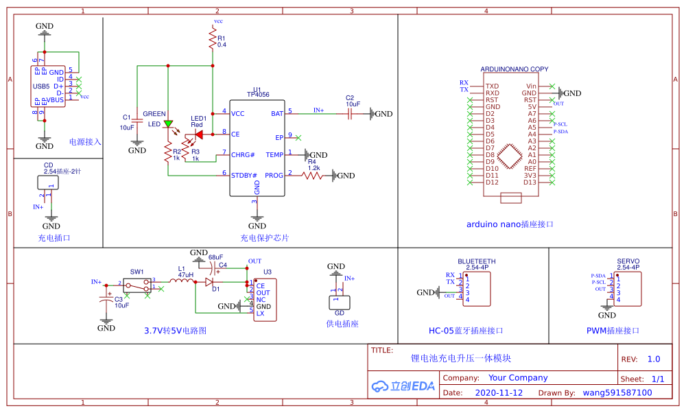

Lithium battery charging and power boosting
Using TP4056 chip and NCP1402SN50T1G for lithium battery charging management and discharge boost management
