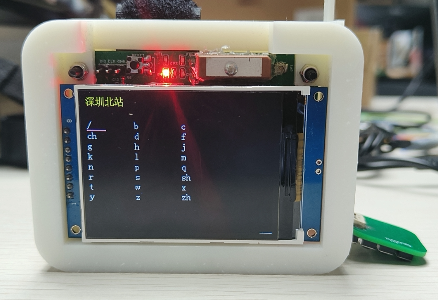

This project is a cycling navigation assistance display device based on STM32.
Project Functionality
This device uses STM32F103RCT6 as the main controller. Users can set the navigation destination by inputting Chinese characters via buttons. The system can convert the destination into latitude and longitude coordinates, and simultaneously obtain the starting coordinates by reading the GPS module to generate a cycling navigation route based on the Gaode Map API.
This device does not require a mobile app, but the mobile phone still needs to enable its hotspot function to provide Wi-Fi. For
font download steps, refer to "Software Design -> Chinese Input Method -> Font Download".
When the device starts up, the GPS will search for satellites; during this time, the LED corresponding to "GPS" on the front will not light up. During the satellite search, the device must remain stationary and free from obstructions from buildings above (trees will not affect the GPS module's hot start). Before
use
, generate font burning code using the code generated in `/Fonttype/fonttype.py`, and use the generated code to download the font library to Flash via STM32 (direct communication between STM32 and computer for font library download will be considered later).
Registration on the platform is required to use Huawei Cloud and Gaode Map services.
Upon startup, the device enters the input method (foreground application `inputmethod_app`).
The entered text is displayed at the top of the screen, and candidates are shown below.
When inputting Pinyin, there are 3 items per line; when inputting Chinese, there are 20 items per line. The cursor can be moved to select the text to be entered.
ASCII character input mode.
Key bindings:
Delete last entered text/Delete previous option | Move cursor up | / | Search destination
Move cursor left | Select current option | Move cursor right | /
Clear current content | Move cursor down | / | Switch location/city.
The cursor movement definition is shown in the image below.

Hardware Design
Battery Management
This device is powered by a 3.7V lithium battery, which outputs 3.3V via a linear regulator BL9110-330BPFB.
The lithium battery charging circuit references [1] and uses LGS4084 for lithium battery charging management. VCC (pin 4) uses a Type-C interface to provide 5V input and connects BAT (pin 3) to the lithium battery.
Under normal circumstances, if the battery is connected, CHRG (pin 1) outputs a low level and FULL (pin 5) outputs a high level when charging; after fully charged, CHRG outputs a high level and FULL outputs a low level. The charging status can be displayed by connecting an LED.
The STM32 main
control chip uses STM32F103RCT6, with a crystal oscillator input of 8MHz. After PLL frequency multiplication, the main frequency is 72MHz. It has 256KB Flash and 48KB RAM.
The peripheral
STM32 cannot store Chinese character libraries, so external Flash is used for storage.
The W25Qxx series is Nor Flash and can communicate with STM32 via SPI. The W25Q32 has a capacity of 4MB.
The GPS module uses ATGM336H finished module, which supports GPS, Beidou and other positioning systems and sends data through serial port.
After the module is powered on, if it is searching for satellites, the LED on top of the module will remain lit. After the satellite search is complete, the module's LED will flash at a frequency of 1Hz, and the PPS pin will output a pulse at a frequency of 1Hz to drive the GPS LED on the top layer of the PCB to flash.
This module requires an antenna connection; this project uses a ceramic antenna.
The display screen is a 2.4-inch TFT screen (GMT024-8p10p-SPI VER1.1) manufactured by Shenzhen Jinyichen, with a size of 240*320 pixels, and comes with an ST7789 driver, using SPI communication.
If using other screen/baseboard models, please modify the pin definitions of the connector accordingly. For
the Wi-Fi module
, this device connects to Wi-Fi via an ESP32 Pico-D4 and communicates with the STM32 via serial port
. The automatic download circuit uses a CH340K chip. When the ESP32 enters download mode, IO0 needs to be pulled low first, and EN needs to be pulled low and then high to reset the chip. Upon restarting, it detects IO0 as low and enters download mode.
IO0 and EN are high by default. The transistor circuit analysis is as follows:
