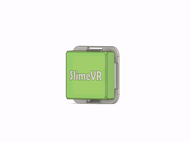

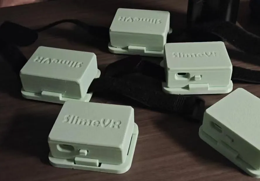

This project consists of an ESP-12F + IP5306-CK + BMI270, with a CH340K for automatic downloading, an LDO for step-down, and a 3.3V power supply.
The official website describes the BMI270 as follows: The BMI270 is a relatively new experimental IMU for DIY SlimeVR. Its performance appears to be significantly better than the BMI160, while being more affordable.
The casing uses the Fusion360 design shell. 3. Firmware:
