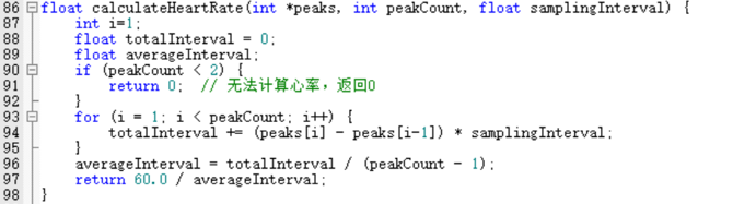

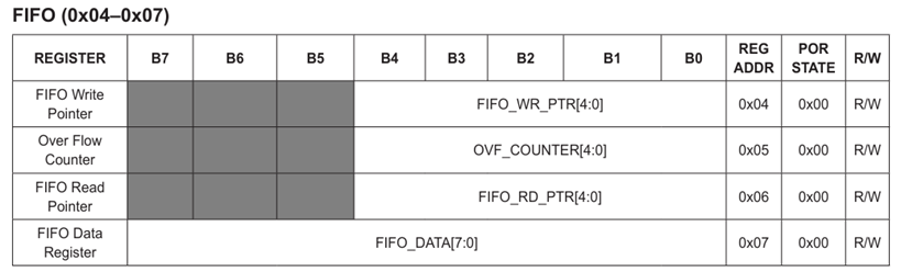

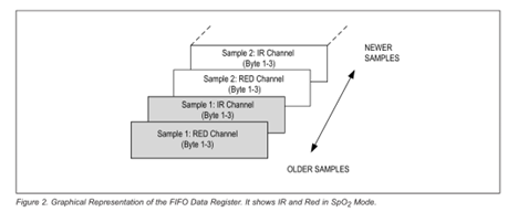

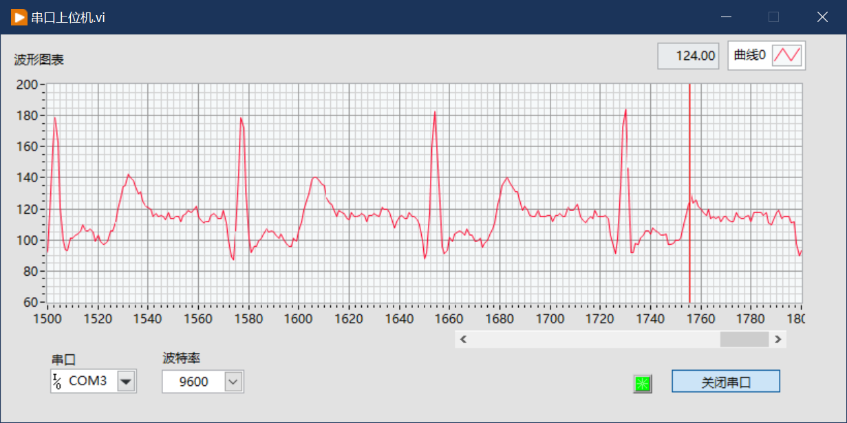

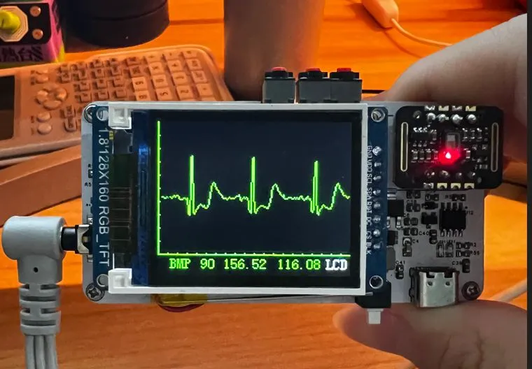

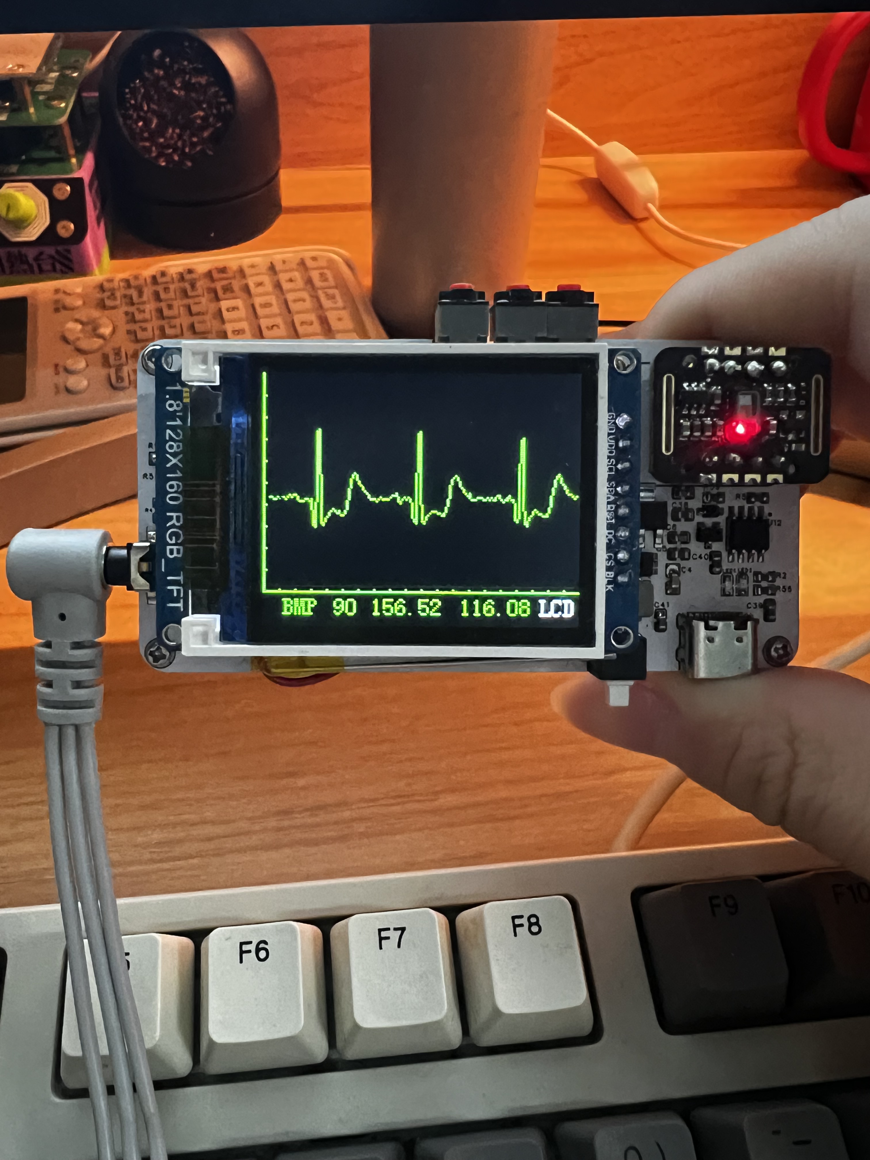

Displays real-time ECG waveforms and calculates heart rate. It can also measure blood oxygen saturation.
It can switch between lower-level screen display and Bluetooth transmission of waveform data to the upper-level computer.
Warnings for tachycardia and bradycardia.

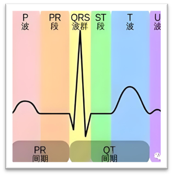

ECG Signal Introduction
The frequency range of ECG signals is mainly concentrated in the range of 0.05~100Hz, with a voltage of about a few tenths of a millivolt. It has the characteristics of being weak, low-frequency, and easily interfered with. Common types of interference include:
1. Power frequency interference. Interference caused by the power supply network (usually 50Hz) is a major source of interference in ECG signals.
2. Baseline drift. Changes in the ECG baseline caused by respiration and exercise can result in amplitude variations of up to 15%, with low frequency.
3. Electromyographic interference. Muscle activity is accompanied by electrical activity. Its frequency range is 20–5000Hz.

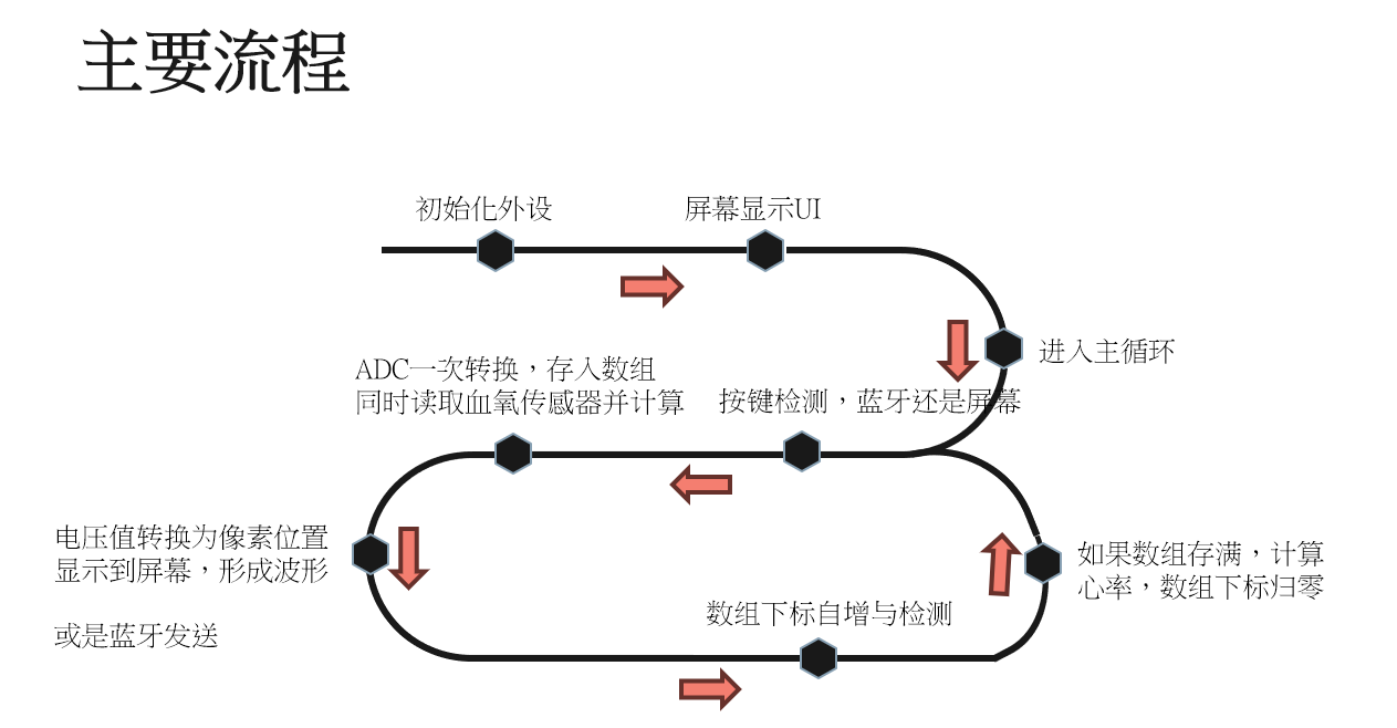

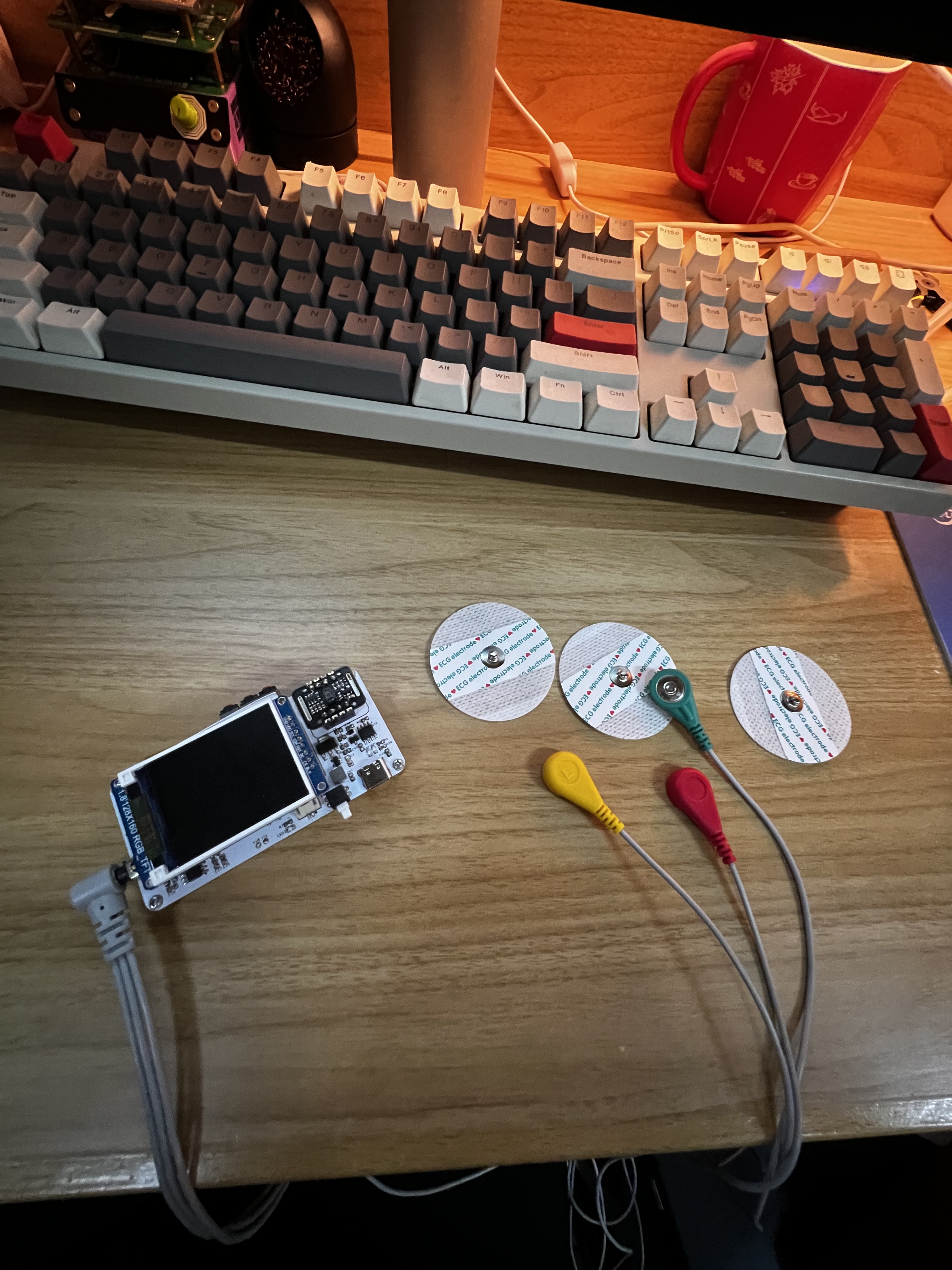

ECG processing circuit introduction:
First stage preamplifier, gain 7, includes right leg drive circuit, used to eliminate common mode interference.
Second stage 107HZ low-pass filter, eliminates high frequency signals.
Third stage dual-T active 50HZ notch filter, filters out power frequency interference.
Fourth stage 0.1HZ high-pass filter, improves baseline drift, amplifies 50 times.
Fifth stage amplifier amplifies the signal 5 times.

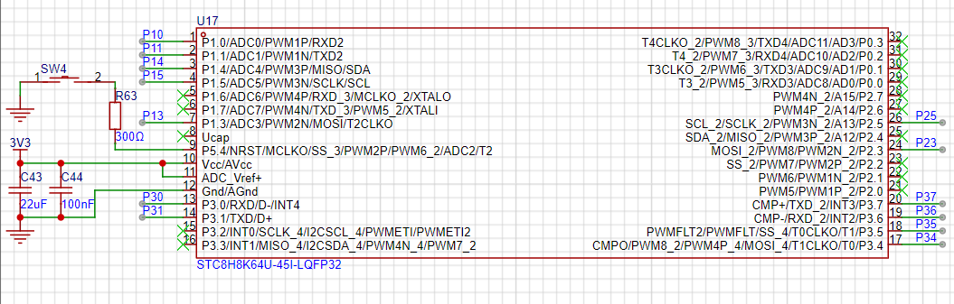

Overall, the signal is amplified 1250 times. The microcontroller is reset at low level
on

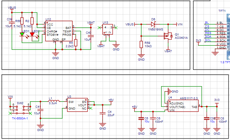

pin P54 for software programming. It is powered
by 3V3. USB and lithium battery. The USB interface uses the widely used Type-C battery. The battery is an 850mA 3.7V lithium battery. After inserting the USB cable, it can automatically switch to USB power supply and charge the lithium battery at the same time. Battery charging management uses TP4056 chip. Software design: Heart rate calculation: Heart Rate (bpm) = 60 / average R wave interval (seconds). R wave detection method – threshold method: 1. Traverse the data: Traverse each data point in the ECG data array. 2. Peak Condition: For each data point, check if it is greater than the data points on the left and right, and if it exceeds the preset threshold. 3. Record Peak: If the data point meets the above conditions, record its position, indicating that an R-wave peak has been detected. Advantages: Simple, fast Disadvantages: Inaccurate, and the threshold needs to be determined manually. If baseline drift or noise spikes occur, it will have a significant impact. Waveform Drawing Implementation : Calculate and scale the voltage value to the Y-axis coordinate value of the screen pixels, and use the X-axis as the time axis . Draw one pixel for each ADC value, and draw a straight line connecting adjacent points. The final effect is a real-time voltage waveform scrolling refresh. Blood Oxygen Saturation Reading: 1. Initialization: Initialize the MAX30102 sensor, including configuration mode, sampling rate, LED current, and other parameters. 2. Data Acquisition: Read the intensity data of red and infrared light from the sensor's FIFO Data register via I2C. Each data point consists of three bytes and needs to be merged into a single long integer. 3. Calculation: Blood oxygen saturation is calculated using a simplified formula based on red and infrared light data. The simplified formula is : R = red / ir spO2 = 120 - 25 * R. Accurate calculation of blood oxygen saturation requires obtaining both the DC and AC components of the light intensity, which involves a large amount of computation and storage. The simplified formula may not yield accurate results. The host computer is based on LabVIEW and only has basic waveform drawing functionality. Demonstration video link: https://www.bilibili.com/video/BV1mJ8qeSEuj/?vd_source=51dc43e08b25c112cfd71690f421341d
