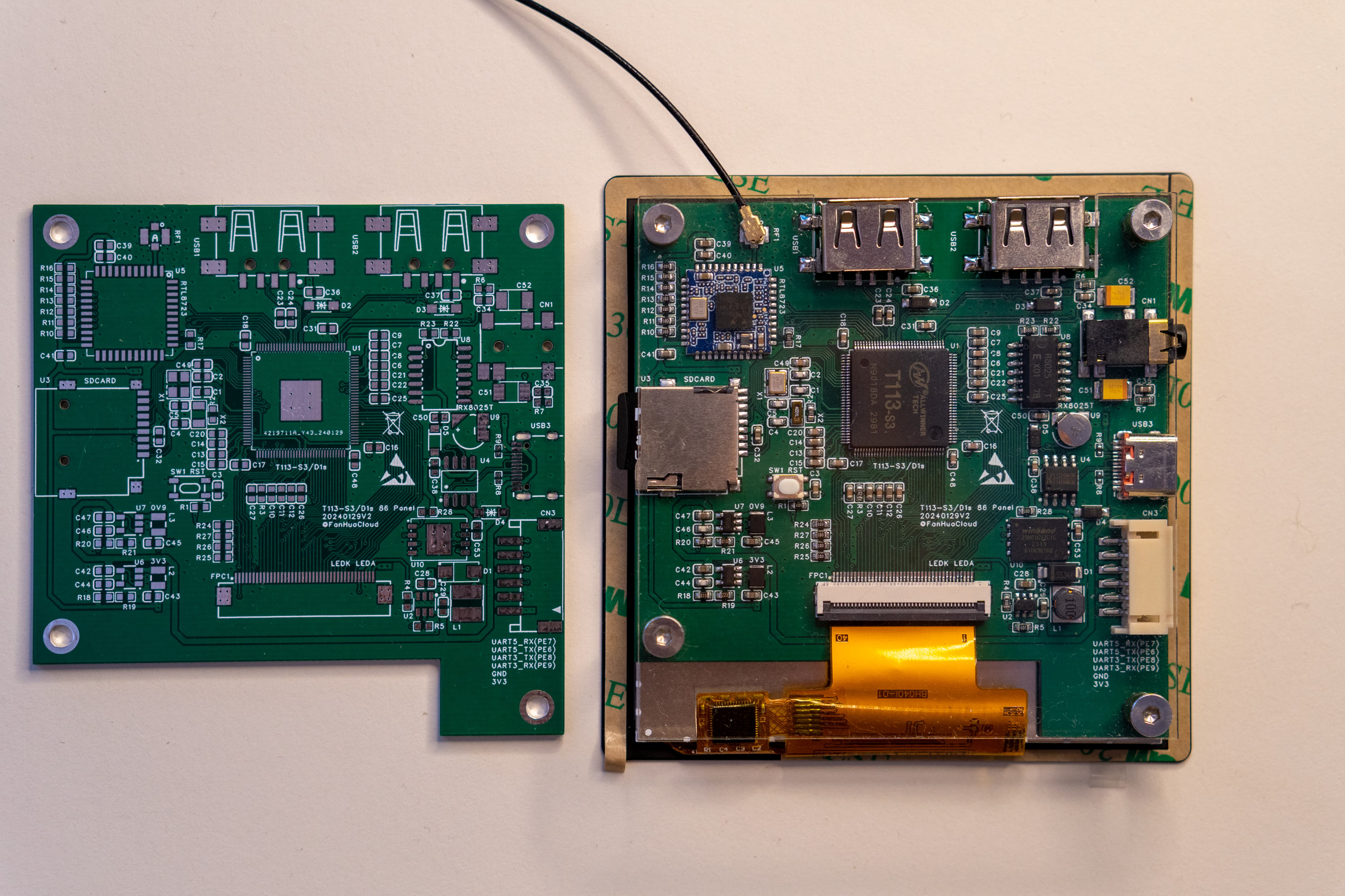

This project is an 86-type smart touchscreen solution for smart home scenarios, based on the Allwinner T113-S3 chip. The Allwinner T113-S3 chip integrates advanced processor technology and is designed to meet the performance, power consumption, and wireless connectivity requirements of smart home control systems.
Project Features:
4-inch 86-inch screen, RGB interface, 480*480 resolution;
Allwinner T113-S3 main controller, dual-core A7, 128MB memory, supports hardware decoding and D1s Pin-to-Pin, supports interchangeable
RTL8723 WIFI modules for connecting WIFI
SPI Nand, supports booting the system from SPI Nand;
dual USB interfaces, one supports Host/Device, the other only supports
two serial ports extended by PH2.0 for RS485 and other functions;
adapts to Allwinner Tina-Linux, supports fast boot;

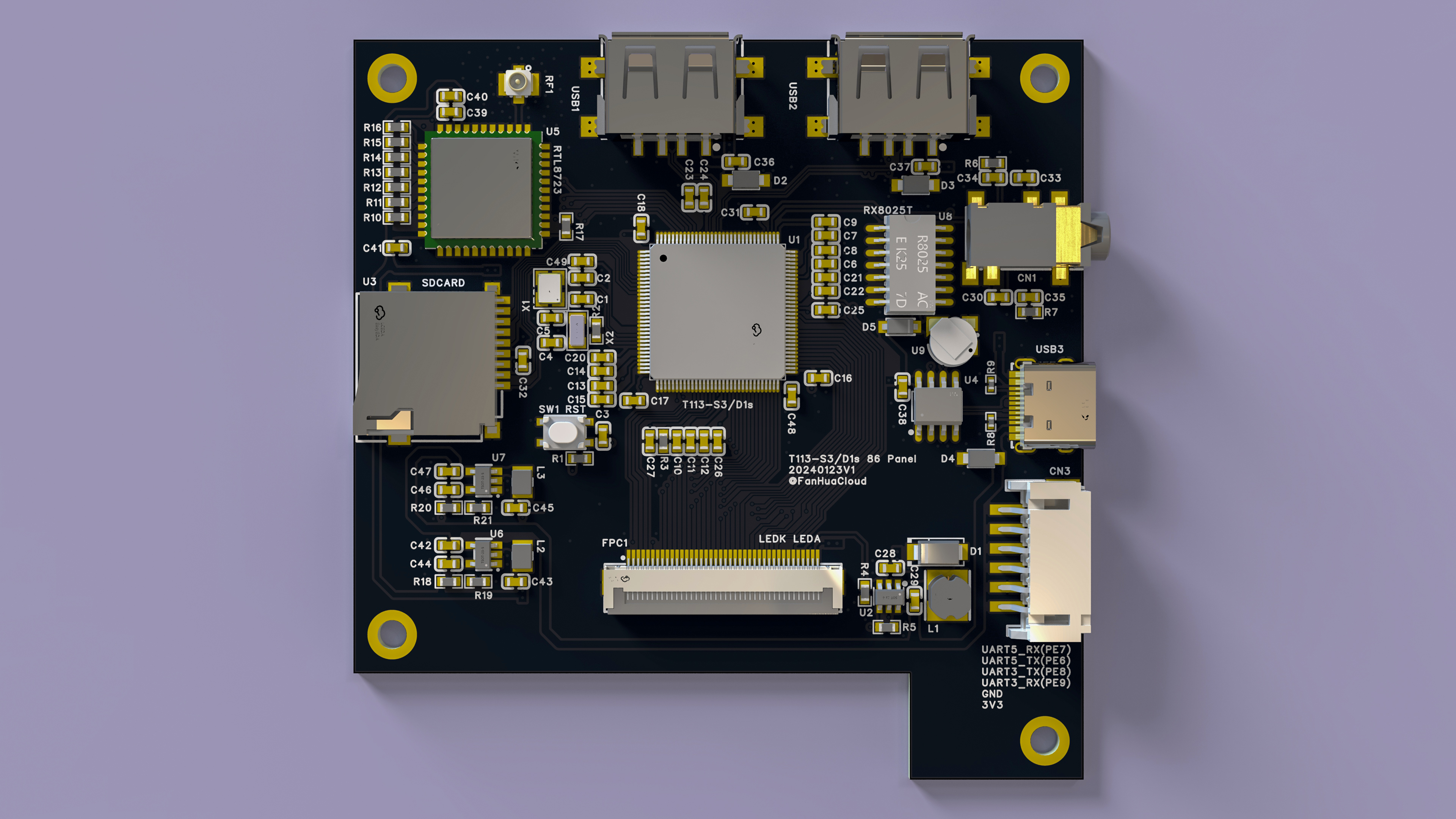

Hardware
Cost: PCB board 58 RMB + screen 69 RMB, approximately 127 RMB;
Main controller chip: T113-S3 (can be replaced by D1s)
; WIFI module: RTL8723BS (planned to be replaced by RTL8723DS);
RTC chip: RX8025T-UB/UC (driver has some issues, Tina-Linux is not currently supported);
Serial to USB: CH340N
SPI NAND: W25N01G (not yet tested)
Backlight Driver: RY3730
chip Power Supply: SY8089AAAC
Screen: ST7701 86-inch screen with RGB interface, 480x480

Mass production precautions

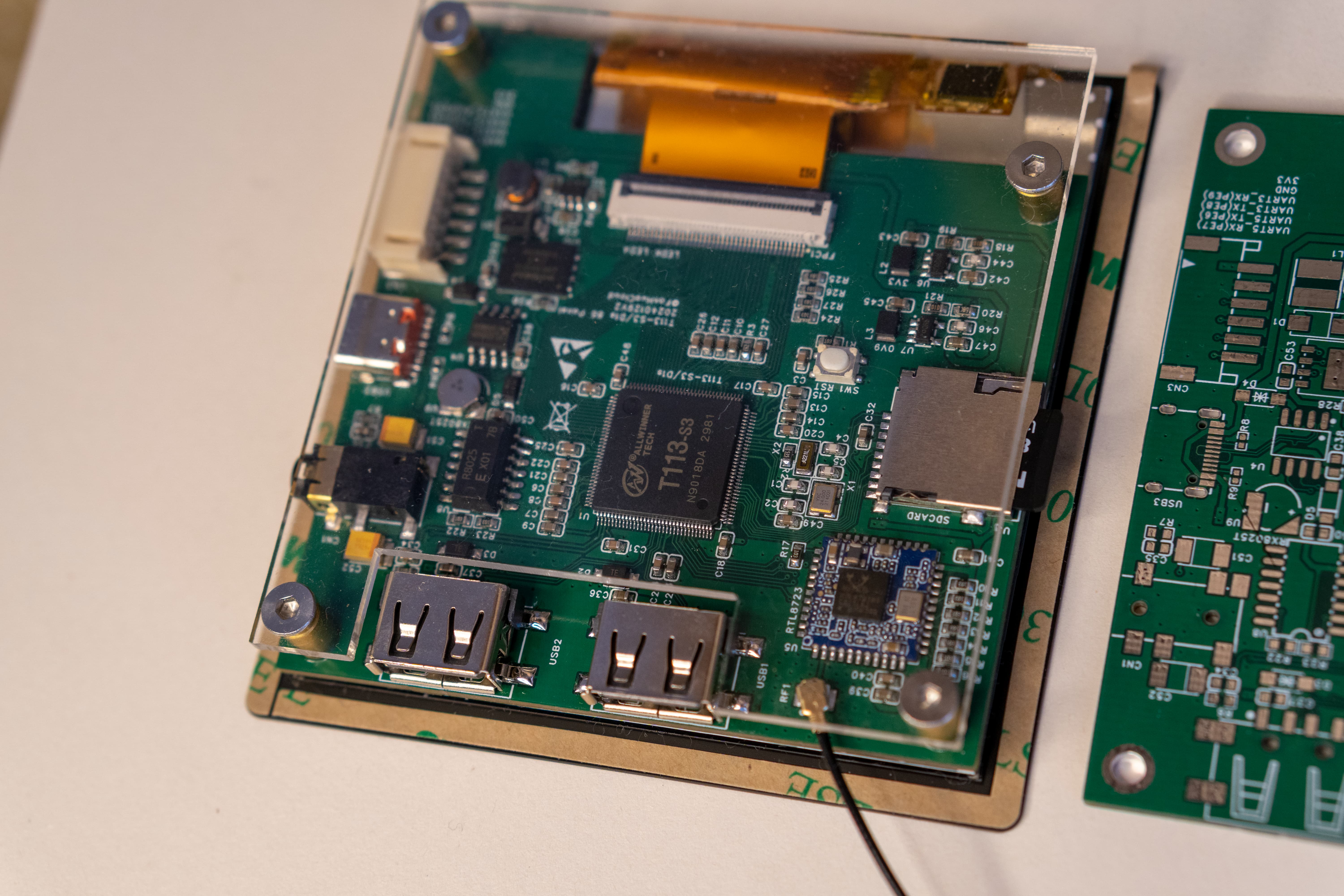

RTC
There are currently software compatibility issues with the RX8025T. For hand soldering, use the built-in RTC
soldering tool on the T113-S3

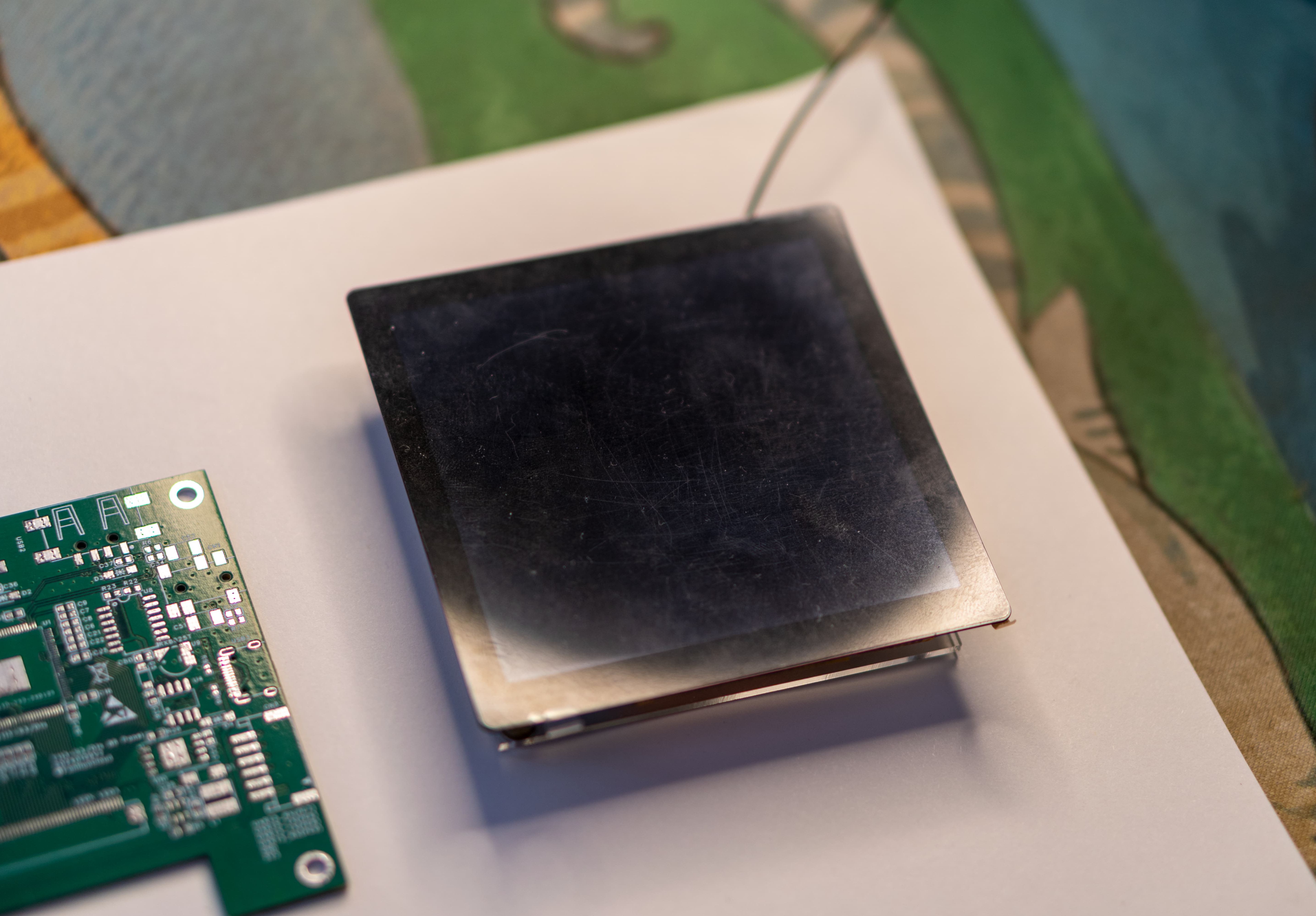

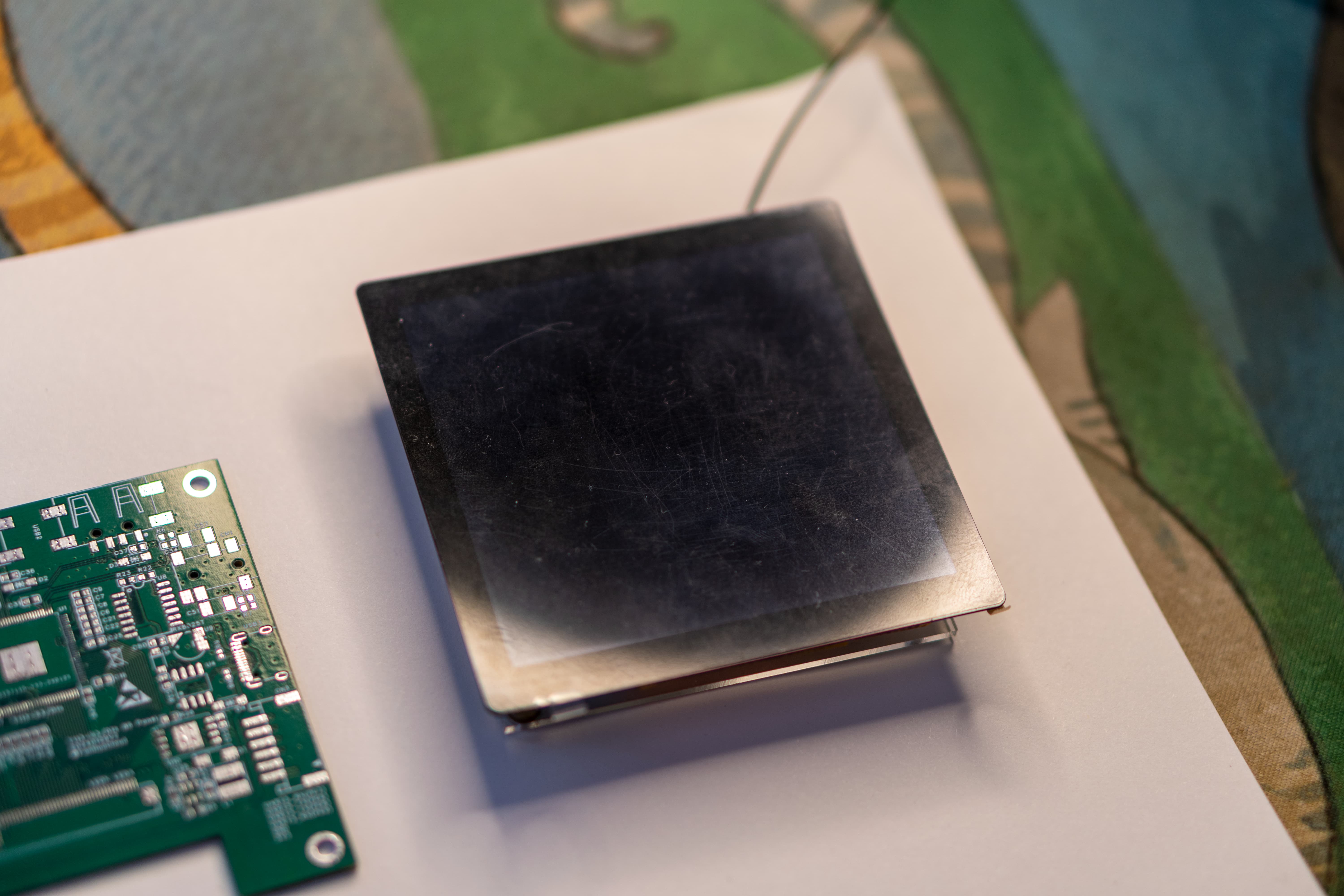

to solder the copper pillars. Apply solder paste around the screw holes, then heat with a hot air gun or heating pad. For
the acrylic backplate
, select "Backplate" PCB, export only the mechanical layers, and send it to Taobao for cutting. For

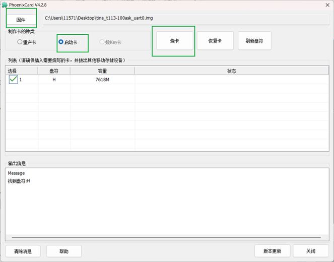

firmware testing , use
an SD card. For the RTL8723BS Wi-Fi: please refer to the attached tina_t113-86_uart0.img
firmware. To burn the firmware
, insert the SD card into your computer, open PhoenixCard.exe, click "Firmware," load the img firmware, select the boot card, and then click "Burn Card." Note that you must select the boot card; otherwise, the boot process will fail!
SDK development
reference: Refer to the documentation below

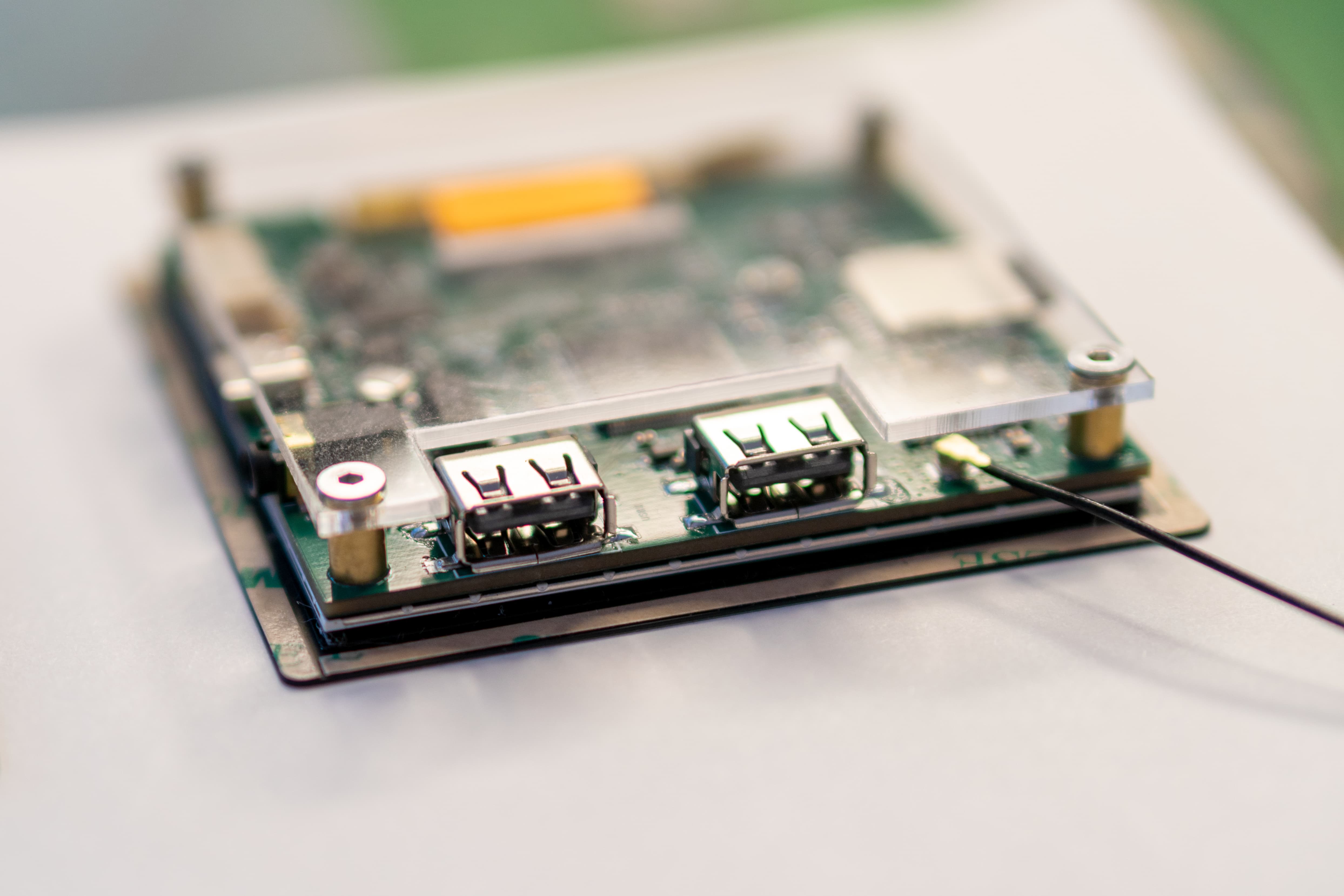

for assembly.
Use M3*5 screws (hex socket screws are recommended as they are less prone to stripping). Simply screw on the acrylic backplate.
Use double-sided tape for the screen; 3M 4229P double-sided tape (5mm wide) is recommended.
