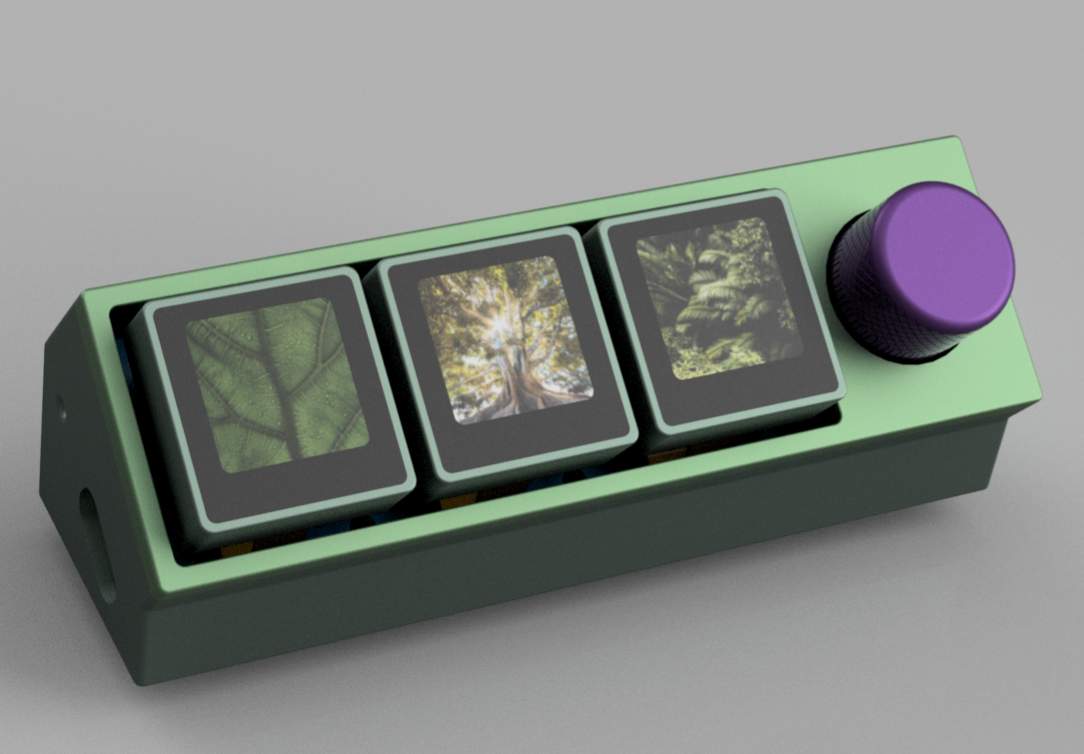

Multi-functional Macro Keyboard 3 Plus [V2 Version]
The older version V2 of Information
primarily addressed previous issues:
it adopted a 0.85-inch TFT color screen, abandoning the original OLED, avoiding screen burn-in,
reducing screen costs and procurement difficulties, and
decreasing the number of boards required. Currently, only one board needs to be prototyped, with
the PCB size controlled within 10x10mm and using
a 0603 package. Soldering is user-friendly.
