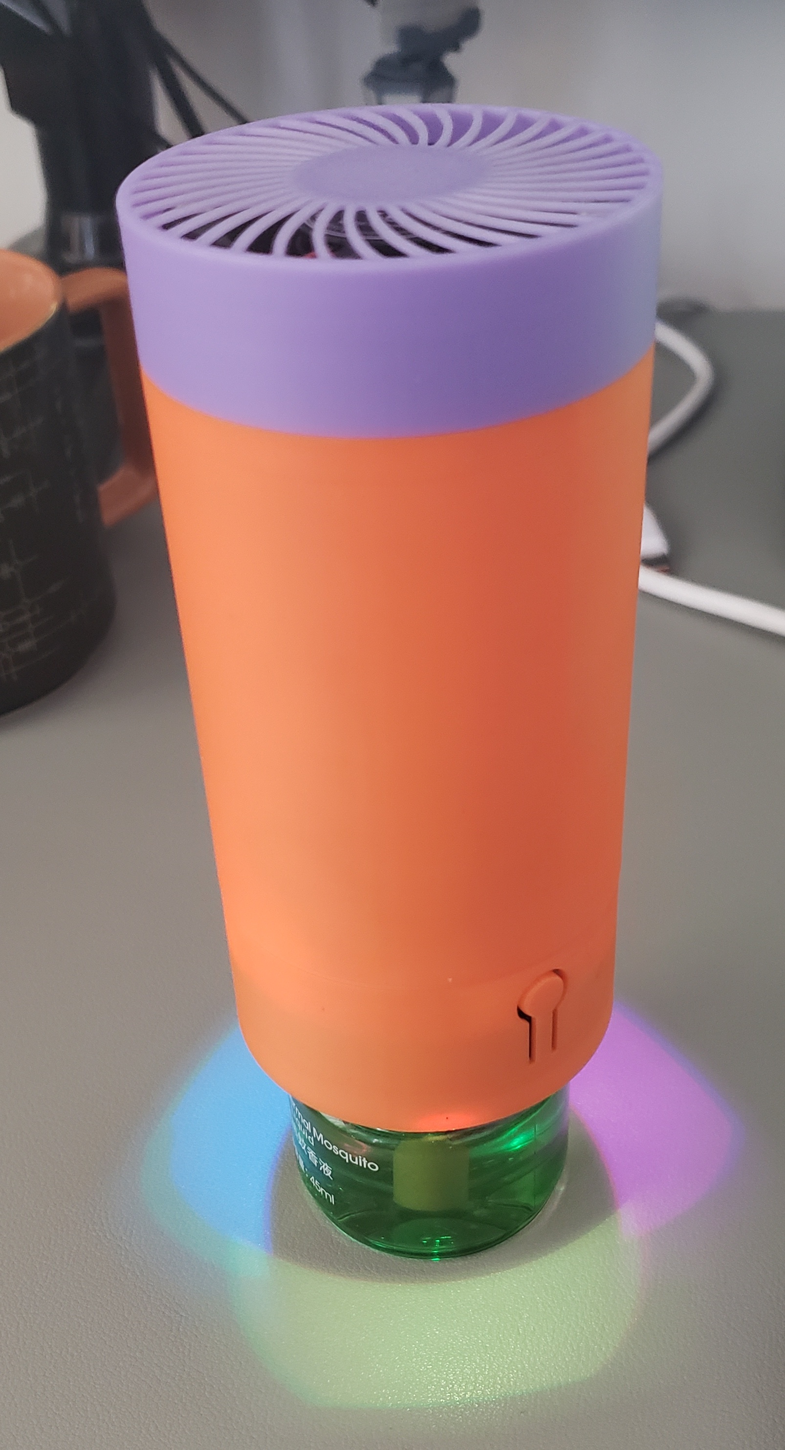

Currently, it has a built-in 18650 lithium battery. This portable mosquito repellent
uses a fan to evaporate the mosquito repellent liquid.
When not in use, it can be unscrewed and used as a night light or small fan. It currently has three fan speed settings, which can be modified by the user.

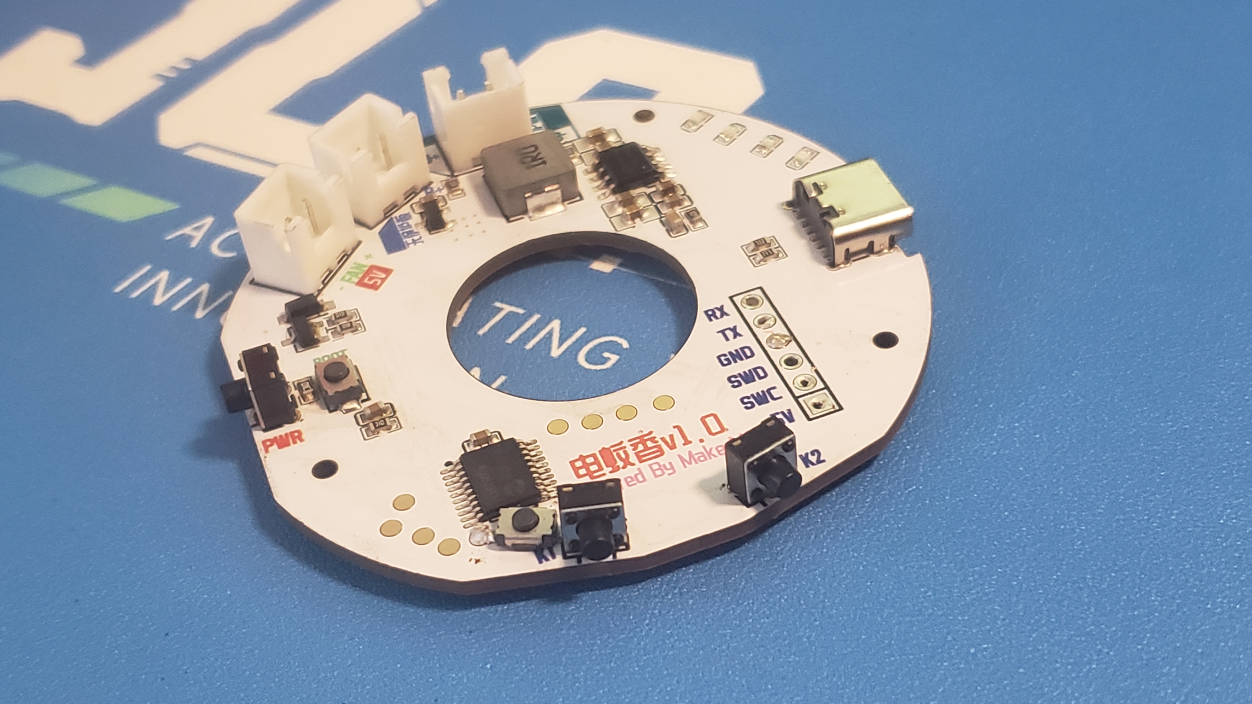

, or via an emulator. The board has pre-reserved ports. The main
hardware
controller is the Heze Air001, which is relatively inexpensive, supports Arduino development, and requires fewer external components.
The charging chip is an IP5306, used to charge the 18650 lithium battery and provide main power to the system
. The fan is a 4010 fan controlled by PWM.
Power
buttons: double-click to power off, single-click to power on.
Button 1: Fan control, three-stage, short press.
Button 2: Lighting effect, short press
effect
. Due to limited testing time and varying mosquito numbers, no mosquito bites were observed during testing.
Further testing is pending feedback.

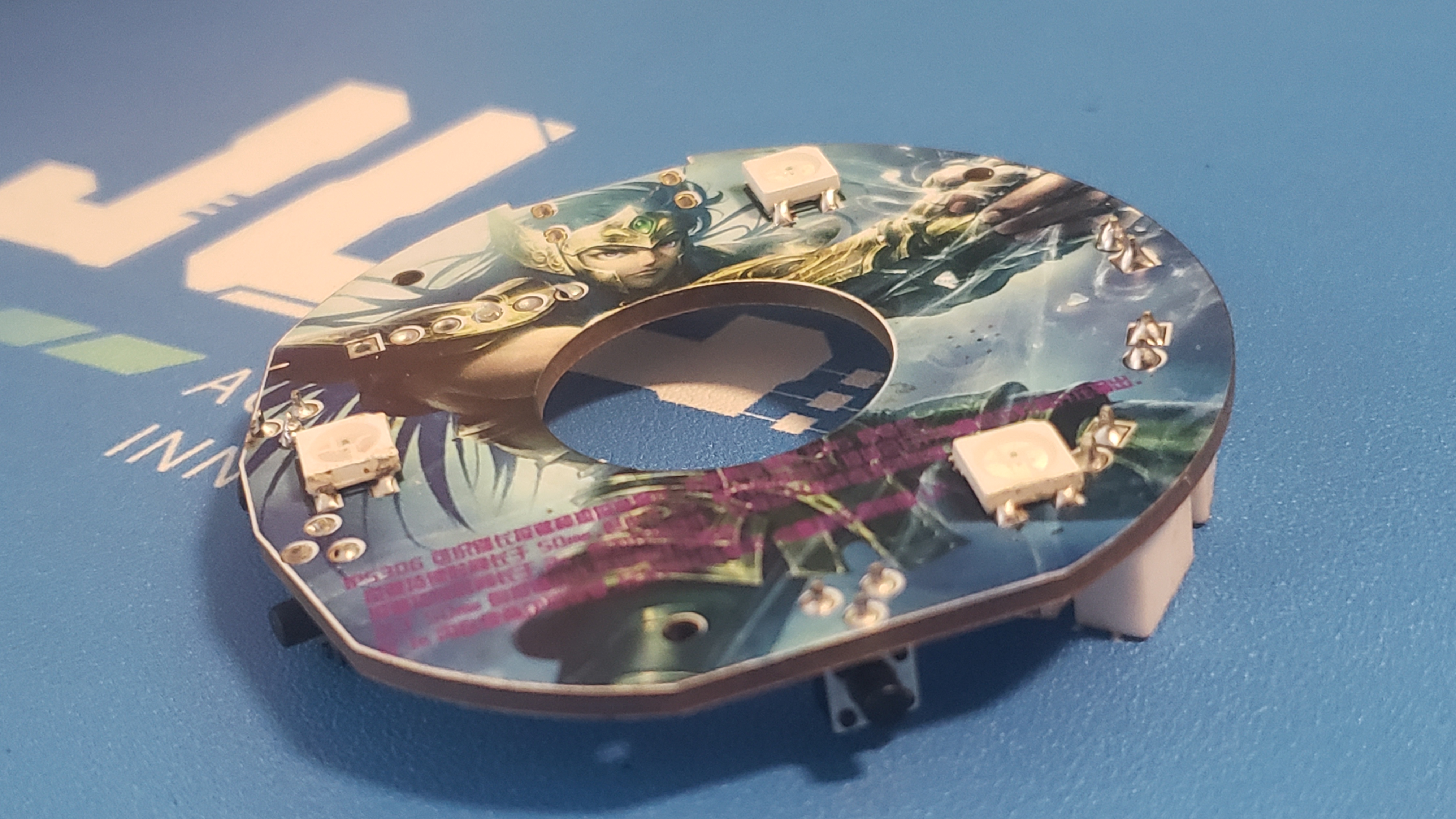

PCB layout.
1.6mm thickness,
latest version: v1.1.
Note: There are two 18650 sockets on the board; choose one as needed. One is for 18650 batteries with a protection board, and the other is for batteries without a protection board.
Pay attention to the positive and negative terminals of the battery and fan; do not reverse them.
