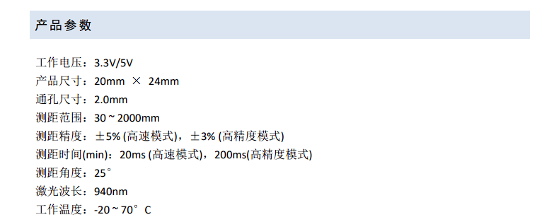

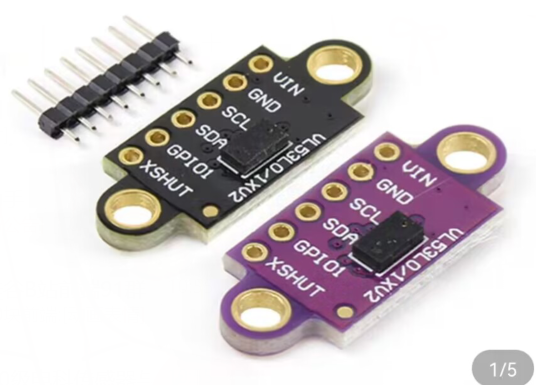

a generic installation guide for ranging modules available on Taobao, priced around ten yuan. They are typically VL53LXX series and use the I2C protocol. Users can modify the layout for their own ranging modules.
I used the VL53L0X, and there are many other different sensors available, generally with distances between 50 and 5000mm.
