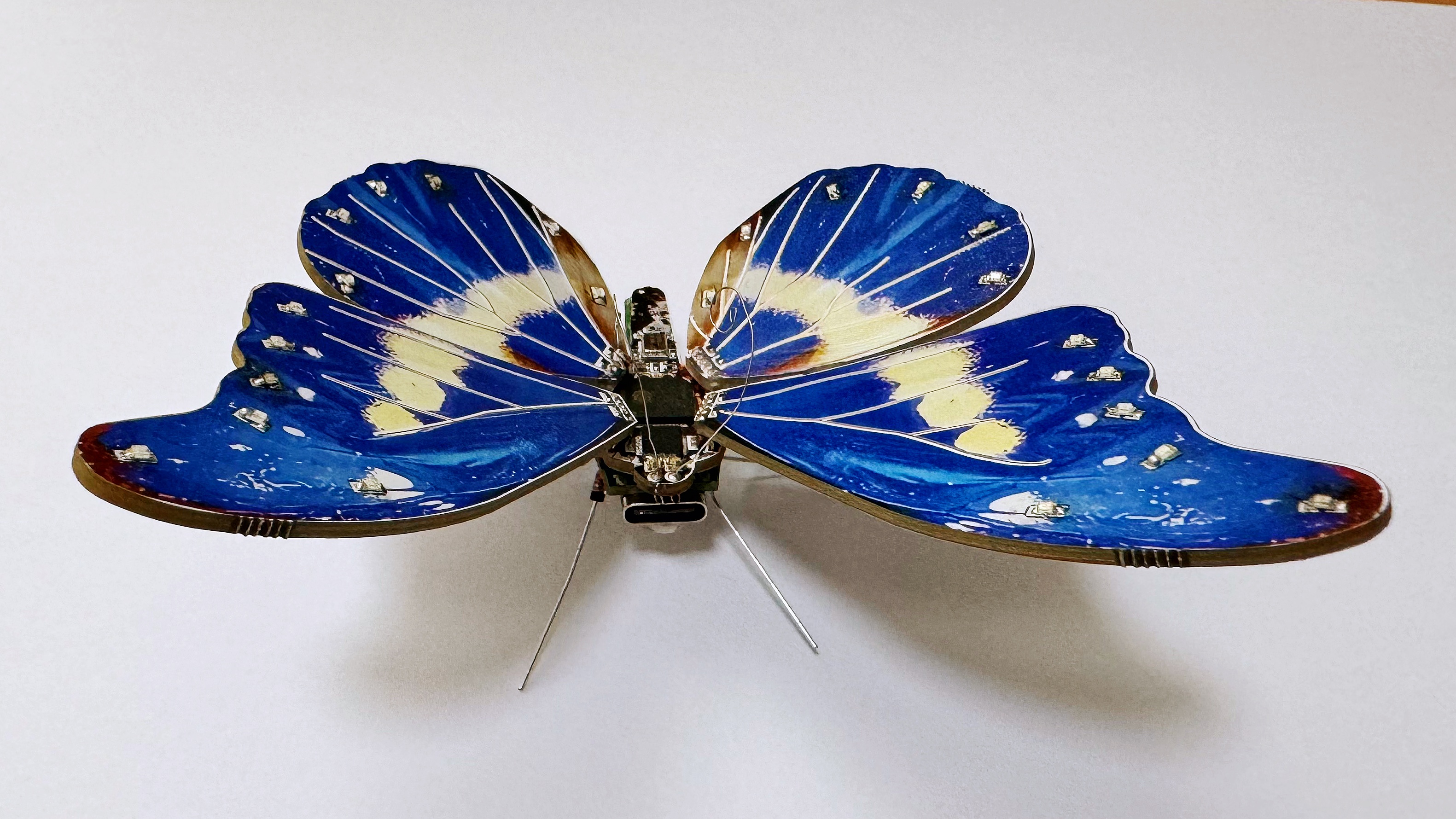

Added a two-layer PCB
and added code testing. Project
: This project's PCB is based on Xiaojunxi's

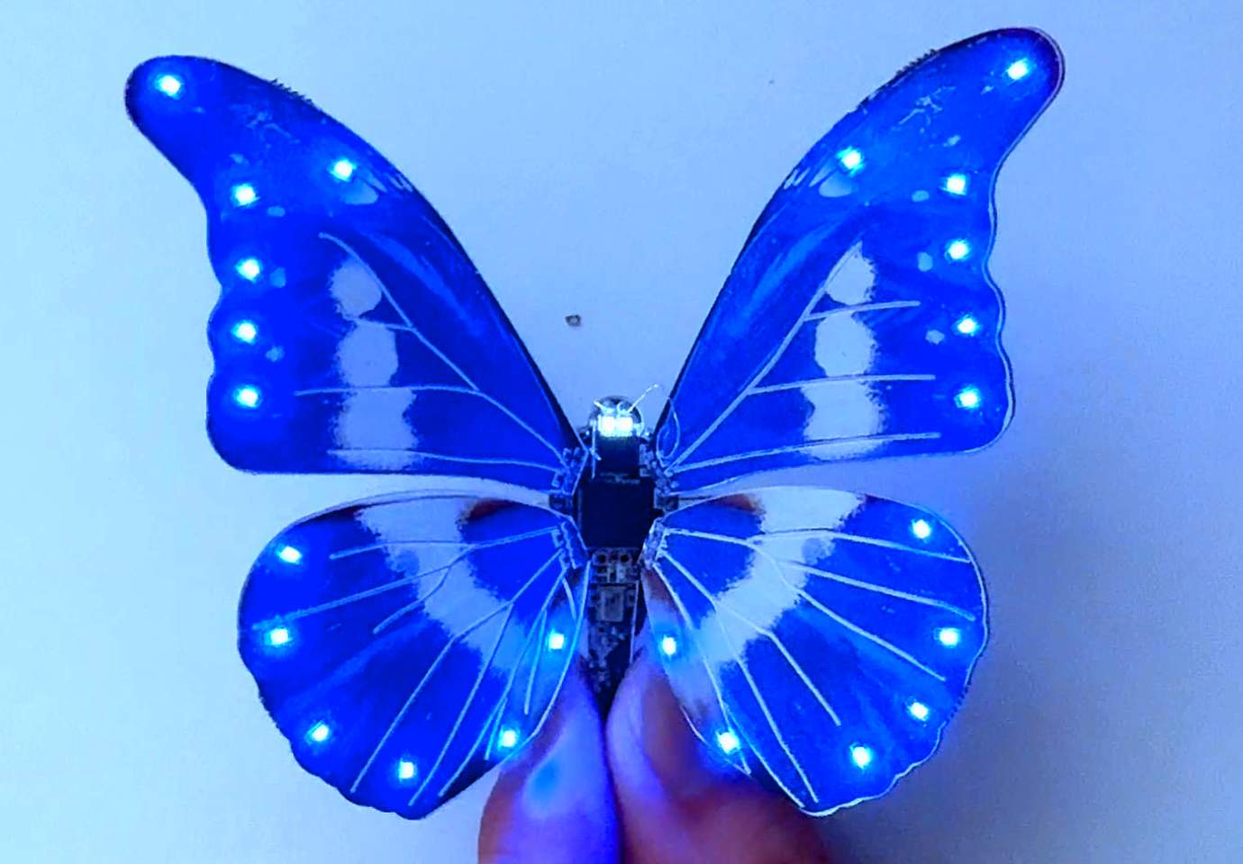

"Butterfly Goddess," with minor modifications to the original version, adding battery power, Wi-Fi wireless control, voice recognition, vibration sensing, and Touch control.
The design concept aims to simulate biological characteristics as closely as possible. The brain part uses an ESP32-S3 to process information, while the cerebellum part utilizes an MPU 6050 to sense vibrations. The project simulates biological morphology, using the antenna as the "mouthparts" and featuring an "abdomen" energy storage unit. The entire development board is symmetrically laid out around the center.

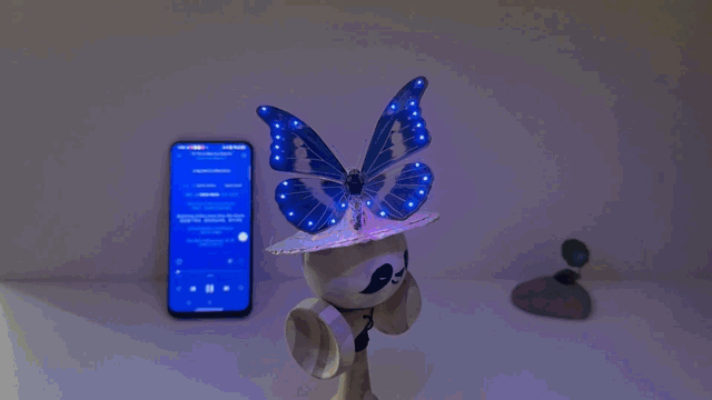

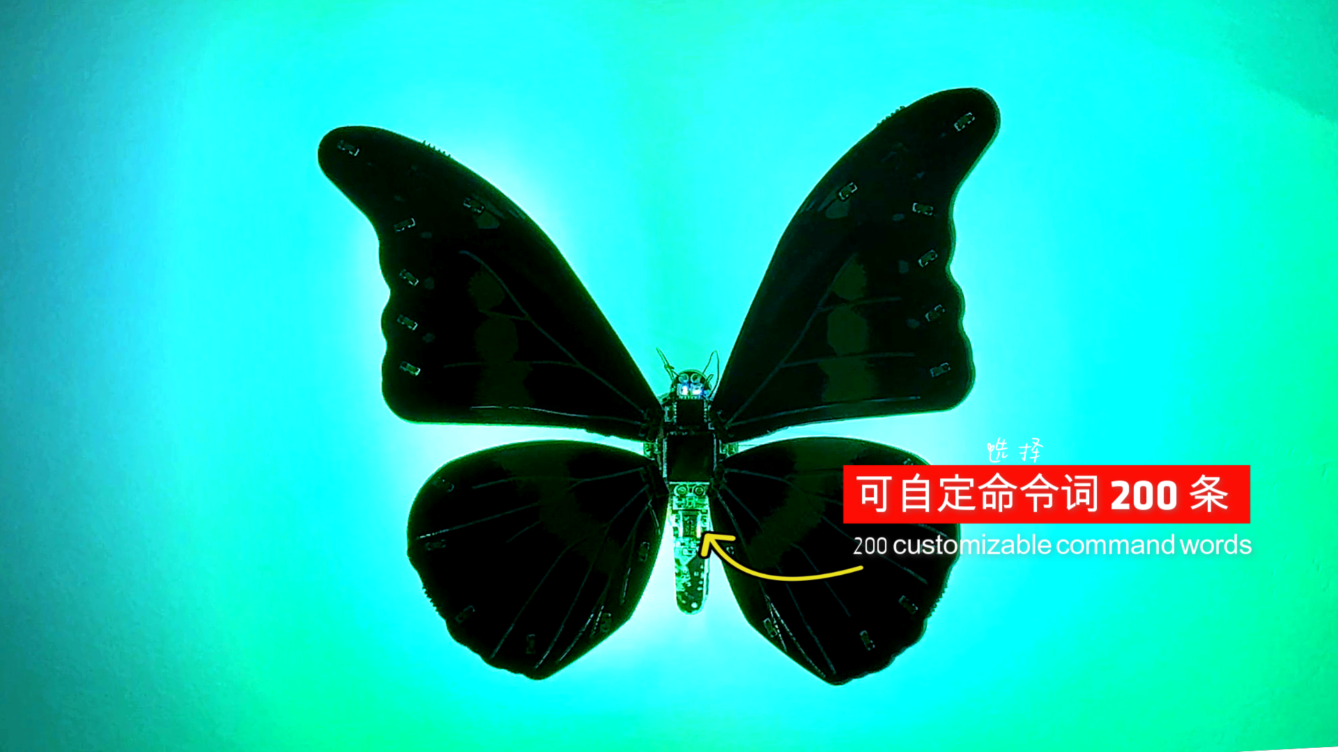

This project supports multiple modes, including light mode, music rhythm mode, remote control mode, and sensor mode. Users can switch between different modes via voice commands, and the current mode is displayed by the "eye" indicator light.
Light Mode:
Mode selection: "Light Mode", "Night Light Mode"
Mode indication: Eye indicator light is white
Voice Control: Includes turning the light on/off, adjusting the light color (white, red, green, blue) and brightness, as well as special "blinking" commands

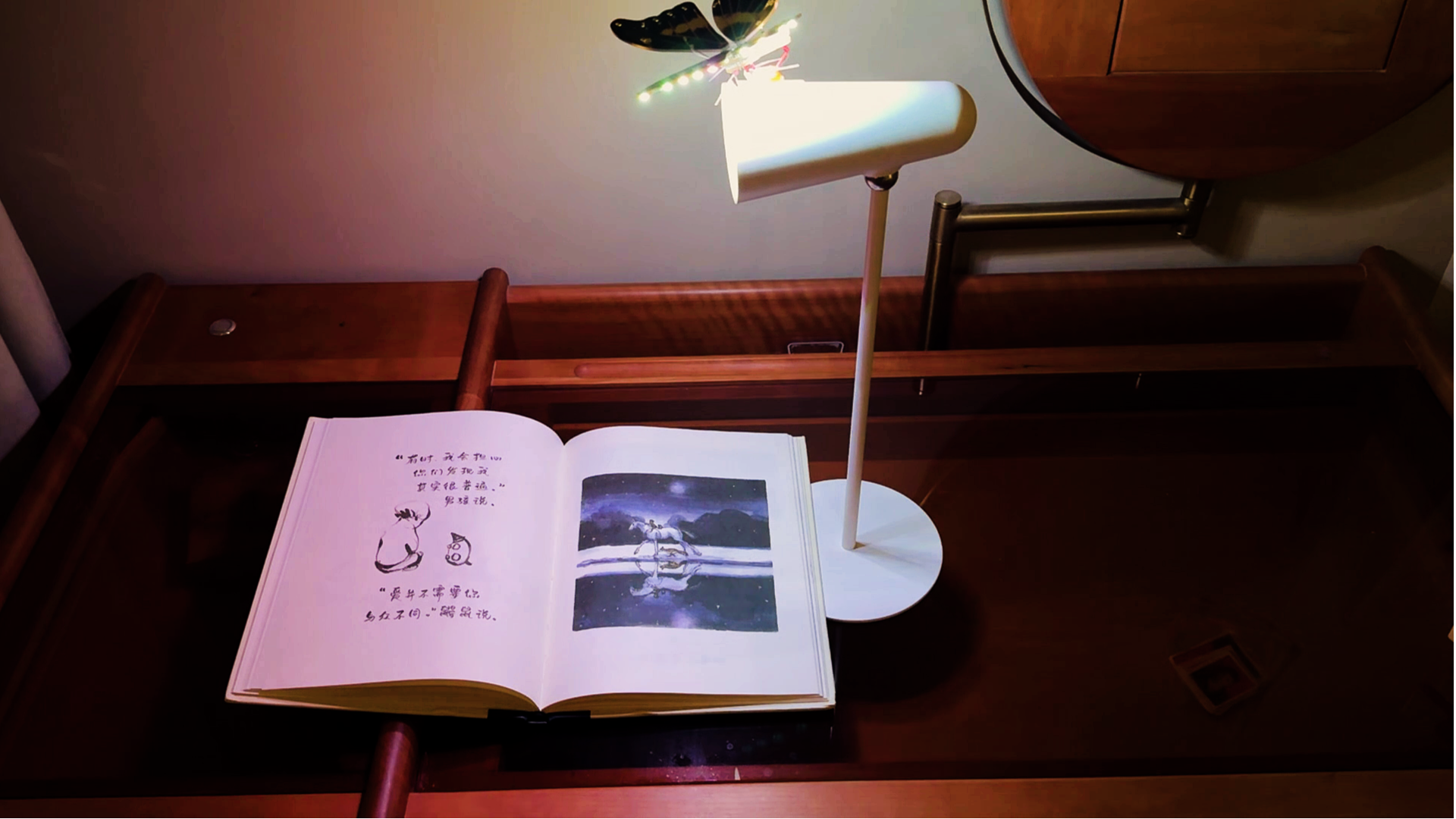

Small desk lamp: Automatically turns the light on/off based on the angle detected by the MPU6050.
Horizontal light on,
vertical light off
. Tapping to turn on: Uses the MPU6050 to detect the tapping acceleration to control the light.
Gently tap to switch between turning on and off.
Strongly tap to turn on the light. No further tapping to turn off the light was detected within seconds.

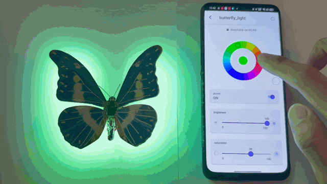

Mobile control: Controls the hue, saturation, and brightness of the light via the App.

Function description: Connects to Home Assistant, linking with smart devices in the home such as Mijia, Midea, Tuya, and Apple.
Four wings are equivalent to four switches, which can link four different smart devices respectively.
Controls air conditioners, washing machines, bathroom heaters, etc. via voice commands.

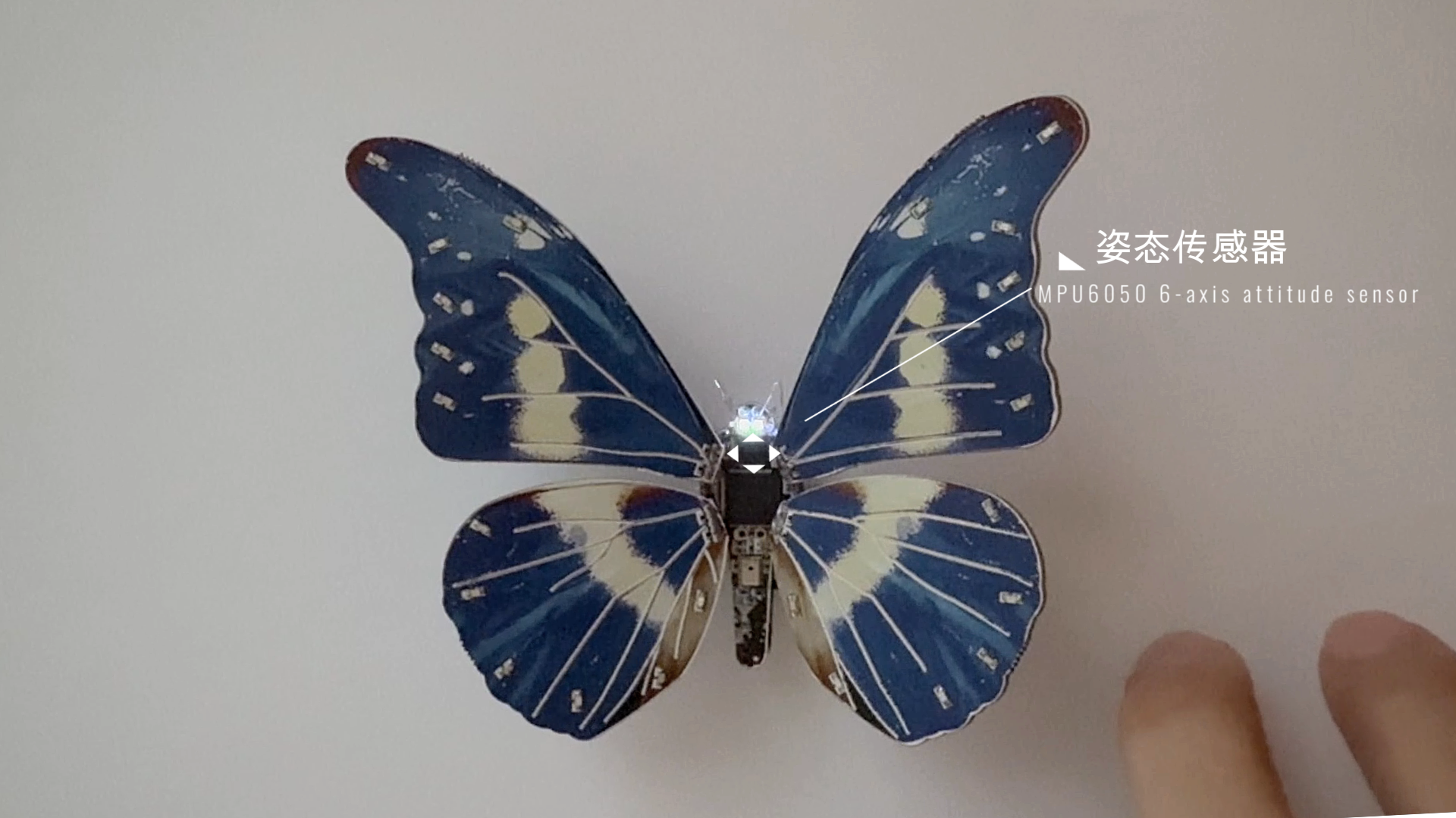

Vibration sensor: Detects vibration, drop, and tilt via MPU6050, linking with smart home devices.

wake-up words (modifiable, supporting multiple wake-up words such as "Hello Xiaozhi," "Xiao Ai Tongxue," "Hi," and "Lexin"), and wake- up
-free operation (wake-up is triggered by vibration, drop, tilting, or wings being pinched )
. Continuous recognition allows for continuous recognition after being woken up, without needing to be woken up again
. Command words support up to 200 custom command words for a single control command. Power

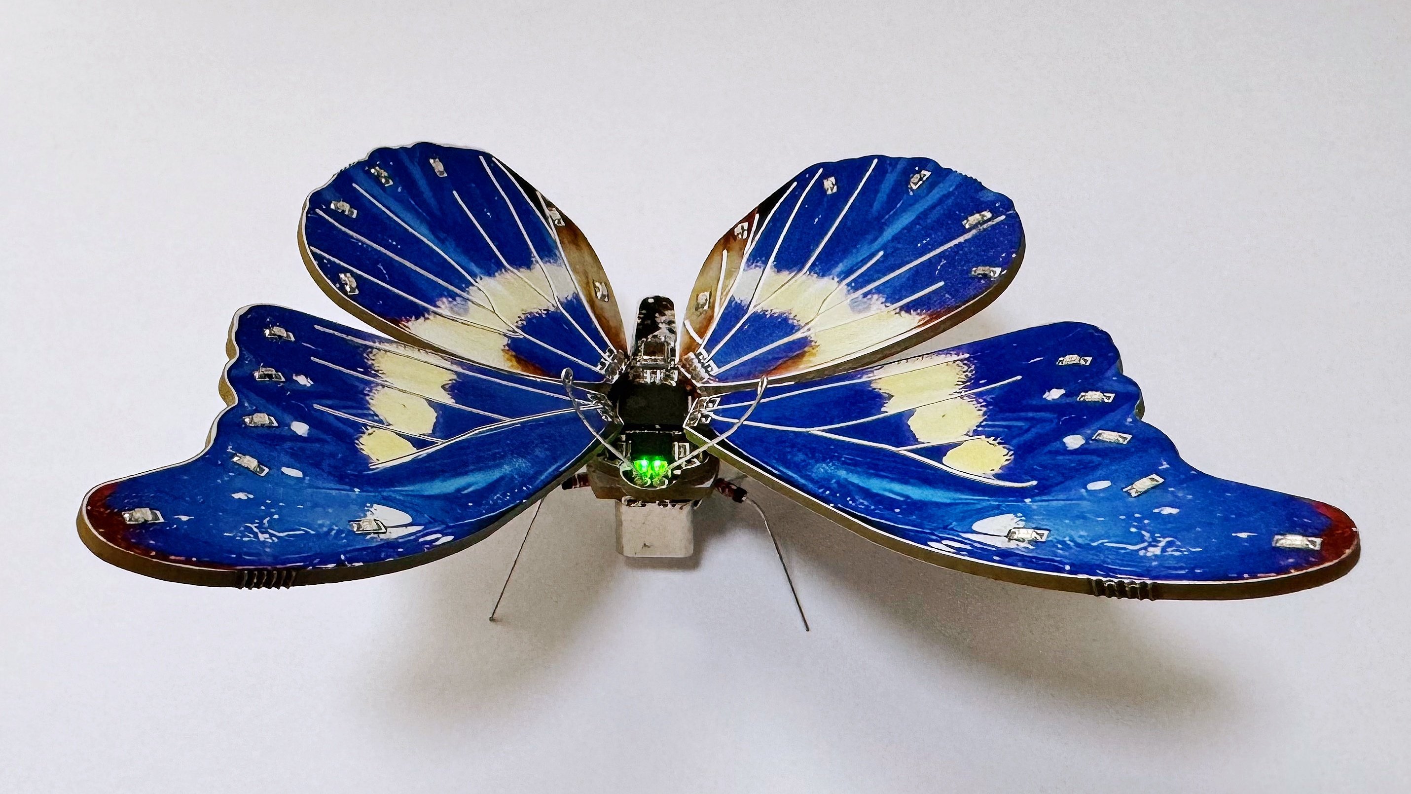

Male butterflies use a Type-C male charging port for direct charging with a mobile phone .
Female butterflies use a Type-C female charging port and support magnetic charging when attached to the Haotian Hammer.
To ensure the Morpho butterfly's complete lifespan, it supports a low-power mode, activated via the MPU6050.
Replication Notes
: This component is difficult to solder and not suitable for beginners. Due to PCB size limitations, most components are in 0402 packages, especially the ESP32-S3-PICO-1. Solder pins are on the back of the chip, resulting in an extremely low soldering success rate
. The four-layer board version cannot be color printed: Due to manufacturing limitations, LCSC's process does not support color printing on four-layer boards
. It's best to use a stencil; otherwise, soldering failure is very likely.
