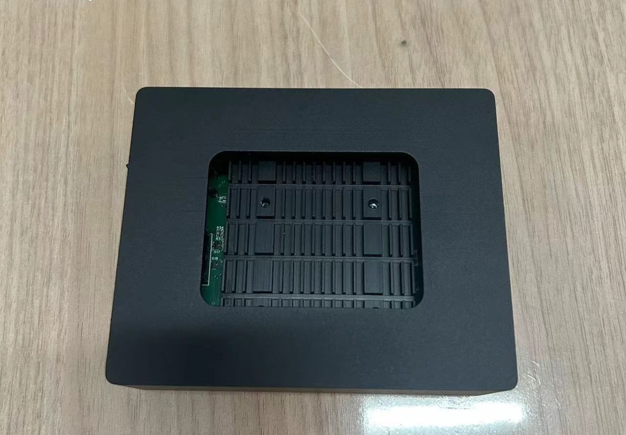

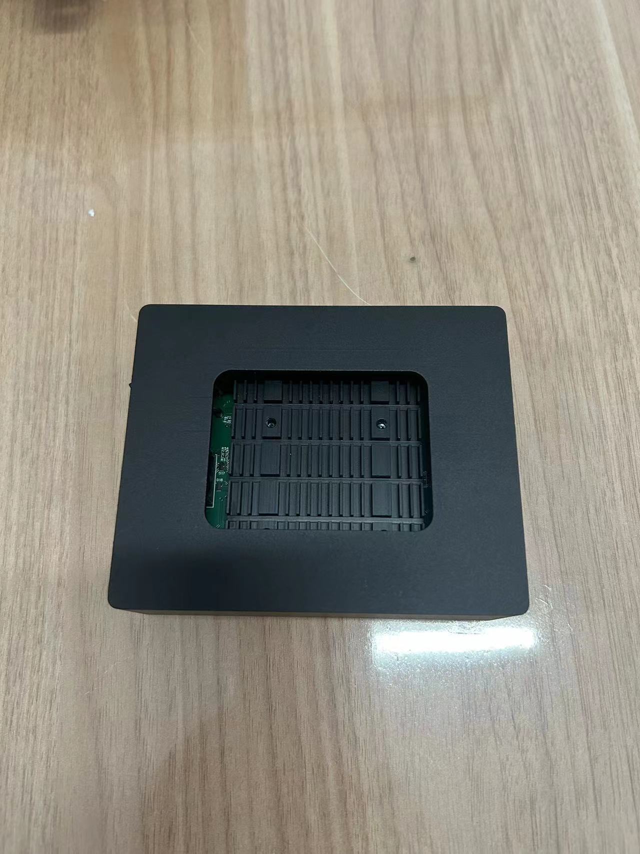

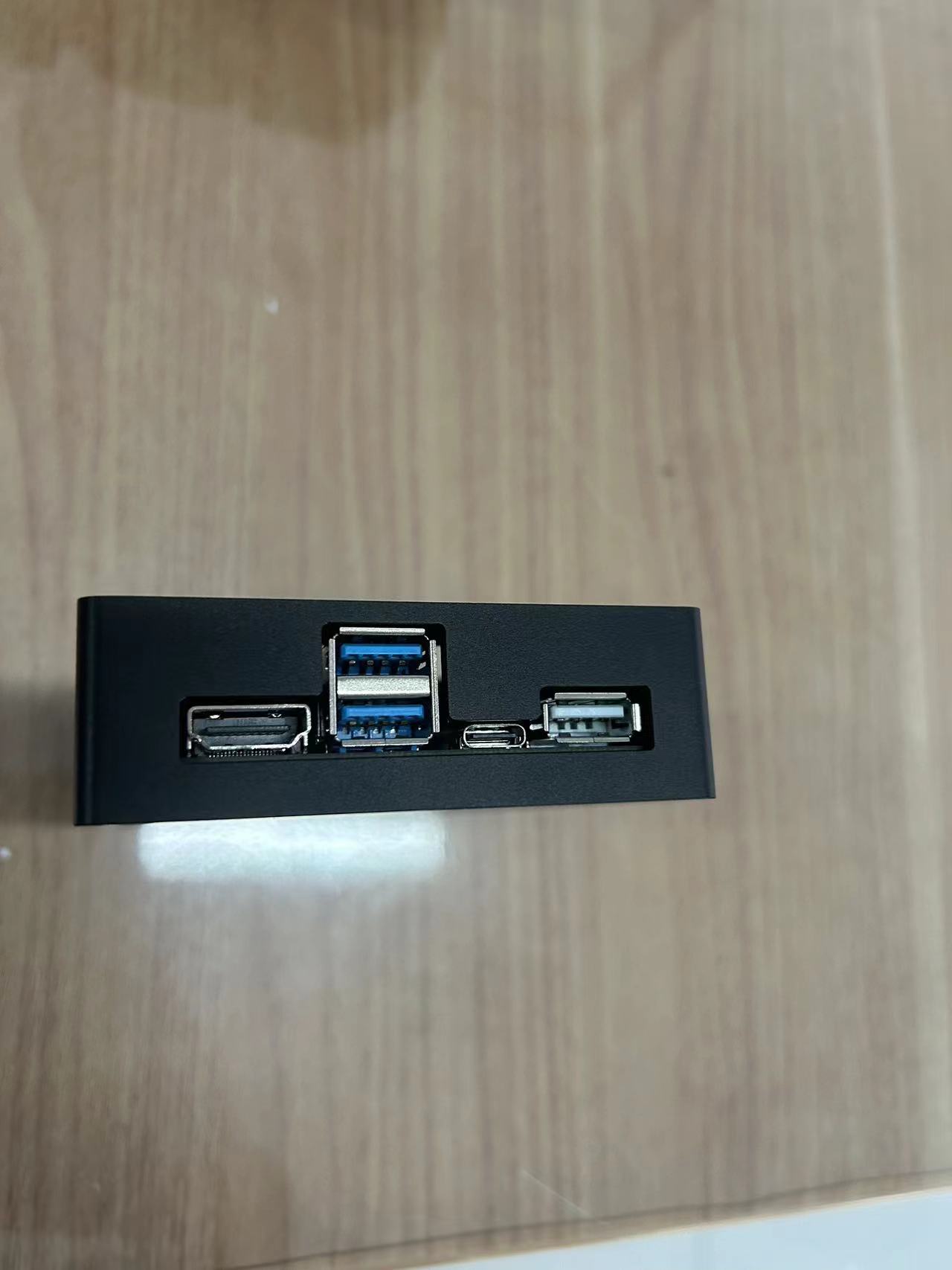

Project Description: This project
uses the RK3588 core board and a custom-made mini-PC chassis. It includes one HDMI port, two USB 3.0 ports, one USB 2.0 port, one 2.5G Ethernet port, and one DC power connector. The circuit board is compressed to 80mm × 100mm, and the overall device is compressed to within 100mm × 120mm × 50mm.
Open Source License:
This project is open source; please indicate the source when reprinting.

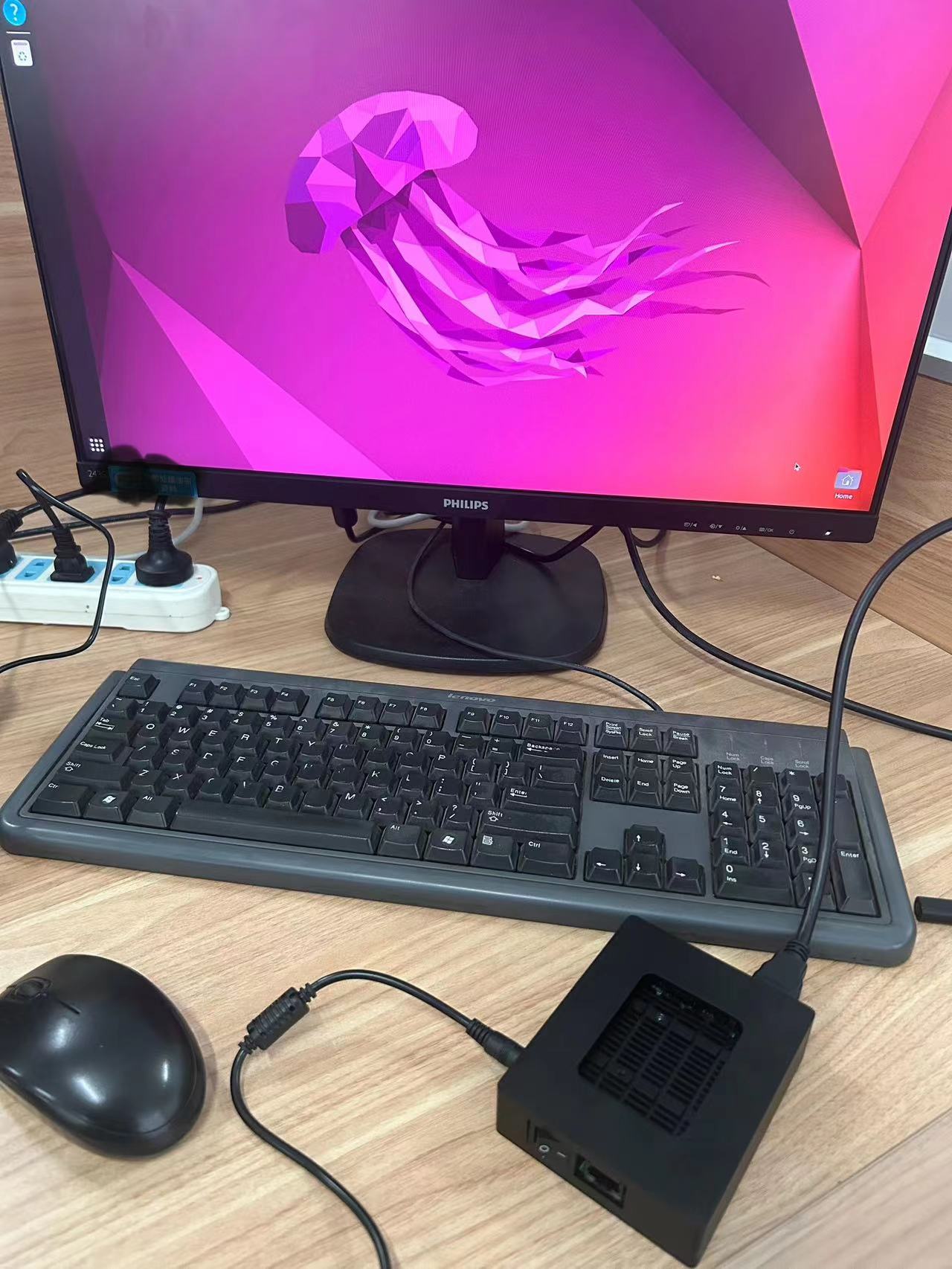

Project Functionality: This
project implements a palm-sized Ubuntu 22.04 host with approximately 6 TOPS of performance. It can connect to an external keyboard and mouse, and connect to the network for light office work.

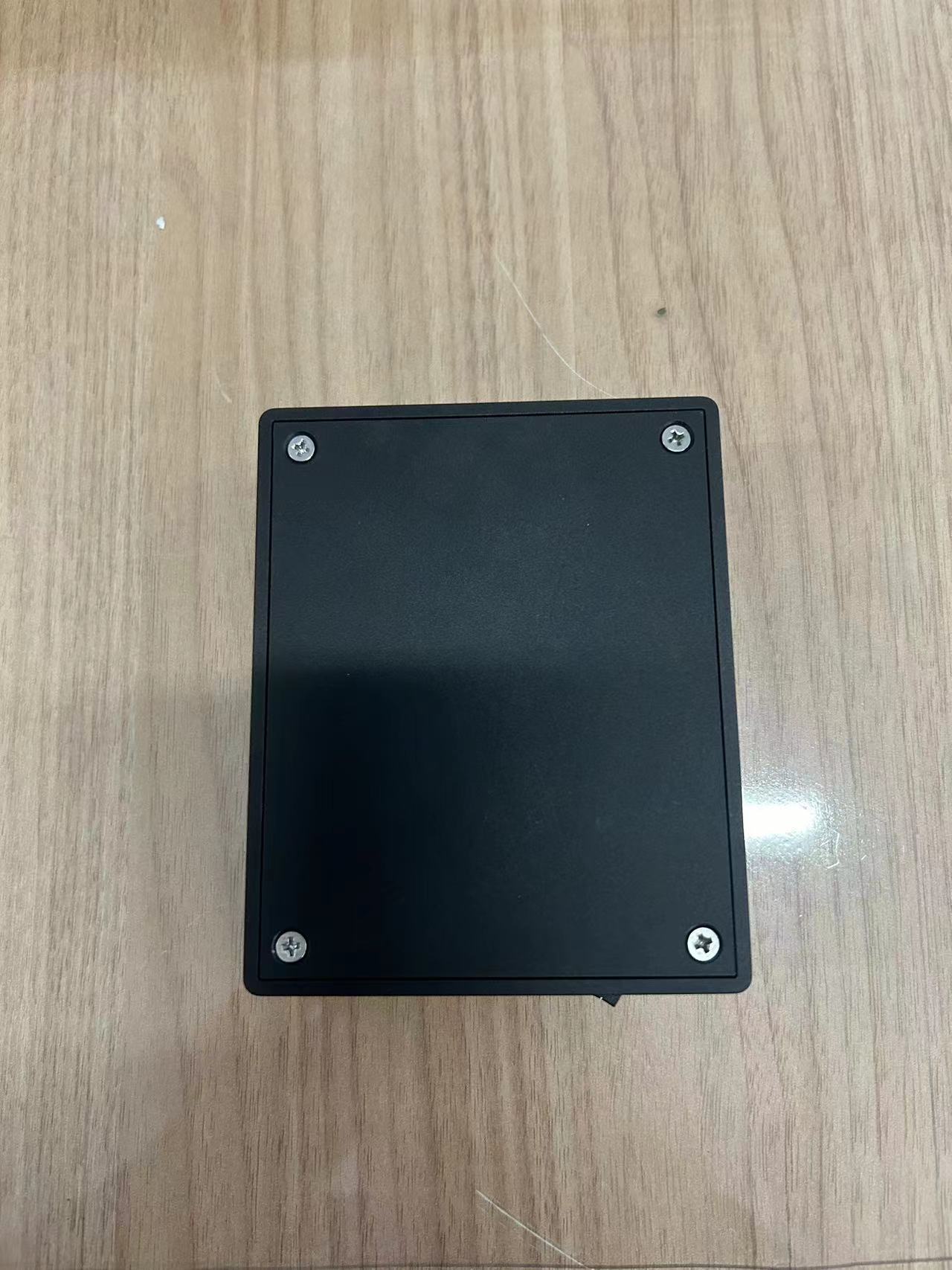

April 25, 2024: Casing fabrication and installation completed, physical product and power-on test video attached;

8. Use a double-layer USB 3.0 socket to trade vertical space for board area;

Software Note:
The firmware device tree needs to be trimmed, otherwise the RK3588 will get stuck at the PCIE clock detection part during boot. You need to download the official RK3588 Ubuntu 22.04 source code, open the device tree file and modify it.
1. In the kernel-rockchip/arch/arm64/boot/dts/rockchip folder: Modify rk3588-nanopi6-common.dtsi and set the PCIe related nodes to disable; 2. In the kernel-rockchip/arch/arm64/boot/dts/rockchip folder: Modify rk3588-nanopi6-rev09.dts and set the PCIe, hdmi1, and hdmirx related nodes to disable; The
device tree adaptation code file is attached. It can be further modified according to your hardware. In actual testing, after modification, Ubuntu 22.04 boots within 10 seconds;
Physical demonstration

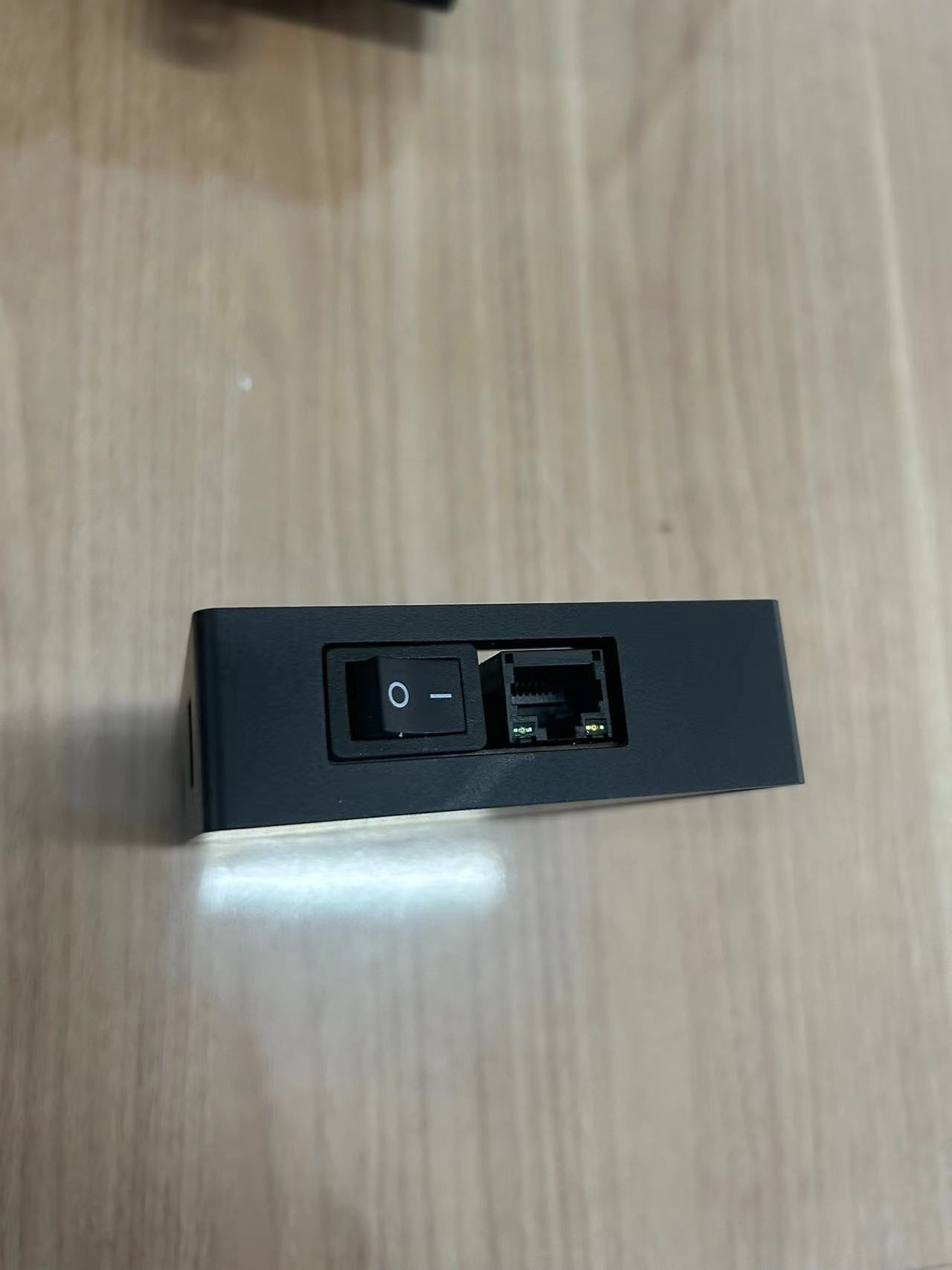

## Hardware 1. Power input section Q2 1. The MOSFET was incorrectly connected, causing a short circuit and burning out after power-on. Q2 was removed. 2. VDC power-on mode control is cumbersome; R19 was removed to configure direct power-on mode. 3. The casing design, prioritizing aesthetics, did not include mounting notches for the power switch and RJ45 socket. These need to be removed during installation, and then soldered back on after the casing is reassembled.
