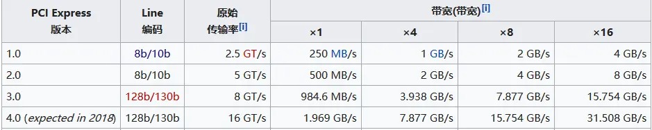

In short, PCI-E is a computer internal interconnect bus standard proposed by Intel in 2001 to replace the previous PCI and AGP. Its characteristics include serial operation (previous ISA, PCI, AGP, etc., were parallel) and support for 1 to 32 lanes (however, the most common and longest is the x16 commonly used on graphics cards), with speeds shown in the table below.

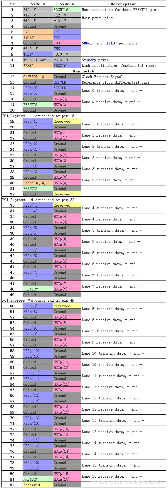

. Pin Function Definitions

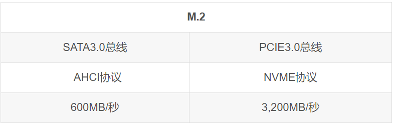

M.2 interface has two bus types: SATA and PCIe. The protocols are AHCI/NVME (Non-Volatile Memory Express), a logical device interface specification.

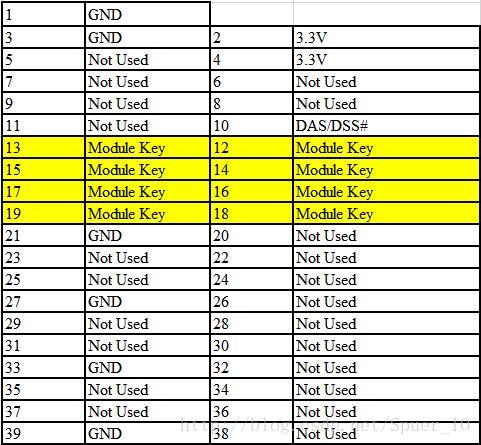

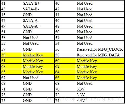

B-Key modules have pin notches located at positions 12-19, providing support for PCIe x2, SATA, USB 3.0, I2C, and HSIC.

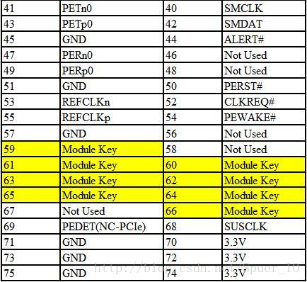

M-Key modules have pin notches located at positions 59-66, providing support for PCIe x4, SATA, and SMBus.
M.2 SSDs are almost always "B & M" key, meaning they have two notches. Configurations supporting SATA or PCIe x2 are called "Socket 2," and configurations supporting PCIe x4 are called "Socket 3."

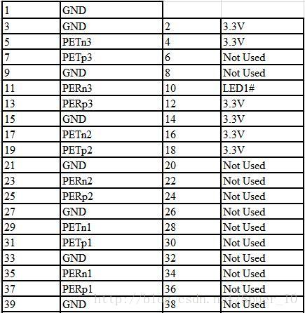

Pin function definitions:
M.2 PCIe SSDs are M-Key;
SATA SSDs include B-Key & M-Key.

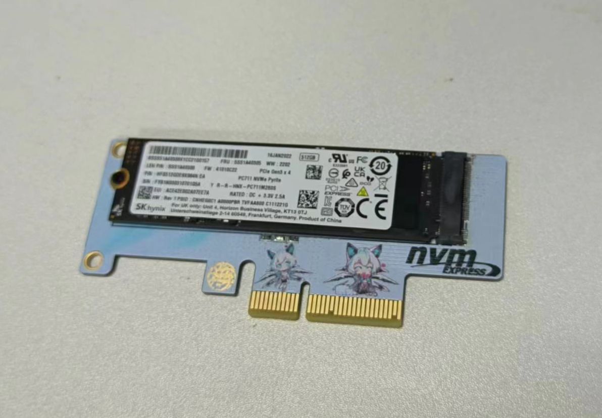

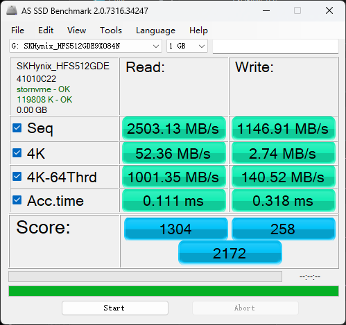

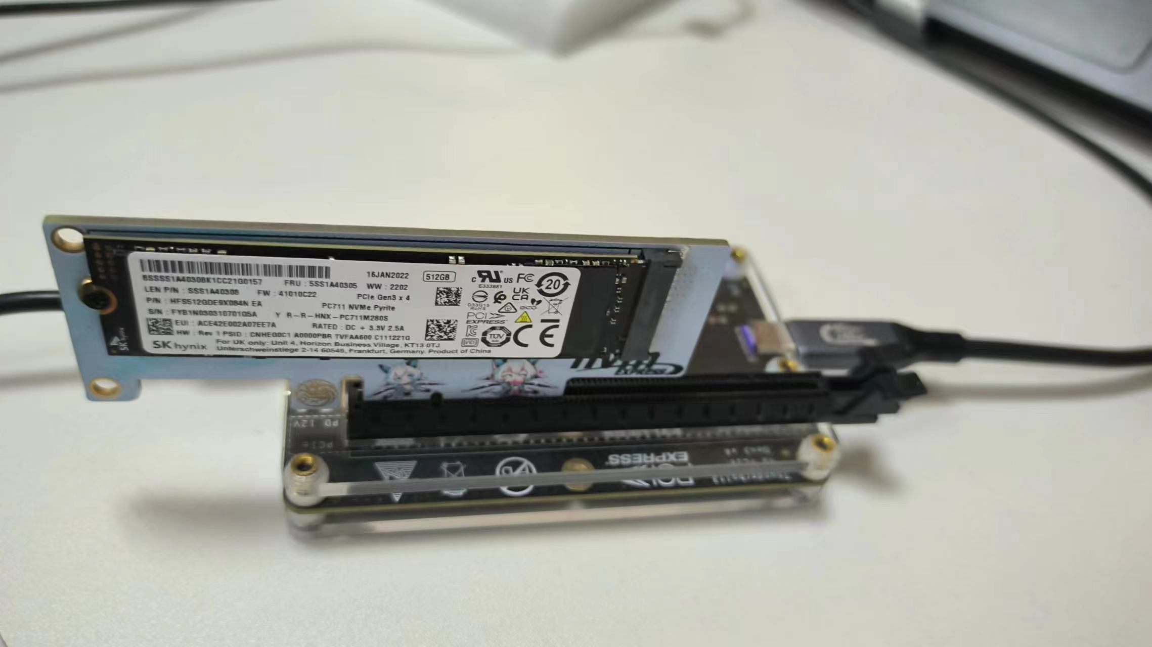

A disassembled laptop hard drive was used as a makeshift solution (currently used as an external hard drive).
The Hynix BC711 (OEM version) 512G (almost full drive)
has slightly slower write speeds, but this is probably due to the full drive being used. The difference compared to the motherboard
's built-in interface is not significant. I'll try it again next time with a spare PCIe 4.0 drive (too lazy to disassemble the system) .
