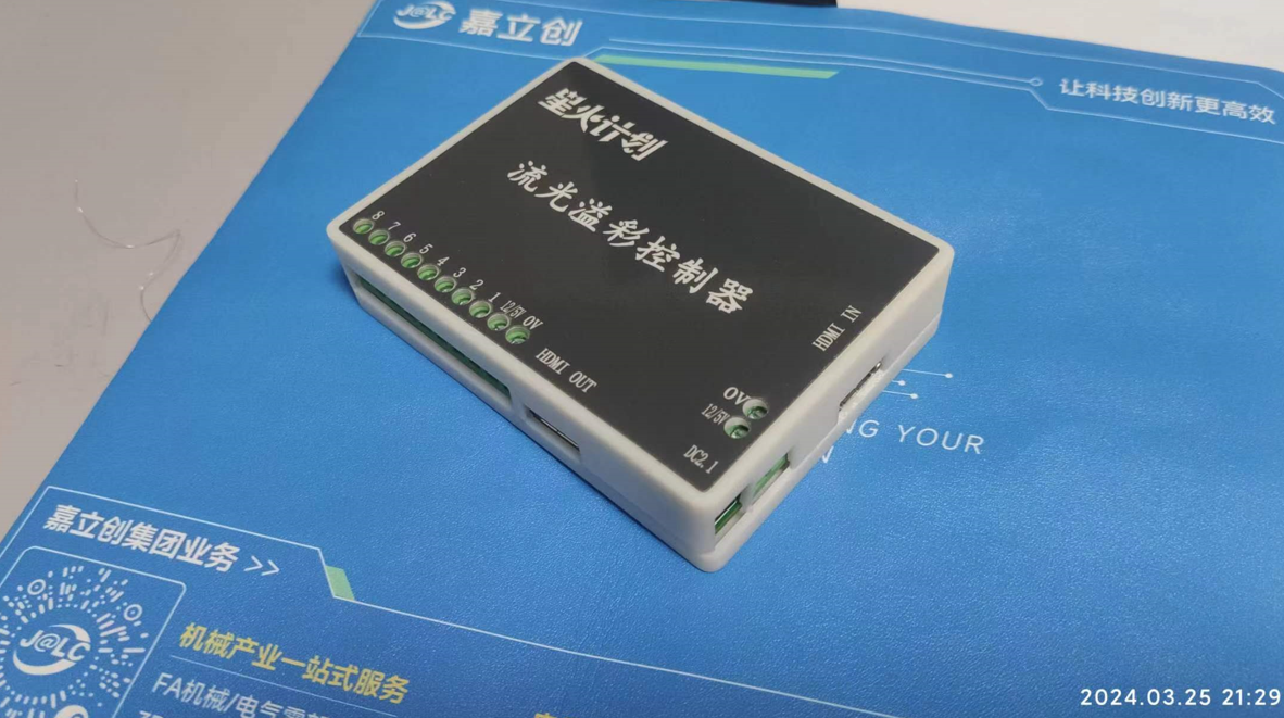

This project describes
a video ambient lighting control system. It controls the color of the LED strip on the TV bezel based on the color of the edges of the video signal, creating a smooth visual transition and an atmosphere where the video content blends seamlessly with the surrounding environment.
Currently, commercially available systems primarily use Philips' Ambilight series TVs and the Hue system. Common open-source projects often involve complex software installations via Raspberry Pi or PC, requiring numerous configuration steps and hardware conversions. Their core principle involves capturing video streams from the network, analyzing and calculating the stream, extracting color information, and finally controlling programmable LEDs via GPIO ports or USB-to-serial adapters. This project's advantage lies in its simple device—requiring only a single controller for plug-and-play operation. The former approach has obvious drawbacks: complex hardware and software configurations, and the sequential processing of the software inevitably leads to a lag between the ambient light color and the video signal generation. This system, implemented using FPGA pure hardware circuitry, eliminates the delay caused by sequential software execution, resulting in a more seamless video ambient lighting experience. The project
is licensed
under the CERN Open Hardware License. Key
features include:

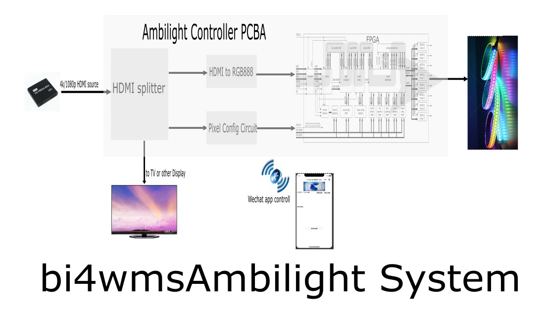

1) Integration of an HDMI 1-to-2 splitter controller, supporting mainstream 1080p and 4K@60Hz refresh rates;
2) Simultaneous support for 8 different LED strip configurations, controllable individually or in a splicing configuration;
3) Standard DC interface or stud terminal block wiring, 5-15V power input, compatible with WS2812 or WS2815 series LED strips;
4) Direct control of LED configuration via WeChat mini-program, adaptable to various application scenarios.

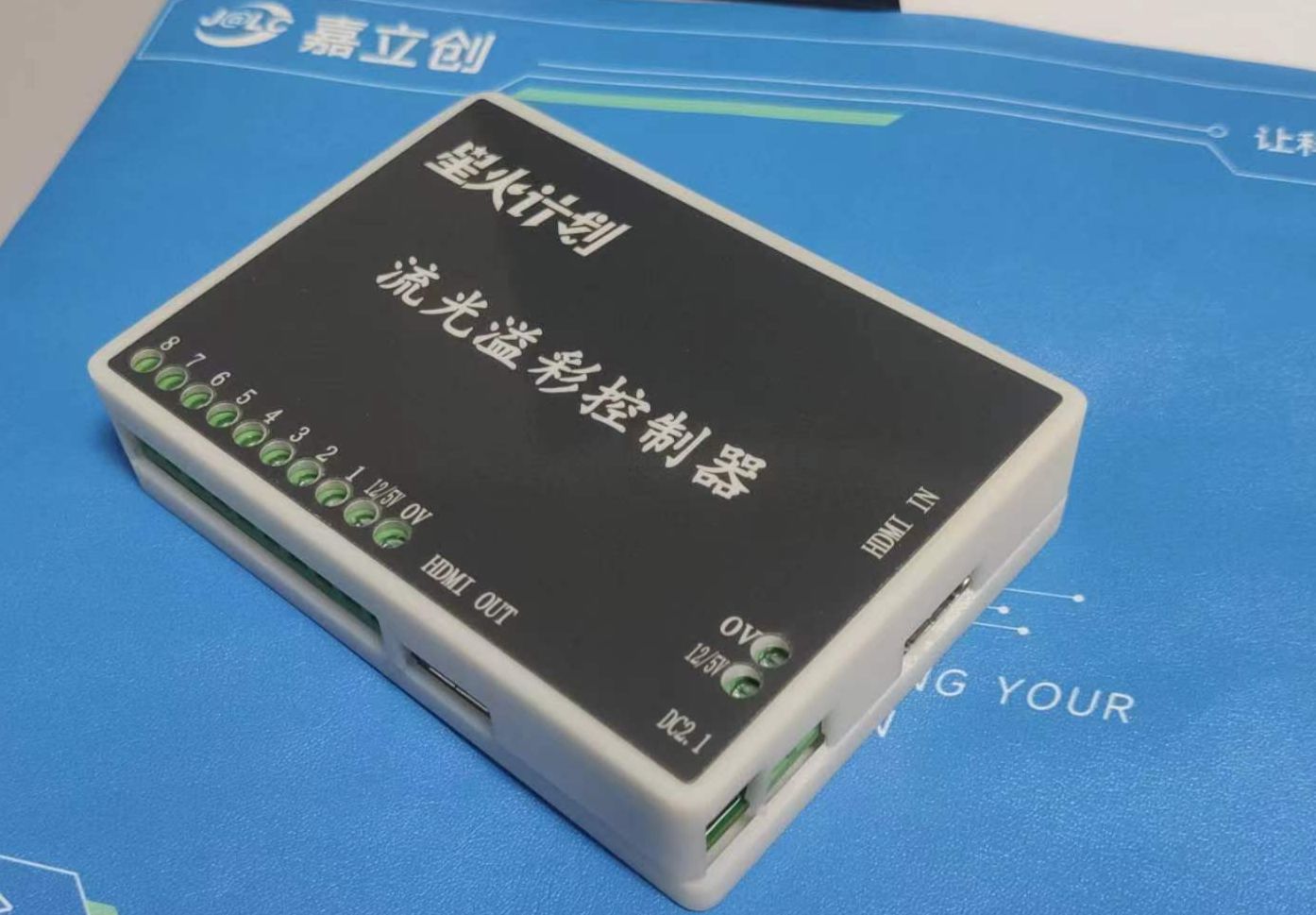

Project attributes:
This is the first public release of this project. It is an original project by the author and has not won any awards in other competitions.

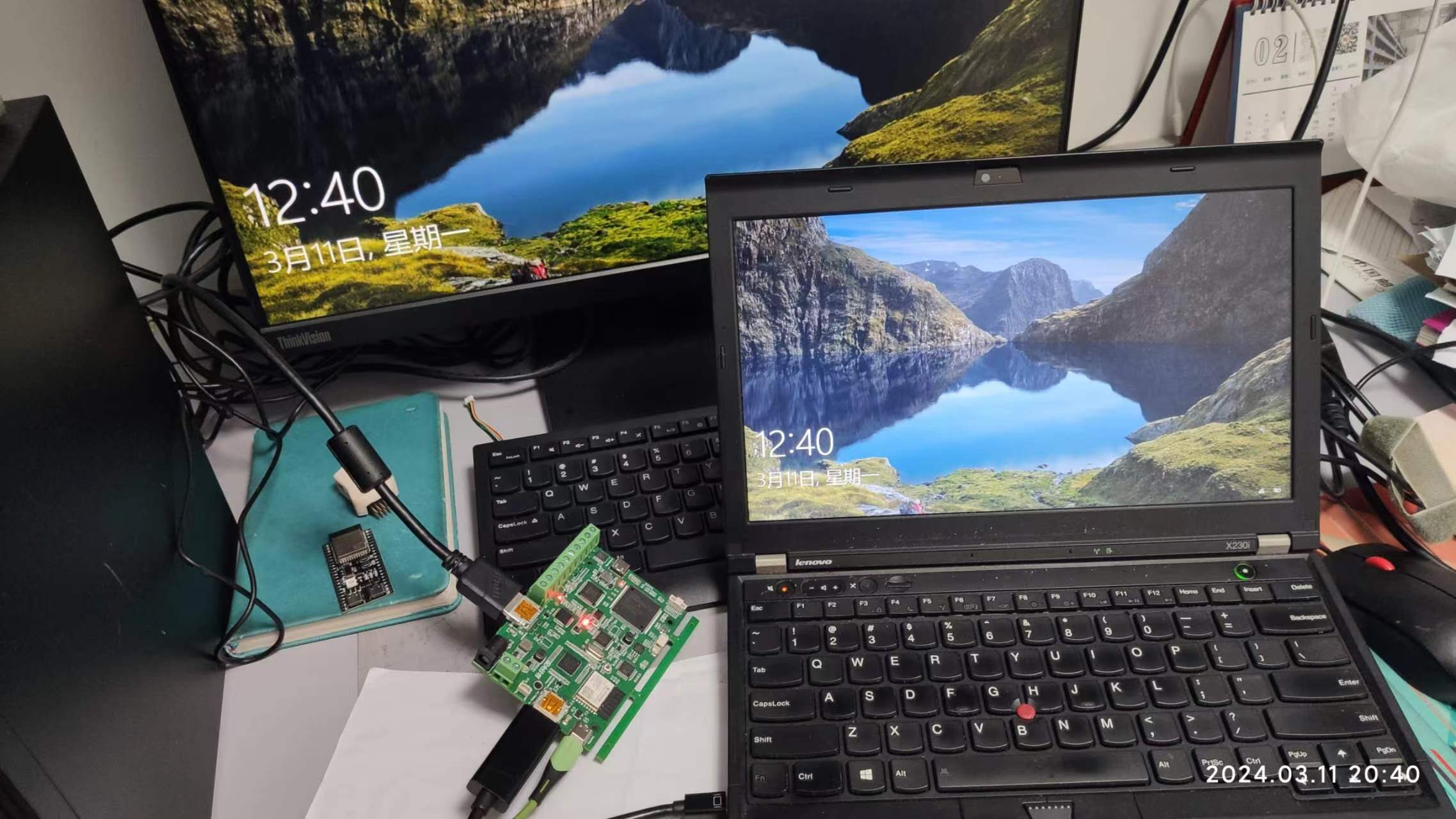

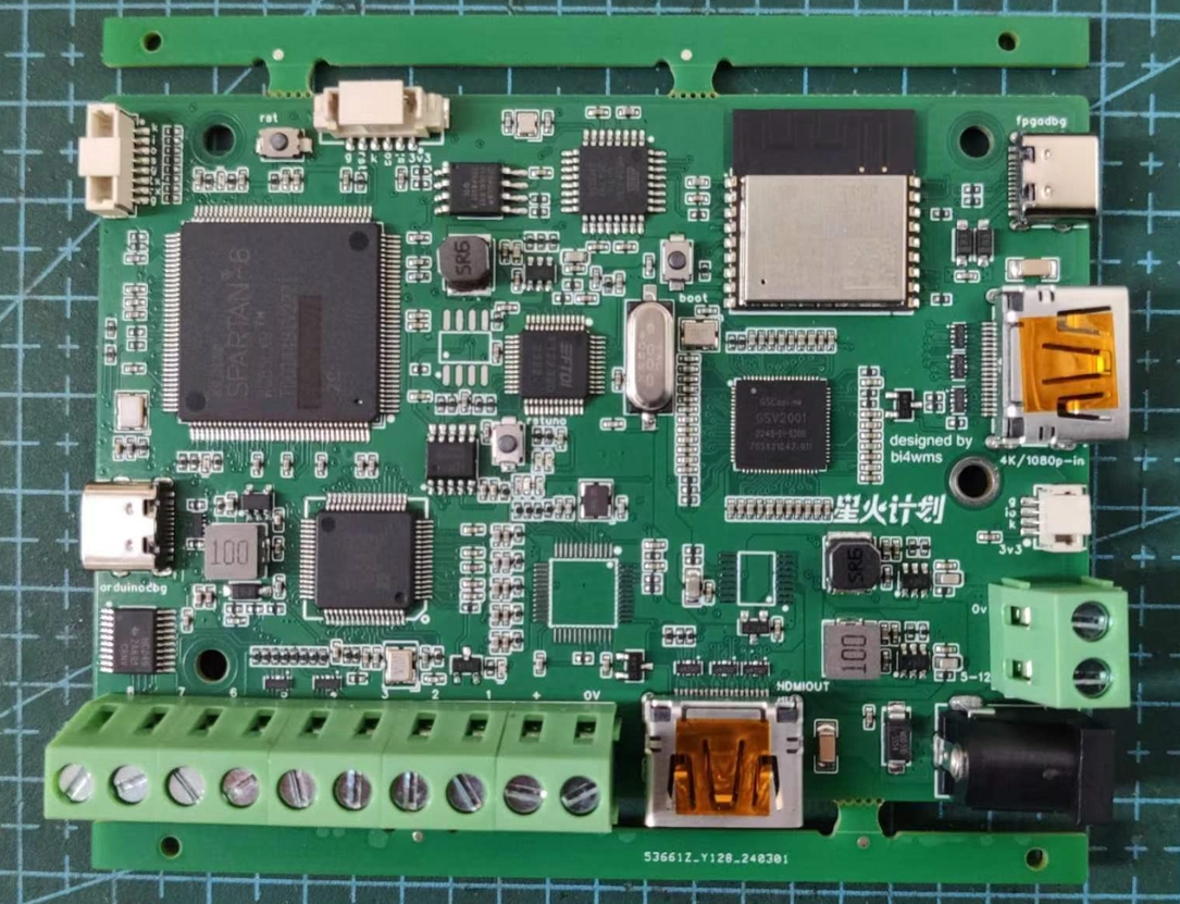

Project Progress
2024-02-18 Design concept document complete
2024-02-22 Hardware engineering design in progress
2024-02-28 PCB completed, surface mount production

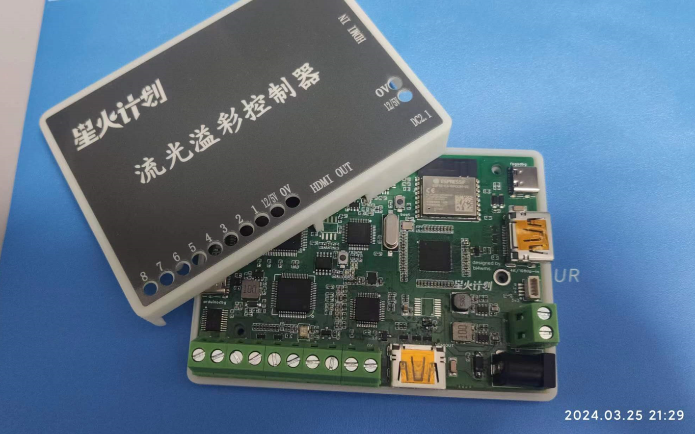

2024-03-15 Basic function debugging completed, can control light strip changes following video

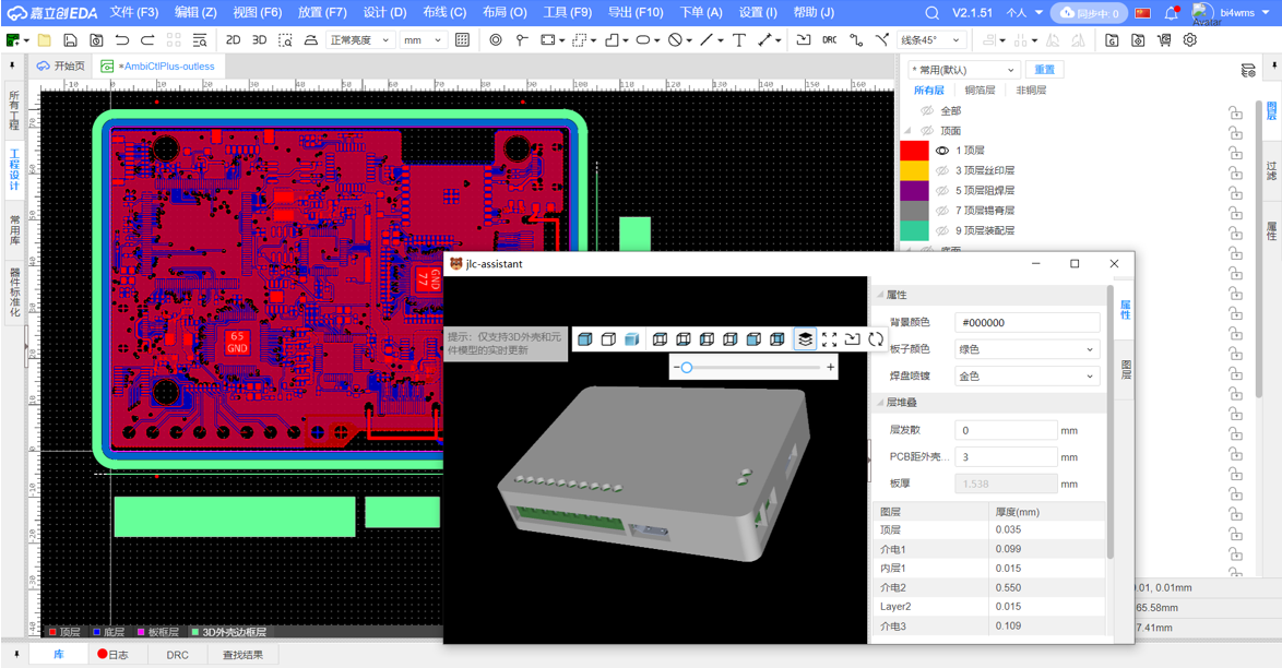

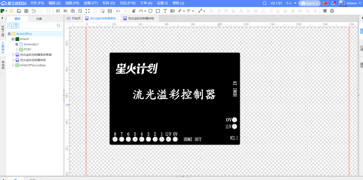

2024-03-20 3D shell and sticker design completed
Design Principles
Hardware System Overall Design Block Diagram

2. Note: Software can be nested using code blocks. Explanation of all software components is unnecessary; only the essential parts need to be explained . A complete product
demonstration of
the HDMI 1-to-2 splitter function is required . A 3D shell design is necessary, which is relatively simple and can be done directly using LCSC EDA . In addition to the shell, a silkscreen panel is also required . Shell and silkscreen design considerations are also important. Note: This section outlines some important considerations during the production process (optional). Other demonstration videos: Upload demonstration videos as attachments. Attachments can be uploaded to a maximum of 50MB. Files larger than 50MB can be hosted on other cloud storage or video websites; simply include the link here. Project attachments: Entries participating in the event must upload all relevant program attachments to an open-source platform or personal code storage cloud. Attachments can be uploaded to a maximum of 50MB (do not upload to the LCSC workspace, as there are limitations).
