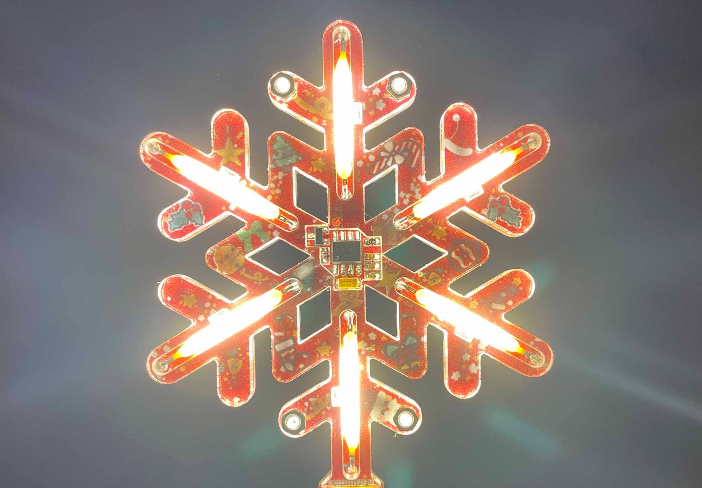

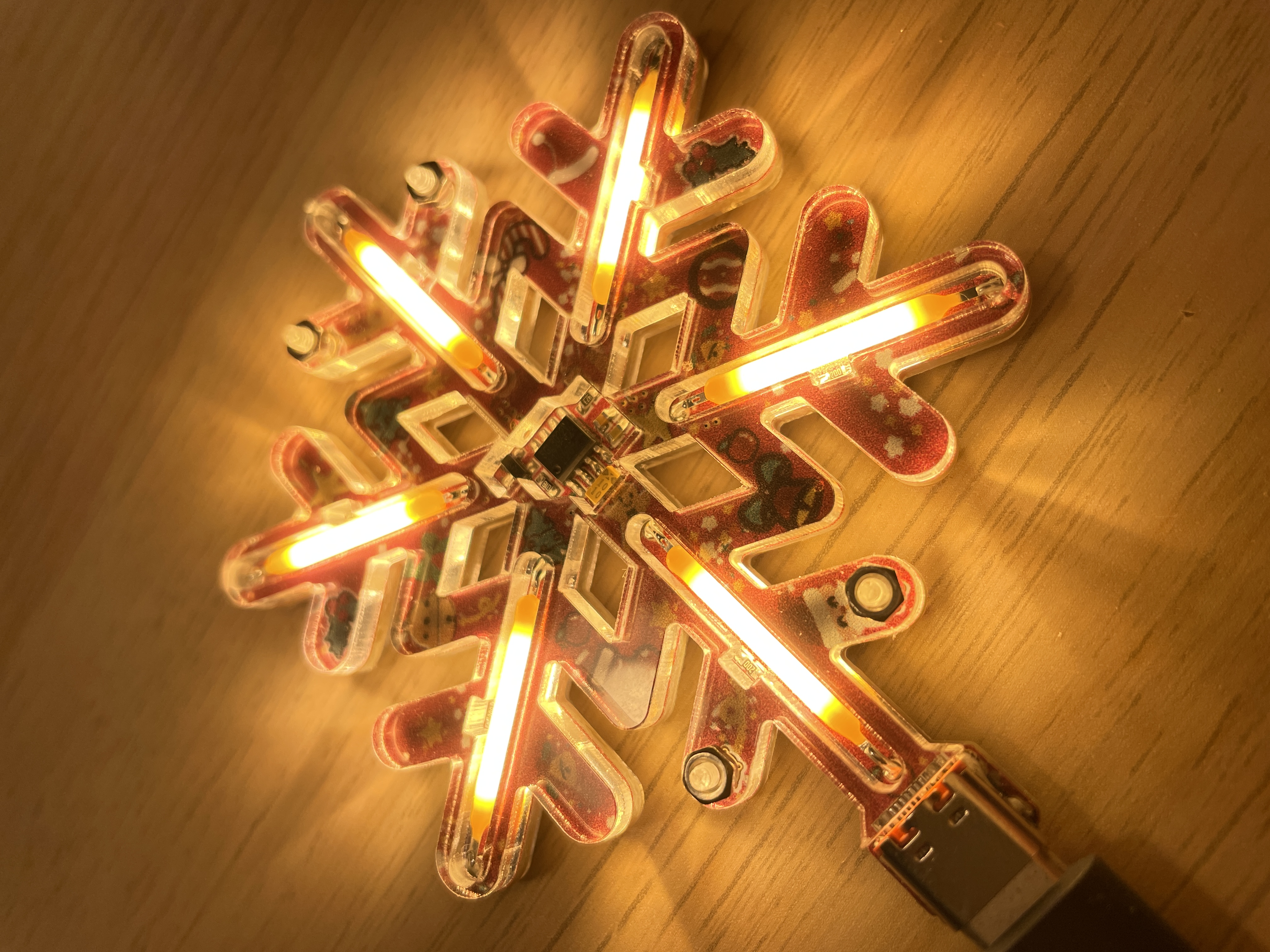

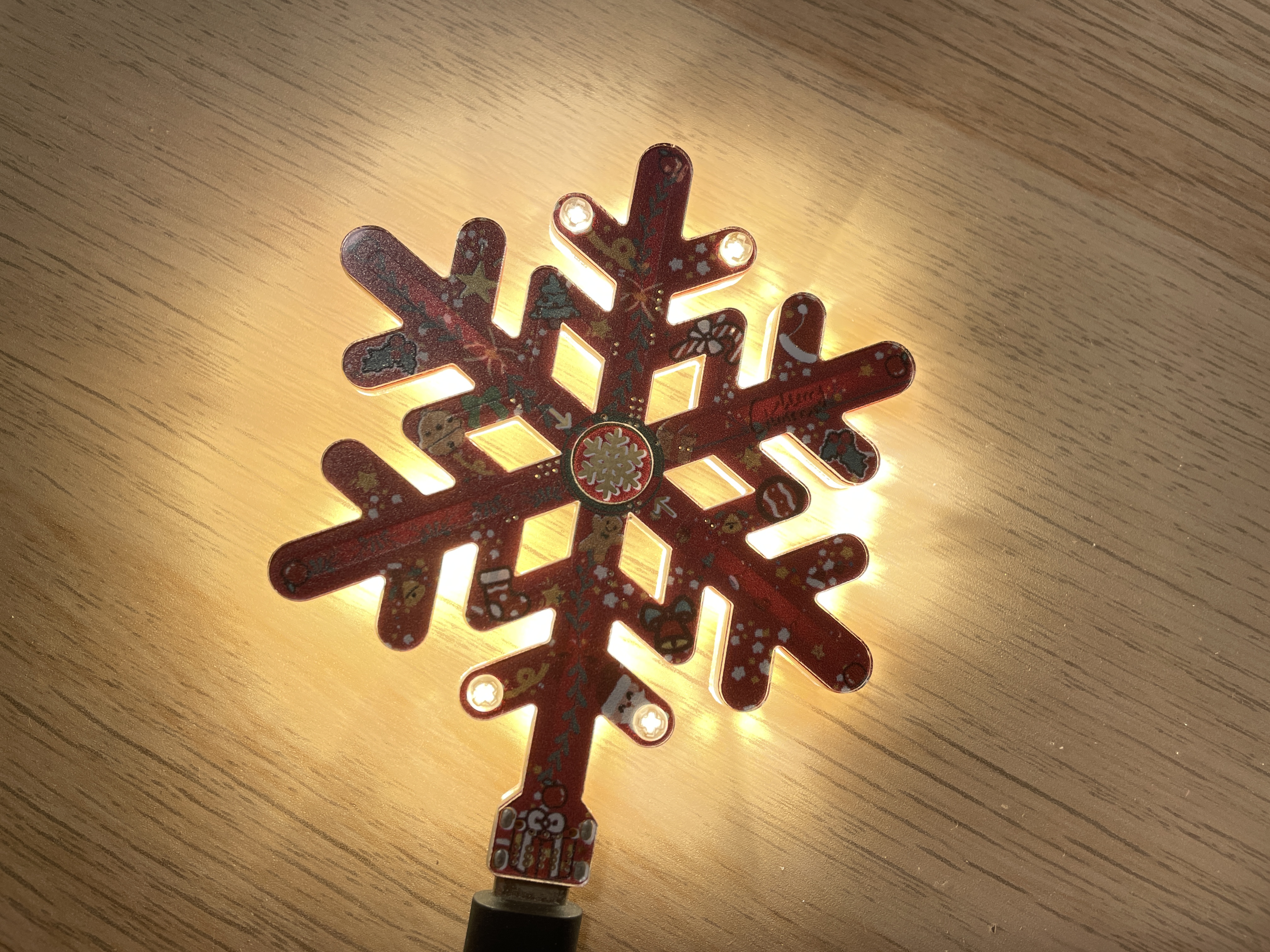

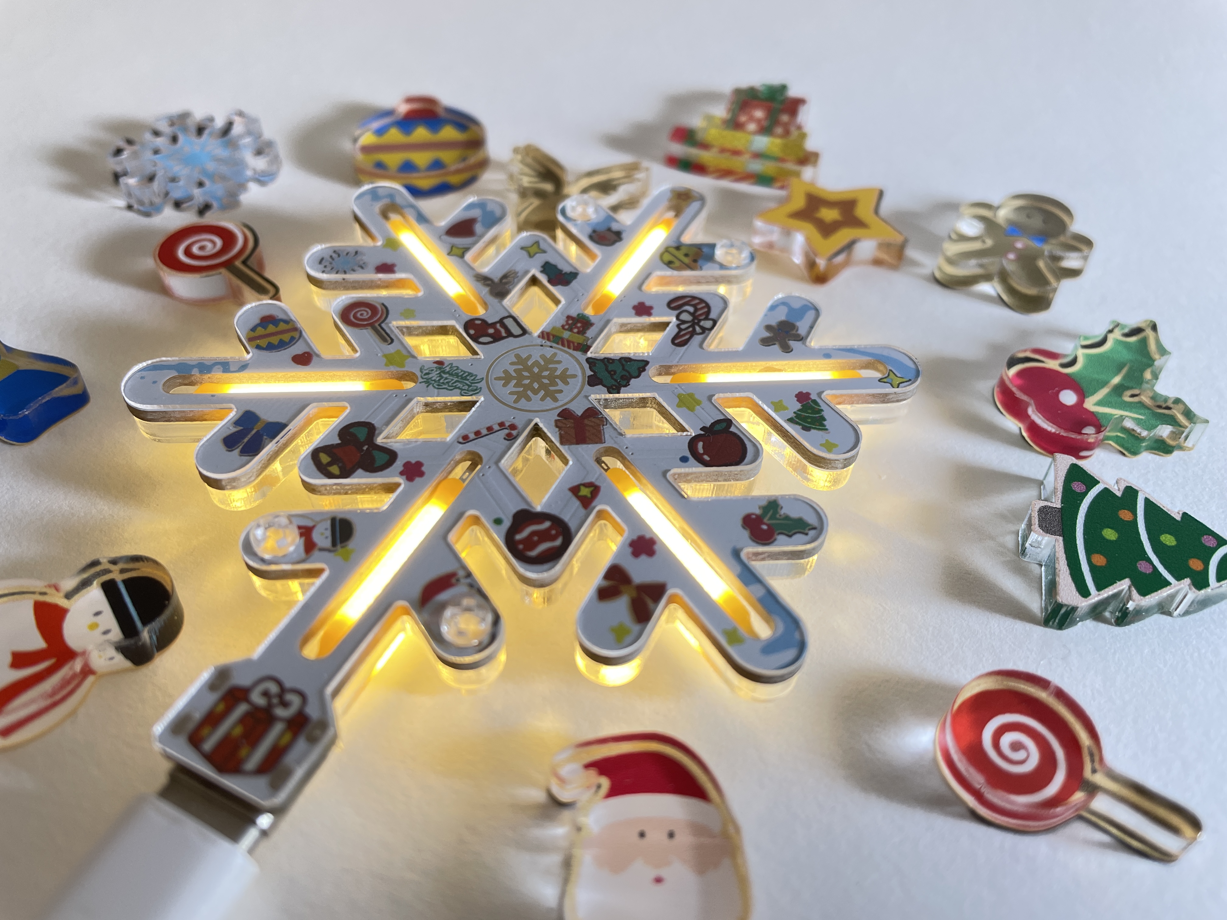

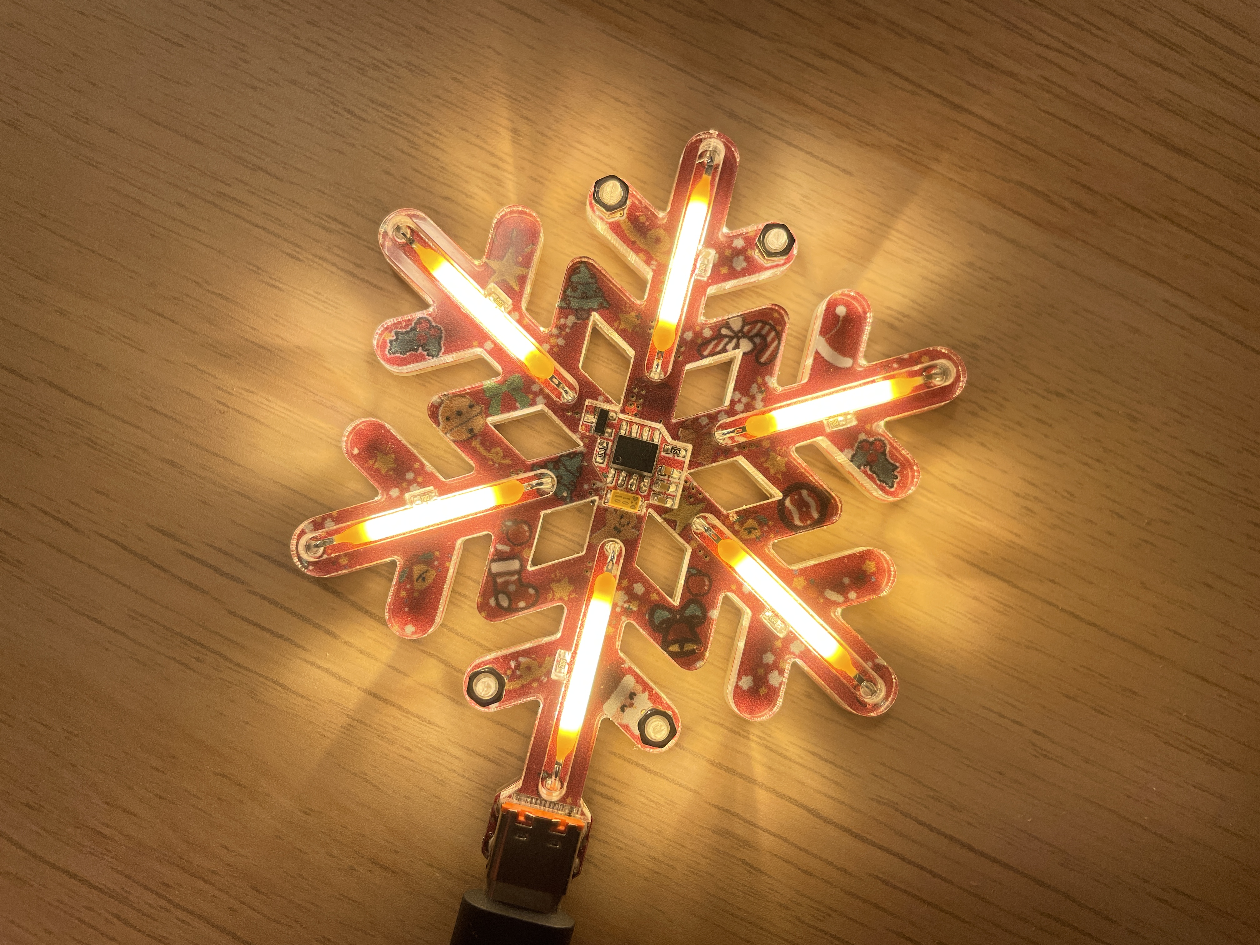

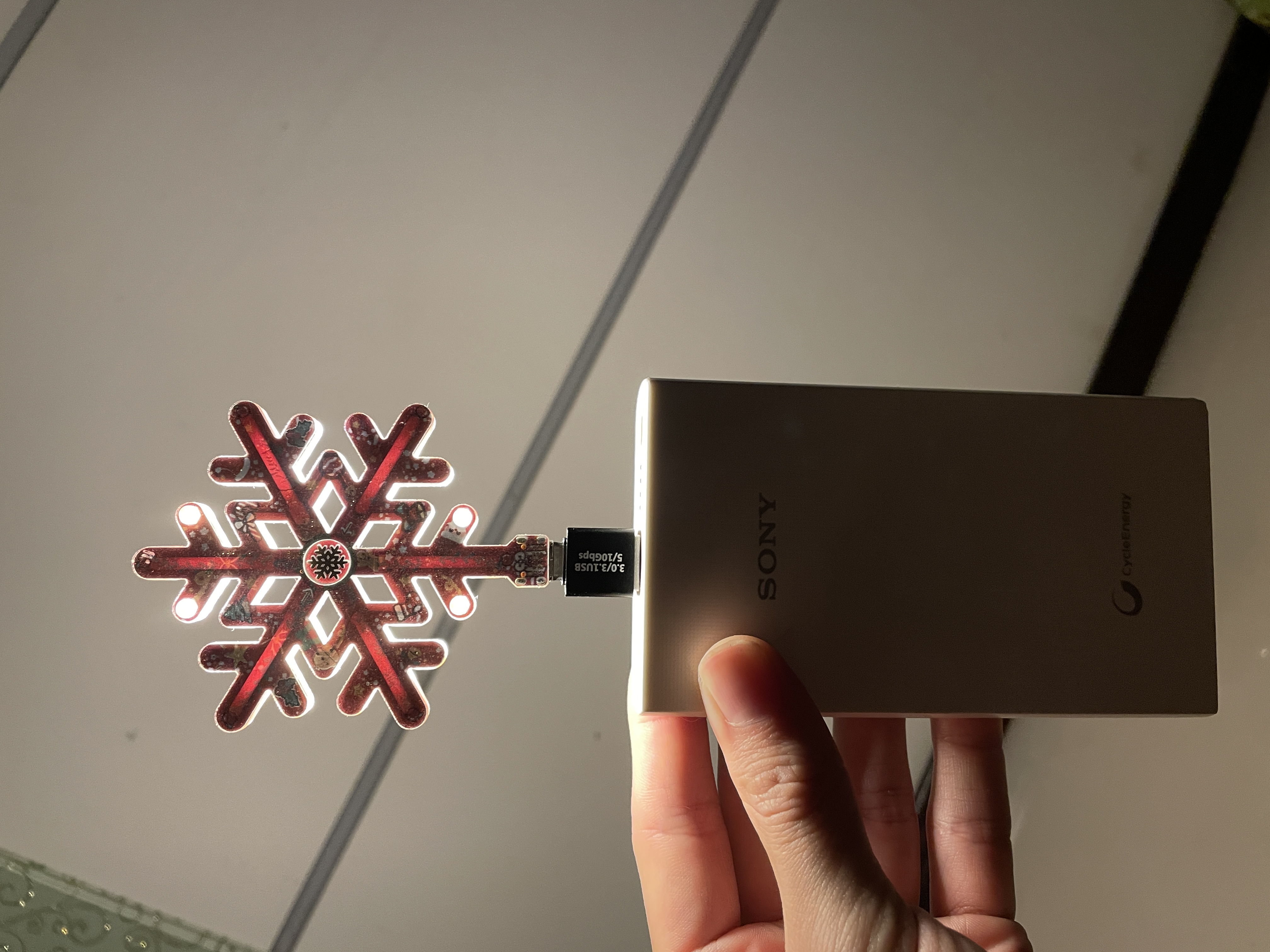

The latest version of the colored silkscreened snowflake light connection, released on December 26, 2023, looks much better overall; it is recommended to make the new version.
https://oshwhub.com/lioasis/christmas-snowflake-lights#P6
This project is based on the snowflake light by mondraker, with modifications to the color silkscreen printing. The original snowflake light (ceramic filament) with touch-sensitive stepless dimming (suitable for beginners!) - JLCPCB EDA Open Source Hardware Platform (oshwhub.com)
The overall schematic remains unchanged; only minor modifications have been made to the PCB. You can order directly, or replace the pattern yourself if desired.

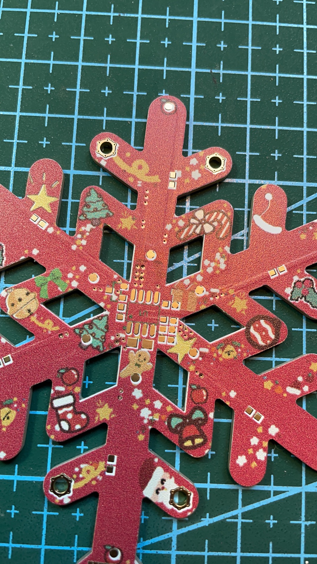

The actual printing effect is acceptable, but the board and the pattern are relatively small, so the pixelation is still quite large. The effect would be much better if the board were larger.
Secondly, during the color silkscreen printing process, the solder mask opening is automatically expanded outward by 0.2mm to accommodate errors. This results in a small amount of white background showing through the opening, but this white area is barely noticeable once the print is complete.
