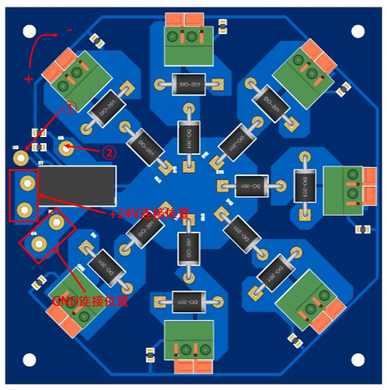

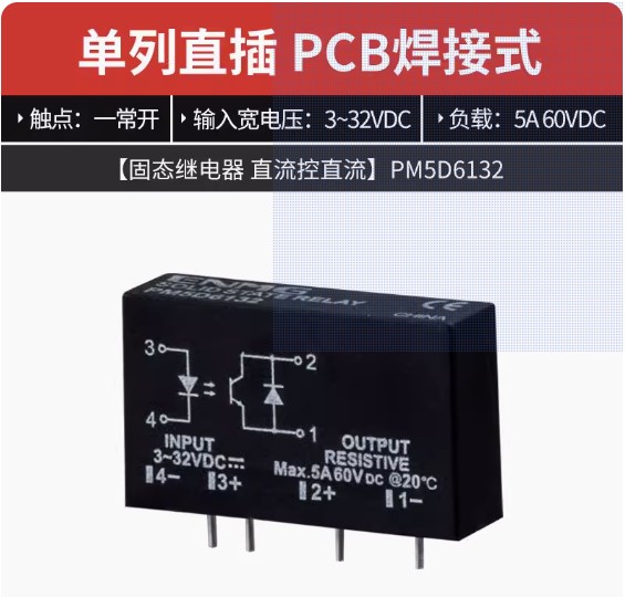

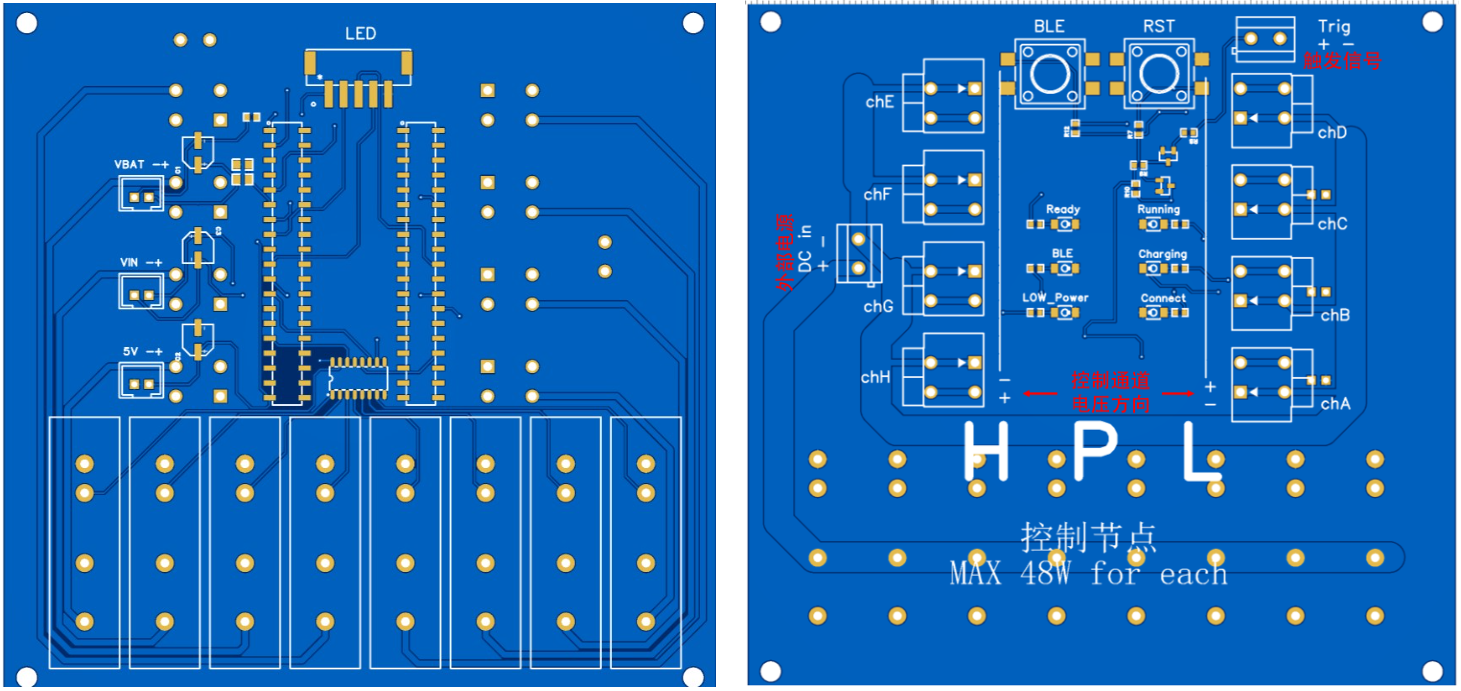

(2) Wireless Control
● Remotely controls the conduction and cutoff of DC voltage on a certain channel, which can be used to drive valves, etc.
● Maximum continuous load current reaches 5A.
● Each PCB supports eight channels.
● Supports timing control and manual control, with timing accuracy reaching 1ms and synchronization delay less than 0.3ms.
● Equipped with an emergency stop device

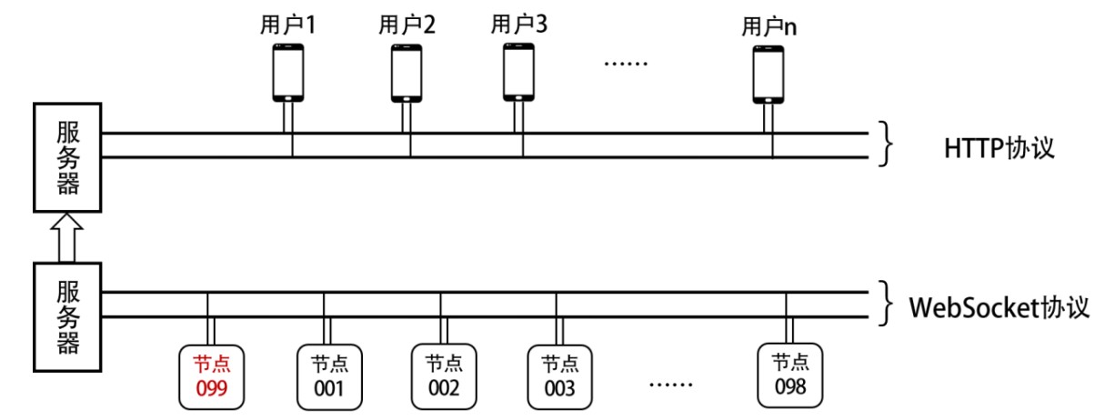

        The entire system comprises two servers (using WebSocket and HTTP protocols respectively) and several nodes, as shown in the diagram below.
        The nodes are distributed across the experimental site, divided into measurement and control nodes, responsible for measuring sensor signals and issuing control voltages respectively. The servers connect users to the nodes, allowing users to observe node data and change the state of the control channels.
        The WebSocket server supports connections to a maximum of 98 nodes, with addresses ranging from 001 to 098. Address 099 in the WebSocket network hosts an auxiliary window program (hereinafter referred to as the "auxiliary program") used to check server status and manage server restart and shutdown actions. Because address 099 also connects to the server via WLAN, it does not need to run on the same computer as the server.
        Note: Node addresses are prefixed with 's' and 'm' to distinguish between the control server and the measurement server. That is, in the control server, node addresses are s001-s099; in the measurement server, node addresses are m001-m099.
        The HTTP server broadcasts two web pages, one for wireless measurement and the other for wireless control: the measurement page allows real-time viewing of node data; the control page allows manual changes to the status of a specific channel. The HTTP server is built on Apache 2.4. The provided software package will install Apache 2.4 and PHP 8 along with the server installation and automatically modify the web page root directory.

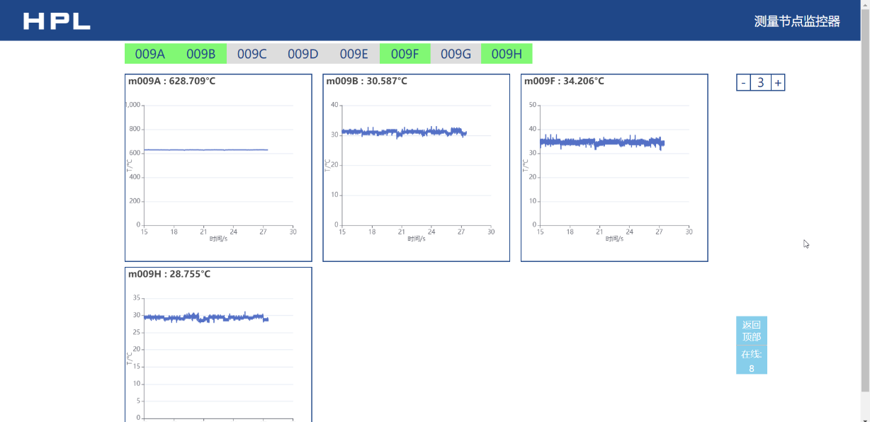

(1) The measurement web page
        interface is shown in the figure below:
        In the interface, the gray-green background squares at the top display all the online channel names, and the bottom is the drawing area. Click to select a channel, and its background will change from gray to green, and the corresponding chart will be displayed below. Click again to deselect the channel, and the corresponding chart and historical data will disappear. The banner at the bottom will fade out of the interface after clicking. The number in the upper right corner indicates the number of charts displayed in each row, which can be adjusted by clicking "+" and "-".
        Note: Drawing many charts at the same time may cause high CPU usage.

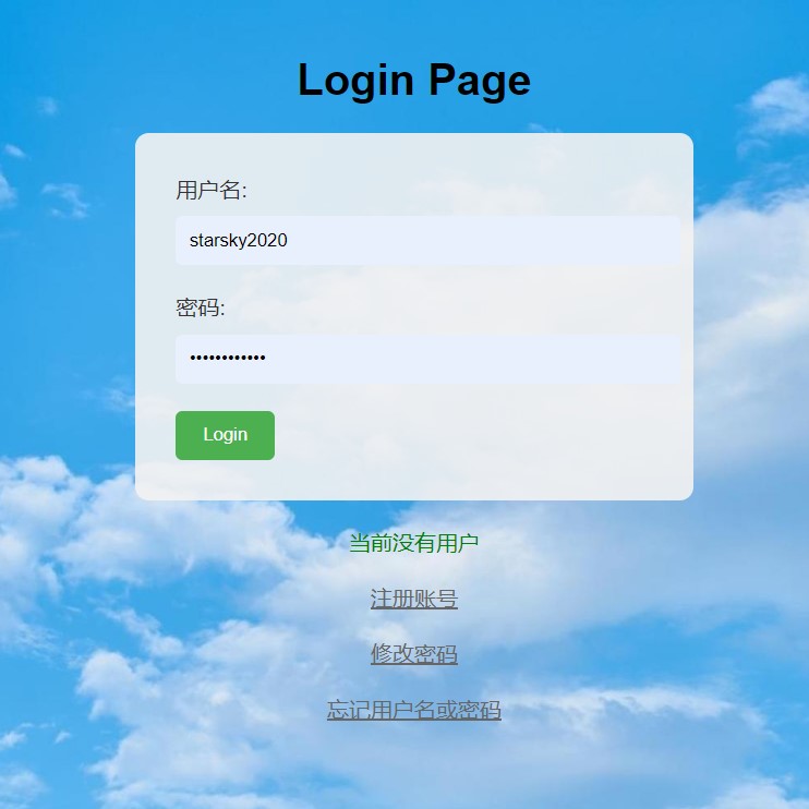

        To prevent command conflicts, the control webpage only allows one user to operate online. Therefore, authentication is required.
        When the control page is opened for the first time, the browser will prompt that the identity information has expired. Clicking "OK" will automatically redirect to the login page. Enter the username and password. After successful login, you will be redirected to the control page and allowed to operate the status of each node channel through the webpage.
        If a user is already operating the control page, all subsequent login processes will be blocked. It takes about 3-6 seconds for the server to update the online status. After the previous user closes the webpage, please wait for a while before logging in.
        On the login page, you can also choose "Register Account" or "Change Password". The initial verification code for "Register Account" is "ABCDEFG". Website administrators can modify the configuration file "Apache24htdocsuser_controlconfig.txt" in the installation directory. The configuration.txt file stores a JSON string, with the field corresponding to the verification code being "vfCode".

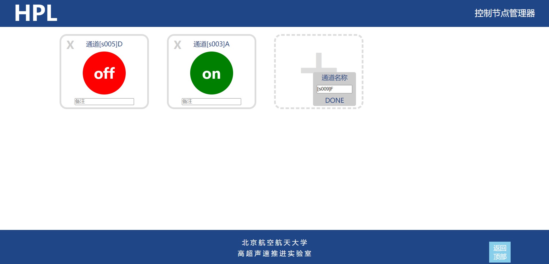

        The main interface of the control page is shown in the image below. Clicking "+" and entering a channel name creates a new control channel. Clicking "ON/OFF" changes the channel's on/off status. Clicking "X" closes the current channel. The banner at the bottom can also be closed by clicking.
        Note: The control page supports manually changing the status of a channel, but it still connects to the server via WebSocket. Please ensure that the operation assistant and the control page are not running simultaneously, otherwise conflicts may occur.

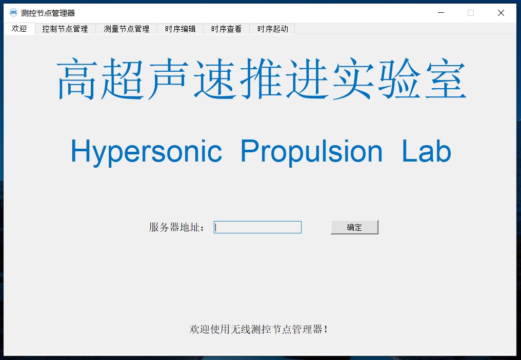

        Double-click to open MS_User. You can see a total of 6 tabs, namely "Welcome", "Control Node Management", "Measurement Node Management", "Timing Editing", "Timing Viewing" and "Timing Startup".
        After the program is opened, it is offline by default and all functions are disabled. Please enter the server address in the "Welcome" interface and click "OK" to connect to the server. If you do this, a new command line window will be launched, which records the debugging information of WebSocket.

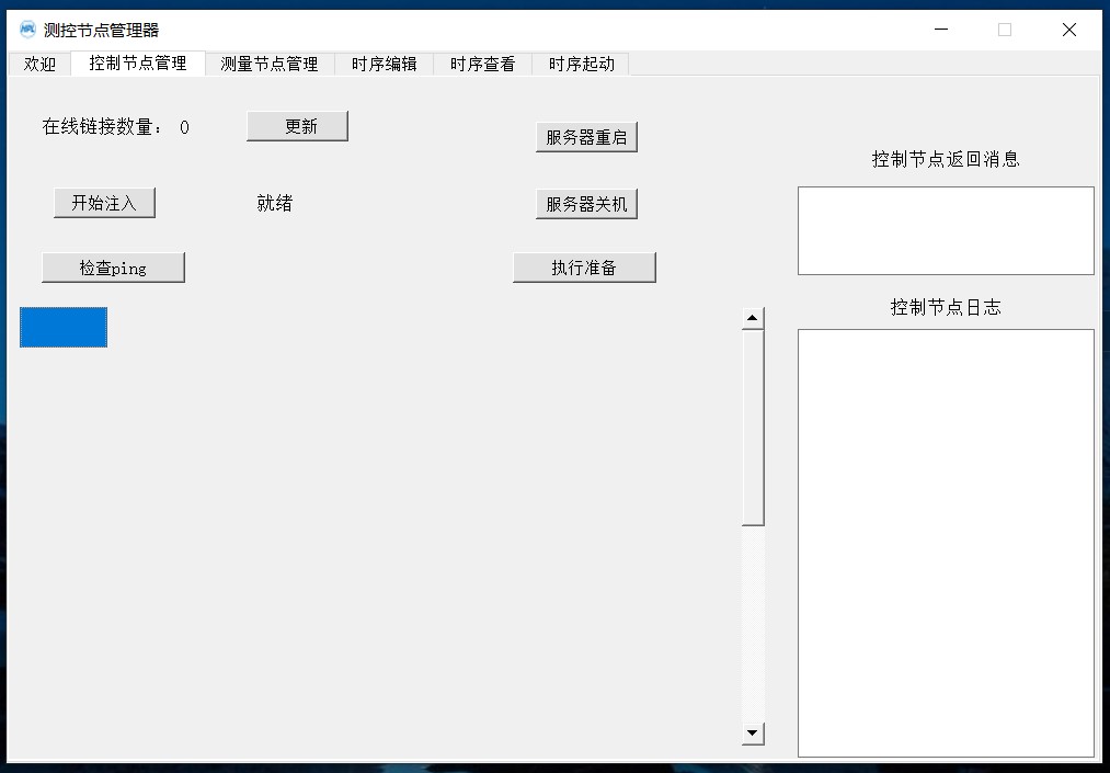

        Open the "Control Node Management" tab. The interface is shown in the figure below. The rightmost part is the server's incoming and outgoing messages, the upper left part has many buttons, and the lower left part is a scrolling area.
Once a control node joins the network, clicking "Update" displays the number of online connections;
clicking "Check Ping" retrieves the latency between each node and the server, with the latency in milliseconds displayed in a scrolling area;
clicking "Start Injection" distributes the timing file (explained below) stored on the server to the corresponding nodes and checks if they have successfully received it;
clicking "Execute Preparation" puts each control node into a "waiting for trigger" state, a necessary condition for starting control timing;
clicking "Server Restart" or "Server Shutdown" restarts or shuts down the server corresponding to ws://localhost:9002.

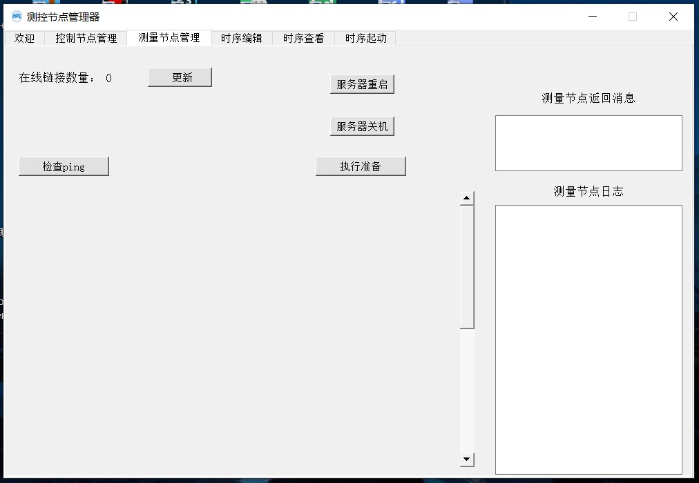

        Open the "Measurement Node Management" tab; the interface is shown below. In this tab, the "Execute Preparation" function is slightly different: after a node joins the network, it is in a standby state by default. Clicking "Execute Preparation" at this time will cause all nodes to start collecting data and continuously uploading it to the server. If "Execute Preparation" is clicked again, the node will stop collecting and uploading data and return to the standby state. Other functions are similar to the "Control Node Management" tab and will not be described further here.

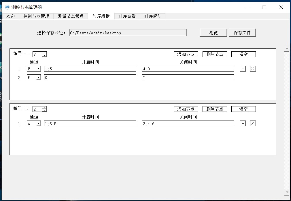

        Open the "Timing Edit" tab; the interface is shown below.
        Timing control is a common control method used to automatically execute a series of operations according to a predetermined time sequence. In this tab, we can select specific channels and specify their on/off times, then create a timing file. Clicking "Browse" allows you to choose the path to save the timing file. Clicking "Add Node" creates a new node below the current node; clicking "Delete Node" deletes the current node; clicking "Clear" clears all entered on/off times. Clicking "+" adds a control channel to the current node; clicking "x" deletes the last control channel of the current node. "On Time" and "Off Time" are in milliseconds; enter several integers separated by semicolons ";". After editing the timing file, clicking "Save" will generate a "server_seq.SEQ" file in the target folder.

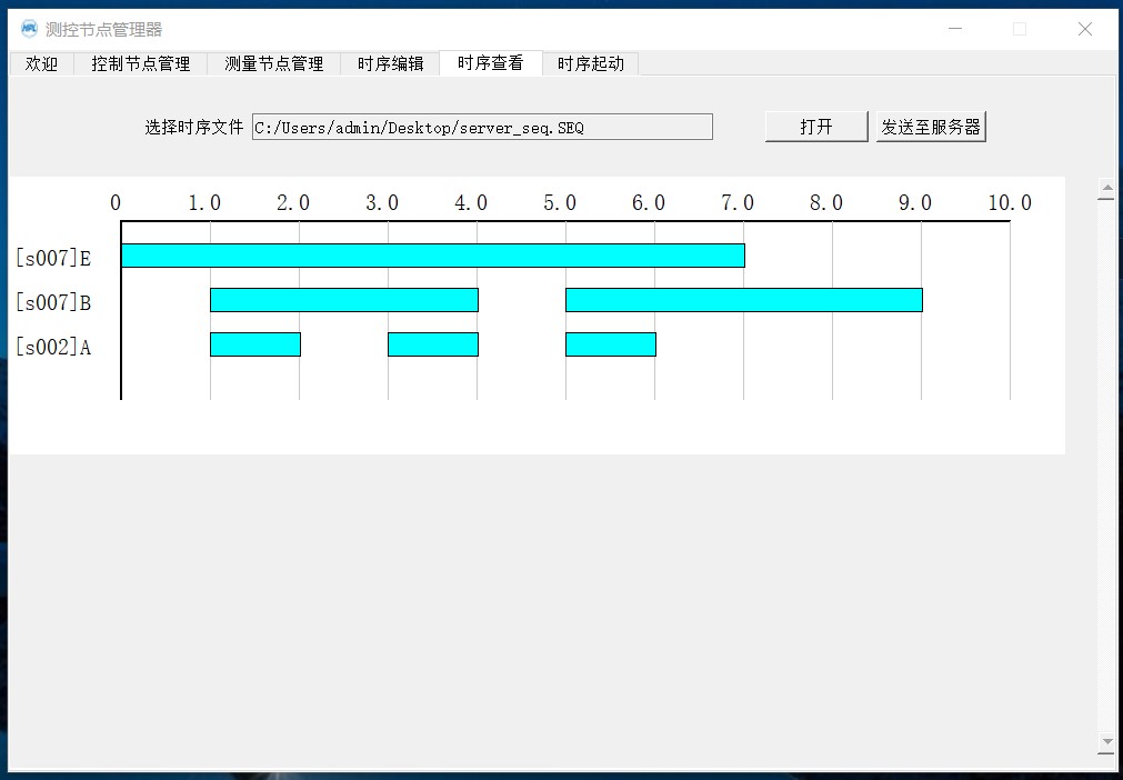

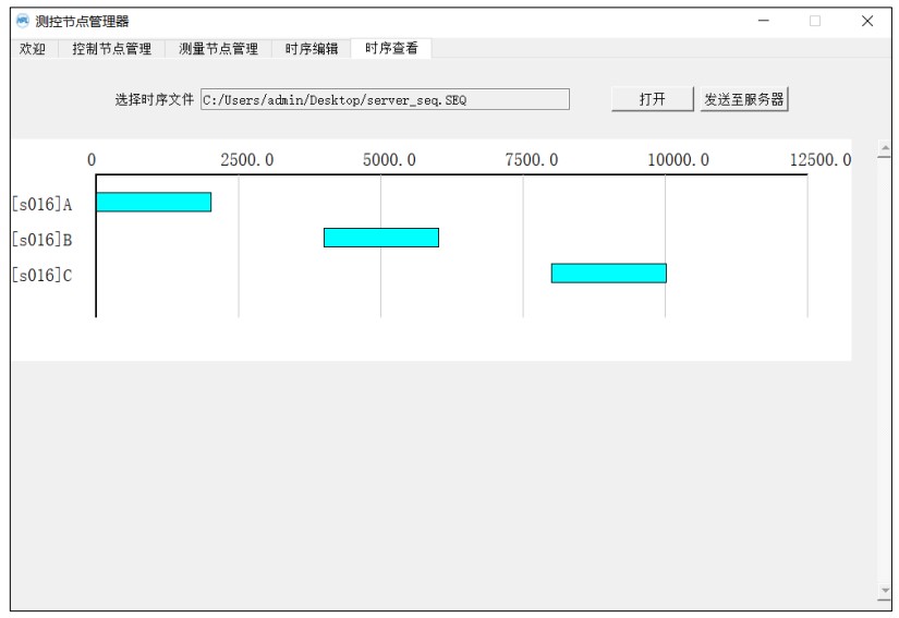

        Open the "Timing View" tab; the interface is shown in the figure below. Open the saved timing file (*.SEQ); the timing graph will be automatically displayed below. After checking that everything is correct, click "Send to Server" to transfer the file to the local server.

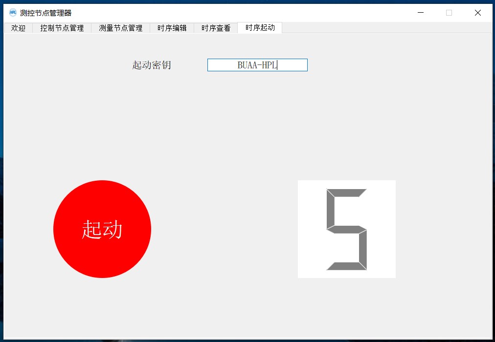

        Open the "Timing Start" tab; the interface is shown in the figure below. Enter the correct start key and click "Start." The program will enter a 5-second countdown. Then, a start command is sent to the synchronizer, which generates a trigger signal, causing each control node connected to it to start executing the timing simultaneously.

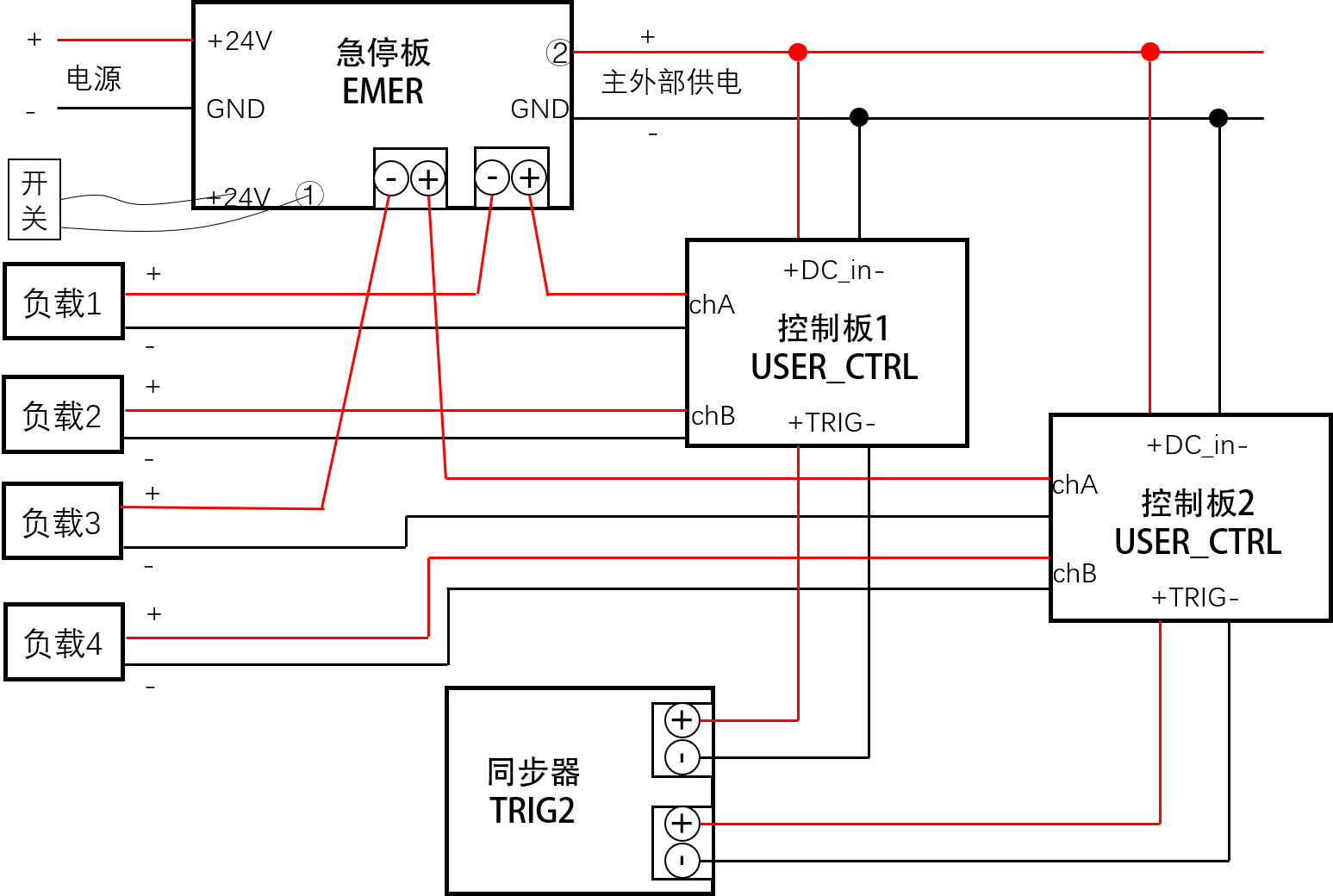

        The function of the synchronizer and its wiring to each control node will be described below.
        Note: Successful timing start requires the following conditions to be met:
① The synchronizer and each control node maintain a wireless connection to the server.
② The key in the auxiliary program is consistent with the key entered in the synchronizer.
③ The trigger terminals of each control node are connected to the synchronizer and are in "waiting for triggering state."

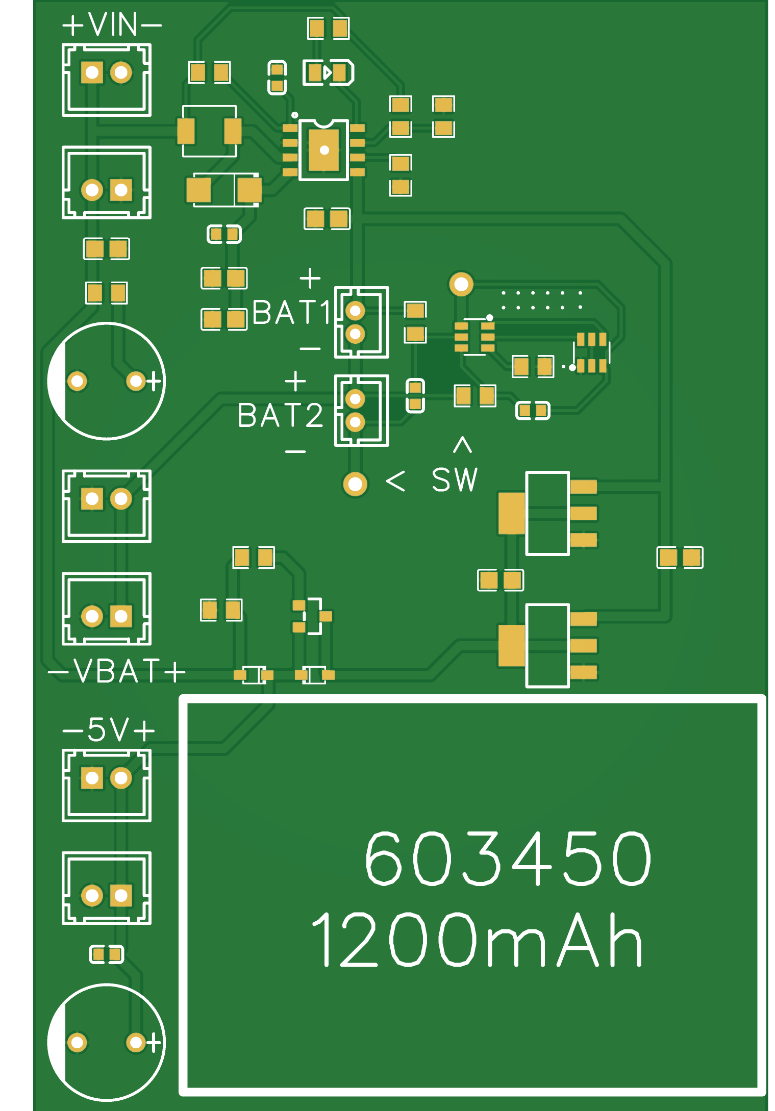

        Measurement Nodes mainly consist of three PCB boards: a power board, board A for measuring K-type thermocouple signals, and board B for measuring 4-20mA current signals.
(1) Power Board

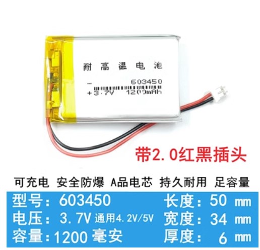

        The function of the power board is to provide a stable 5V voltage for both measurement boards and to provide interfaces for battery status and charging status indication. For the measurement nodes, the PCB name used by the power board is "UPS2". As shown in the figure below:
        The power board uses two 3.7V lithium batteries in series, which are regulated to 5V by an AMS1117-5.0.
        In the figure, BAT1 and BAT2 are two PH2.0 sockets used to connect the batteries (!Please make sure the positive and negative terminals of the batteries are consistent with the silkscreen before connecting!). The two circular pads with through holes indicated by the silkscreen "SW" are the switch connection positions. The battery will only have output when the two are shorted.
        Two AMS1117 soldering positions are reserved on the PCB, which are connected in parallel. If the load current requirement is less than 1A, only one AMS1117 needs to be soldered.

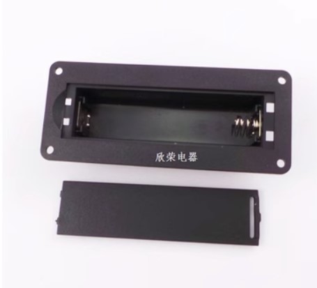

        A lithium battery mounting position is reserved in the lower right corner of the PCB. The author used 603450 batteries (from Taobao), which were stacked and fixed with glue. The batteries are shown in the figure below. Of course, if space permits, a larger capacity and larger battery can be used. However, the 3D casing provided in this project may not be able to accommodate it, so please redesign.
        There are six XH2.54 sockets on the far left of the PCB, divided into three groups: "VIN", "VBAT", and "5V". Each group is shorted to each other and provides both positive and negative soldering positions, with the positive and negative terminals matching the silkscreen markings.
        The power board uses a PL7501C to charge two lithium batteries and a PL7022B to protect them. When charging, connect a 5V voltage to one of the XH2.54 sockets in "VIN". The default maximum charging current is 1A; please ensure the power adapter's output current is sufficient.

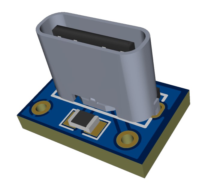

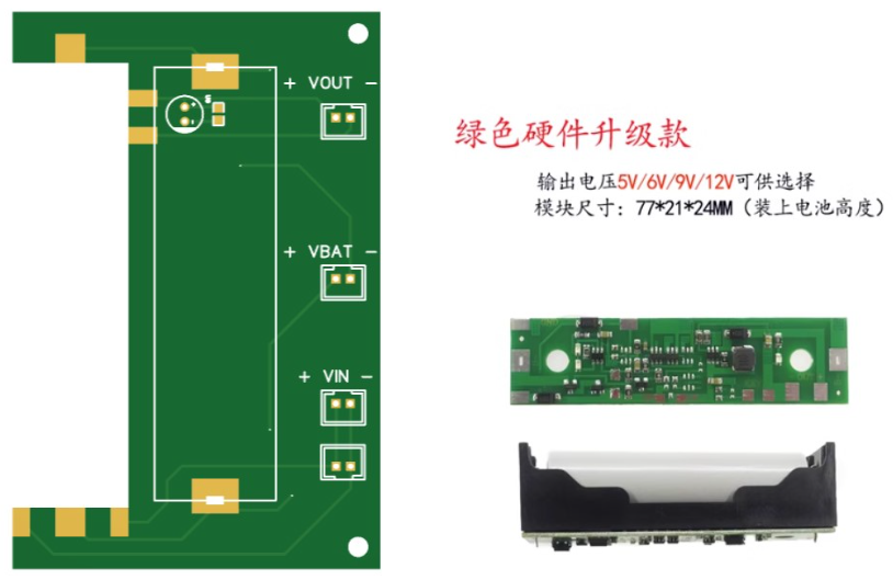

        This project also provides a small Type-C to 5V adapter board, named "TypeC-5V". After soldering XH2.54 terminal wires to it, it can be directly plugged into the sockets on the power PCB.
        The "VBAT" socket is connected to the positive and negative terminals of one of the batteries, outputting the current voltage of that battery for power monitoring on the measurement board.
        The “5V” output provides a stable 5V voltage to power both types of measurement boards. When charging, this voltage is directly output from VIN; when discharging the battery, this voltage is output from AMS1117. The switching process will not affect the operation of the measurement board.
        Note: There is another power supply option: boosting the 3.7V of a single lithium battery to 5V, the corresponding PCB name is “UPS”. There is an empty slot on the left side of the PCB, and a lot of solder needs to be piled on the edge pads to connect to the power module (Taobao) (as shown in the figure below). The recommended PCB thickness is 1.2mm.
        Note: The above boosting scheme is not recommended for use in the measurement board. This scheme has a large ripple, which will bring considerable noise to the measurement data.
        Note: Try not to perform measurements while charging. The output voltage quality of some power adapters is poor, which will also interfere with the measurement results.

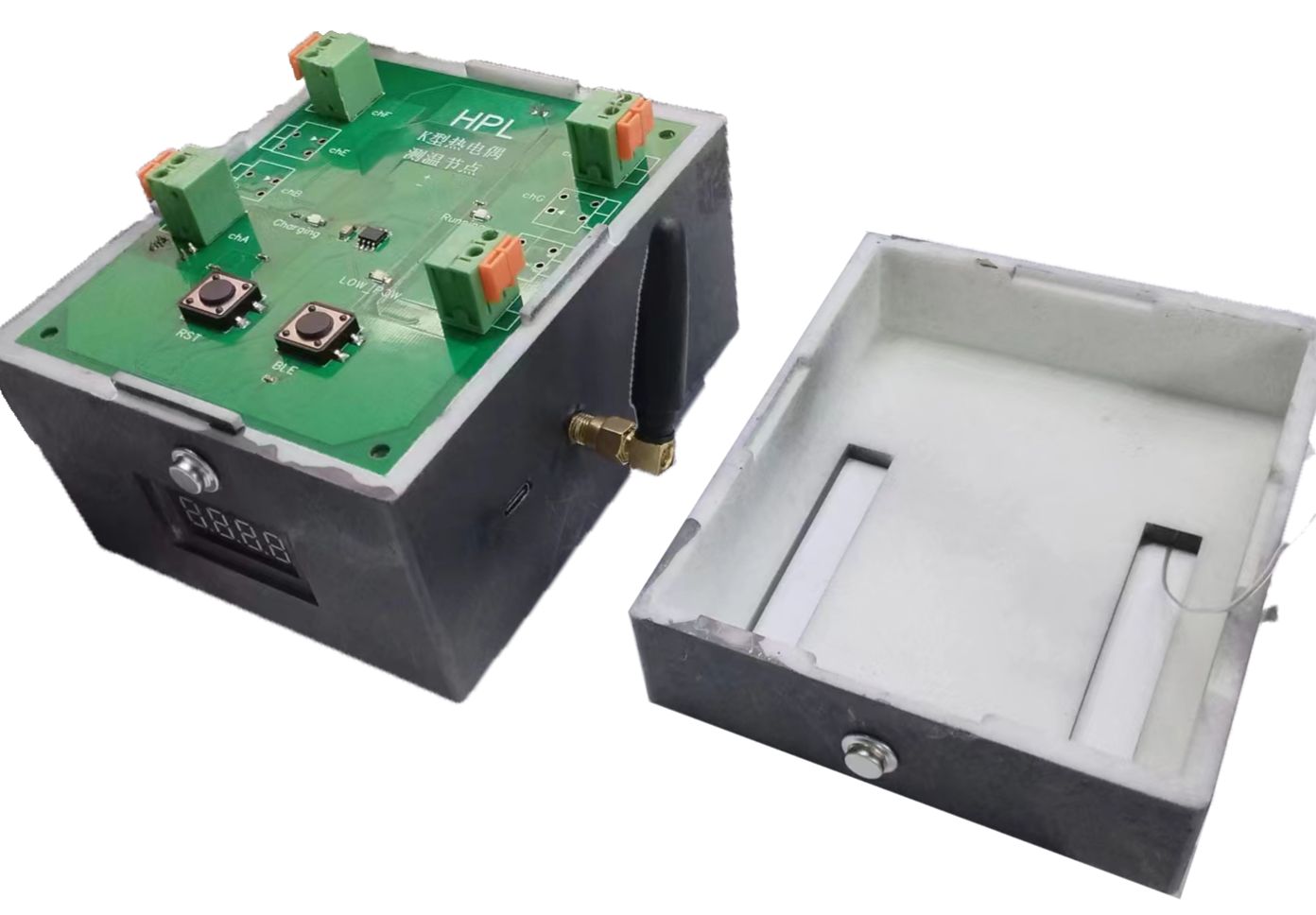

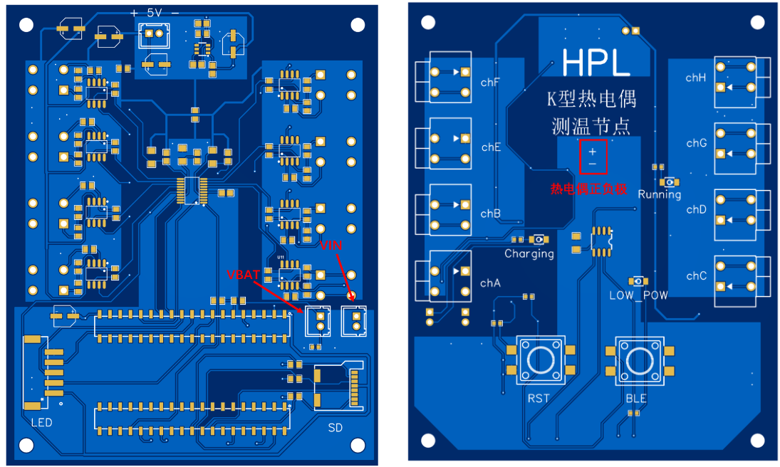

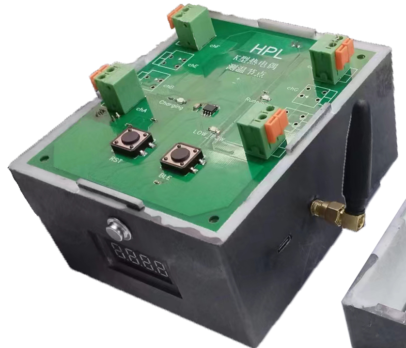

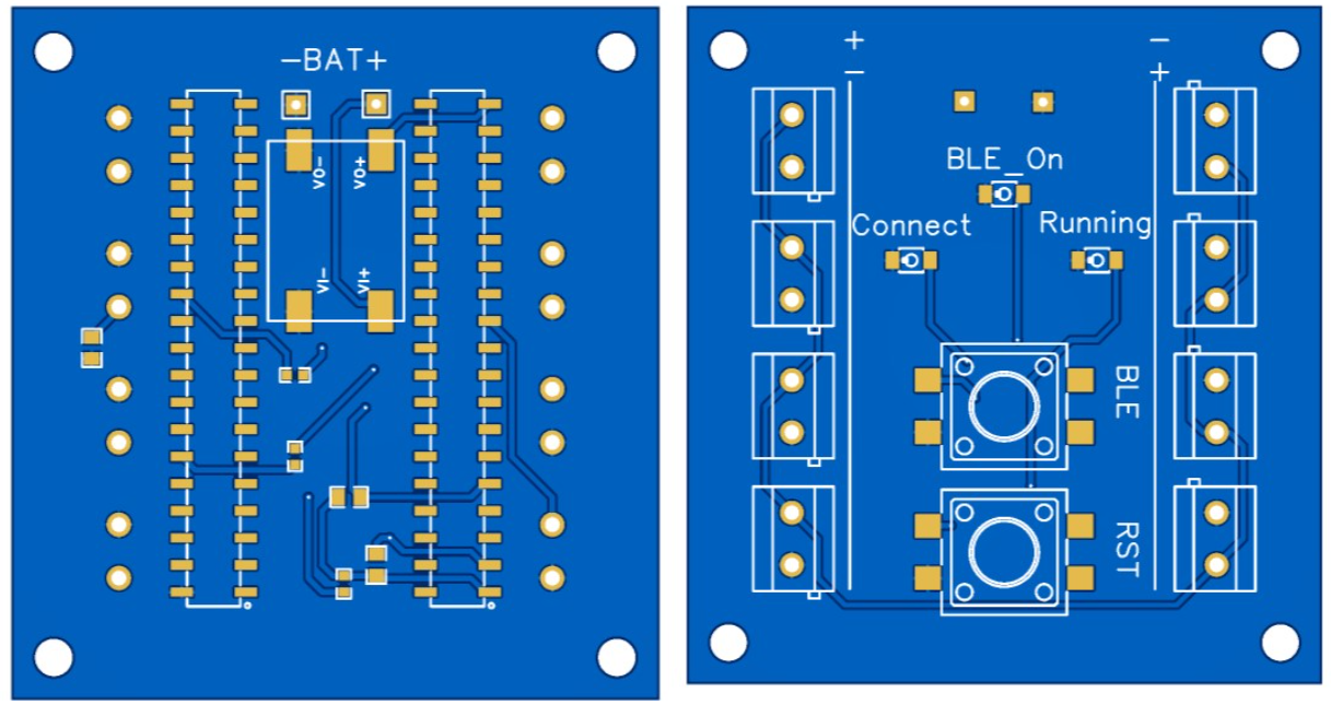

(2) Measurement board for K-type thermocouple
        The measurement board for K-type thermocouple is um_op. Eight terminals are installed on the back of the PCB, which are directly connected to the K-type thermocouple. It uses an OP07 to form a differential amplifier, amplifying the thermocouple signal, and then inputs the amplified signal to an AD7327 analog-to-digital converter. The AD7327 is connected to an ESP32 microcontroller and configured as a slave, transmitting data via SPI. The microcontroller also has a MAX6675 and an SD card connected, responsible for cold junction compensation and data backup of the thermocouple, respectively.
        An SGM3204 is mounted on the PCB to generate a negative voltage. This allows the measurement board to still acquire data normally even if the hot junction of the thermocouple is lower than the cold junction temperature.
        The top and bottom surfaces of the PCB are shown in the figure below.
        The top surface has three XH2.54 sockets, labeled "5V", "VBAT", and "VIN", which correspond to the three sockets on the power board. "5V" is the power supply socket; "VBAT" is the battery level monitoring socket, which illuminates the indicator light when the battery is low when connected, and can also work normally without being connected; "VIN" is the charging status indicator socket, which illuminates the indicator light when charging when connected, and can also work normally without being connected. On the lower left of the top surface, the socket indicated by the silkscreen "LED" is an XH2.54-1x5P socket. It is connected to a four-digit LED display to show the node number. As shown in the picture below (Taobao)
        , there are three LEDs on the bottom. The silkscreen "Running" indicates that the measuring board is powered on, "charging" indicates that it is charging, and "LOW_POW" indicates that the battery is low. There are two buttons on the bottom: the silkscreen "RST" indicates that the microcontroller is restarted, and "BLE" indicates that Bluetooth is turned on (the function of Bluetooth will be explained below).

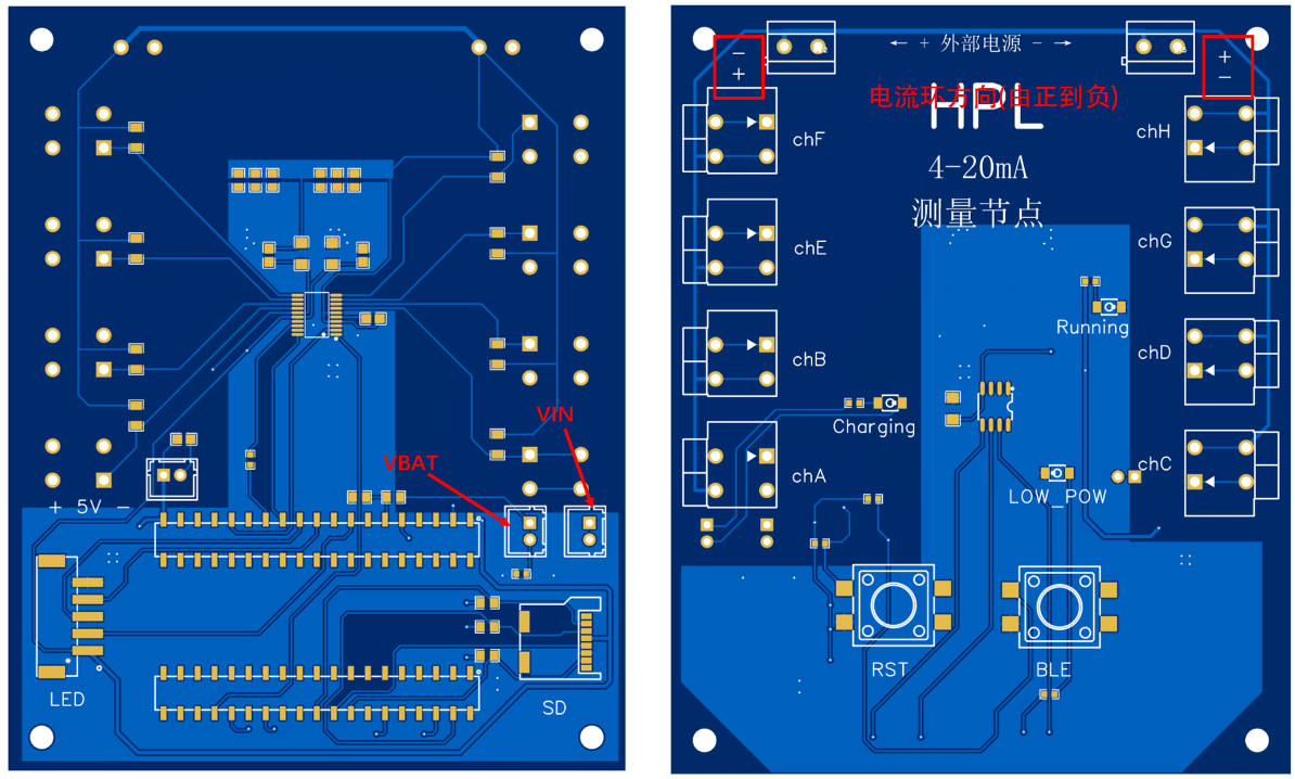

(3) Measuring board for 4-20mA current signal
        The measuring board for 4-20mA current signal is um_420. It uses a 150Ω precision sampling resistor to directly collect 4-20mA current, which will cause a maximum voltage drop of 3V. In my test environment, the current loop allows a maximum voltage drop of 12V. If the sampling resistor is too large, the sampling resistor can be reduced and an operational amplifier can be added. It should be ensured that the output voltage of the operational amplifier corresponding to 20mA is 3V.
        The PCB of um_420 is basically the same as that of um_op, with the top and bottom surfaces shown in the following figures:
        The um_420 PCB does not have a negative power supply and has two additional terminals. This is because 4-20mA signals generally require an external power supply (mostly 24V), and using a lithium battery would result in high energy consumption. The two terminals marked "External Power Supply" are shorted. One is connected to the power supply, and the other can be connected to another measurement board for cascading.

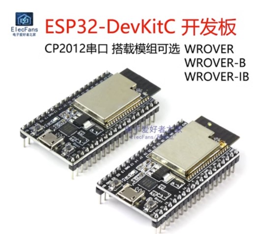

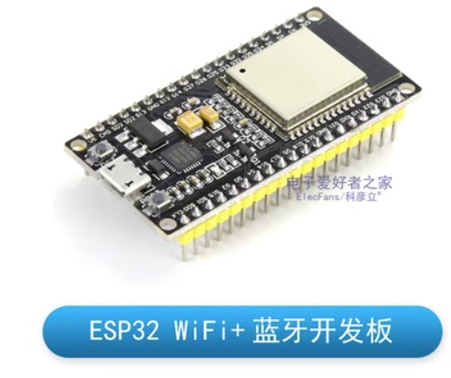

5.2 The microcontroller
        program is compiled using the Arduino IDE. Due to the large memory usage of the program, the ESP32-WroverB module (available on Taobao) is used as the microcontroller for the measurement board, directly inserted into the outer column of the two rows of 2*19P parallel surface mount headers.
        Note: The author recommends enabling PSRAM and changing the microcontroller partition to "HugeAPP".
        The microcontroller-related programs are attached. Among them, um is the measurement program for mounting an SD card. The program will not run properly if the SD card is not inserted. If the SD card is damaged or does not need to be mounted, please burn um_noSD: except for the SD card, the function is the same as um. The K-type thermocouple measurement board and the 4-20mA measurement board both use the above microcontroller program.
        The microcontroller program needs to import an external Websocket library. The library file is attached "arduinoWebsockets-master".

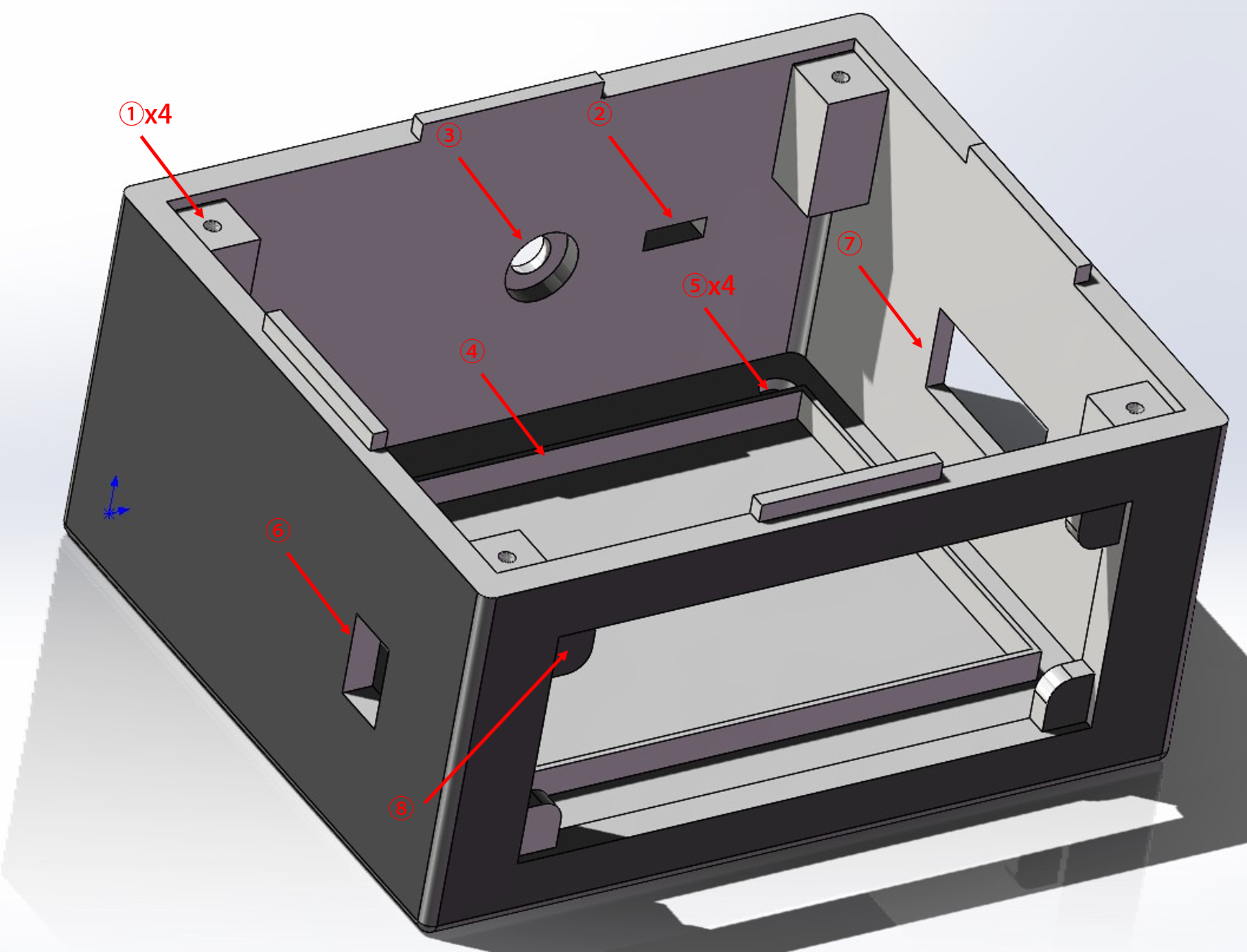

5.3 Measurement Node Housing
        The housing of the measurement node consists of two parts: the bottom shell and the top cover. Its 3D model is shown in the "um shell" in the engineering attachment.
        Note: The model scheme of the bottom shell is applicable to the power supply "UPS2".
(1) Bottom
        shell The side view of the bottom shell is as follows:
①: The four platforms with through holes on the top of the bottom shell are used to install the measurement board. These through holes are 2.5mm in diameter and correspond to the positions of the four through holes on the PCB board. Please use a tapping wrench to make M3 threads and then use bolts to fix the PCB on it.
②: Type C interface position. Please solder the PCB of "Type C-5V" (see 5.1-(1)), solder the positive and negative pads to the XH2.54 terminal wire, and then insert the male end of the terminal wire into the "VIN" socket of the power supply board "UPS2" (note the positive and negative directions). The type C socket is inserted into the square hole shown in ② through the inside of the bottom shell and fixed with glue.
③: Antenna interface reserved position. Since the signals collected by the measurement board are very small, they may be affected by strong electromagnetic fields around them. Therefore, such a hole is reserved on the shell to bring out the antenna of the microcontroller.
        If this is necessary, first solder the IPEX 1st generation antenna mount to the reserved position on the ESP32-WROVERB module, and change the soldering position of the nearby 0Ω resistor to connect it to the antenna mount (Baidu). Then use the IPEX to SMA adapter cable, connecting the IPEX end to the antenna mount, and leading the SMA mount end out from the inside of the bottom shell through the hole shown in ③, and fix it with glue. Then select the appropriate antenna according to the SMA interface type and install it on the SMA mount. The effect after installation is as follows:
        Finally, apply tin foil to all exposed surfaces of the top and bottom shells to shield against electromagnetic interference.
④: Reserved position for the power board. Its size is basically the same as the PCB size of "UPS" or "UPS2". After the power board is soldered, it can be installed in this position. For "UPS2", there are two 3.5 diameter through holes on the PCB board and the bottom shell, which can be fixed with M3 bolts.
⑤: Four mounting feet. Fix them to the bottom shell with M3 bolts. You can refer to the following specifications (Taobao):
⑥: Rocker switch mounting port. The rocker switch uses a 14*9 single-pole single-throw specification. Press it into the mounting hole shown in ⑥ from the outside, and then solder the wires on both feet to the corresponding pads on the power PCB (see 5.1-(1)).
⑦: Four-digit LED display mounting port. Install the four-digit LED display from the inside and fix it with glue. Connect the pins to the XH2.54-1x5P socket on the measuring board using an adapter cable. The pins corresponding to each pad on the PCB are shown in the figure below. Please pay attention to the correspondence between the LED display pins and the XH2.54 socket when soldering.
⑧: 18650 embedded battery box mounting position. In the new power supply design (“UPS2”), the 18650 battery is no longer used. Please leave this position empty. If using a PCB power supply solution called “UPS”, please install the battery box (from Taobao) shown in the figure below from the outside and fix it with glue.

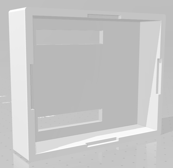

(2) Top cover
        The side view of the top cover is as follows:
        The top cover is installed on the bottom shell. There are two rectangular cutouts on the upper surface of the top cover. The wiring terminals of the measuring board PCB and the external wiring can be introduced through these cutouts.

        The PCB name of the control board is "USER_CTRL". It has an external power supply and uses a microcontroller to send control signals to change the state of eight solid-state relays, thereby changing the conduction and disconnection of the eight terminals with the power supply. The 2D diagram of the top and bottom surfaces of the PCB is as follows:
        On the top surface of the PCB, the bottom is the installation position of the eight solid-state relays. The relay used is the pin-type PM5D6132 (from Taobao), as shown in the figure below:
        The functions of each socket on the top surface are exactly the same as those of the measurement node.
        On the bottom of the PCB, the "DC_in" silkscreened terminal on the left is the external power input terminal, directly connected to a DC power supply; the "Trig" marked on the upper right is the trigger signal input terminal, connected to the synchronizer's output channel.
        Eight terminals are mounted on both sides of the bottom of the PCB. When a channel is open, a voltage will appear between the corresponding terminals, approximately the same magnitude as the external input voltage, in the same direction as the silkscreen; when the channel is closed, the terminals will exhibit a high impedance state.
        The "RST" and "BLE" buttons on the bottom have the same function as the measurement nodes.
        Six LED indicators are mounted on the bottom of the PCB, with the following functions:
① Ready: Lighting on indicates that the timing command from the server has been received, and the timing can be executed immediately upon the arrival of the trigger signal (the trigger signal will be explained below); not lighting on indicates that the timing command from the server has not been received, and the timing will not be executed upon the arrival of the trigger signal.
② BLE: Lighting on indicates that the device is in Bluetooth mode; not lighting on indicates that the device has exited Bluetooth mode.
③ Low_Power: Lighting on indicates that the battery is low
. ④ Running: Lighting on when the control board is powered on and off when power is lost.
⑤ Charging: Light up indicates charging.
⑥ Connect: Flashing indicates attempting to connect to WiFi; solid light indicates already connected to WiFi.

        The synchronizer's PCB is named "TRIG2," and its top and bottom surfaces are shown below:
        On the top surface, the pad with the silkscreen "BAT" is the single-cell lithium battery interface. The lithium battery leads are directly soldered to the corresponding position on the PCB. Below this, the component with four rectangular pads is a 5V DC-DC boost converter (available online), as shown below:
        On the bottom surface, there are eight trigger signal transmitting terminals on each side, connected in parallel, with the positive and negative terminals as indicated by the silkscreen. During use, these terminals must be connected to the trigger receiving terminals of the control boards.
        On the bottom, the functions of the indicator lights and buttons are the same as those on the control board, and will not be repeated here.
(4) Emergency stop board
        experiment In case of an emergency, people can quickly press the emergency stop button to achieve protection. For the control board, in an emergency, some channels need to be closed, and the rest need to be kept open.
        The PCB name of the emergency stop board is "EMER", and its schematic diagram is as follows.
        In order for the emergency stop to work, please distinguish in advance which channels of each control board need to be closed and which need to be open in the emergency stop state. Then perform the following operations on the power supply of each control board and the channels that need to be open:
a. Solder the two ends of the DC power supply to the connection positions of +24V and GND respectively.
b. Lead out a wire from GND as the negative terminal of the external power supply of each control board; lead out a wire from the pad shown in ② as the positive terminal of the external power supply of each control board.
c. Select two normally open pins of an emergency stop switch, solder one end to the pad of +24V, and the other end to the pad shown in ①.
d. There are seven green terminals around the emergency stop board. For channels that need to be closed in emergency stop mode, connect the negative terminal of the channel directly to the load, connect its positive terminal to the positive terminal of the green terminal on the emergency stop board, and then lead a wire from the negative terminal of the green terminal on the emergency stop board to the load. Looking down from the top, in a clockwise direction, the two terminals of each green terminal are the positive and negative terminals respectively. See 6.1-(5) for the specific wiring diagram.
e. Press the emergency stop switch in emergency mode to disconnect all external voltages of all control boards. Channels not connected to the emergency stop board will be in a high-resistance state, and channels connected to the emergency stop board will output power supply voltage.
        Note: When selecting wires, especially power supply wires, please pay attention to the magnitude of the load current on the wires and select the appropriate wire diameter according to the allowable temperature rise.
        Note: One emergency stop board can support a maximum of seven channels that need to be open. If more emergency stop boards are needed to work together, please connect them to the same power supply and emergency stop switch.
        Note: The pads of the emergency stop board are relatively compact. Please be careful to avoid short circuits caused by wire contact.
(5) The connection method of the control board, emergency stop board, trigger, power supply, emergency stop switch and load
        is shown in the figure below (the microcontroller and its power supply have been omitted):
        In the figure, loads 1 and 3 need to be powered on in emergency situations, and loads 2 and 4 need to be powered off in emergency situations.
        Since the author used a 24V DC power supply during debugging, some pins have network names related to "24V". In fact, the input range of the external power supply is 5-30VDC, depending on the load.

        control board and synchronizer both use ESP-WROOM32 microcontrollers, as shown in the figure below (Taobao).
        Both programs are compiled by ArduinoIDE. The Websocket library file can be found in the attachment "arduinoWebsockets-master".

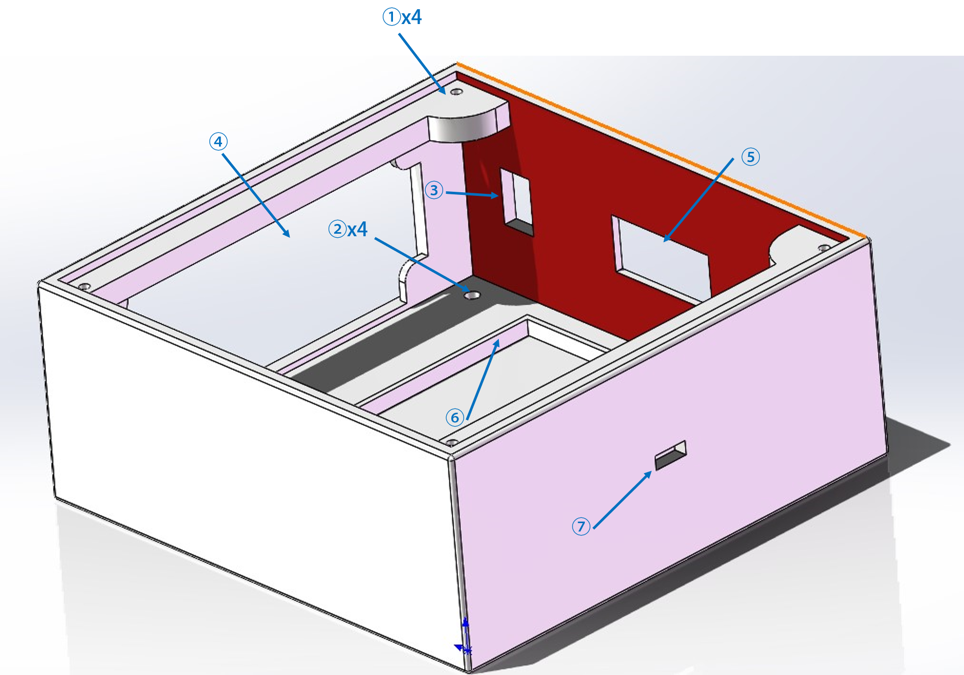

6.3 3D Shell
6.3.1 Control Board Housing

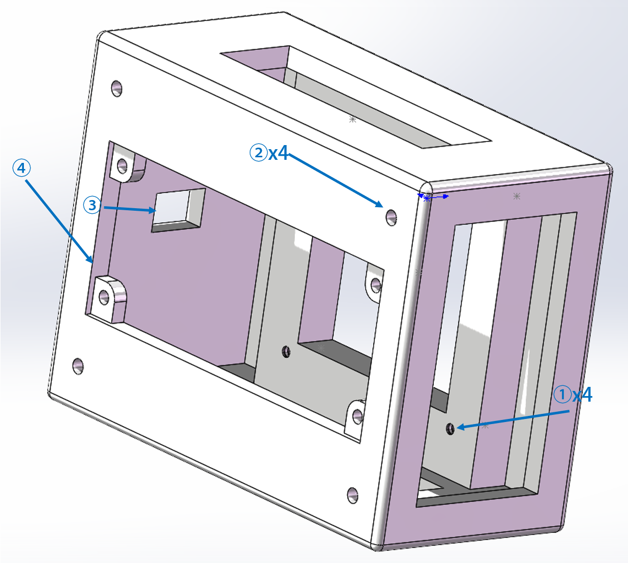

        The side view of the control board housing is as follows:
        Most of the housing design is similar to the bottom housing of the measurement node in 5.3-(1), and is only briefly described here:
① Four 2.5mm diameter through holes, tapped with M3 screws, for mounting the control board PCB
② Machine foot mounting holes, 3.5mm diameter
③ Boat switch mounting port, 14*9mm
④ Embedded battery box mounting port, installed from the outside, glued
⑤ LED four-digit digital tube mounting port, installed from the inside, glued
⑥ Power board mounting position. Either "UPS" or "UPS2" power board can make the microcontroller work normally. If the "UPS2" PCB is used, the battery box shown in ④ does not need to be installed.
⑦ Type C interface mounting position, installed from the inside, glued.

③ Open the auxiliary program and connect to the server.
④ In the “Measurement Node Management” tab of the auxiliary program, check the number of online links and their network latency.
⑤ After confirming all nodes are online, click "Execute Preparation" to start the measurement.
⑥ Open localhost/user_measure in your browser to view real-time data. For other users in the WLAN besides the server, please replace localhost with the server's address in the WLAN, for example: 192.168.43.5/user_measure
. ⑦ After the experiment, click "Execute Preparation" again to stop the measurement.

② If timing control is used
, a. Open the auxiliary program and connect to the server
. b. Enter the "Timing Edit" tab to configure the timing of each channel and save the file locally.
c. Enter the "Timing View" tab to open the timing file, check the timing graph, and send it to the server (see 4.5).
d. Enter the "Control Node Management" tab to check the number of online links and their network latency. Click "Start Injection" to send the timing file to each node.
e. Click "Execution Preparation" to put each node into the waiting trigger state.
f. Go to the "Timing Startup" tab, enter the startup key, and click "Start". The timing will begin execution after 5 seconds.

: a. Access "localhost/user_control" through your browser, register an account, and log in.
b. Add the required control channel name. The name format is "[s0XX]N", for example, [s009]A. (See 4.3-(2))
c. Control the opening and closing of the channel by clicking "ON/OFF".
