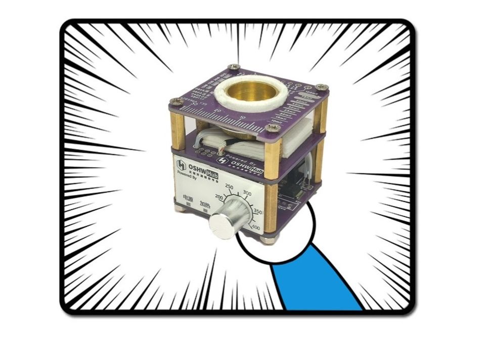

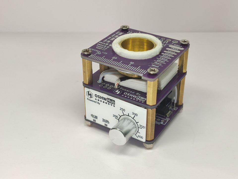

This is a mini soldering furnace,
small in size, low in cost, and suitable for amateur, low-intensity use by electronics enthusiasts. It is powered by a Type-C or 12V-DC power supply. The hardware
schematic is available at:
https://oshwhub.com/code504/mi-ni-xi-lu
(Hardware updates will primarily be made on oshwhub; unless there are special circumstances, Gitee will only update the documentation, not the project files). A video demo is available at
: https://gitee.com/dma/mini_solder_furnace

Production instructions
Please read carefully before making it. I have almost encountered all the pitfalls

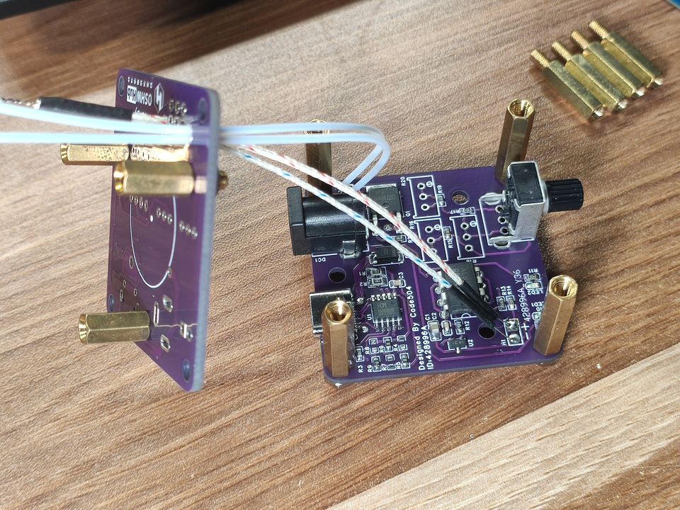

. The structure is very simple. Two main boards and one fixing board can be assembled as shown in the figure. Here are some details and places where mistakes are easy to make.

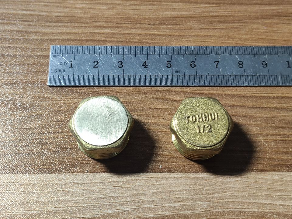

Buy the kind of copper plug with a flat bottom. The picture below is an incorrect example. I did not pay attention and bought one with a raised printed bottom. You can only manually grind

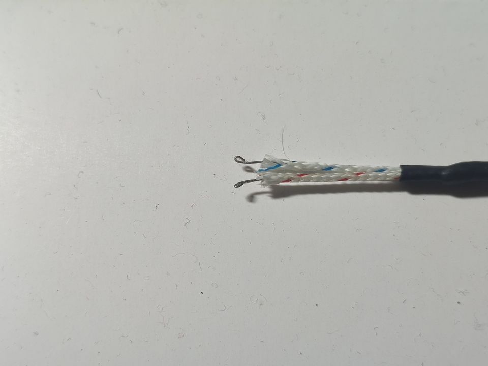

the two leads of the thermocouple, especially the positive lead, which is difficult to be wetted by solder (commonly known as not being soldered). It is easy to fall off when soldered using conventional methods. You can do it like me, make a ring at the wire end, and then embed the ring in the solder. The shape of the solder after cooling will fix it. Using screw posts for fixing is also an option, but currently, making a ring is probably the simplest method.

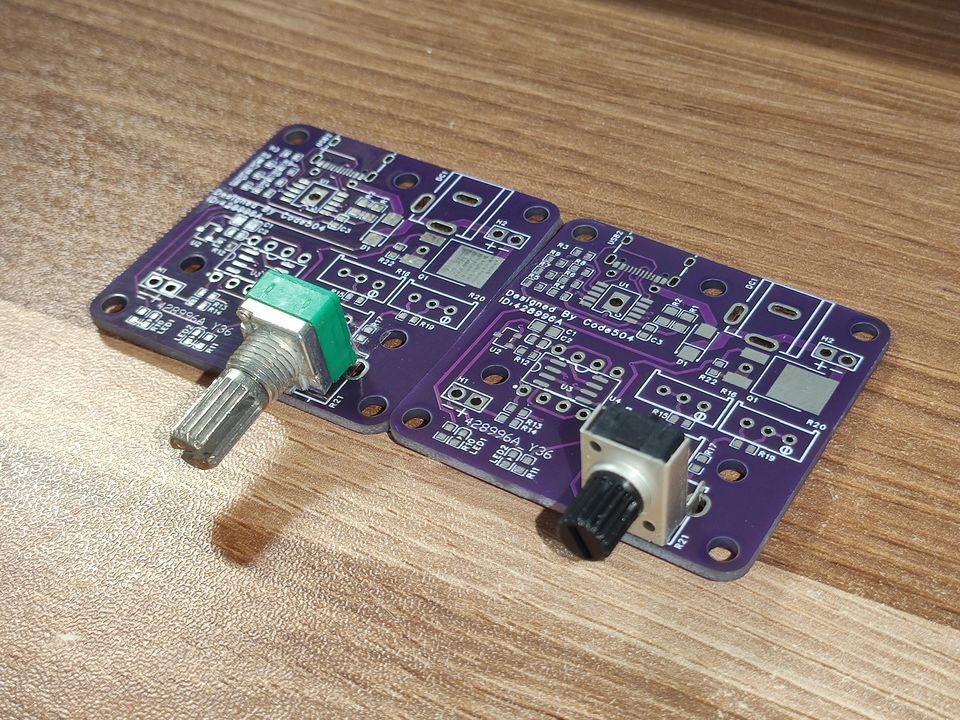

The motherboard has pre-drilled pads for RV09 and RK097 potentiometers. The installation effect of the two potentiometers is as follows:

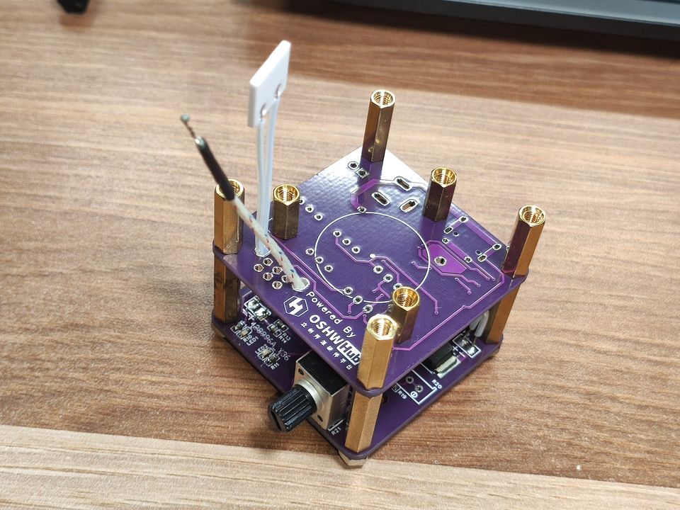

The heating element and thermocouple wires can be passed through any suitable hole on the circuit board.
The motherboard has three screw holes for fixing the plugs. Maximize the use of every inch of space on the motherboard

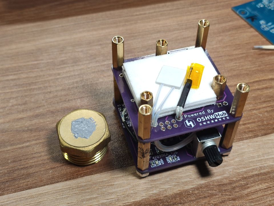

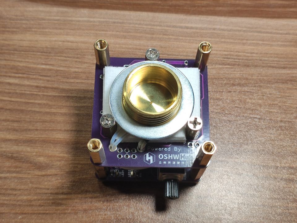

by cutting appropriately sized insulation cotton, approximately 5mm thick. Place the ceramic heating element and K-type thermocouple on top of the insulation cotton. The thermocouple should not be directly against the heating element; leave a 1mm gap, otherwise the measured temperature will be too high.

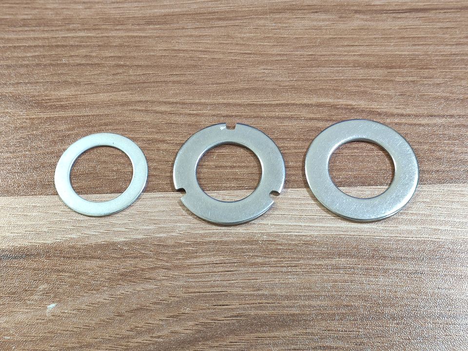

Apply a suitable amount of silicone grease to the thermocouple, place the copper plug on it, and fix the copper plug with a washer. The washer is fixed with a copper post, with a copper post height of 10mm.
If you buy a washer with an inner diameter of 20mm and an outer diameter of 37mm, you need to manually grind the grooves corresponding to the three screw holes. Choose a material like galvanized iron; never choose stainless steel, as stainless steel is expensive, hard, and difficult to grind. If you buy a 20mm inner diameter and 30mm outer diameter gasket, you don't need to do any processing; just install it directly.
The holes on the mounting plate are specially designed to be larger than the copper plugs, and you need to pad the edges with 2 to 3mm thick heat insulation cotton. The final product is shown in
