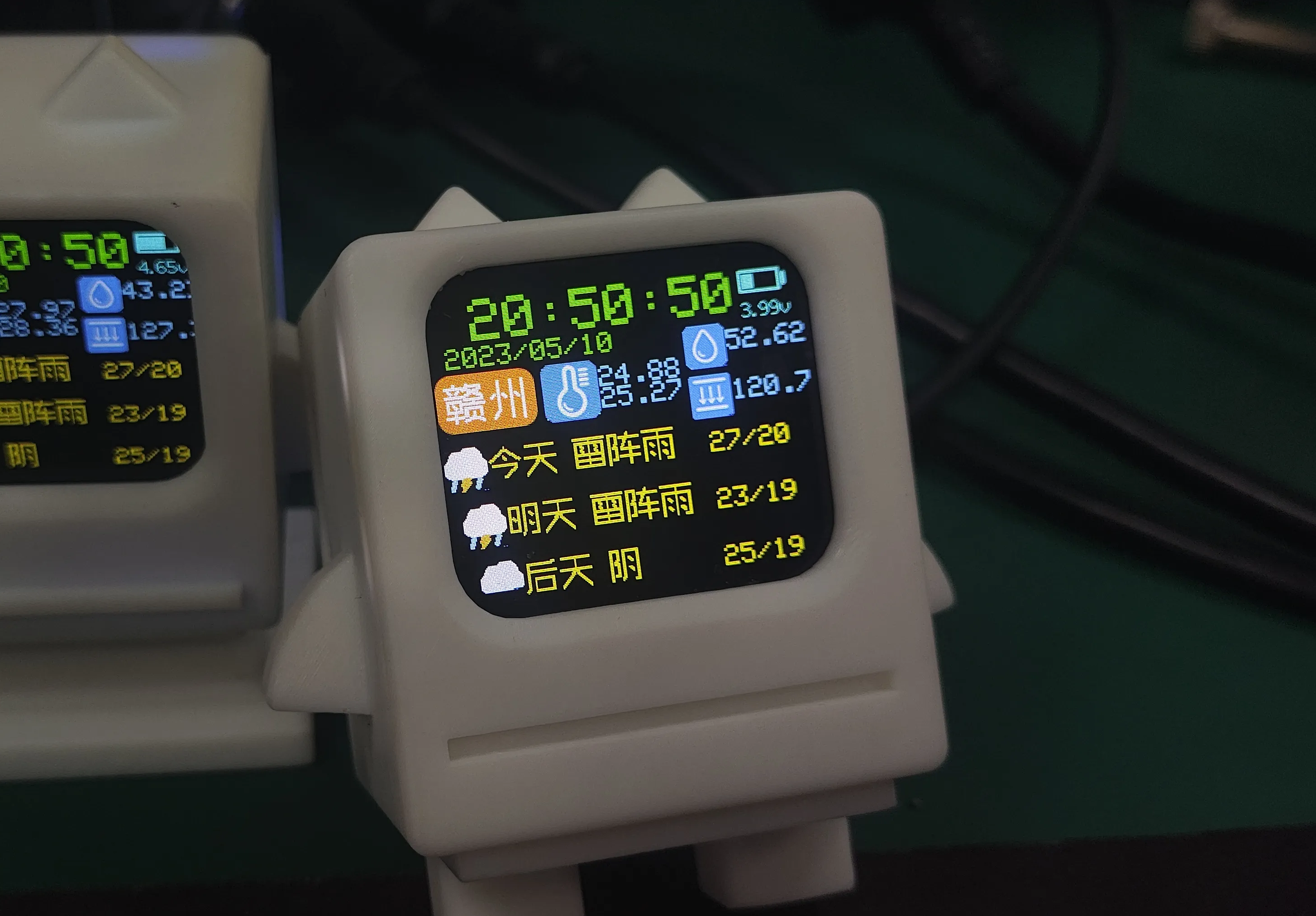

   Project Introduction: This project uses the ESP32-WROOM series domestic WiFi chip as the main control chip. Local sensors, specifically the SHT30 and BMP280 temperature, humidity, and barometric pressure sensors, are used to detect and display local temperature data in real time. The main control unit automatically obtains its location and weather conditions via IP address. The built-in light sensor automatically adjusts the screen brightness based on ambient light intensity and features OTA remote firmware upgrade functionality.
