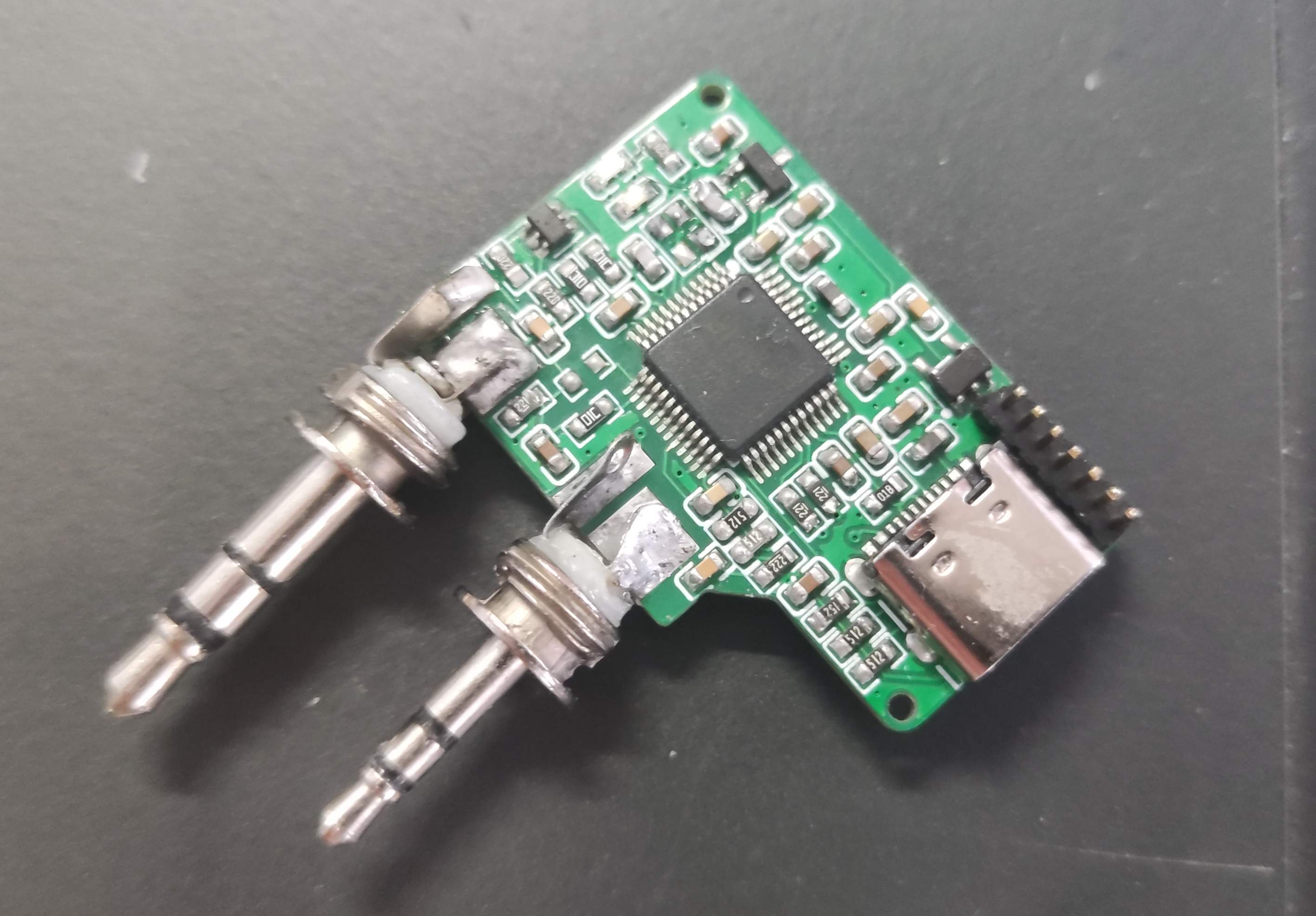

This project briefly introduces
how a program written in an STM32 microcontroller enables a device to exhibit the same characteristics as the CM108 sound card, allowing control of the PTT (Push-to-Talk) via DireWorf software. It also features serial port control of the PTT and can be used with APRSDroid on mobile phones.
This project redesigned some circuitry using LCSC EDA, maintaining functional compatibility with the original. The original author, skuep,
has attached a GitHub page with a brief explanation of how to use it in the "How to use" section.
Additional notes:
Because many audio plugs use low-quality plastic that is not heat-resistant, the soldering points and audio contacts are often pressed together with plastic. Therefore, soldering audio plugs must be done quickly. If the soldering speed is too slow, the high temperature may cause the plastic to melt and deform, leading to poor contact or a short circuit. Poor contact may cause partial functional failure, while a short circuit may trigger transmission when the handheld radio is plugged in. Therefore, when soldering audio plugs, it is essential to operate quickly and minimize the soldering temperature.
If the audio plug does not readily accept solder, consider using "stainless steel flux." However, please note: Flux increases the contact area of ​​the solder, which leads to a significant increase in heat transfer efficiency, making the plastic plug more susceptible to melting. Therefore, please use it with caution.
During transmission, the radio can easily interfere with USB communication. This interference manifests as an inability to stop transmission once PTT transmission is controlled via software. This is likely because electromagnetic waves interfere with USB communication, preventing the command to stop transmission from reaching the AIOC. Therefore, using a high-quality and as short as possible USB cable is essential.
The plug plastic is also soluble in board cleaning solution, so avoid contact with board cleaning solution after soldering the plug.
Use when both QR codes correspond to white and black silkscreen printing. White silkscreen printing is used by default.

This gives you 5 (or more) SMD assembled AIOC. The only thing left to do is soldering on the TRS connectors (see here).
The total bill should be around 60$ US for 5 pieces plus tax and shipping from China.
How To Assemble
This is the process I use for building. See photographs in images folder.
You need to use Monacor PG-204P and PG-203P or compatible TRS connectors (2 solder lugs and a big tab for the sleeve connection)
Cut the 2.5mm and 3.5mm TRS sleeve tab where the hole is located
Put both TRS connectors into the 3d-printed solder guide (or a cheap HT that you don't mind potentially damaging). Make sure, that they are seated all the way in. If the holes in the solder guide are too small, you can ream them using a 2.5mm and 3.5mm drill bit.
Insert the AIOC PCB into the solder guide
Solder sleeve tab on the back side for both TRS connectors first
Turn around PCB and solder remaining solder lugs
