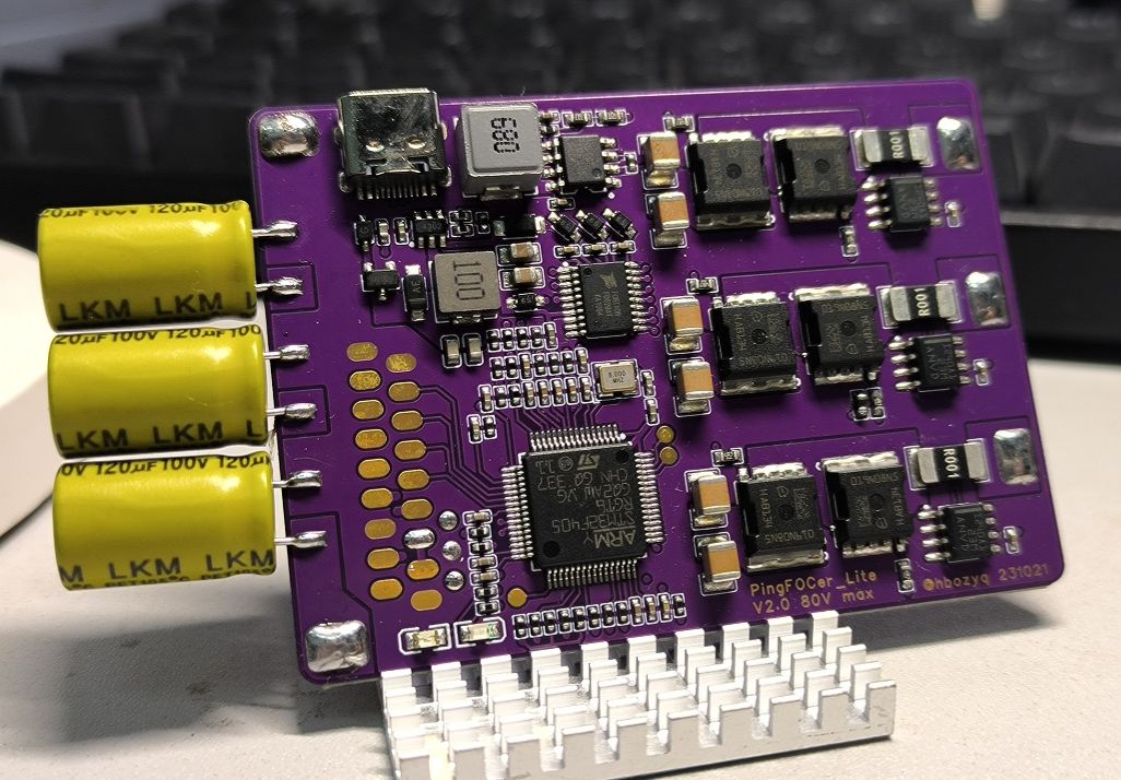

Features:
High power: Output power exceeds 1.5KW (actually measured)
Small size: Dimensions are 50*70*8mm (excluding wires and electrolytic capacitors)
Easy to order and install Use: PCB body can be sampled for free (6 layers), all SMD components are on the same side of the PCB, JLCSMT's economical surface mount service can be used (and is recommended)
Uses USB Type-C
three-phase current sampling, can use silent HFI function
I/O with ESD protection
USB does not draw power, requires connection to power to operate
Electrical specifications
Phase current: Continuous 60A (tested, requires external heatsink and forced cooling), instantaneous current >75A, sampling current range: ±82.5A
Maximum input voltage: 80V (absolute value, should not be exceeded at any time)
Recommended input voltage:
Disadvantages
Uses custom firmware that is not currently supported by the VESC project, requires self-compilation.
The hardware connector is inconsistent with the standard VESC, requiring soldering.
It lacks CAN functionality (too much space).
[Image of the actual product ]
Other considerations:
The current amplifier is compatible with INA240 and AD8418. Note the package and amplification factor.
The MOS used is the IST019N08NM5AUMA1 (80V 1.9mR) available from LCSC. Alternatively, salvaged parts such as IAUA250N08 (80V 1.8mR) can be selected; this package should not currently have counterfeit products.
The BOM does not include a large bus filter capacitor (10mm diameter), requiring the use of high-frequency, low-resistance electrolytic capacitors; solid-state capacitors are recommended.
The verification board uses 6-layer 2OZ thick copper, which is relatively expensive. Free samples of 1OZ/0.5OZ have slightly lower thermal performance but are cheaper; the choice is yours. (Group buying could be considered to lower the price.)
