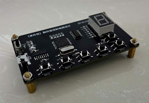

1)器件焊接
  第一,先焊接Micro USB接口;第二,焊接CH340CCD4511BESTC89C52RC(焊接芯片时要注意方向,别焊反了);第三,电阻、电容和LED;第四,晶振和按键;第五,排针、开关和数码管。
6-1 PCB装配图
6-2 未焊接PCB
  注意焊接过程中用电安全手不要接触到烙铁头,避免烫伤。焊接时元器件对准位置,检查型号是否正确。焊接贴片元器件用镊子夹住时,要等焊锡凝固后再移走镊子,否则易造成虚焊。焊接过程注意锡线是否虚焊漏焊,避免影响电路性能,导致电路不能正常工作。
6-3 PCBA实物图
6-4 PCB-3D渲染图
(2)硬件调试
  若焊工比较粗糙,在焊接完一种元器件,可以目测检查是否短路,也可用万用表检查。焊接完成后需要使用万用表检查电源与地是否短路,焊接过程中有没有出现短路以及断路的情况,检查无误后方能进行上电测试。
During the debugging process, it was found that the CH340C would backflow and light up the power indicator light. This caused an abnormal phenomenon that the power indicator light also lit up when the toggle switch was not turned on. Therefore, a pin header J1 was added in front of the CH340C , and a short-circuit cap was used when programming and downloading. Short-circuit pin header J1 , CH340C is working and programming. When not downloading and programming, pull out the short-circuit cap, CH340C will not work, reducing the power consumption of the board.
