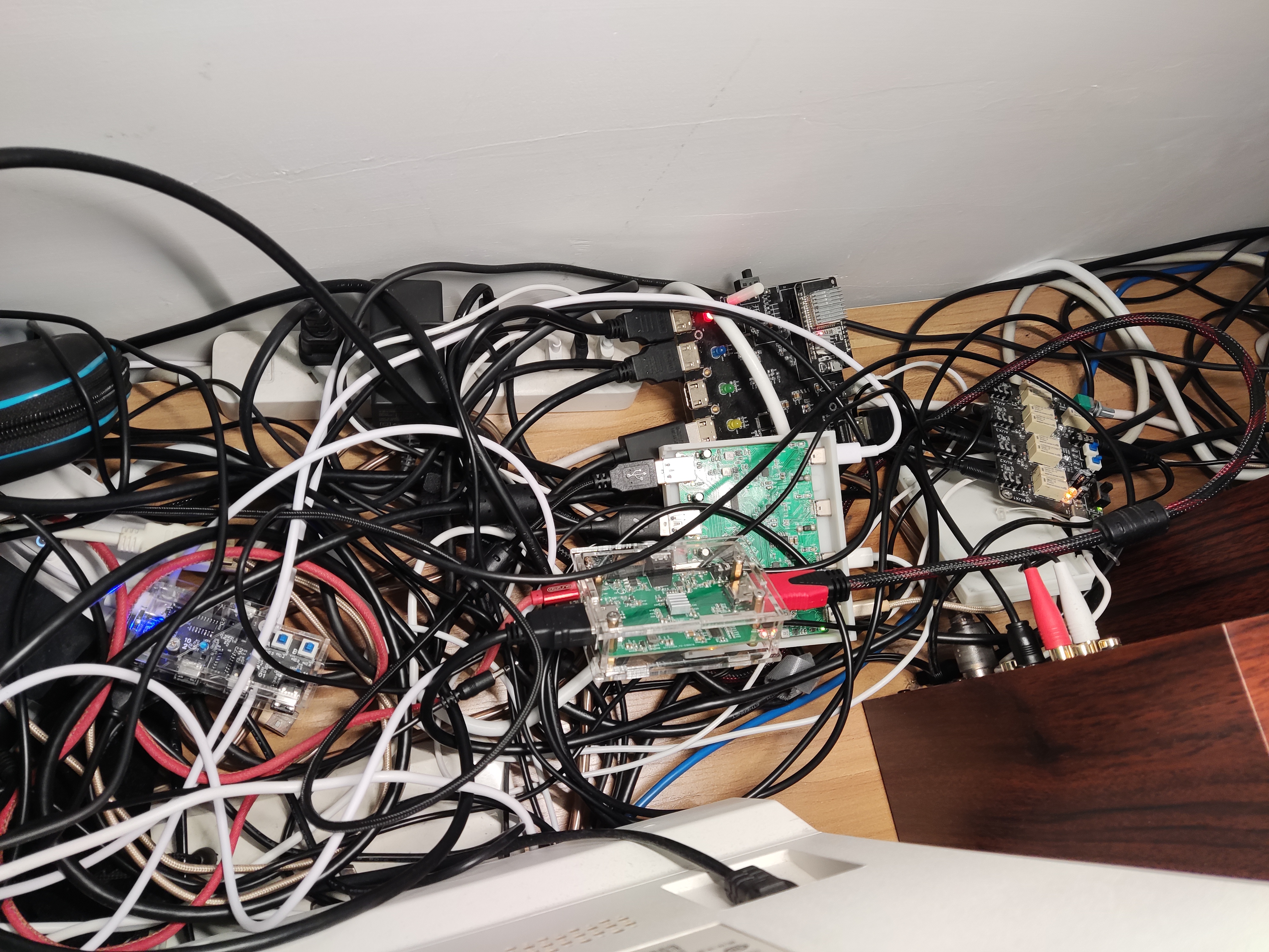

I have many HDMI and audio devices, including various Raspberry Pis, Orange Pis, desktops, laptops, game consoles, disc players, and cassette players.
However, I only have one monitor and one speaker. Therefore, I wanted to share these peripherals among these devices, which is where the switcher comes in.
There are many
HDMI switchers on the market: HDMI
audio decoders,
audio switchers, and
fiber optic switchers.
However, they are expensive, and each component is separate, making wiring cumbersome.
Although the price wasn't their problem, it was mine—I simply couldn't afford it!
But I could do it myself.

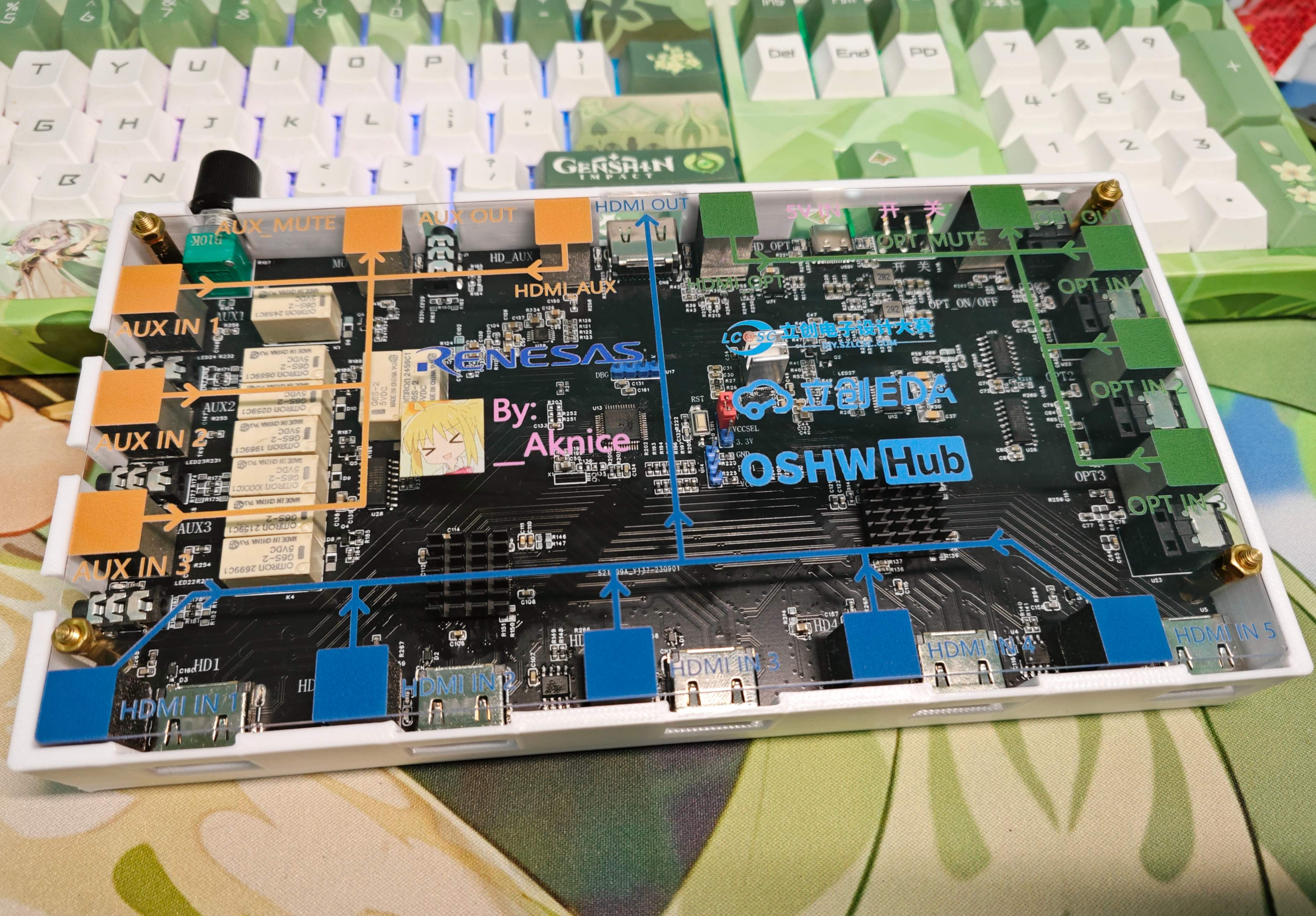

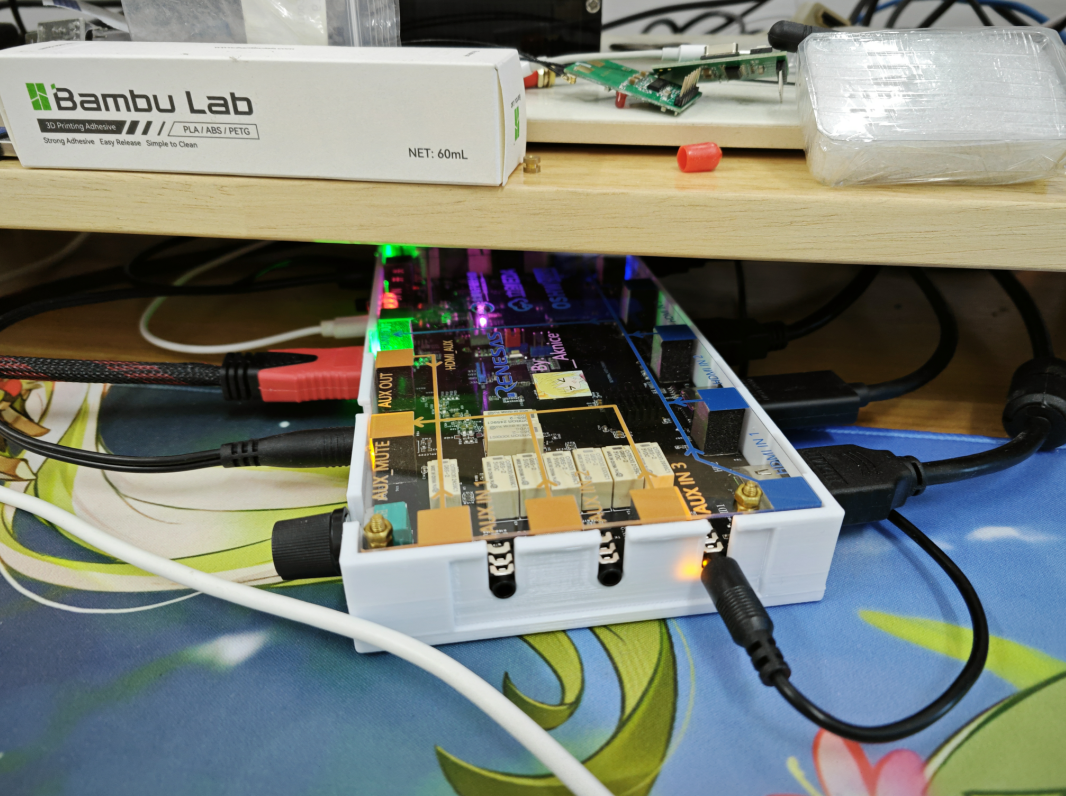

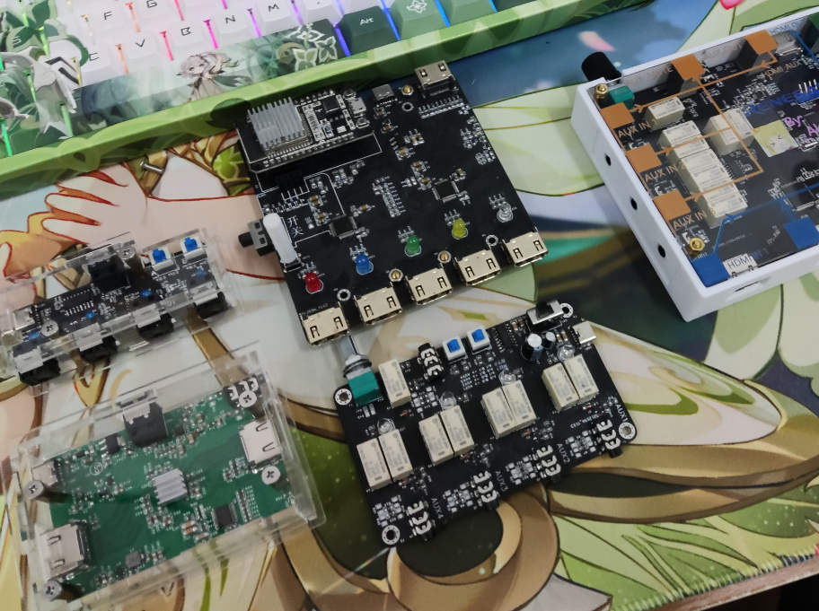

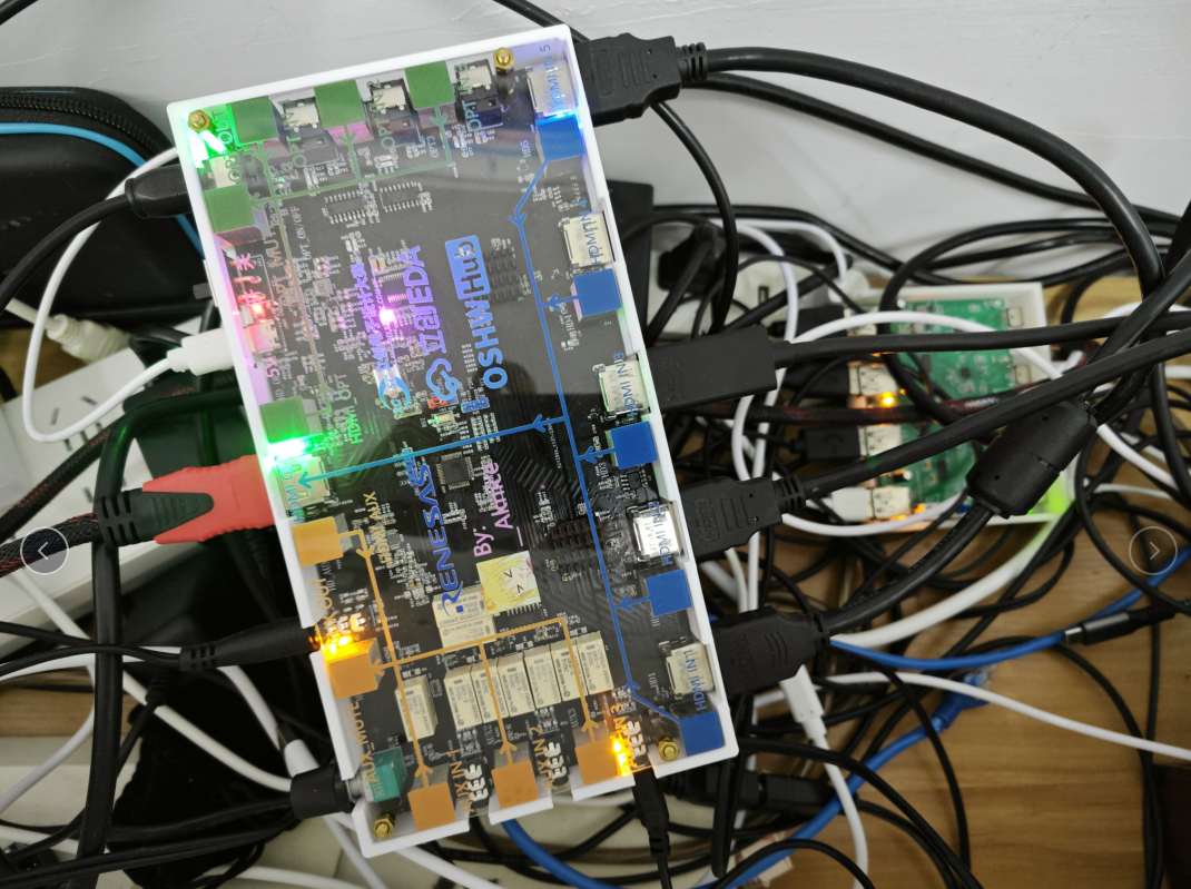

So, this is what the back of my computer looked like before—a complete mess.
This was a compilation of several projects, so there were a lot of cables.
With this integrated solution, I could remove and
replace everything. Afterward
, there were far fewer cables, and it looked much better than before, but it was still messy (sad).
So, I placed the switcher under the monitor, so I could just take it out when switching.

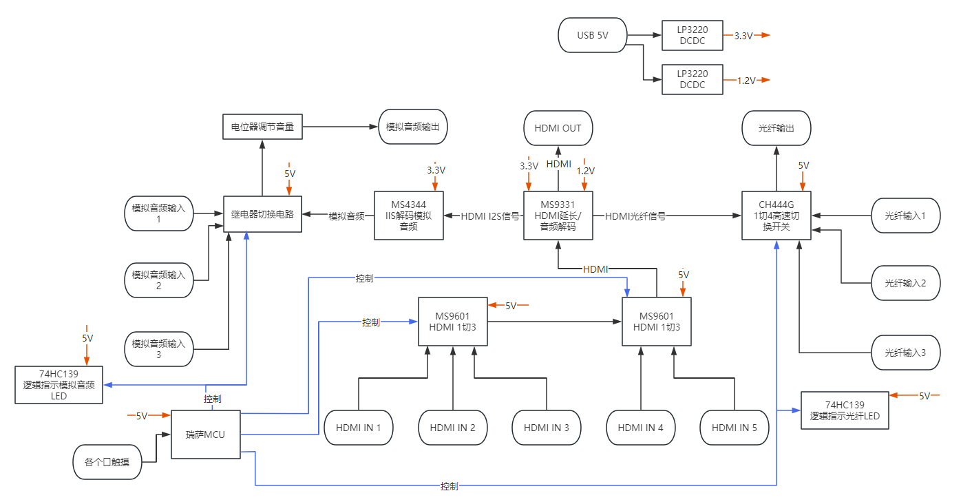

3. Block Diagram
The main block diagram is as follows. Note the power supply usage. The analog audio and optical fiber light indicators and controls use the same set of control signals. The layout
can basically refer to the block diagram.

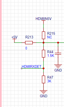

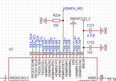

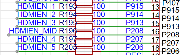

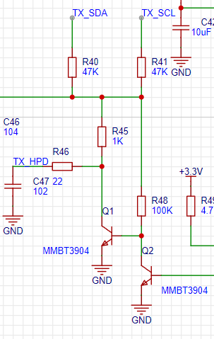

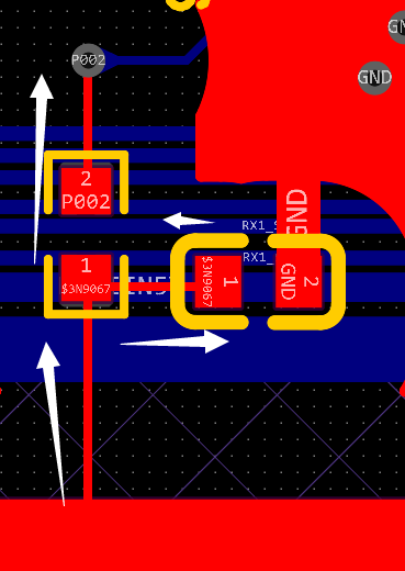

4.1 Controlling HDMI Signals
According to the MS9601 datasheet, the RX HPD signal can be sent to the corresponding port to switch the corresponding HDMI to that port.
Therefore, the control is very simple; you only need to control the HPD high and low levels.
Often, after the input device detects HPD, it will output a differential video signal.
First, we need to understand the working principle of HPD (hot-swappable):
HDMI has input and output terminals. The input is the monitor, and here we have HDMI 3 inputs. The output is the computer graphics card, and here we have HDMI 1 output.
When an output device is connected to an input device, the input device will output the video signal at high speed via the HPD signal line. Once the input is ready, the input device will begin EDID communication and video signal transmission.
Therefore, controlling HPD controls the input device, specifically whether the MS9601 initiates EDID communication with the output device.
HDMIEN_MID is an intermediate signal relay, controlling the switching between input from chip 2 and output from chip 1. When using HDMI1, HDMI2, and HDMI3, HDMIEN_MID needs to be pulled high to switch inputs to chip 1.
4.2 HDMI Signal Flow
: As shown in the block diagram, HDMI signals 1, 2, and 3 are input to the preceding chip of the MS9601. This chip then outputs to the input of a subsequent chip, and HDMI signals 4 and 5 also enter the subsequent chip.
The signal input and output between these two chips can be directly connected.
The output of the latter chip is then fed to the MS9331. The 9331 detects and directly uses 5V for the HDMI DET
HPD input signal, retaining the original input method of two 3904s. A 47K

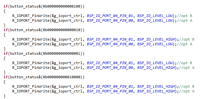

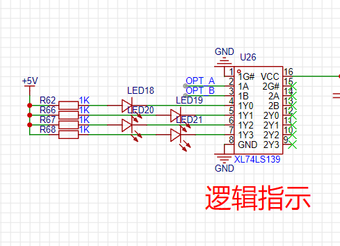

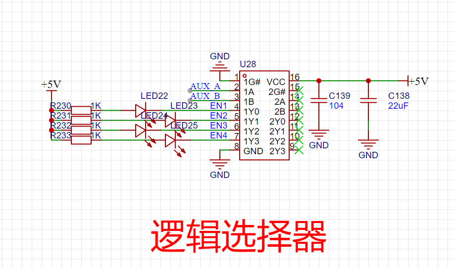

4.3 indicator light is pulled up by the IIC
. Due to the limited port resources of the RA chip, it is impossible to allocate four I/O ports for OPT and AUX control. However, two I/O ports can output four states, which can still be used for switching and indication. For indication, a 74LS139 logic chip
can be OPT as an example:
A:0 B:0 -> OPT1 A:1 B:0 -> OPT2 A:0 B:1 -> OPT3 A:1 B:1 -> OPT4
The same applies to AUX.

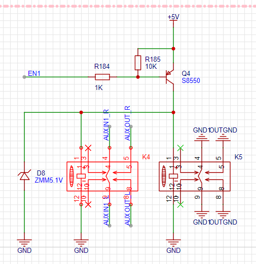

4.4 AUX
analog audio is directly switched using a relay, a pure physical switching, ensuring the original analog audio quality without going through a digital switcher!
The analog audio side has a separate ground wire, which is not connected to the entire GND circuit, resulting in the purest original sound quality (very Hi-Fi).
Therefore, an additional GND switching relay is needed.
The AUX input, besides indicating, also needs to control the relay's enable function, hence the output EN1234, connected to the relay's transistor control.

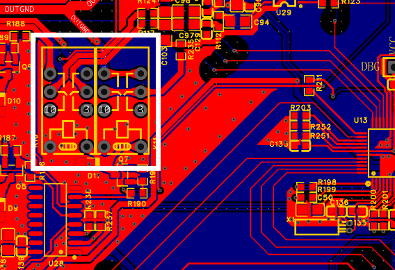

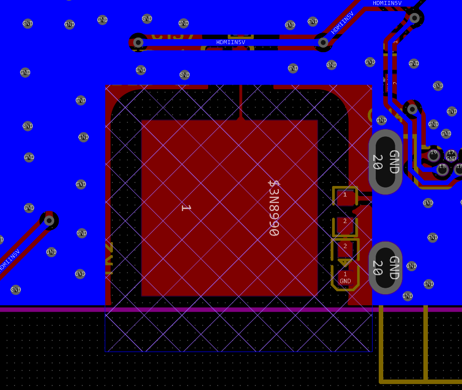

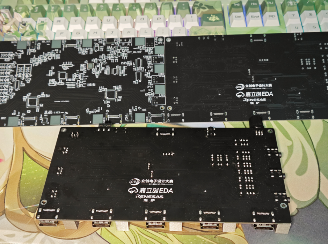

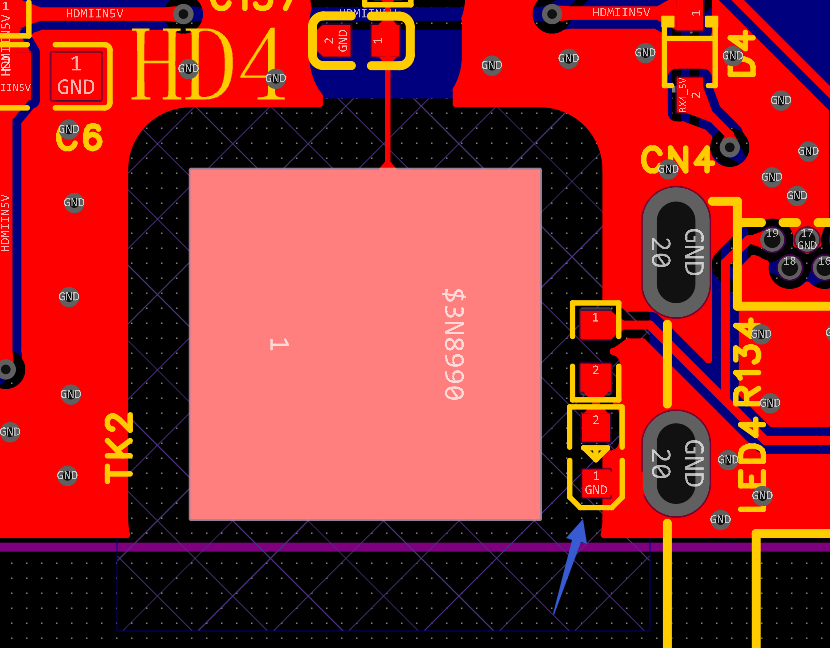

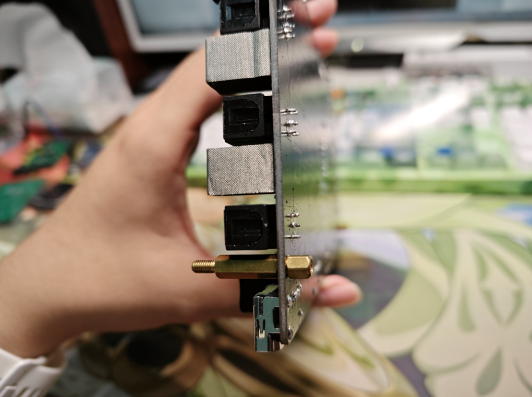

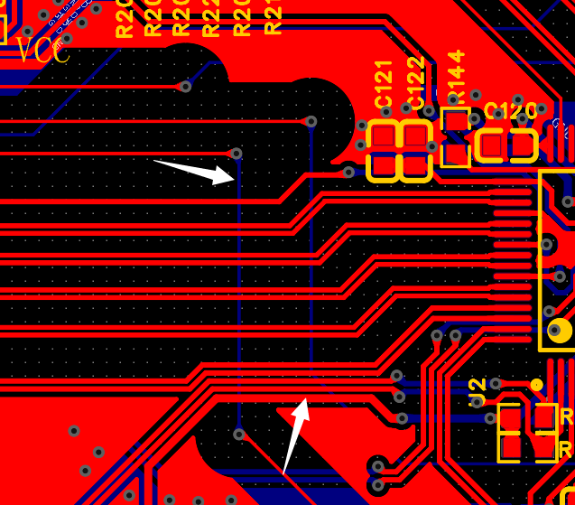

LAYOUT: The most technically demanding part of this project is the layout. Due to the use of a large 20x10 PCB, a double-sided board is used to reduce manufacturing costs, but this increases the wiring difficulty. Therefore, pre-planning various rules is essential.
This project uses HDMI high-speed signals, requiring high-precision wiring. However, the interaction uses touch, and touch signals also have high wiring requirements. The analog audio switching signals also have high wiring requirements. The combination of these three factors significantly increases the difficulty.

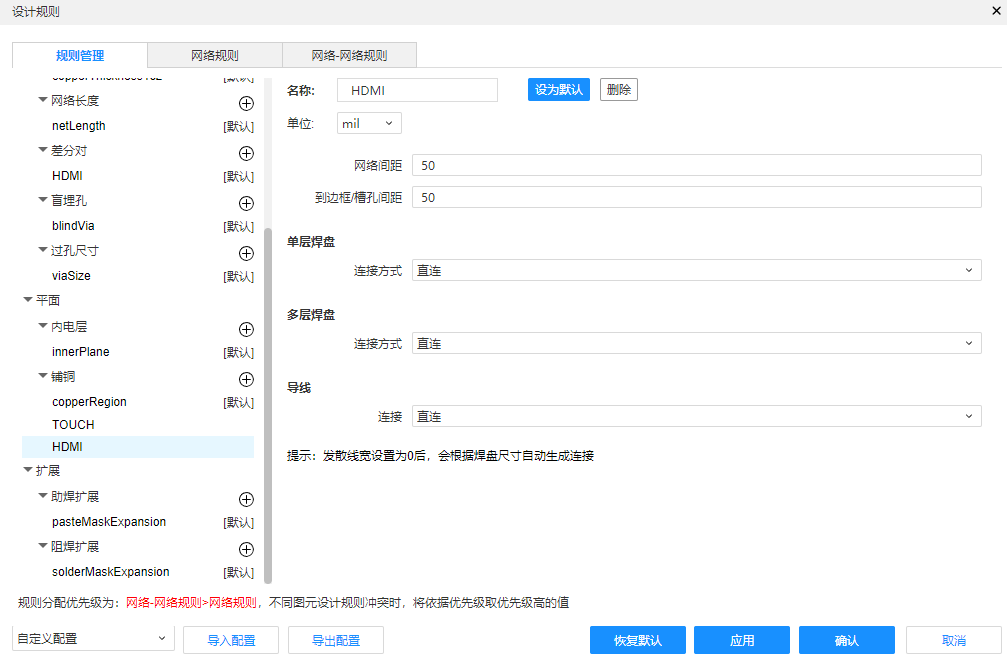

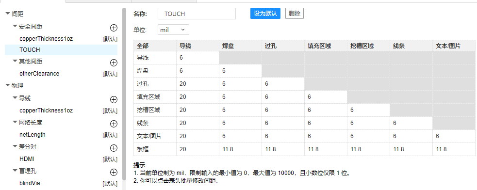

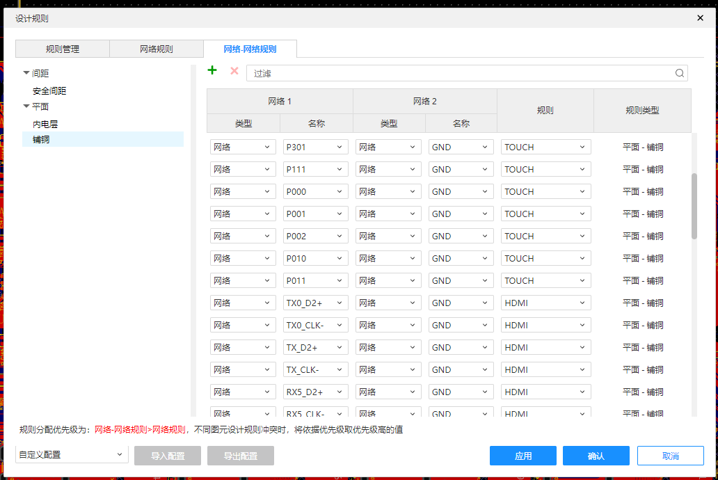

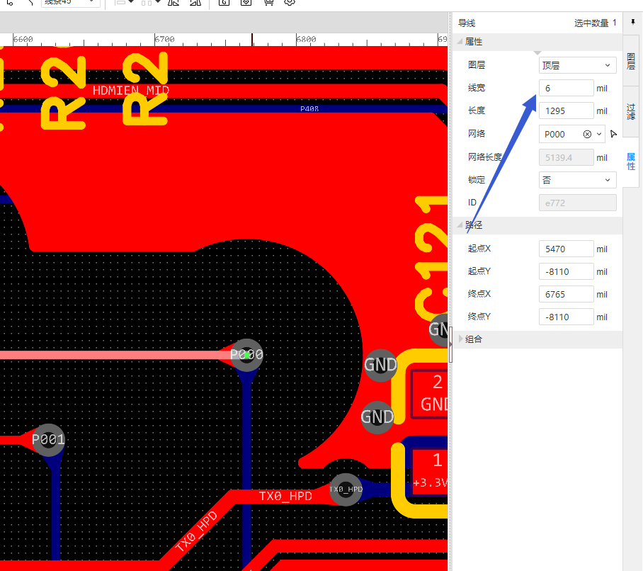

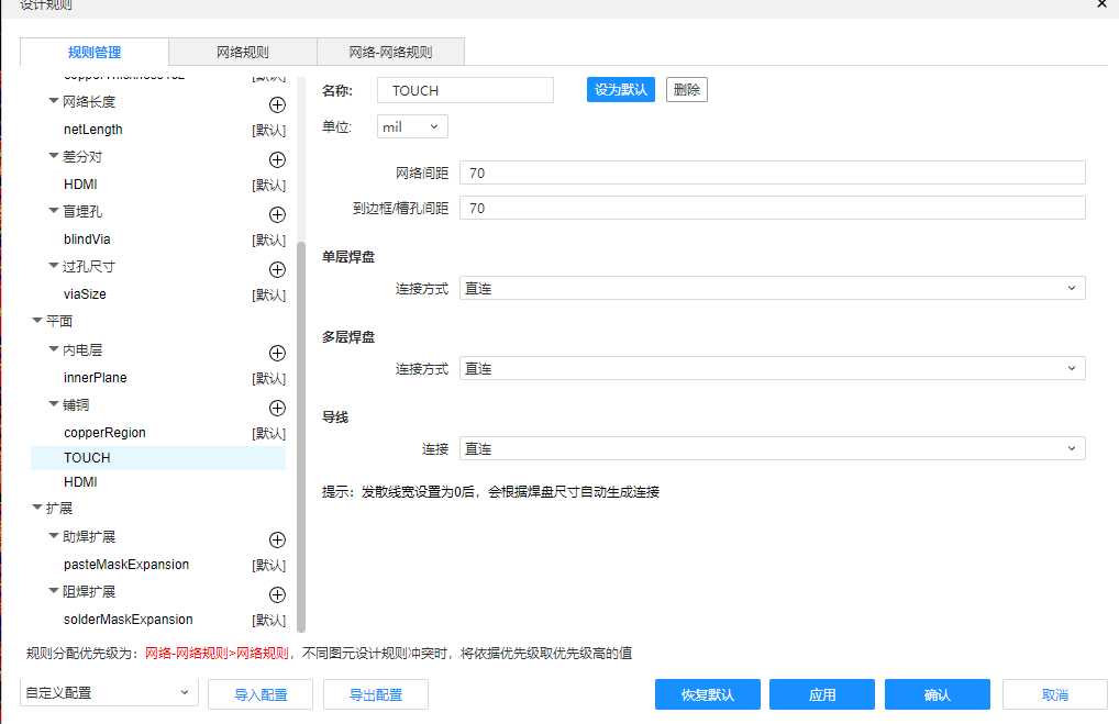

5.1 Safety Spacing
Settings: Touch safety spacing
. 5.2 Copper Pour Spacing
Settings: Copper pour spacing for touch and HDMI. It is recommended to set a larger spacing
for touch. Set corresponding rules for both HDMI and touch signal networks.

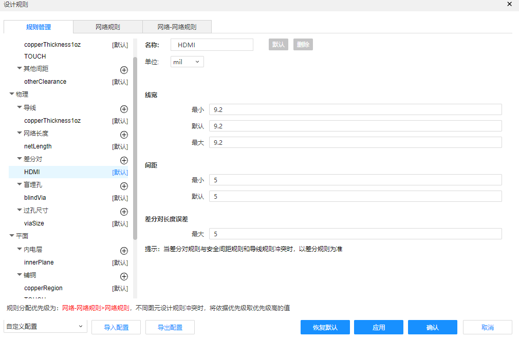

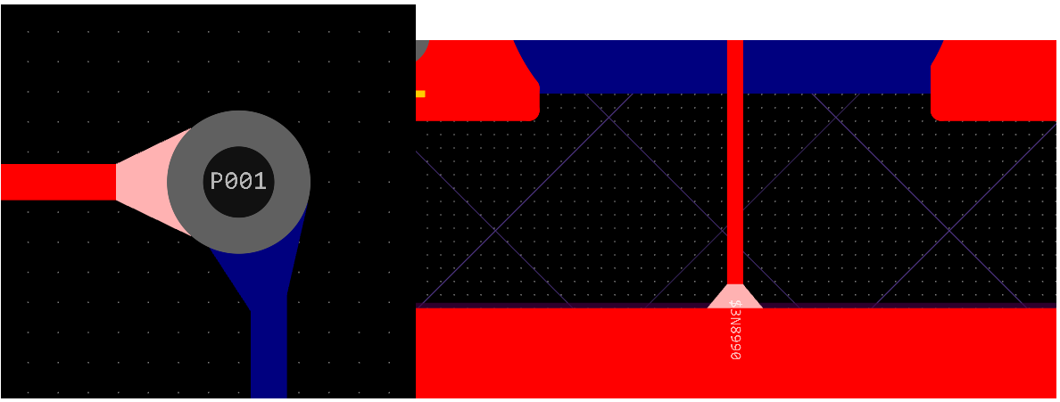

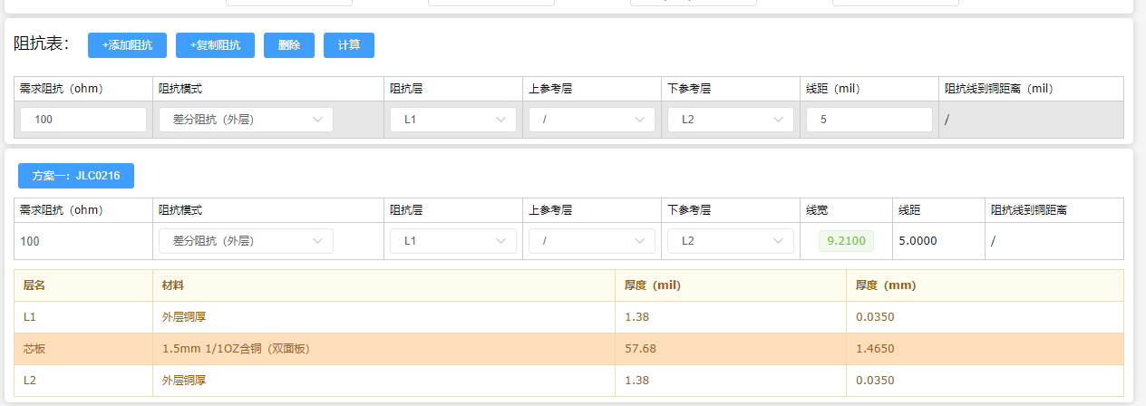

5.3 Impedance Matching:
HDMI should be routed with 100 ohms impedance matching.

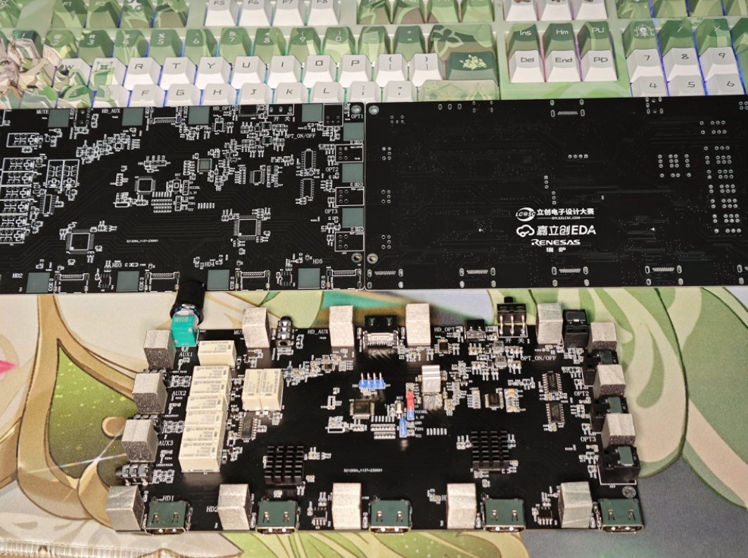

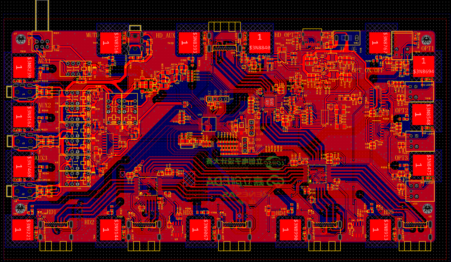

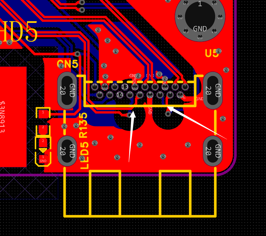

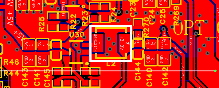

5.4 Layout:
I frequently design products with touch interfaces in my work, so I have some experience with touch layouts. Please feel free to correct any errors.

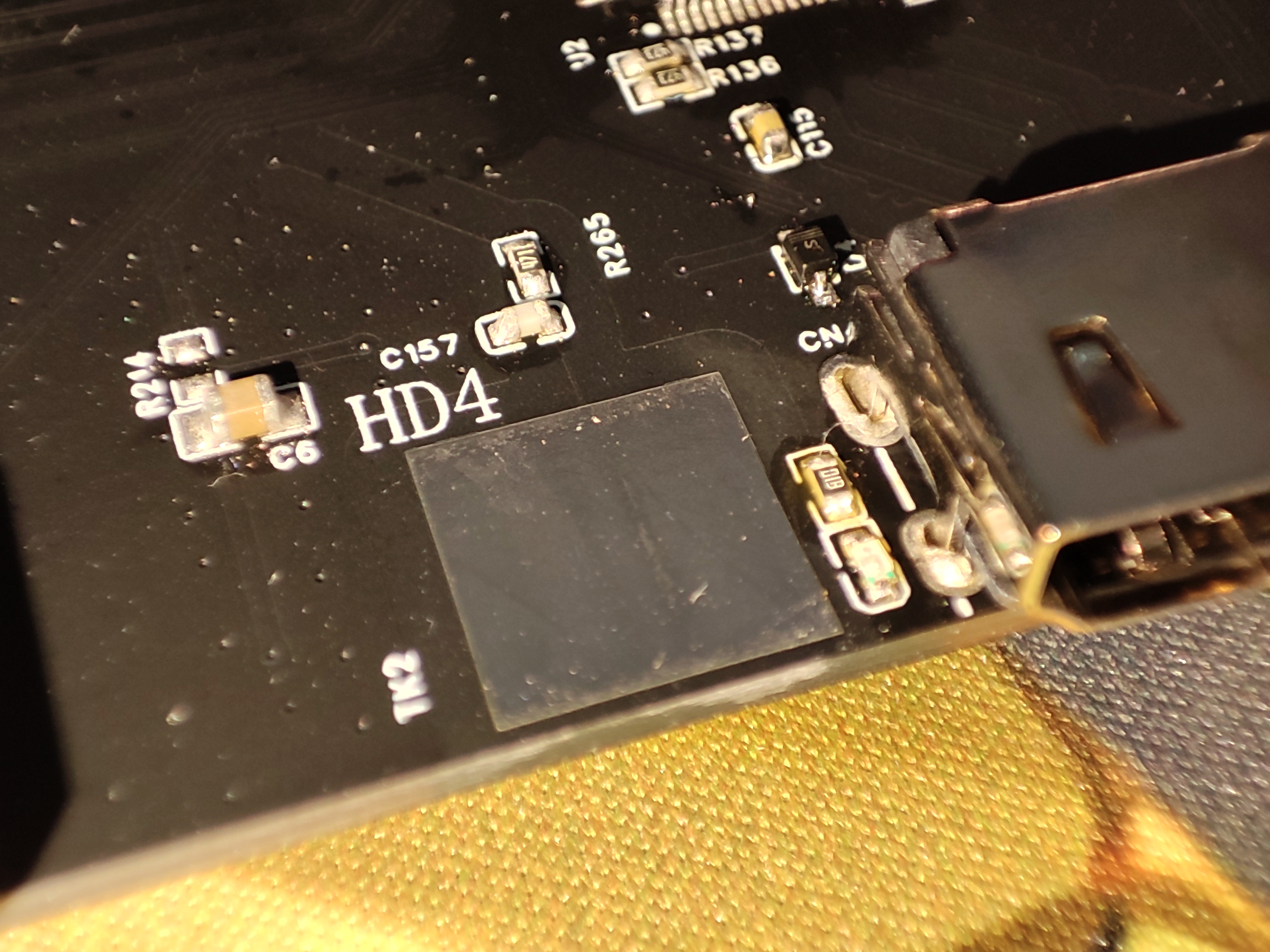

The overall layout is as follows. Actually, I personally feel that the ground plane is quite poor. A four-layer board would be much better.
I often use this plug-in HDMI connector. It is very easy to solder. Previously, I used surface mount connectors, which had many cold solder joints. This one is good, but there are two signal lines at the back, so the routing is more convoluted and will cross.

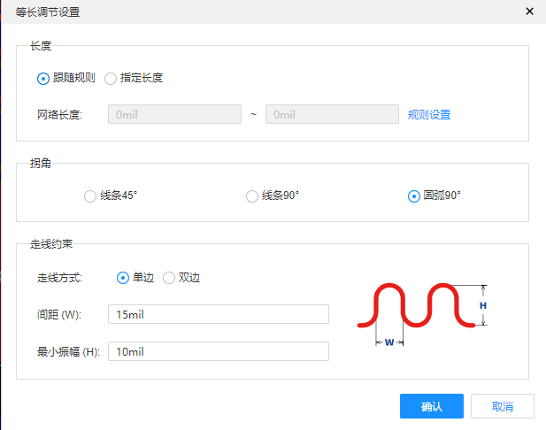

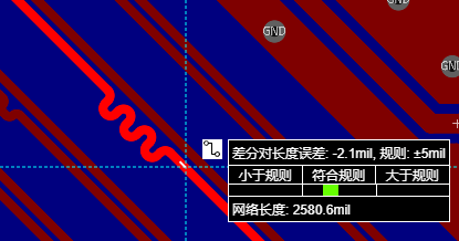

HDMI differential parameter settings are as follows. It is recommended to set the spacing to 3 times the line width, i.e., three times 9.2, but this is not set here, and the default 15mil is used. When
controlling the differential error to within 5mil,
HDMI signals and touch signals should cross vertically
and avoid crossing as much as possible.

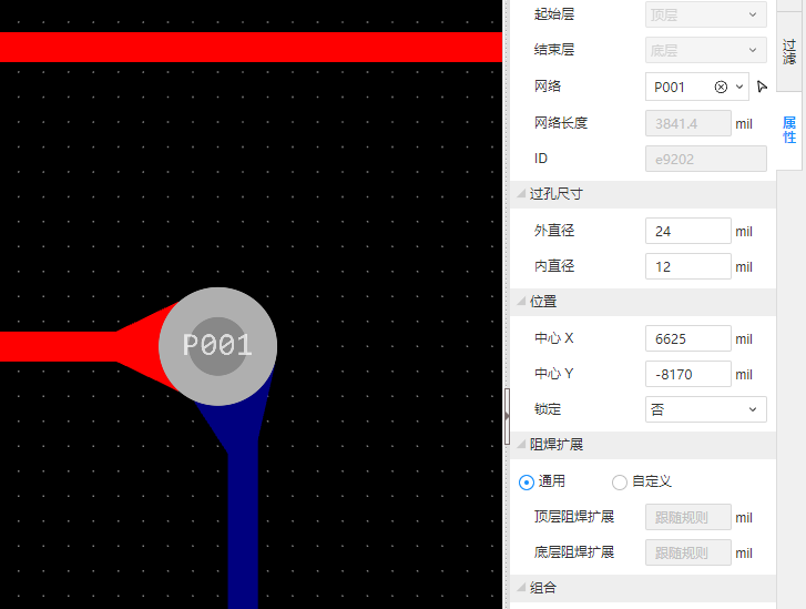

Touch traces should be as thin as possible; avoid making them too thick. Double-sided boards can currently achieve 4mil traces, but to balance yield and minimum trace width, I've used 6mil traces here.
Minimize touch vias, ideally to 1 or 0. Keep via diameters as small as possible; for double-sided boards, the minimum outer diameter is 0.5mm and the inner diameter is 0.3mm.
Some touch lines here use two vias due to layout limitations.
Teardrop-shaped touch signals are generally avoided, but I'm too lazy to delete them all, and to maintain PCB yield, I've retained them.

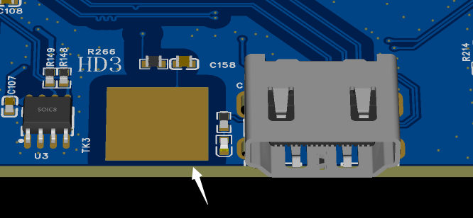

Copper plating around the touch pads increases interference immunity, but be careful not to place them too close together. Also, it's not recommended to place surrounding components near the pads. Here, we've compromised by placing them next to the pads for the sake of the indicator lights.
Make the touch pads as large as possible to increase sensitivity and interference immunity. Whether or not to plating
copper on the back of the pads depends mainly on the panel thickness.
Thicker panels don't need copper plating, while thinner panels require a grid of copper. This grid copper shouldn't be placed in the exact center of the pad; it needs to be placed around it (this might be a bit abstract; we'll demonstrate with examples later).
Note that the touch pads are open; not having them open will affect sensitivity.
Pay attention to the routing of touch resistors and capacitors.

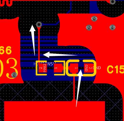

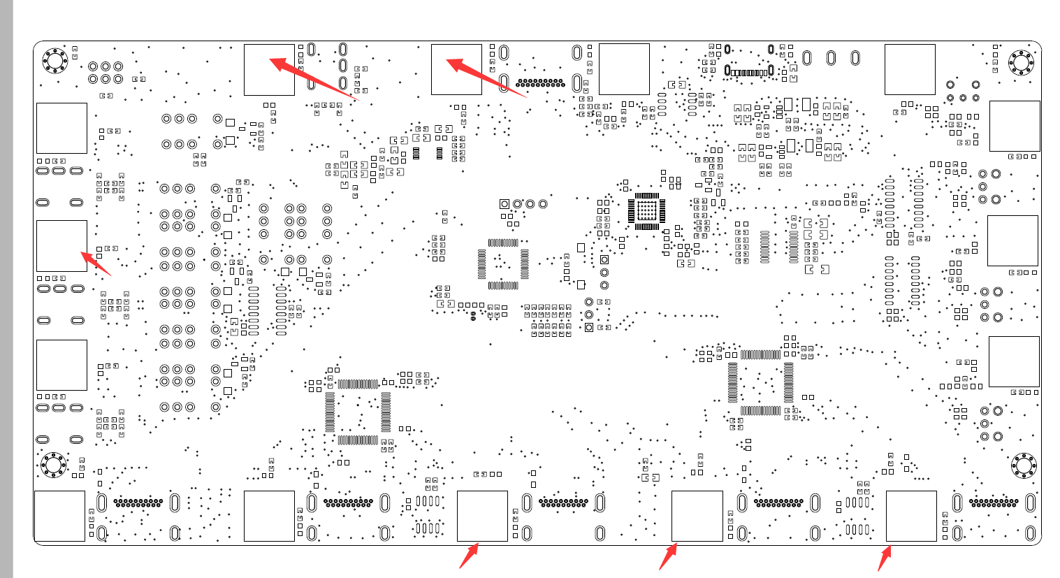

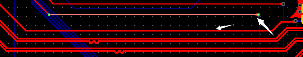

Incorrect examples:
Avoid parallel routing of touch and high-speed signals. I've separated them slightly here, but unless absolutely necessary, parallel routing is still not recommended.
Avoid placing touch sensors under relays, inductors, or other components that cause magnetic interference; keep them as far away as possible.

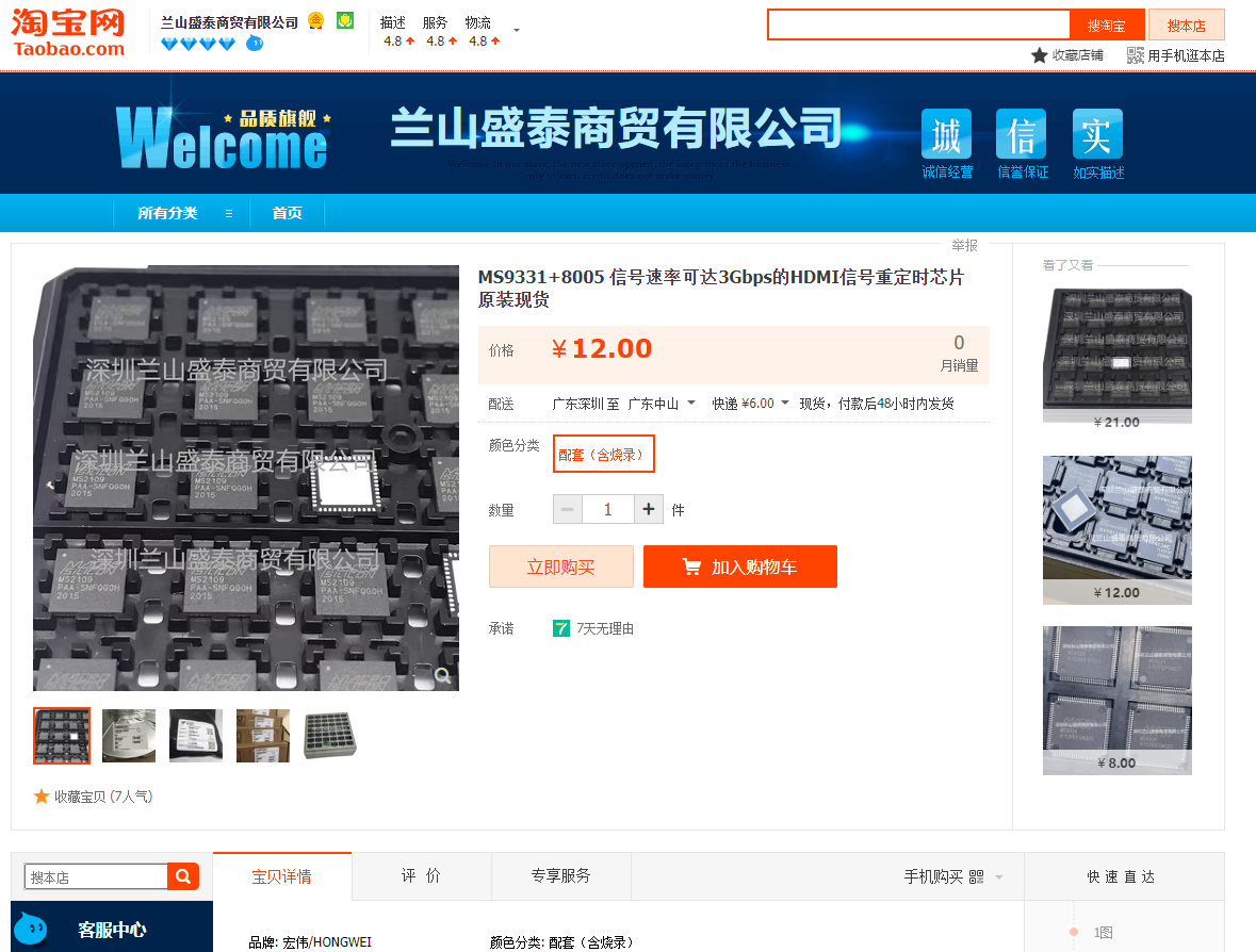

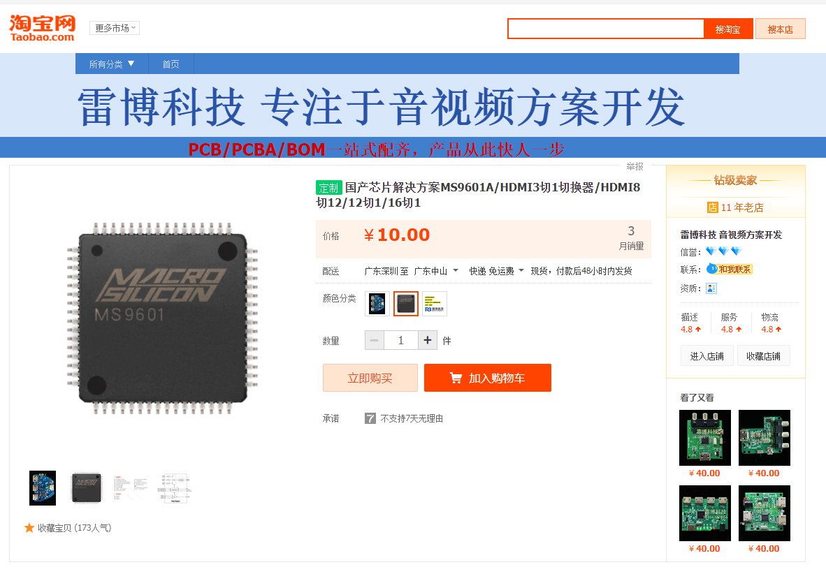

6. Chip Purchase
6.1
MS9331 The MS9331 uses IIC control. As usual, datasheets and register tables for MS chips are unavailable. However, like previous MS chips, there are compatible MS8005 ICs available online, so you can use a ready-made one without programming.
https://item.taobao.com/item.htm?spm=a1z09.2.0.0.5f152e8dYHRKFr&id=691533336994&_u=hqavhl8b1f1
6.2 MS9601 Chip
This store has a decent supply of chips, but there's a minimum purchase quantity. Buying just one will require additional shipping fees, so I recommend buying three or more.
Link: https://item.taobao.com/item.htm?spm=a230r.1.14.18.44ce4a89OI2g1U&id=664865791026&ns=1&abbucket=1#detail
Specifications: 24C16 programming

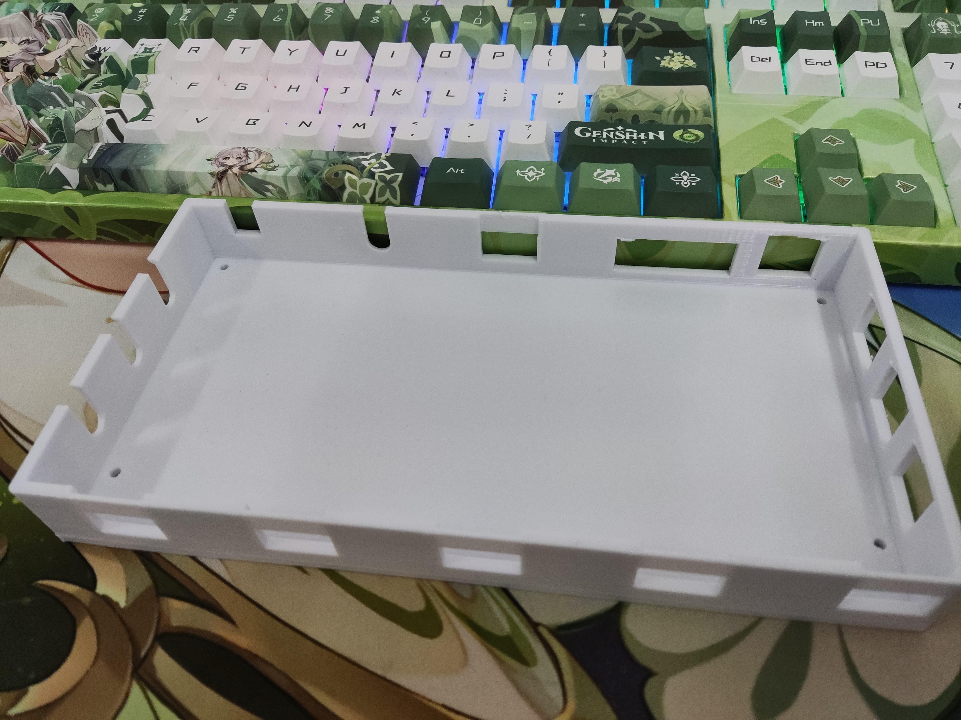

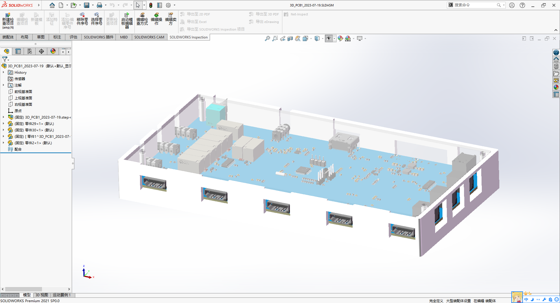

7. Shell Design
The shell is designed using SOLIDWORKS.

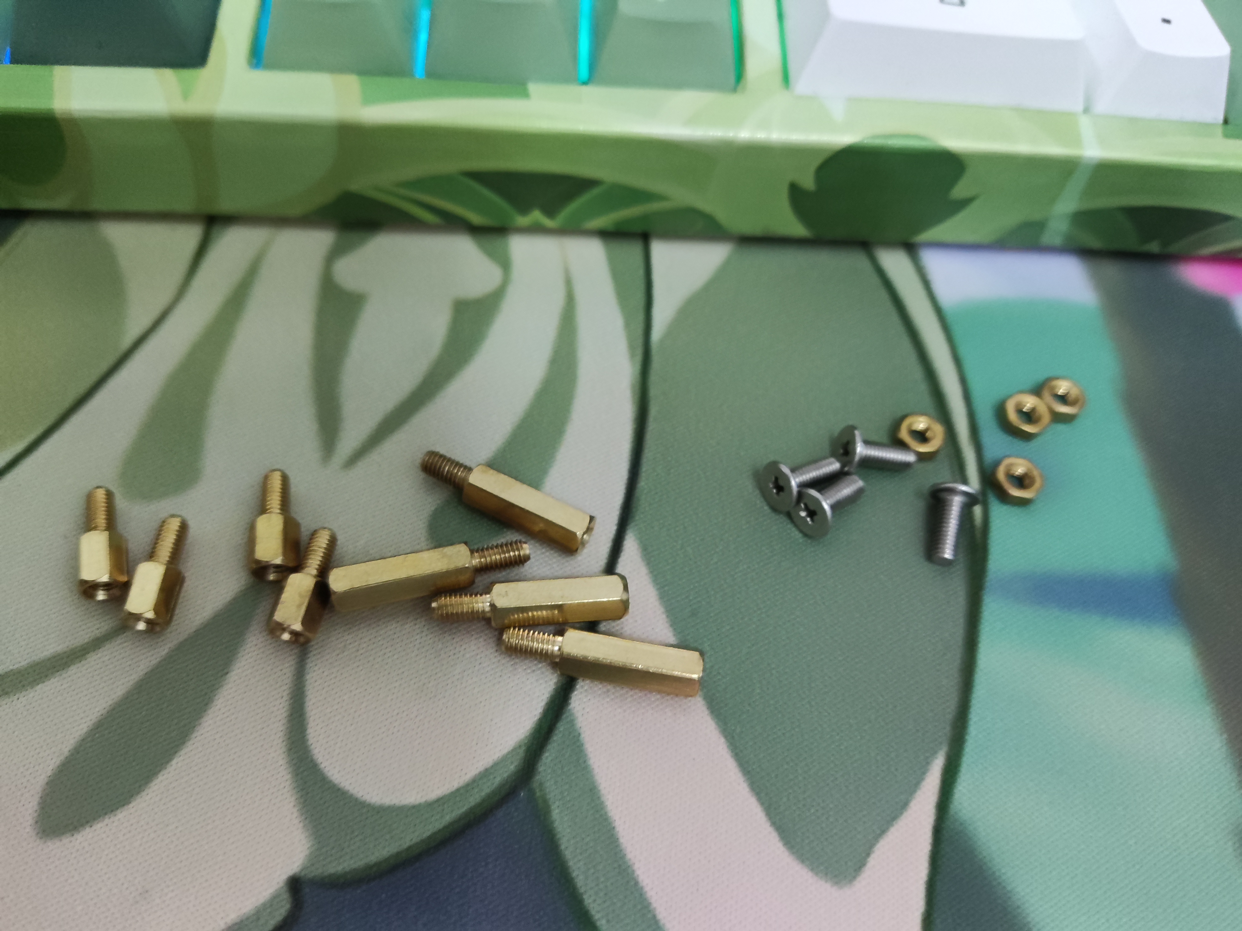

Screws:
Quantity
Single-pass hexagonal copper post
M3X6+6
M3X14+6
Copper hexagonal nuts
M3
304 Phillips head machine screws
CM3X6

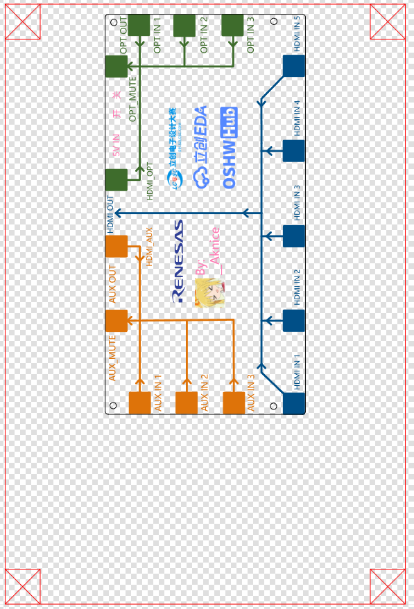

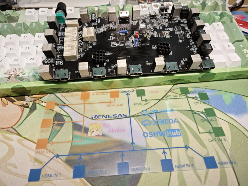

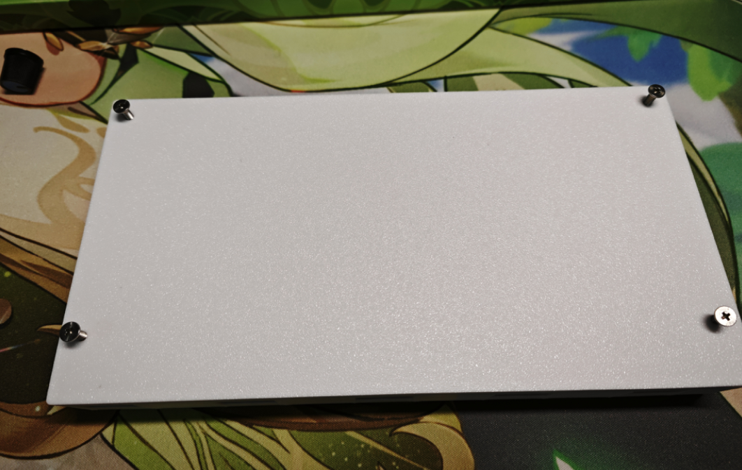

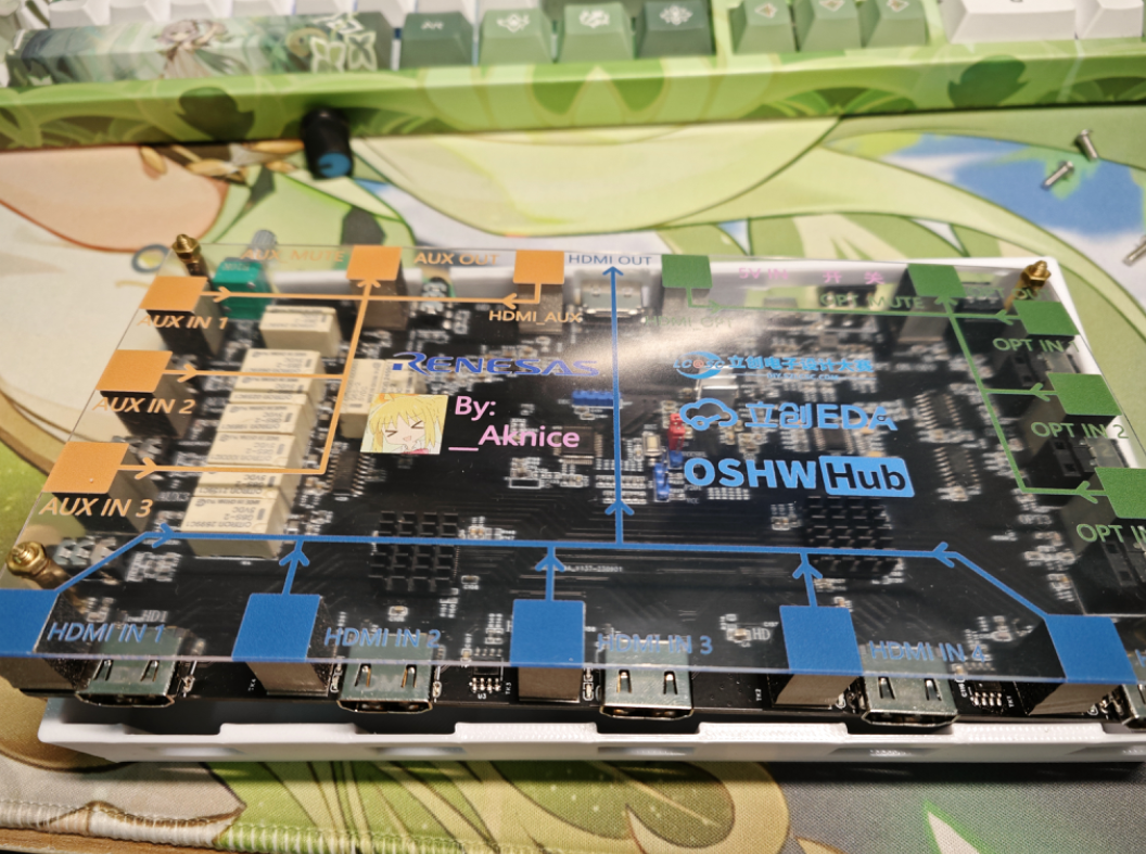

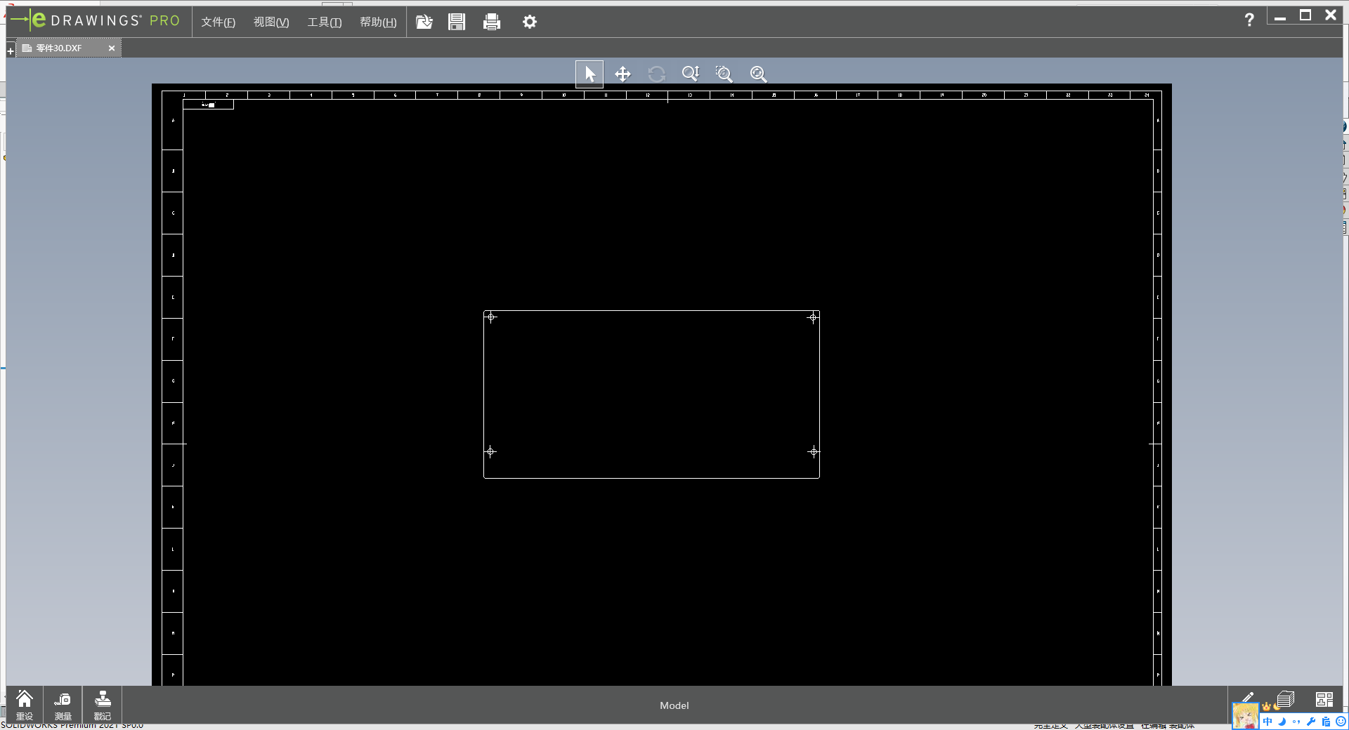

8. Panel Drawing:
While drawing the outer casing in the previous step, draw the panel casing as well. Then export the DXF file and import it into LCSC EDA for panel drawing.
The touch pads need to be aligned for accurate drawing.
Select "Export Top Layer Solder Paste
," keep the touch positions, and delete other unused pads,
board outlines, and SW drawings. Align the imported elements and draw accordingly.
I personally recommend 1mm; I tried 2mm, and the touch sensitivity was slightly lower, but it was still recognizable.

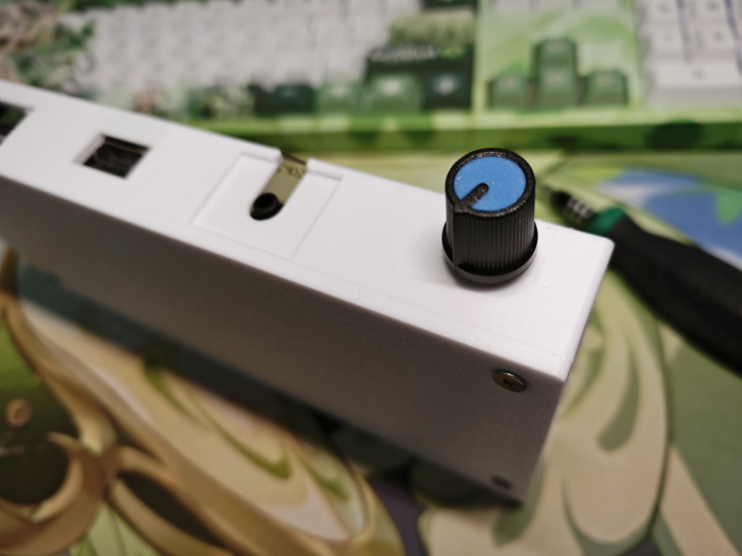

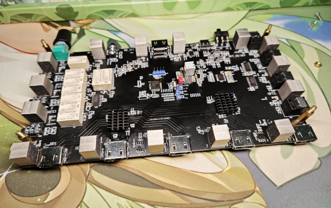

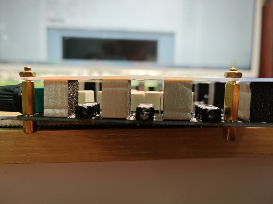

9. Assembly:

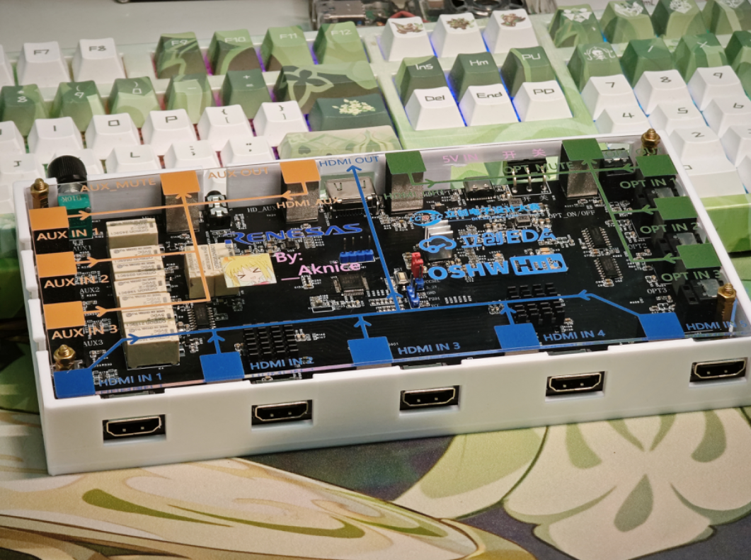

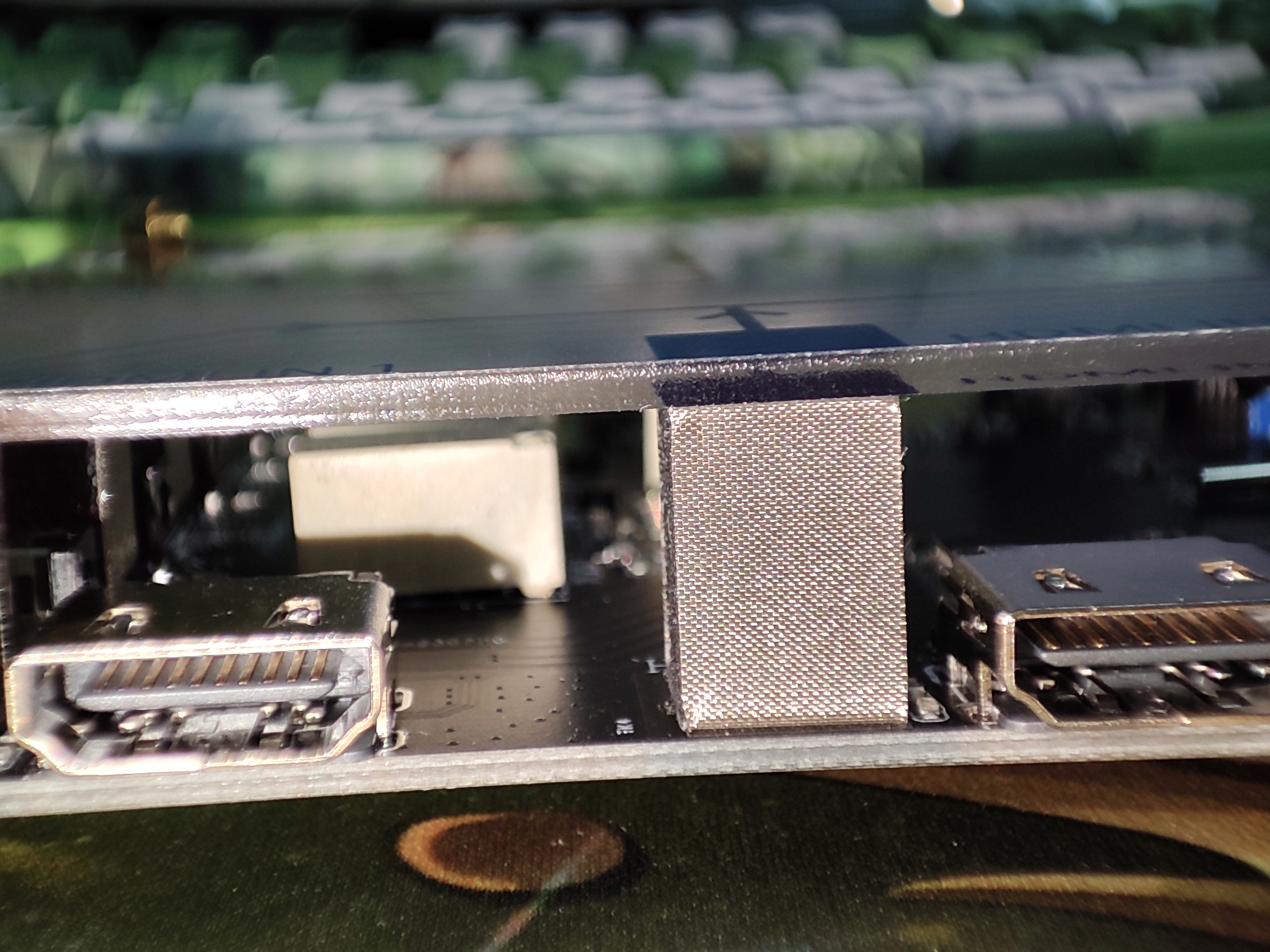

First, install the conductive cotton,
then the two copper pillars.
After placing the panel down, tighten the nuts and
install it into the casing. First, install the upper right corner, then insert the toggle switch, then install the lower left corner. Next, tighten
the screws on the back, and
finally install the volume knob

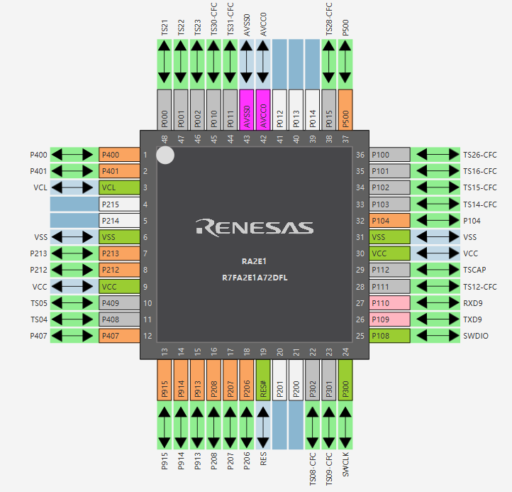

. 10. Renesas MCU Software:

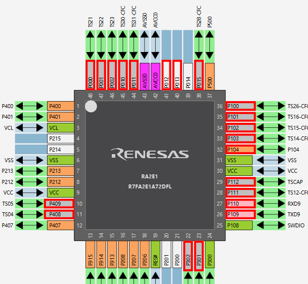

This time, I used the R7FA2E1A72DFL.
MCU resources are limited, basically utilizing all I/O ports.

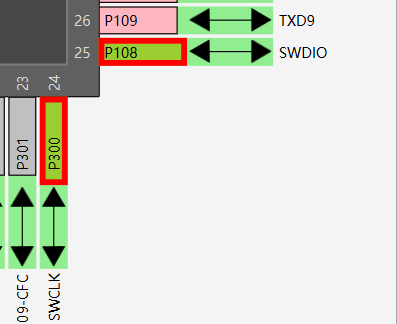

10.1 I/O Configuration:
This project is relatively simple, without communication functions; it's mostly I/O control. Therefore, no special
debugging ports were reserved. Touch debugging uses
UART, which wasn't actually used. Later, it can be reserved for PC control of the
touch ports. Most ports are used
, with some control I/Os for output but no input.

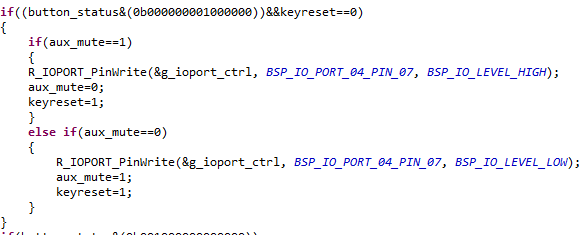

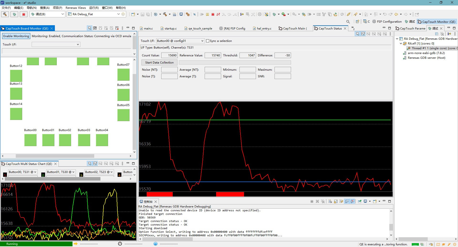

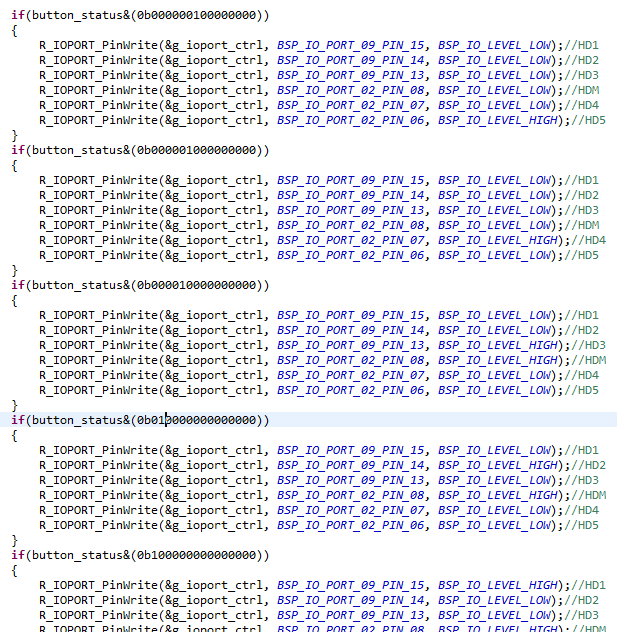

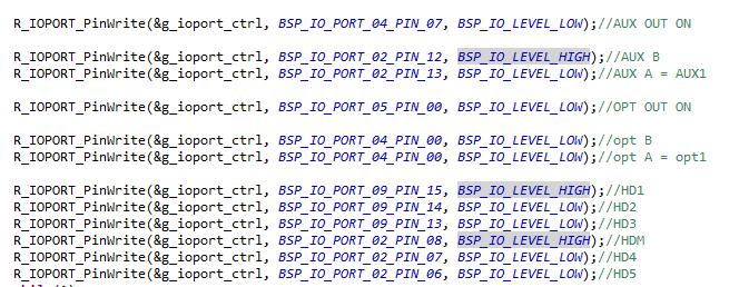

10.2 Touch Logic:
It's very simple; pressing a button changes the corresponding I/O. There's no difficulty
. One touch function is that pressing a button lights up the P407's LED, and releasing it turns it off.
The default interface switching level is preset during initialization.

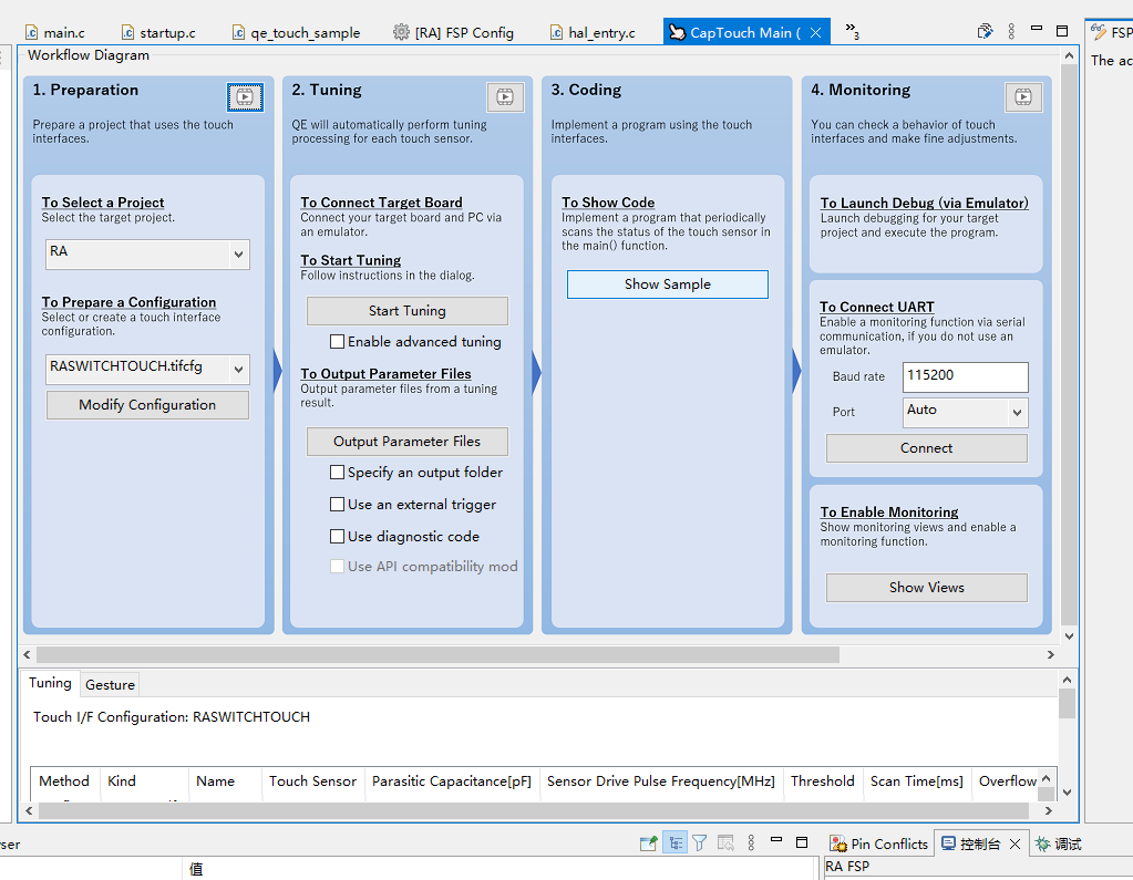

11. Touch Debugging
Notes: Touch sensitivity debugging is very limited by assembly. First, reassemble the panel and casing, and then perform touch sensitivity debugging!
It's recommended to do this step simultaneously with the previous code writing.

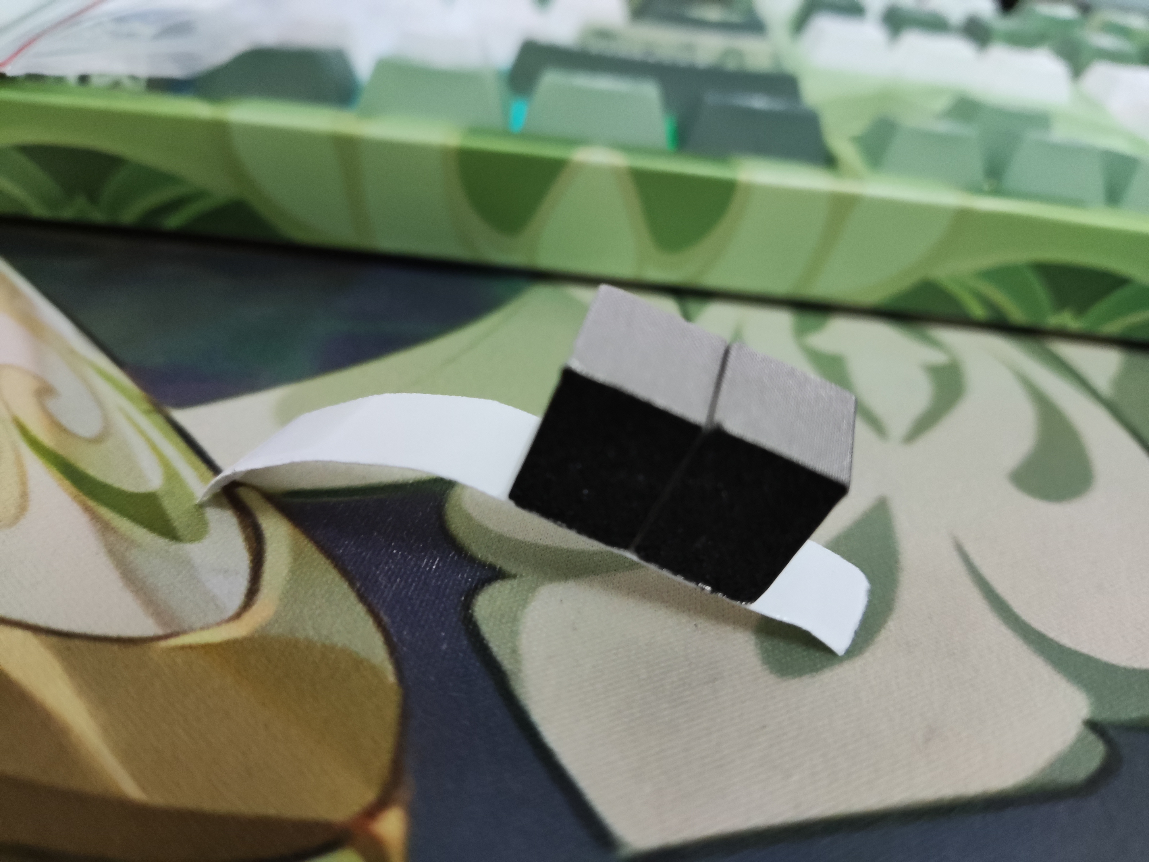

Touch debugging requires the conductive cotton to be properly assembled. I used 10x10x15 conductive cotton.
Note: When purchasing, pay attention to the description or ask the seller if the adhesive on the conductive cotton is conductive! This is very important. Some adhesives are not conductive.
After installing the conductive cotton, install the copper pillars provided in the outer casing. Because I chose 15mm high conductive cotton, I used 14mm high copper pillars, which pressed down just right. I do not recommend using 13mm pillars as they will not press down.
The conductive cotton just touches the panel.
Once everything is assembled, you can proceed with the assembly. Note that you should lead the debugging wires to the simulator
and then use the E2's CapTouch for debugging. Follow the instructions step by step to
set the corresponding touch key positions
. The touch resistor needs to correspond to the surface mount resistor. Here, I did not use the default 560 ohms but replaced it with 470 ohms. The program is also set to 470 ohms.
The touch debugging is as follows: after exceeding the threshold for a while, the button will be triggered, and the desired action can be executed.

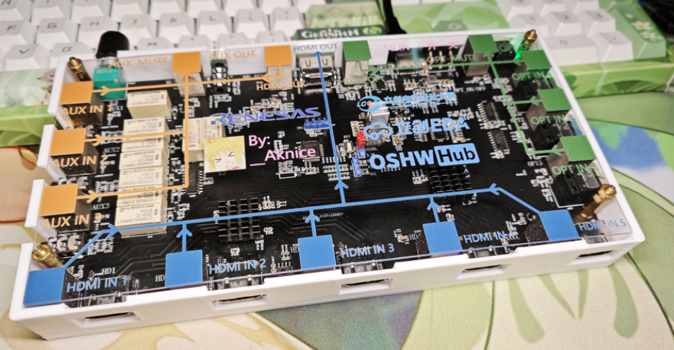

12. Summary:
The technical content of this project mainly lies in the touch wiring and interaction, including the touch layout rules and the compatibility of touch with high-speed signals.
The debugging process of this project is different from ordinary projects. Due to the addition of touch, the touch sensitivity is very limited by the structural assembly. Therefore, debugging can only be carried out after the assembly is complete.
The highlight of this project also lies in the ingenious combination of structural and electronic technologies, such as the conductive cotton used for the interaction between the touch pads and the panel.
On the software side, the main focus is on the debugging and coordination after the touch panel is installed.

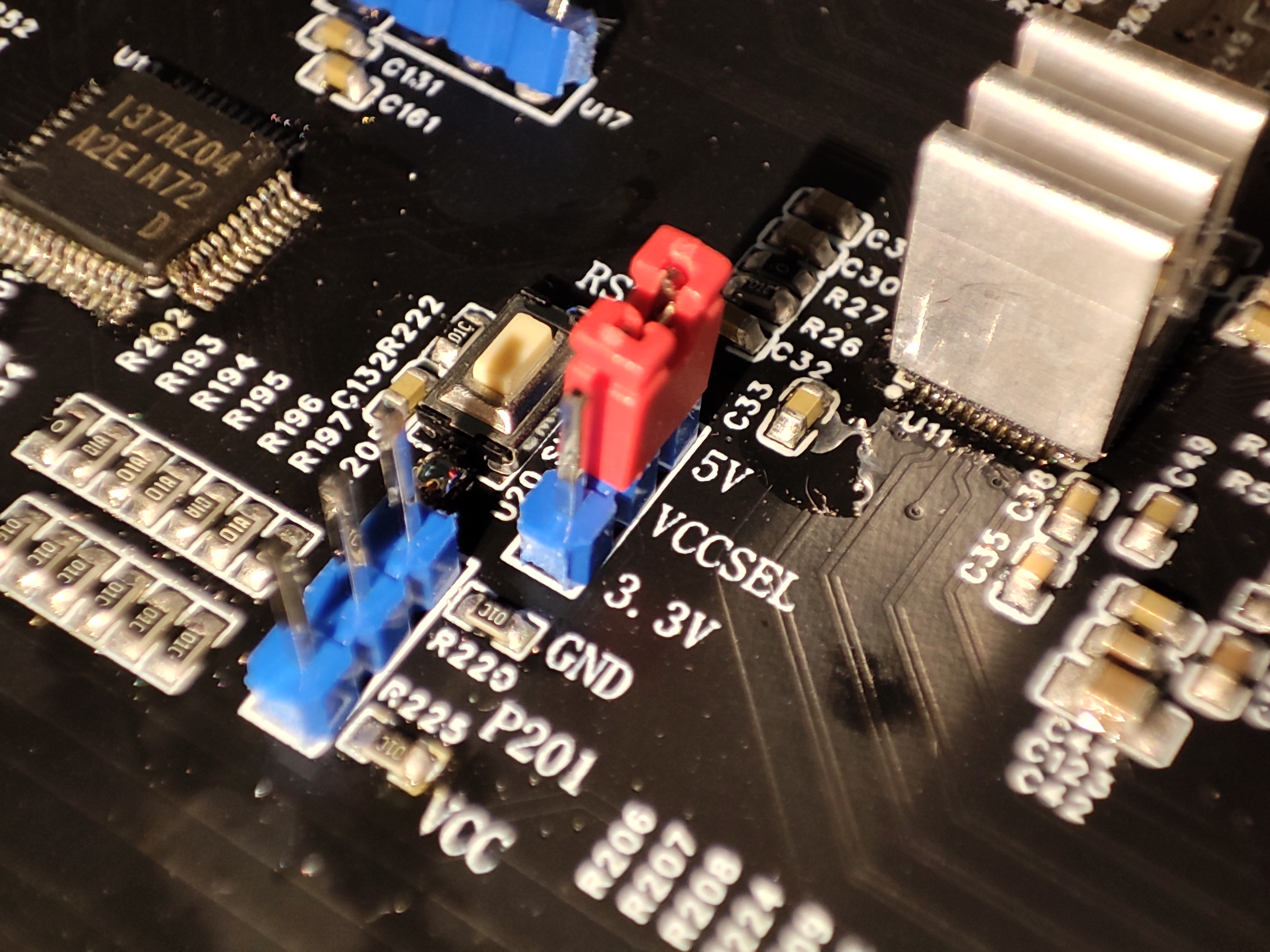

Choose 5V for the MCU power supply; do not use 3.3V.
For high-speed display devices, it is recommended to connect to HDMI 5 and 4, prioritizing HDMI 5 and 4 inputs. This avoids the need for a switching chip and reduces heat generation. It

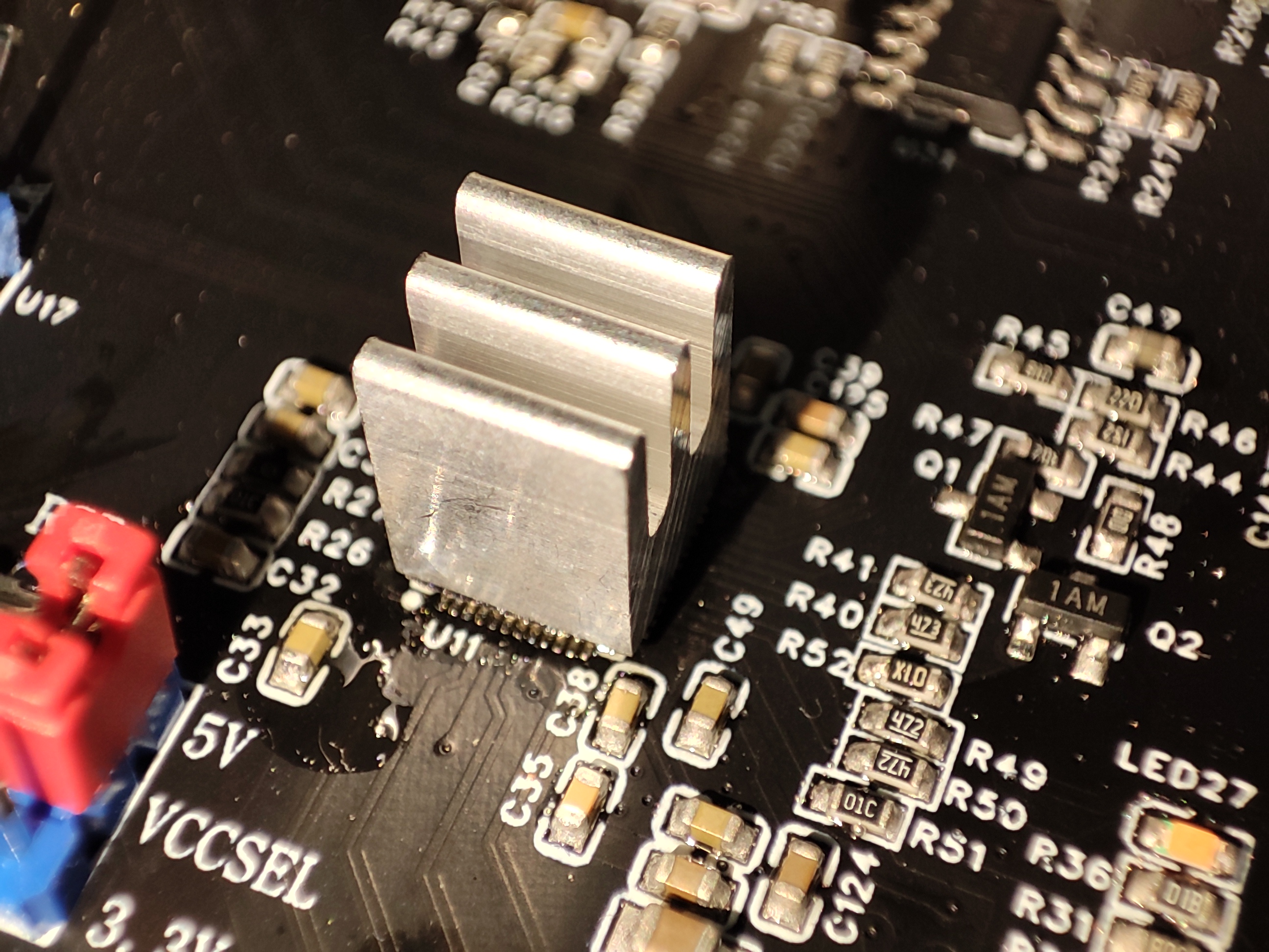

is recommended to add heatsinks to the MS9601 and MS9331 chips, as they generate significant heat.

These three circuits are all based on official examples and will not be explained further here. Please refer to the official documentation [Oscilloscope Expansion Board].
3. Power Supply Section:
The level conversion in the power supply section is based on official examples. I won't go into too much detail here
. Based on the official documentation, I added a power supply interface because when using the official oscilloscope extension version, the power supply interface interfered with the waveform acquisition and output channels, preventing normal operation. In this project, after modifying it to use the waveform acquisition channel, one channel became unusable. Therefore, I added a power supply interface to ensure stable operation of both channels.
Also, please note that the oscilloscope uses a +2.5V ADC reference, but the Liangshanpai version uses a 3.3V reference. Therefore, the A3.3V and AGND 0Ω resistors in the Liangshanpai version need to be removed. The official documentation specifically notes the following:

5. Button Circuit:
 This project uses two DIP switches and screen touch to achieve human-computer interaction on the oscilloscope.
PCB Design Description:
This project requires the placement of many components, so I lengthened the board during the design process. The width is consistent with the core board of Liangshanpai, as shown in the figure below.
The PCB layout is relatively compact, which significantly impacts routing. Therefore, this project ultimately adopted a 4-layer board design. Inner layer 1 is used as an analog ground plane. Inner layer 2 is only connected to some power and signal lines due to concerns about interference with analog signals (this is my first time drawing this, and I'm not sure if it will cause interference. If any experts can see this and explain the relevant knowledge, that would be excellent; please don't criticize).
In this project, two ADC detection probes are brought out, along with waveform generation test points and analog ground test points. The test loop is used for the waveform generation test point and the simulated ground test point, which facilitates the connection and testing of the oscilloscope probe .
Also, the component layout is relatively dense, making soldering slightly more troublesome.

4. Touch Function Porting:
The touch chip used in this project is XPT2046. Screen vendors provide touch functions for XPT2046, but these are functions applied to ST chips and require GD porting.
The provided touch routines use software SPI, so this project also uses software SPI. The microsecond function implementation in the previous step mainly applies to the touch software SPI communication.
Due to batch differences and other reasons, the default calibration parameter values ​​of the touchscreen may cause inaccurate touch recognition. It is recommended to calibrate before use; it is not recommended to directly use fixed default cali
