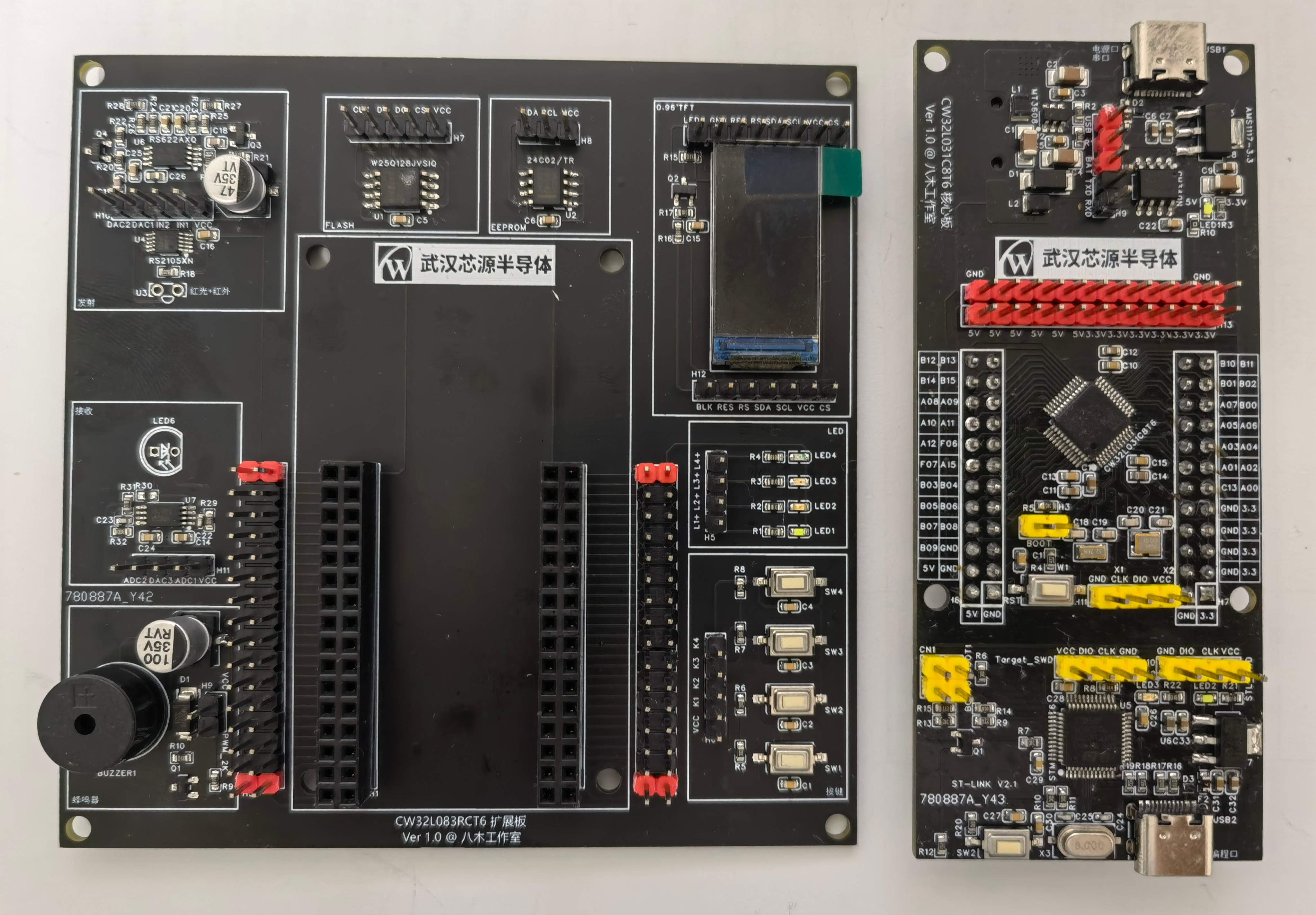

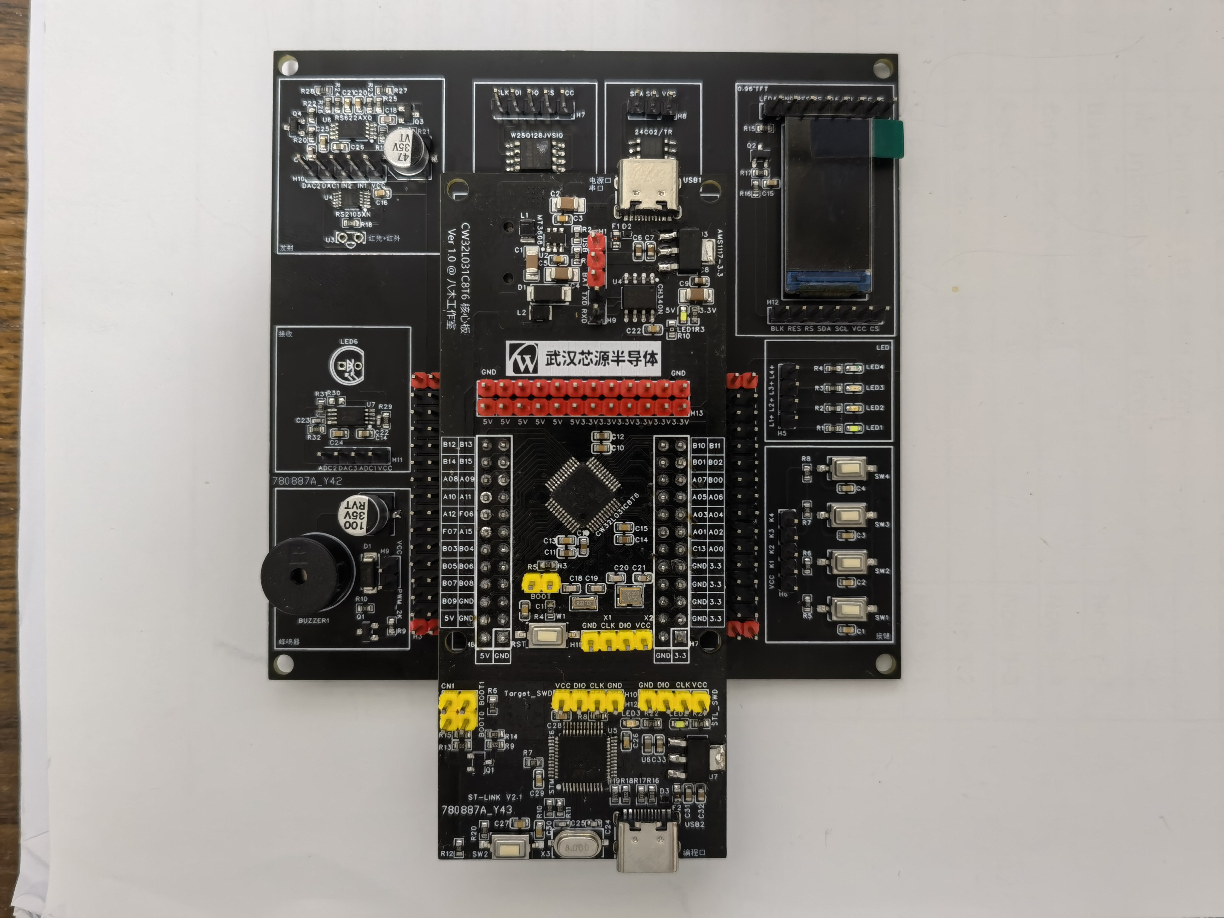

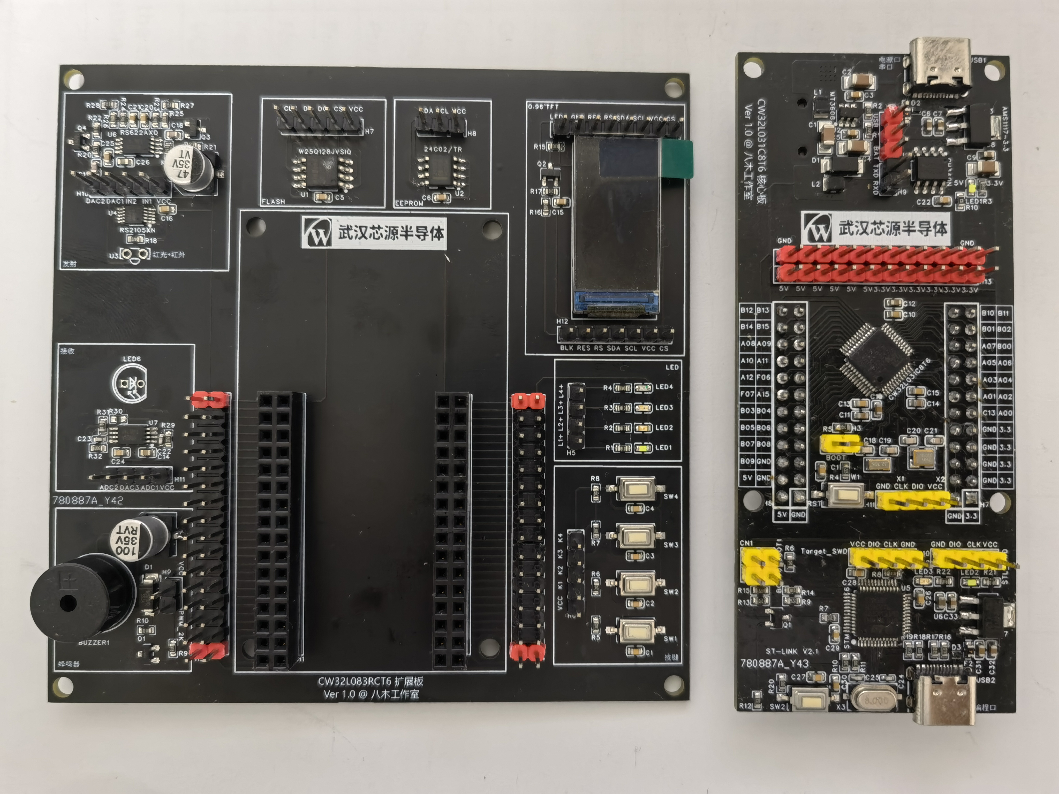

        To facilitate the development and testing of the finger-clip pulse oximeter, a core board based on the CW32L031C8T6 and an expansion board integrating various external modules were designed. The purpose of adopting an independent design for the main control and external circuits is to achieve support for multiple main control models and compatibility with multiple types of expansion boards, thereby facilitating learning and development for a wide range of enthusiasts.
1. Core Board
1.1 Design Concept
        The core board consists of three parts: a power supply circuit, an MCU main control circuit, and a programmer circuit.
1.2 Power Supply Circuit The power
        supply section provides two power supply methods: USB power and battery power, via a header. The USB interface uses a 16-pin, Type-C interface. While providing external power, it implements USB-to-serial communication functionality through a CH340 chip, and the serial port pins of the main control chip can be freely selected via the header. A CR1220 button battery is onboard, and a 5V output is provided through a SEPIC circuit composed of an MT3608 chip. The back end is connected to the AMS1117 chip to form an LDO circuit to provide 3.3V output.

1.3 MCU circuit
        The MCU circuit uses CW32L031C8T6 as the main control chip. The 33 sets of IO interfaces, 2-pin Boot interface and 4-pin SWD programming interface are brought out through the pin header, and a reset button is provided.

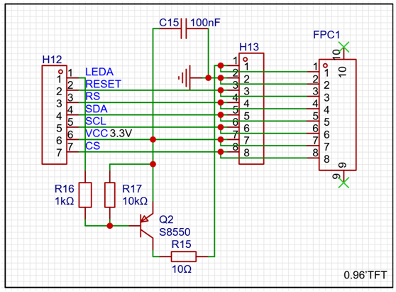

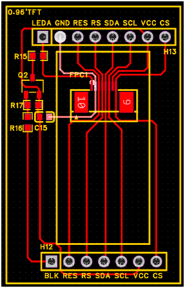

2.7 TFT Display Circuit The
        TFT display circuit is used to drive a 0.96-inch full-color LCD display. It also has an 8P drawer-type FPC interface and an 8P pin header interface, which can be used to connect a display with a soft flat cable interface and a display module with a pin header, respectively. Meanwhile, a PNP transistor is used as a switch, and the screen backlight is controlled by the PWM signal with a certain duty cycle output by the MCU.
(1) Schematic design
(2) PCB design

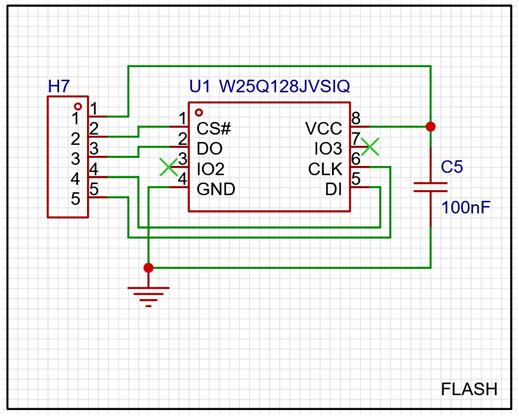

2.8 FLASH circuit
        The FLASH circuit mainly designs a set of SPI interfaces to connect the W25Q128JVSIQ device.
(1) Schematic Design
(2) PCB Design

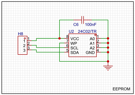

2.9 EEPROM Circuit The
        EEPROM circuit mainly designs a set of IIC interfaces for connecting 24C02/TR devices.

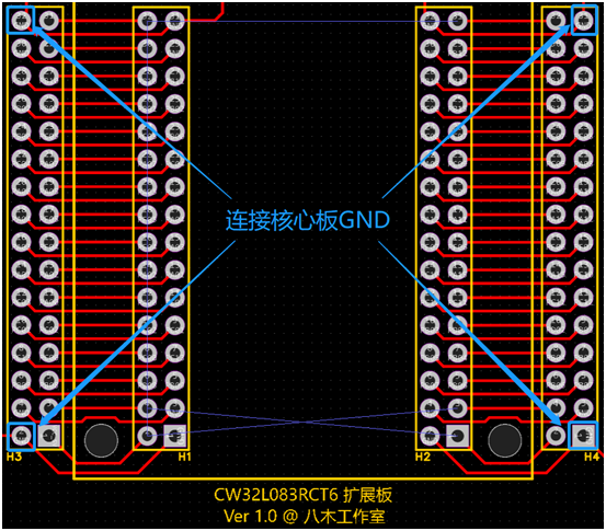

2.10 Core Board Interface Circuit The
        core board interface circuit is mainly used to support the access of low-power series core boards such as CW32L031 and CW32L083. Since the number of pins of the above chips is different, the maximum number of pins is used as the design standard. Therefore, when inserting MCU core boards with fewer pins such as CW32L031, it is necessary to avoid the four groups of pins 1, 2, 31, and 32, and connect the GND pin of the above four groups of pins to the GND of the core board through DuPont wires to realize the GND connection of various external devices of the expansion board.
(2) PCB Design
(III) Physical Display
(1) Display of Expansion Board and Core Board Separately
(2) Display of Expansion Board and Core Board Combined

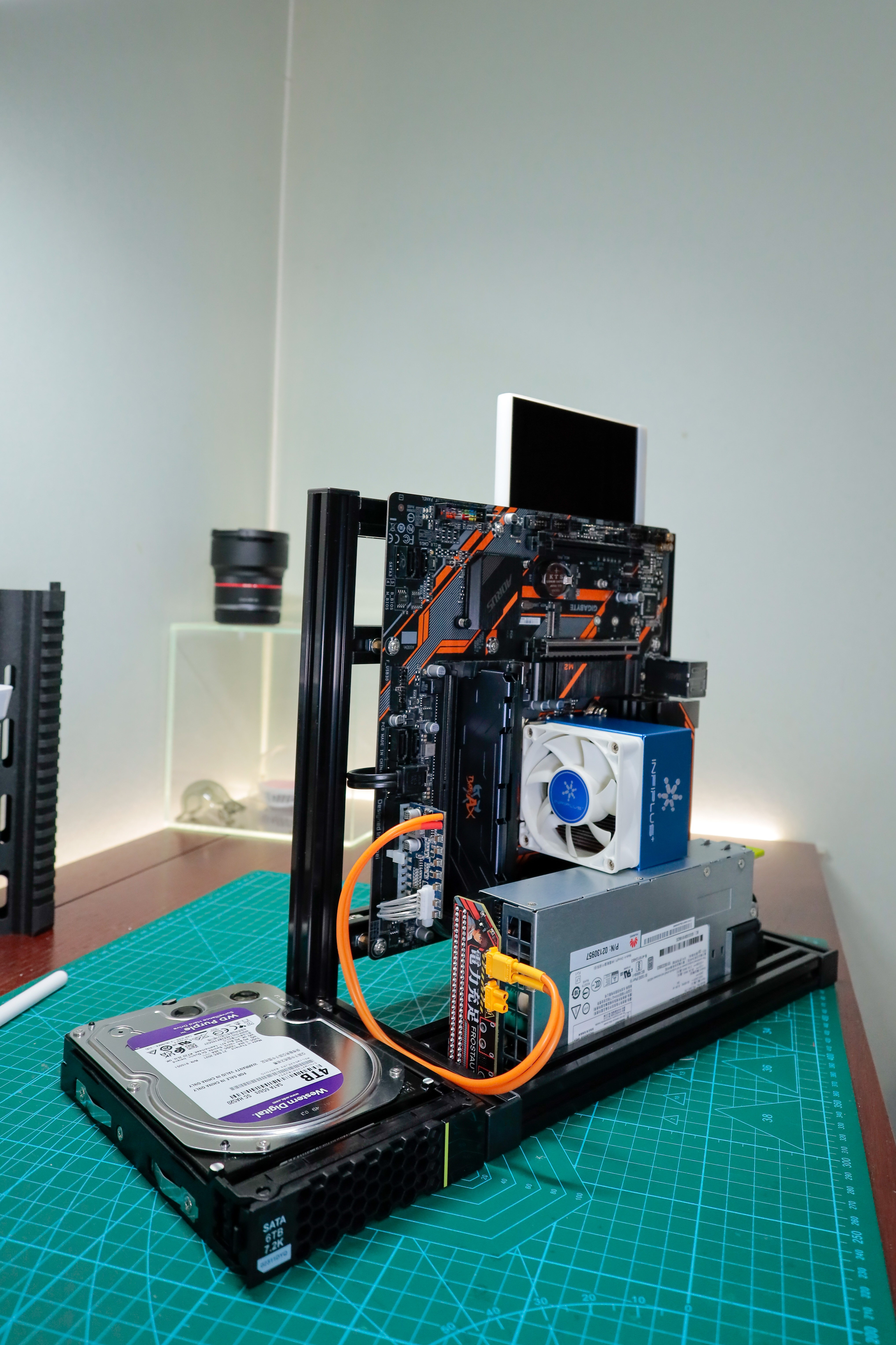

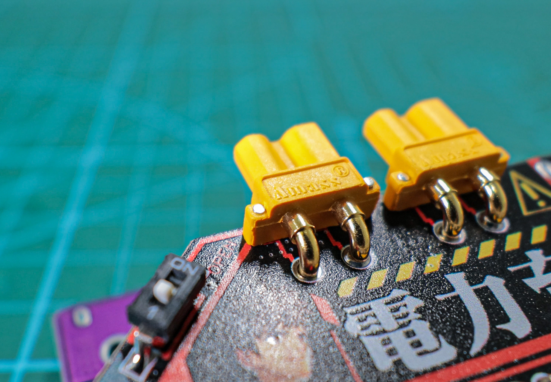

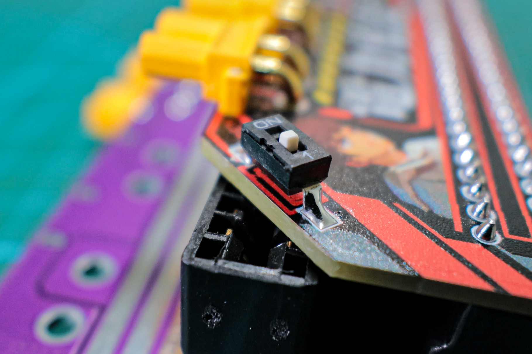

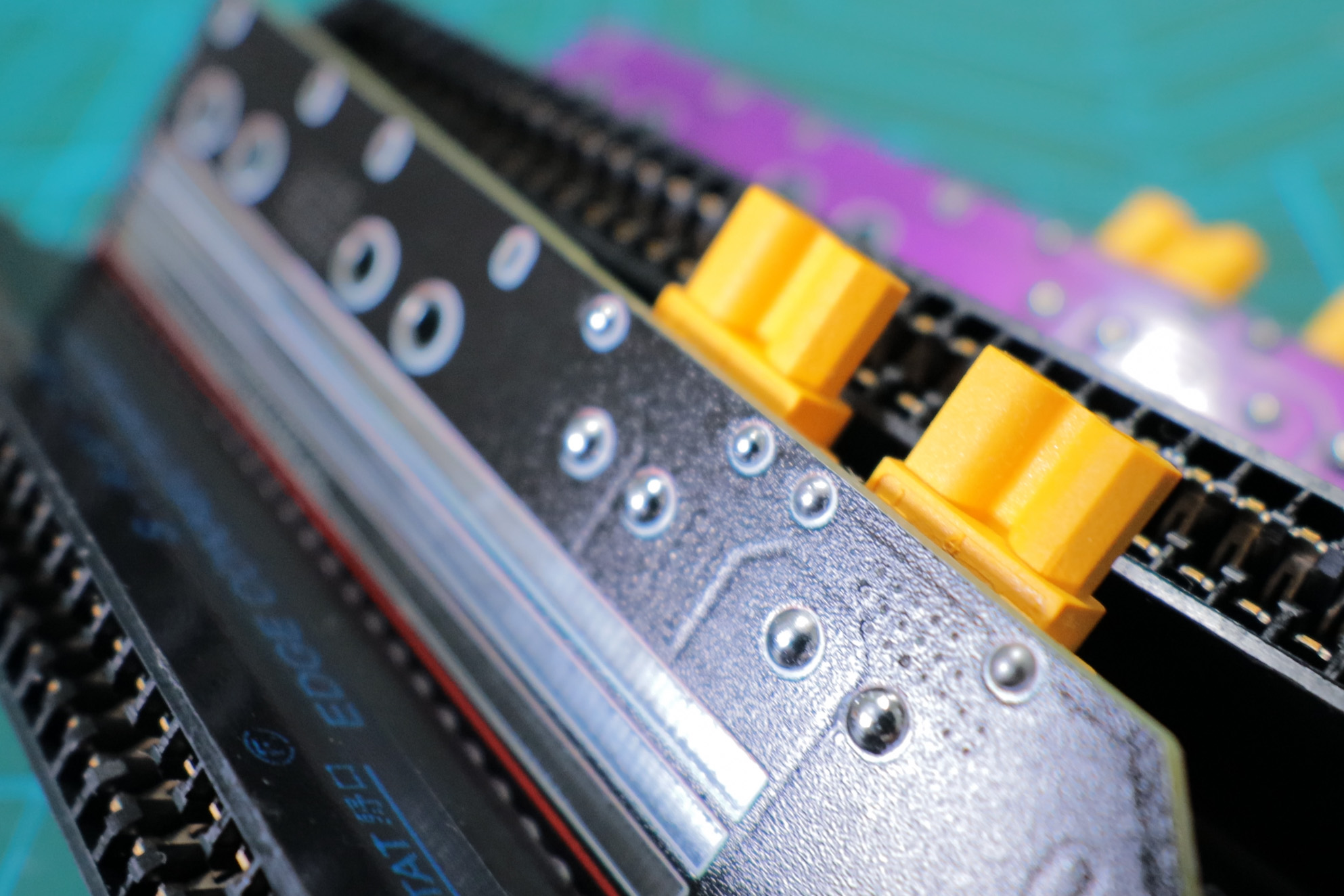

Huawei Server Power Adapter Board (Color Screen Printing)
A simple adapter board for Huawei 460W and 750W server power supplies.
(For computer power supply)
The input interface is a Noguchi 64P 2.54mm pitch connector,
including two XT30 and two XT60 pins. Outputs
are controlled via a DIP switch to prevent accidental power-on
. The gold finger start pins must be pins 1 and 4.
If the project file is not displayed below, please click the option below it. ∀
PS: This product has been verified and is working correctly.
