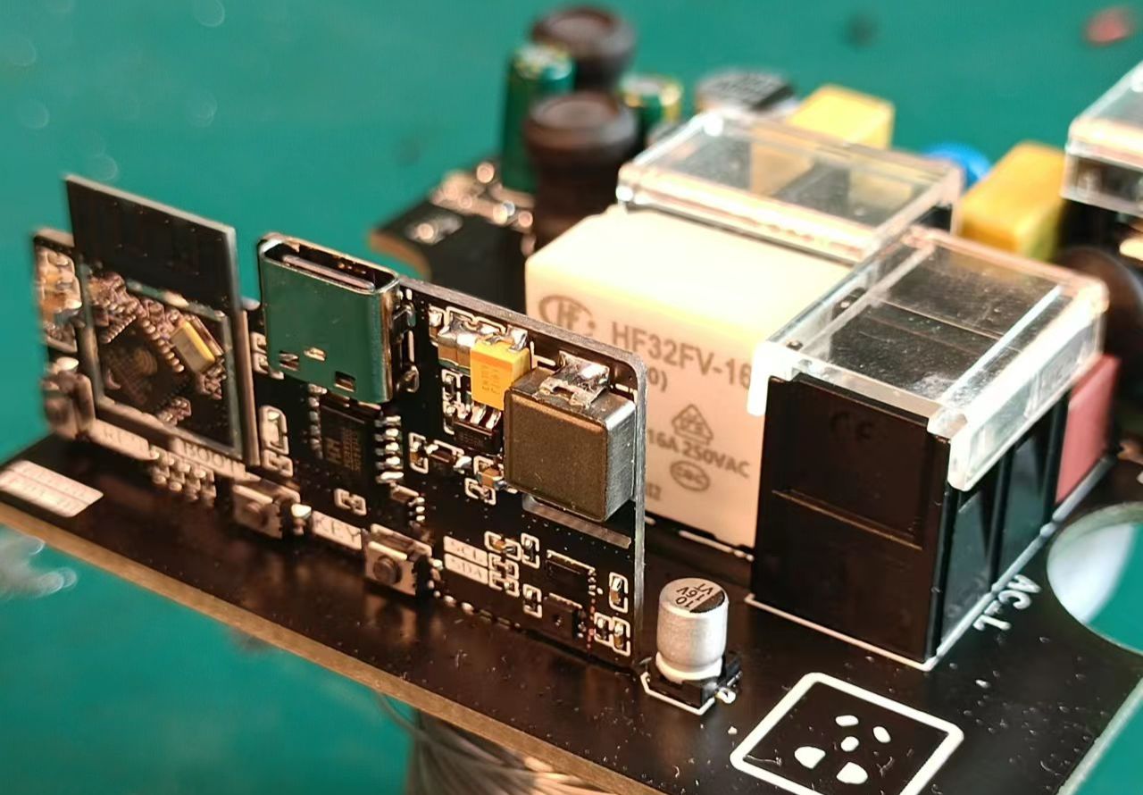

This project describes
a Wi-Fi smart socket based on the ESP32-C3 microcontroller. The main controller chosen is the ESP32-C3-MINI-1-N4, the temperature and humidity sensor is the SHTC3, and the light sensor is the BH1750. The AC/DC power supply ultimately uses a pre-built module: HLK-5M05, and the DC/DC power chip is the SY8120B1ABC.
The project consists of two boards: one for the minimum system and sensors, and the other for high-voltage and energy metering. The boards are fixed together by soldering.
The assembled unit can be placed inside an 86-pin junction box, and the output is connected to the box's panel, creating a simple casing.
Software development is based on ESP-IDF v5.0, and the cloud platform used is Tencent Cloud, allowing interaction via the Tencent Lianlian mini-program.
Demo video: [Bilibili demo video] .
Hardware introduction:
Power supply
AC/DC
. Initially, the AC/DC circuit for this project was built using a custom chip, a non-isolated solution. However, during later debugging, the relay activation caused the power chip to overcurrent and restart, so a pre-built AC/DC module was used instead. Cost wasn't a primary consideration during the initial design, so the chosen module may not be the most cost-effective.
The HLK-5M05 module measures approximately 38 x 23 x 18 mm. While it fits in an 86-pin junction box, its size is somewhat large. At the time, the priority was functionality, so further consideration wasn't given to this.
The circuit, based on the HLK-5M05 datasheet, only required adding a fuse and a varistor at the input, followed by several filter capacitors and a power indicator at the output.
The DC-
DC converter handles the 5V to 3.3V conversion, powering the ESP32-C3 minimum system and sensors.
The circuit tested and found it feasible. Adding a 100uF tantalum capacitor at the output resulted in good ripple control.
An LDO wasn't chosen for this power supply because a DC-DC converter is more efficient, improving energy utilization.
For energy metering
, the HLW8032 chip was selected. This chip supports both isolated and non-isolated sampling, but since an isolated power supply was already in use, using non-isolated sampling would be strange. Therefore, isolated sampling was ultimately chosen for this project.
The transformer models are: current transformer ZMCT103C and voltage transformer ZMPT107-1.
Practical verification shows it's feasible, but software debugging requires knowing the voltage, current, and active power of the electrical load to calculate the isolation sampling coefficient.
The environmental sensor is an SHTC3
, using the IIC protocol. Nothing much to say about this.
The optical station sensor is
a BH1750, also using the IIC protocol. The light sensor... well, it's not very useful at the moment, because if it's on the board and inside the housing, it can't measure ambient light.
I haven't thought of a better solution yet; not soldering this part of the circuit doesn't matter.
For the minimum system
, I tried a USB virtual serial port, but I didn't know how to use it, so I used a CH340, specifically the CH340K, in an ESSOP-10 package, which is relatively small.
Why not use a CP2102 for a small package?
Budget was limited, and the CP2102 is too expensive,
so in the end, a serial port with automatic download was used.
