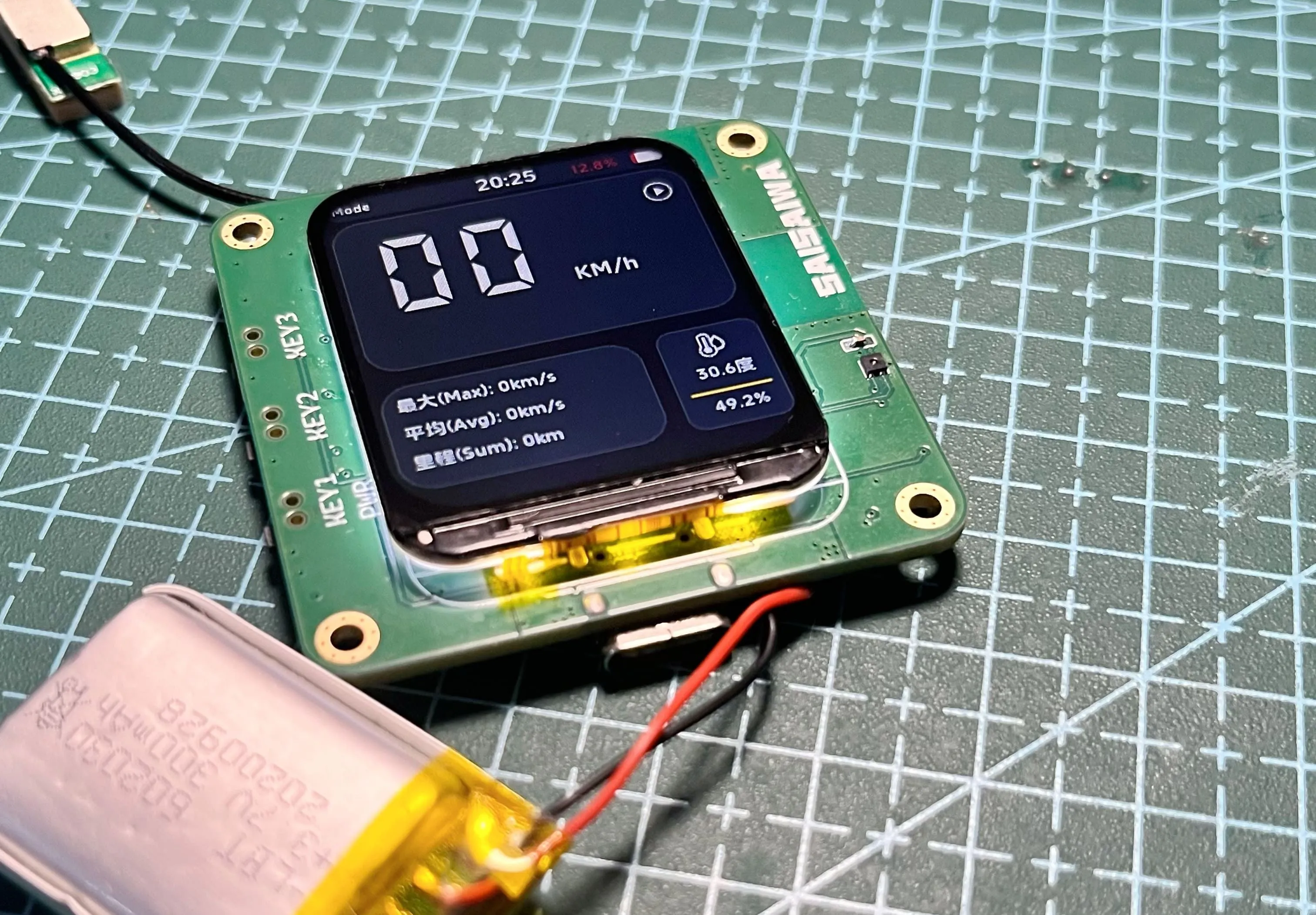

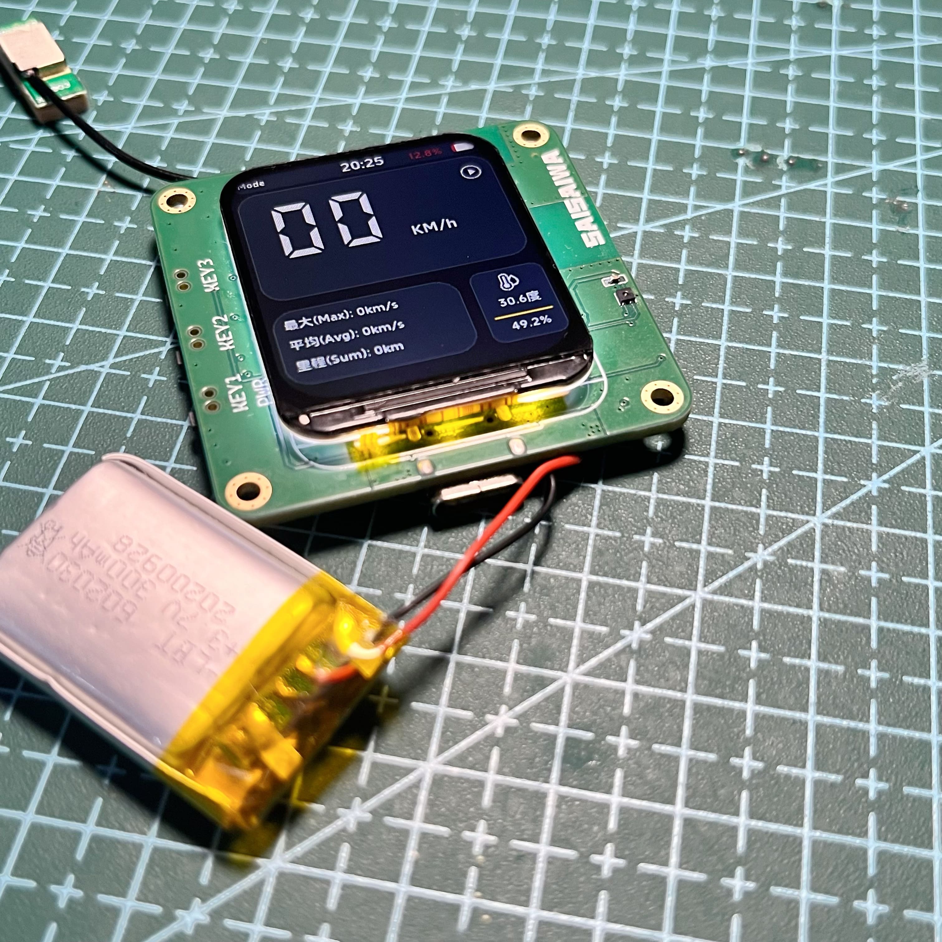

GPS Dashboard for ESP32-S3
This is a GPS dashboard/speed meter developed using LVGL9.2 and based on the ESP32S3 as the main control UI framework .
It was only ported and completed on the 16th. I'm going out for the Mid-Autumn Festival, so the casing isn't finished yet; I'll work on it when I have time.

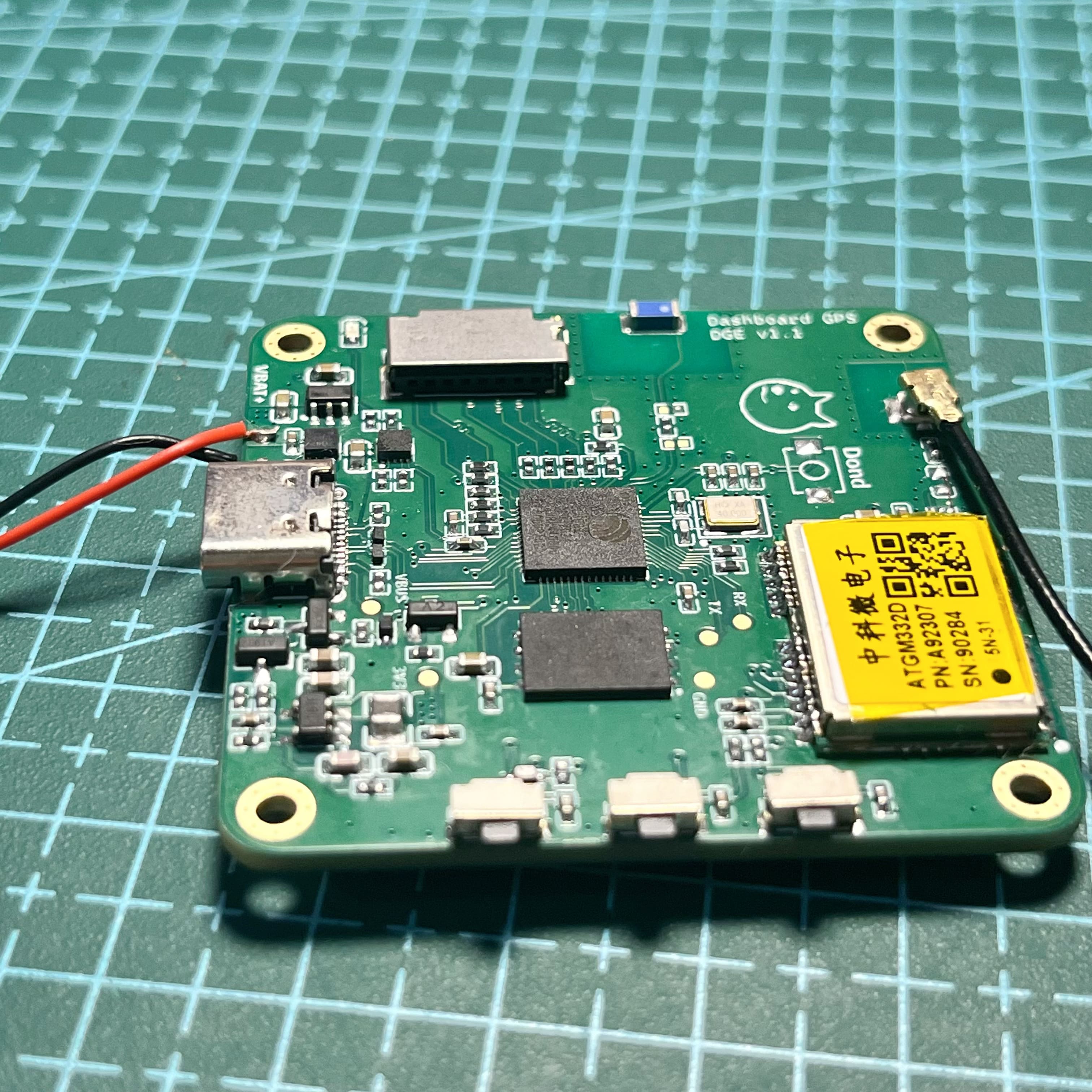

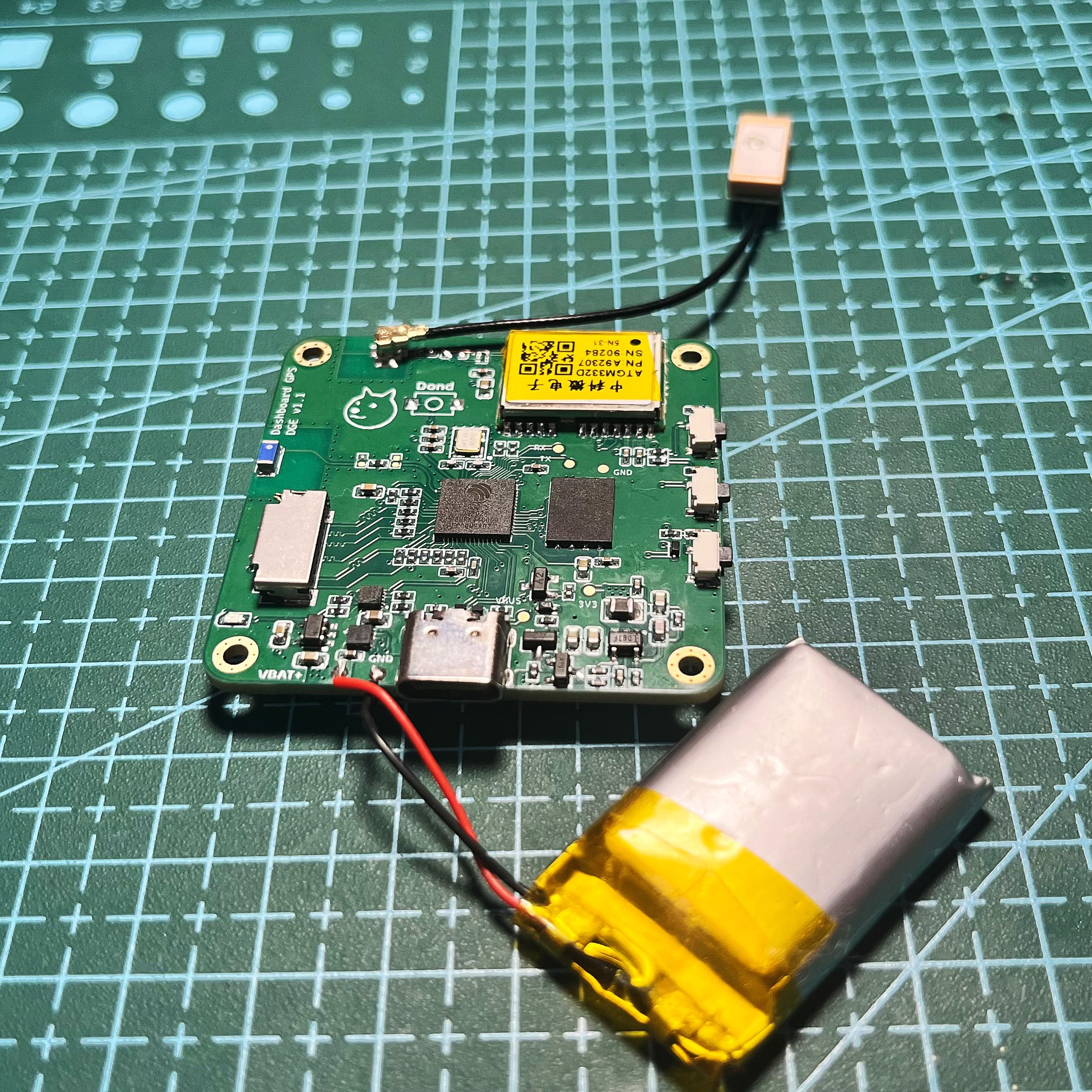

1. Hardware Design
Integrated charging chip, supporting 3.7V battery charging, automatic power path management.
Integrated fuel gauge chip.
Designed with a one-button power on/off circuit.
Uses Zhongke Micro's GPS module.
The main control is ESP32-S3R8.
Built-in PSRAM 8 MB (Octal SPI).
External Flash 16M.
Designed with SD/TF card with SDIO interface.
Uses ESP32-USB peripheral debugging.
Three user buttons, one of which is the power button.

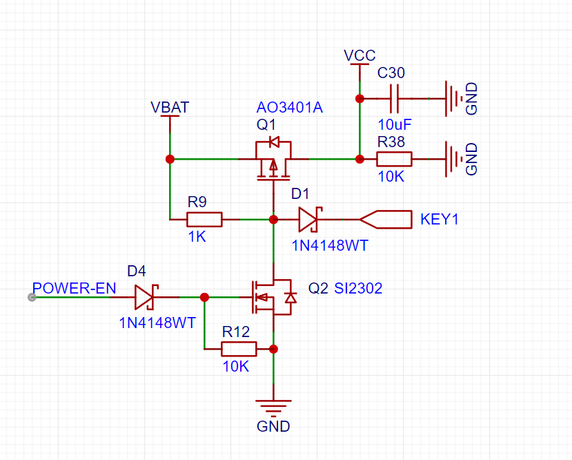

1.1 Automatic Power On/Off
This is a common circuit design, using a PMOS to control the positive terminal of the battery to connect to the system.
By default, the gate (G) of the PMOS is pulled high by a 1K resistor, cutting off conduction. In reality, it's difficult for a PMOS to be completely cut off. A larger pull-up resistor results in a larger leakage current; even with a 1K resistor, there's still leakage current, approximately 1.5~2V.
When the KEY1 button is pressed, it conducts to GND, pulling the gate (G) of the PMOS low, effectively short-circuiting the source and drain. At this point, the ESP32 microcontroller is powered on at 3.3V via the DC-DC step-down circuit. Once powered on, the ESP32 sets a high level on the POWER-EN pin, turning on the NMOS and pulling the PMOS's gate low. Releasing the button keeps the PMOS conducting. To power off, the ESP32 sets a low level on the POWER-EN pin.

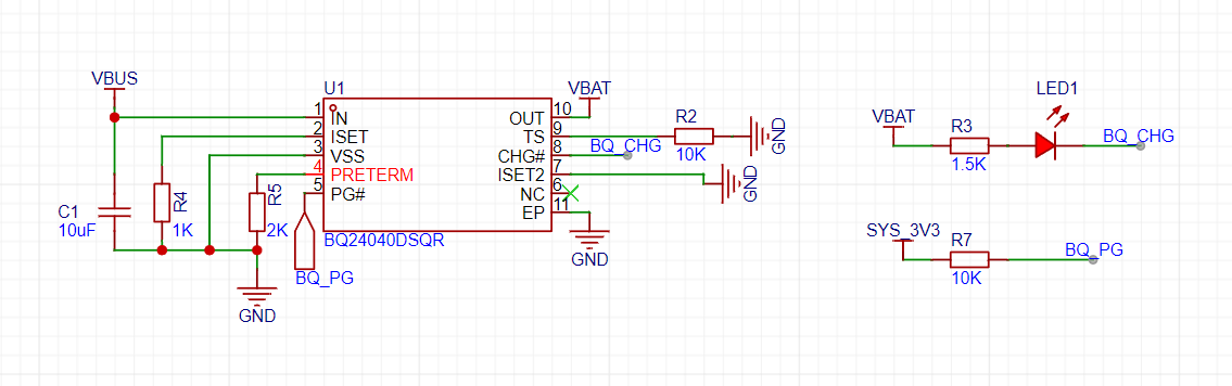

1.2 Charging IC
: A single-cell lithium battery 3.7V charging IC is selected. When a power source is detected, BQ-PG is pulled low, allowing the microcontroller to detect the power supply connection. This can be linked to the charging state switching of the LVGL.

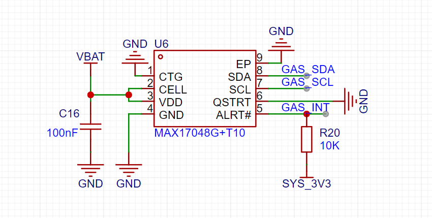

1.3 Fuel Gauge
This fuel gauge uses an I2C peripheral driver. The GAS-INT pin is pulled low when the battery is low, sending a low battery signal to the ESP32.
Linking with LVGL allows for battery level detection, and linking with the charging IC provides a comprehensive overview of charging information.

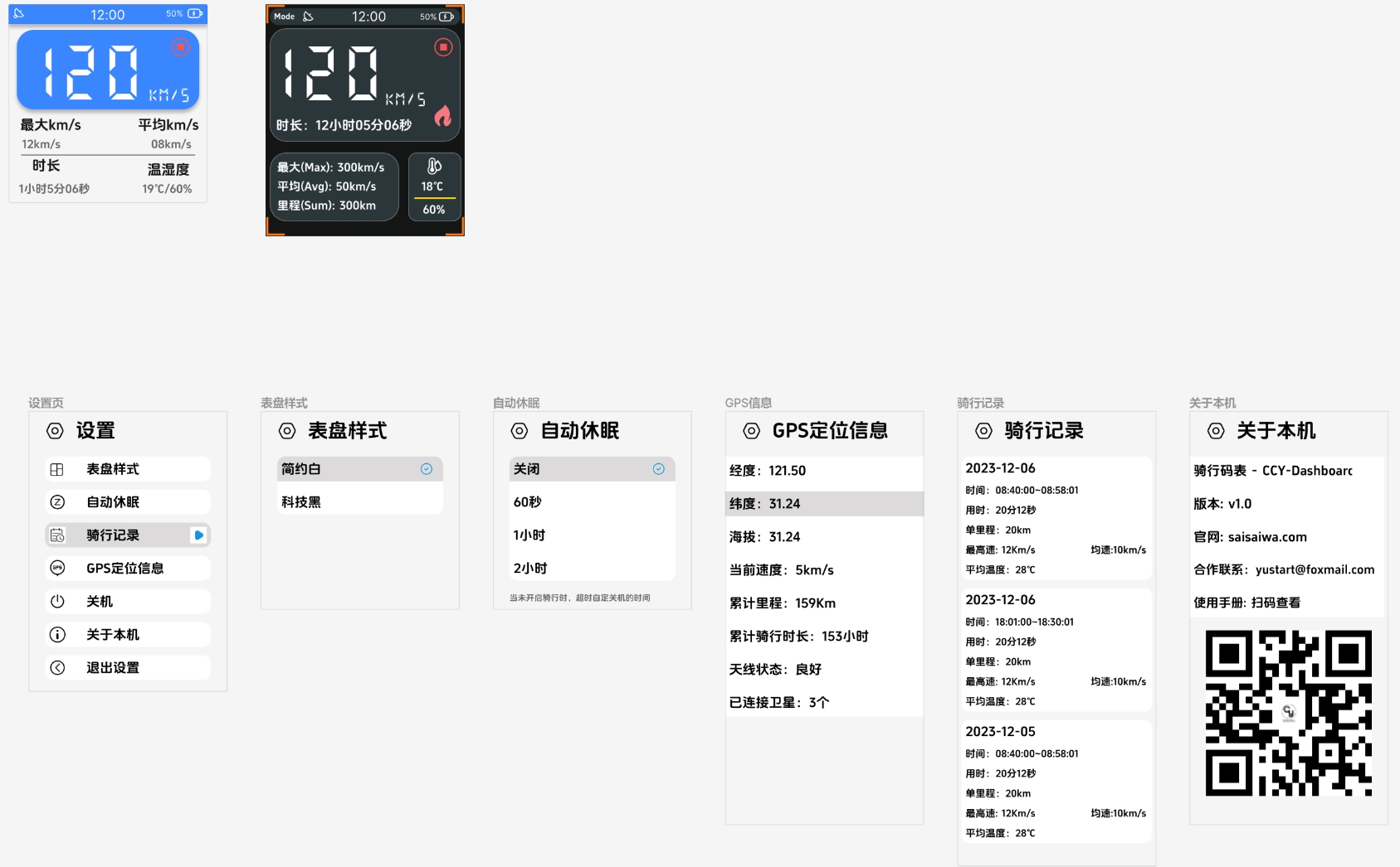

UI Design The UI
project framework is designed modularly, using CMake to manage
the LVGL source code and project UI code (framework). One codebase is used by both the SDL simulator and ESP32IDF. CMake environment variables distinguish different environment build files.
The script folder provides a font generator, image generator, and image compositer (multiple images are generated into a single .bin file). All scripts are written in Python.

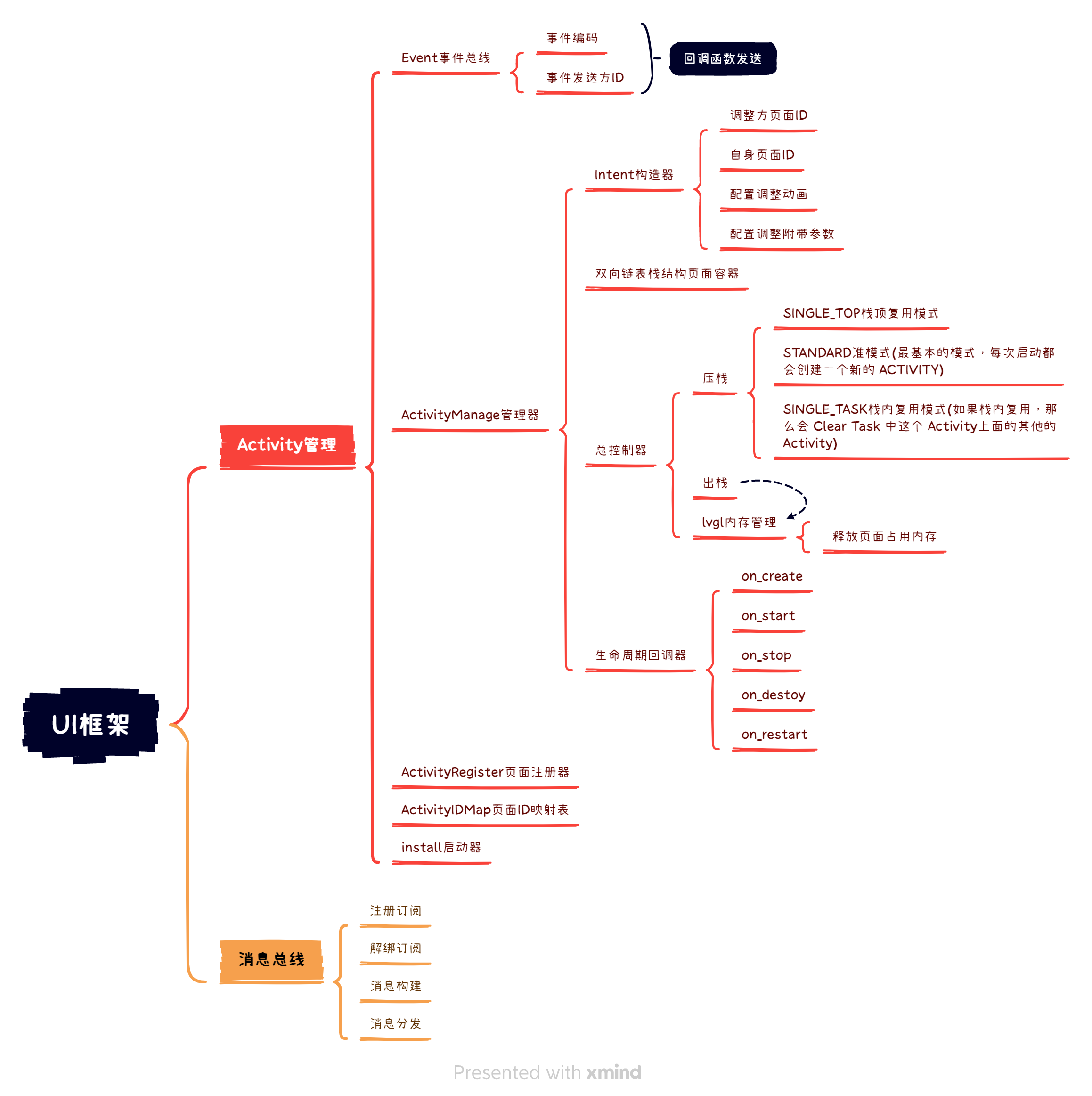

2.1 LVGL Page Framework
The core algorithm of the page management framework is a doubly linked dynamic list for management.
Functions include
various lifecycle callback controls,
page animation controls,
dynamic parameters,
a message bus (EventBus),
page operation tools, methods,
components, memory management
(lv_group), input event grouping management
(lv_indev), redefining input callbacks, key types
, etc.

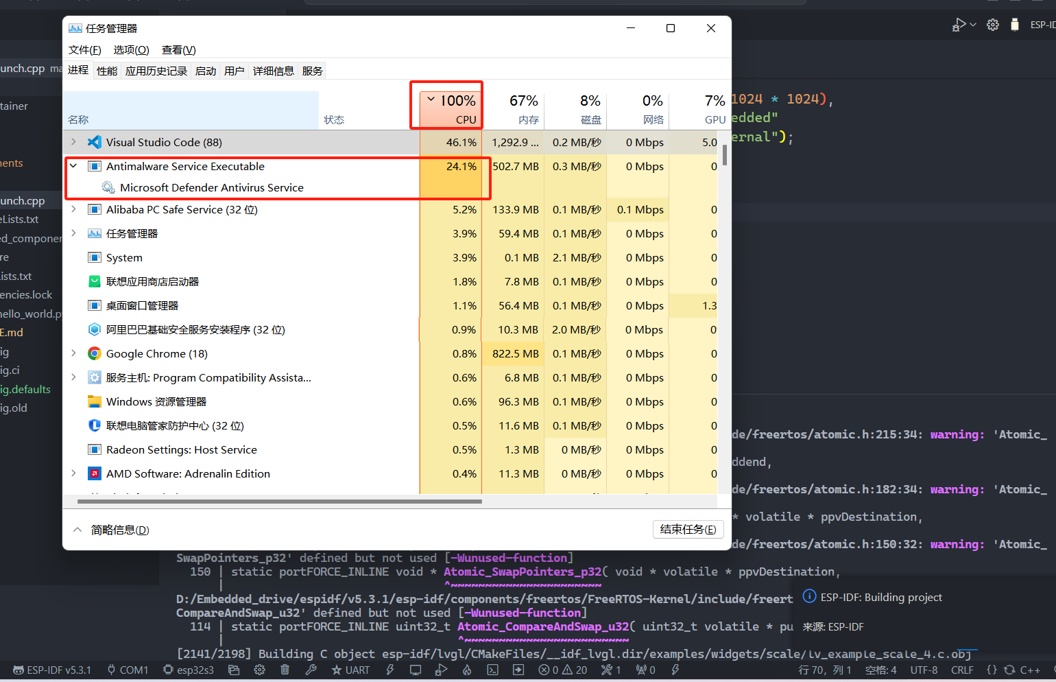

5.1 IDF compilation speed is very slow, but 100% CPU usage
is due to Microsoft Defender. Turn off this built-in antivirus program.
