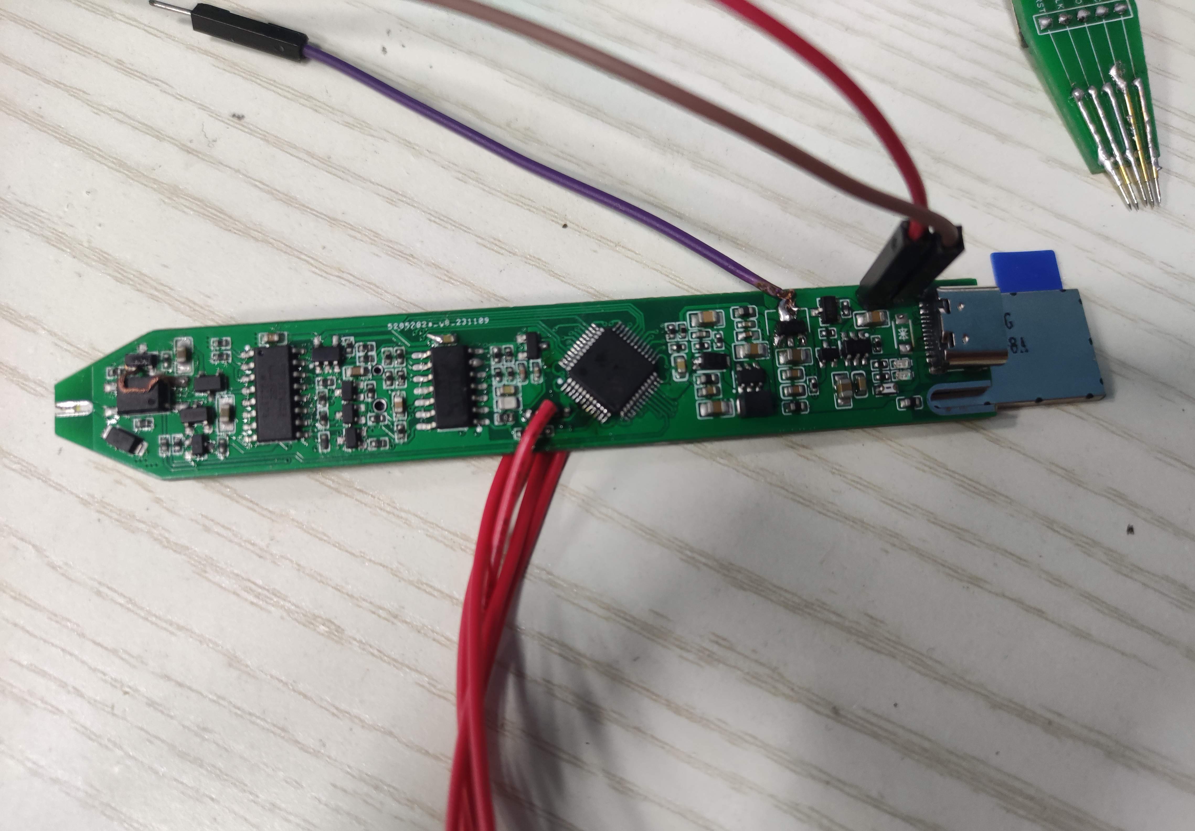

Multifunctional test pen
Specific functions include:
1. Voltage measurement + threshold judgment; the threshold level can be set according to requirements to meet different logic level scenarios, and it has a traffic light indication function;
2. Continuity measurement, and the threshold resistance can be adjusted according to requirements;
3. Diode measurement, measuring the conduction voltage and lighting up one diode;
4. PWM output, convenient for providing a known quantity to test the system in some scenarios, and can also be used to test passive buzzers, etc.;
5. PWM input, which can measure frequency;
6. DC output, simulating a required DC level for testing;
7. It can be connected to an expansion board for joint measurement.
The PCB length is within 10cm, and the PCB can be obtained from JLCPCB for free. Most of the resistors and capacitors use 0402 packages.
