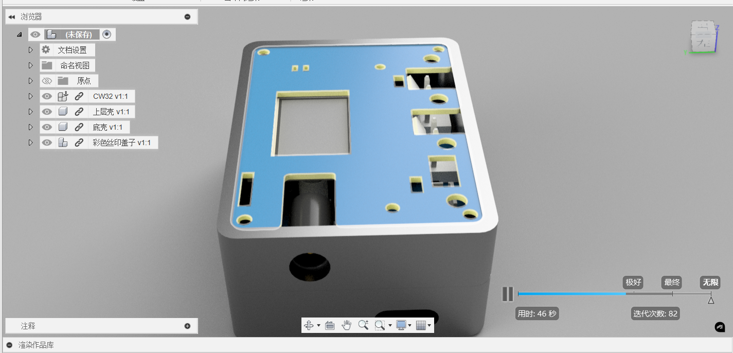

Modified the shell wall thickness to reduce the gap between the PCB board and the shell.

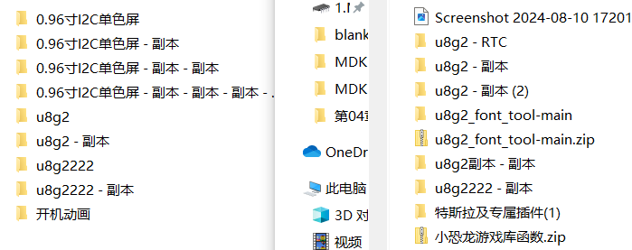

Uploaded the ported u8g2 graphics library code (a clean graphics library, without using other miscellaneous libraries), making it convenient for those who need to use the u8g2 library on CW32.

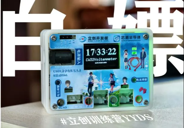

the hardware

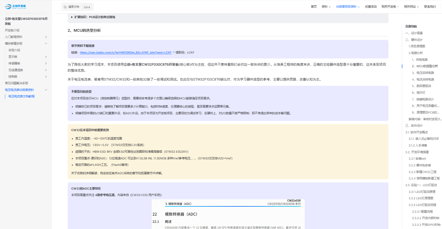

part mainly references the "CW32 Digital Voltage and Current Meter Training Camp Project Tutorial Document". Only the plug-in components were changed to surface-mount components, and the digital tube was changed to a 0.96OLED display; other than that, there were almost no changes.
The tutorial documents and videos, covering both hardware and software, are very detailed and comprehensive, making learning relatively easy. (Thumbs up to the engineers and staff of this training camp OvO)
(Excerpt from the tutorial documents) ^

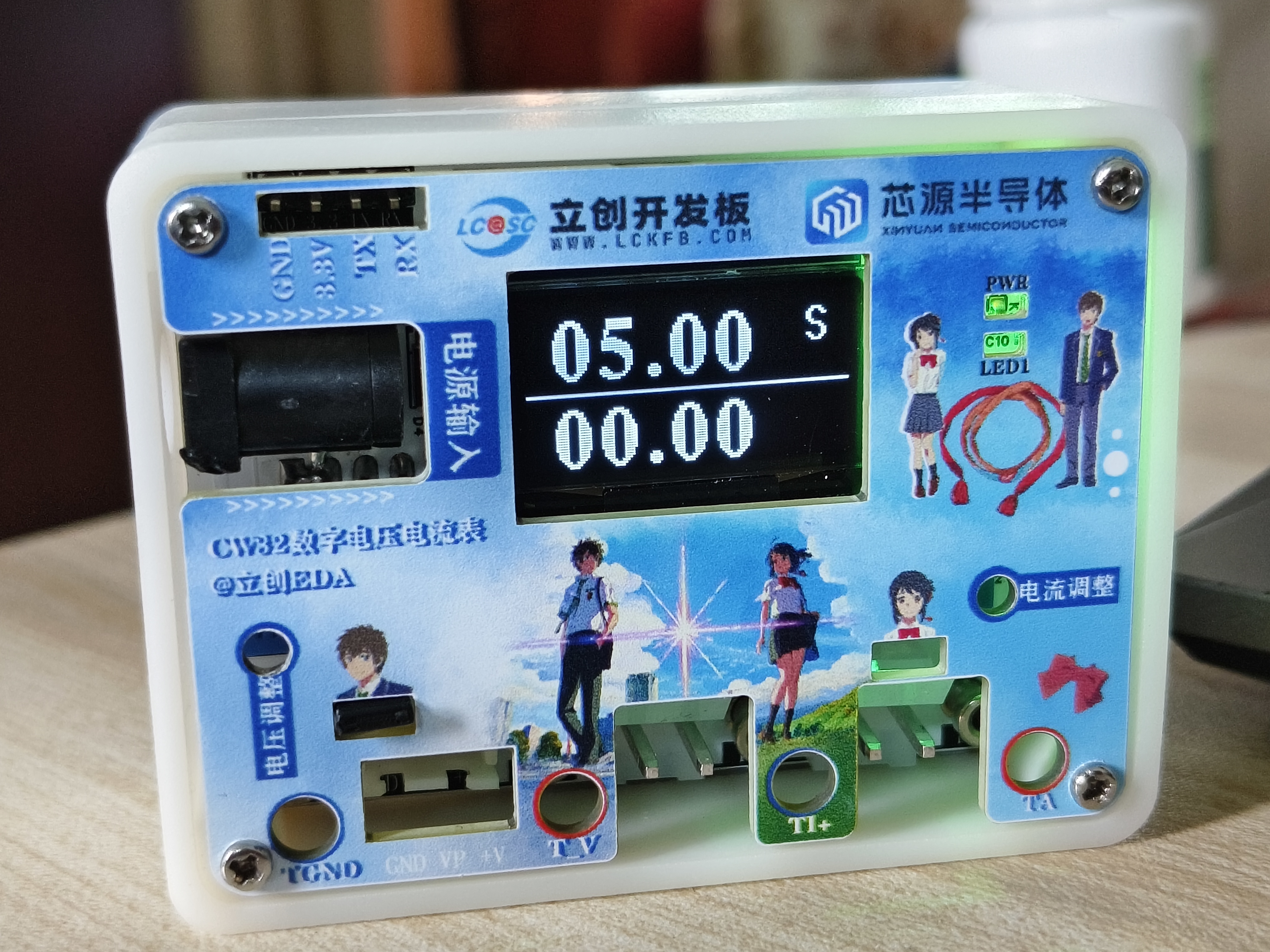

Note that in calibration mode, units are not displayed; in voltage calibration mode, "S" is displayed in the upper right corner; in current calibration mode, "A" is displayed in the lower right corner.
(5V calibration mode)^

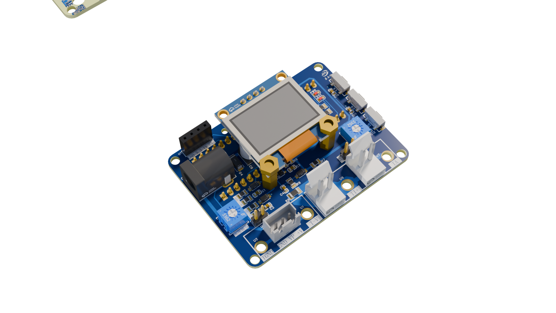

(PCB rendering)^

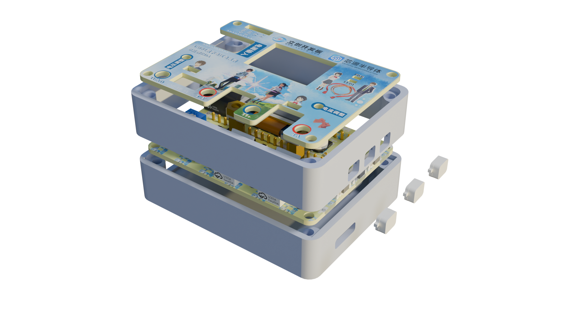

(3D casing rendering)^
(Actual product image; the color silkscreen printing was done in Photoshop, I really love it)^
The large gaps in the exterior have been modified, so you can use it with confidence
(modified exterior rendering)^

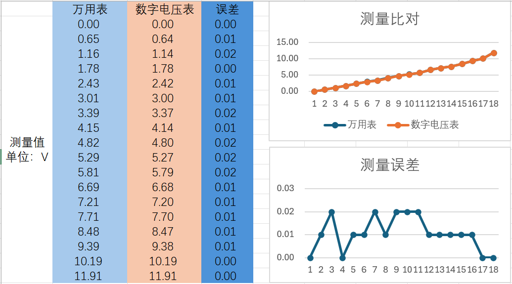

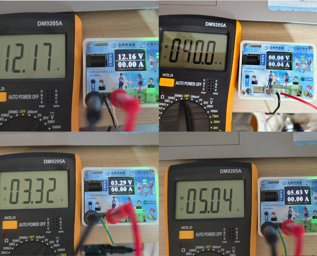

: The basic function is to measure voltage and current. Since the debugging
process was done with a 12V power supply, it went smoothly. The values ​​calculated by the CW32 sampling measurement are quite close to those measured by the multimeter (I bought the multimeter for 10 RMB).
I can't say how high the accuracy is, but it's definitely fine for everyday measurements. This is all thanks to the engineers in this training camp project; I love you all so much!

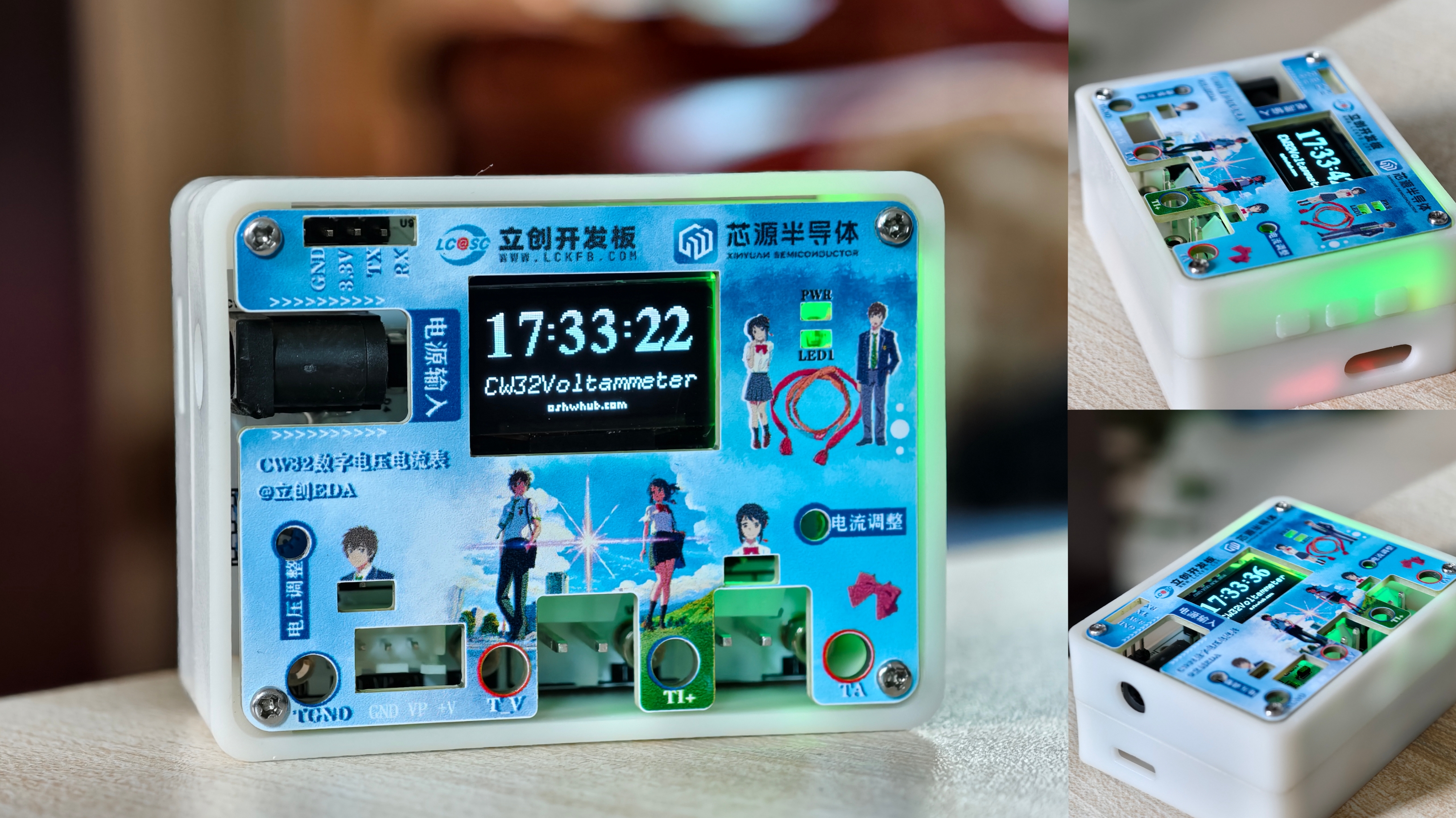

Digital clock, simple serial port assistant, multi-level menu, etc.
Because the initial goal was to create a beautiful and practical multi-functional little box, the u8g2 graphics library was ported, and a multi-level menu was written.
I added a lithium battery, which wasn't necessary. It's just a "small product" I made during this training camp that I really love. I play with it all the time, and it can also be used as a small desktop ornament. OvO

. The CW32's RAM is 8kb, while the current code is only 2.8kb. However, adding u8g2 display functions to the current code causes garbled characters or incomplete display on the OLED screen.
This strange issue directly led to the menu style selection not being available in the settings, but instead requiring two separate codebases
(the author will actively learn and improve the functionality T^T).

However, rest assured, while the extended functionality is not perfect, the measurement function is normal and easy to use. Furthermore, after software compensation, the error is very small, ranging from 0.01 to 0.03.
Due to equipment limitations, voltage measurement was only performed within the 0-12V range. Current measurement also lacked the necessary power supply; currently, only 40mA can be measured, with almost no error.
The small box has a built-in 1200mA lithium battery, so it does not require a power supply. The inaccurate measurement issue is also resolved through software compensation.
