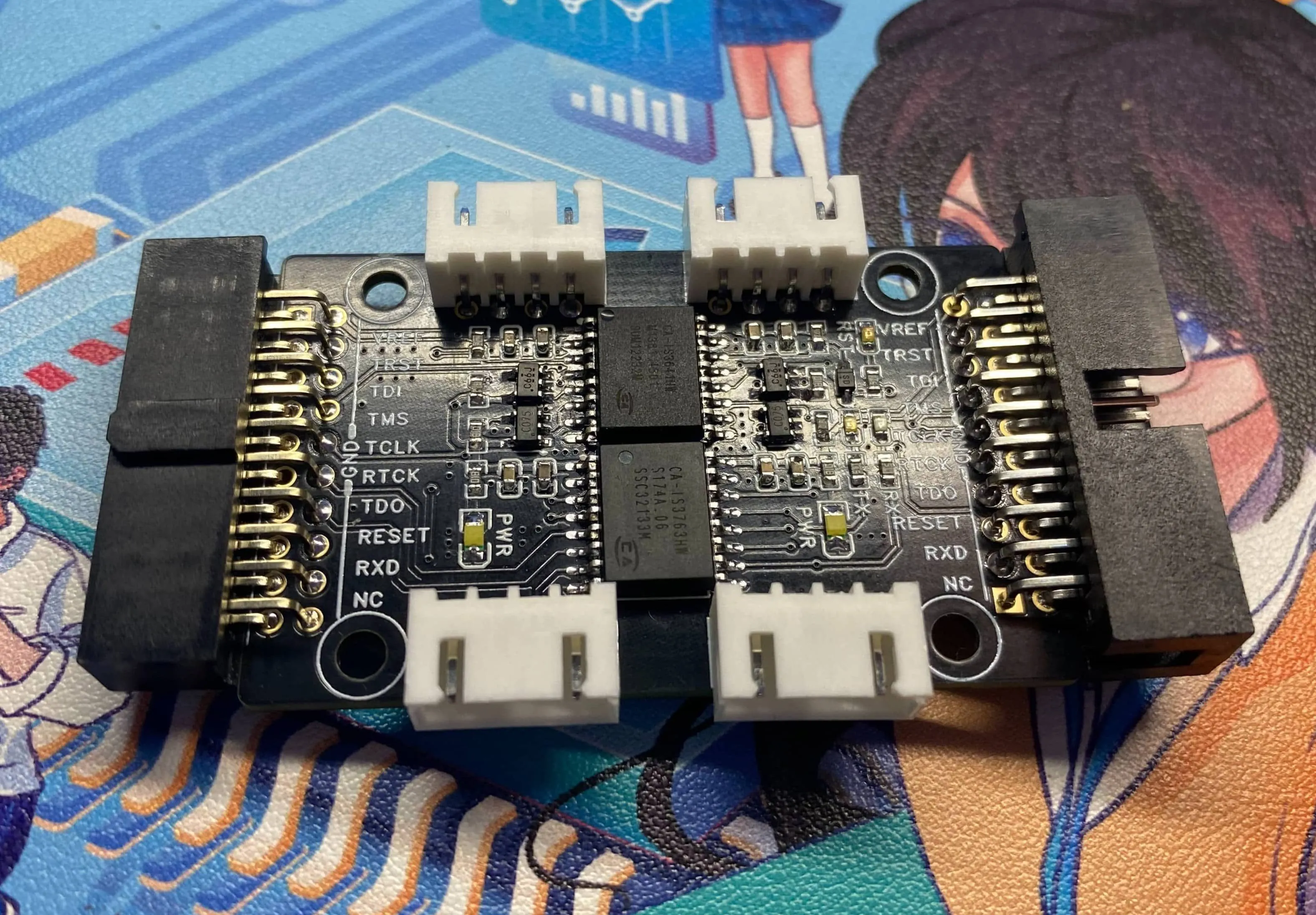

Project Introduction:
1. This open-source isolation expansion board is compatible with the JTAG interface. It supports electrical isolation of serial port, SWD, and JTAG interfaces, suitable for motor debugging, BMS development, and other scenarios requiring isolation, enabling microcontroller program download or serial port testing.
2. For ease of use, we have brought out the SWD and serial port to an independent XH2.54 4P interface, which is compatible with the pin order of Zhengdian Atom. During download, this connector can be used directly, which is very convenient. It also supports female DuPont wire connection.
Features:
Plugs into the JLink's JTAG interface, has an onboard isolated power supply with a power indicator light. The programmer automatically outputs 3.3V after power-on.
Regardless of whether the isolated front end outputs 5V or 3.3V, the isolated power supply is uniformly 3.3V.
When there is data on the serial port, the Rx or TX light will indicate this.
If the programmer is hardware reset, the onboard RST light will also indicate this.

Test progress:
[x] Serial port isolation test
[x] SWD download isolation test
[x] JTAG download isolation test
1. Due to the low isolation chip speed, the microcontroller recognition in SWD mode needs to be adjusted to 3MHz (for reference only):
2. Using the D version of J-Link v9 in JTAG mode (for reference only):
Please note that if your code disables the JTAG pin, you cannot use JTAG mode to download normally. You need to switch to SWD mode or other modes and download the code that does not disable the JTAG function. Generally, JTAG is enabled by default.
Modifying the BOOT pins can also enable downloading.
3. Using the Zhengdian Atom DAP, a stable download speed of 5MHz can be achieved (for reference only):
Therefore, regarding the speed issue, you can modify the isolation chip or circuit scheme according to your own needs. This open source is for reference only.
Physical Demonstration
Precautions
1. When soldering, please pay attention to the soldering order to ensure the power supply is correct and to avoid burning out subsequent circuits! The soldering order should follow the principle of from shortest to smallest, and from inside to outside.
2. The circuit has been verified. Solder according to the component parameters in the schematic diagram. It is recommended to prioritize soldering the main controller, which is more difficult to solder; a heated soldering station is recommended
. 3. When using board cleaning fluid, be careful not to touch the buttons, as corrosion will make them difficult to use.
4. It is recommended to use the schematic diagram parameters; the BOM table contains errors.
