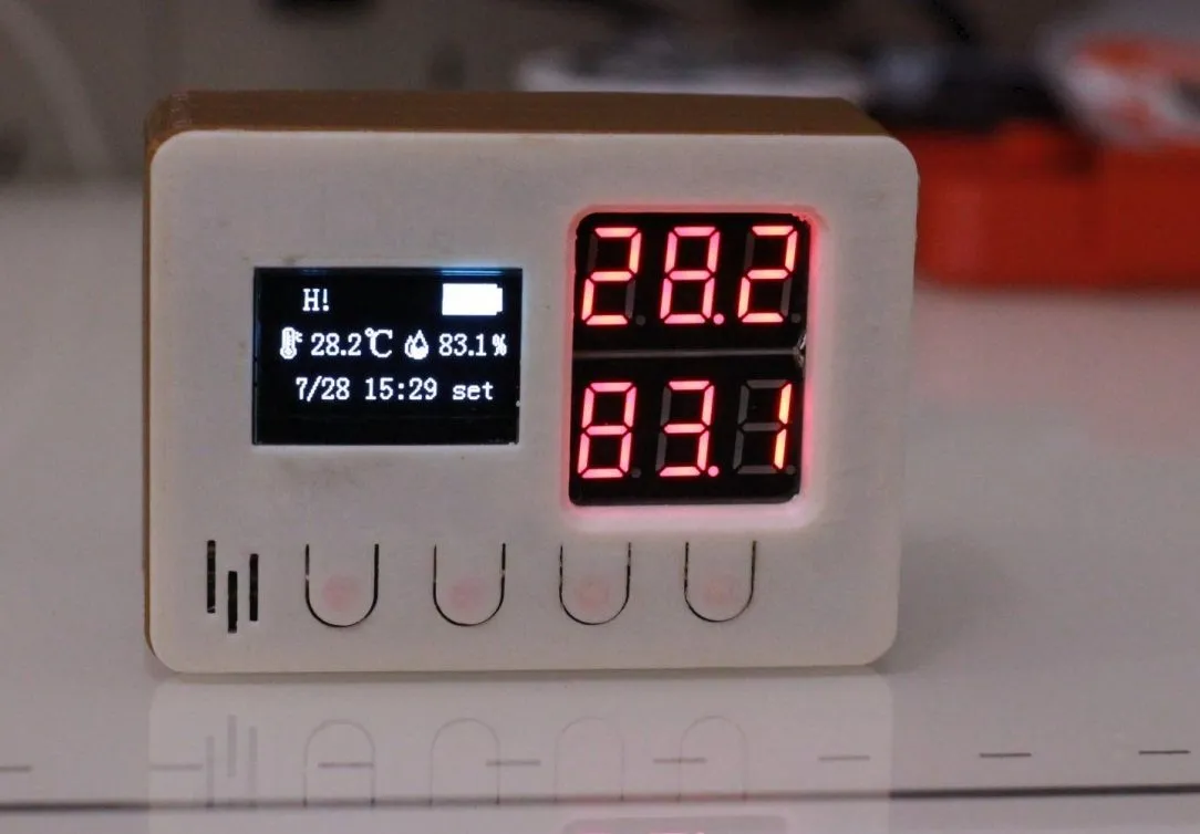

4.5 Housing Design The
housing design mainly considers the OLED display area, digital tube display area, button area, and temperature and humidity sensor area in conjunction with the PCB layout. See the following figures for the housing design:
Figure 22. Housing Model Design Figure
23. Housing Image

*7. Verification image of the competition logo
(Figure 27). A physical image of the circuit board containing the competition logo.
