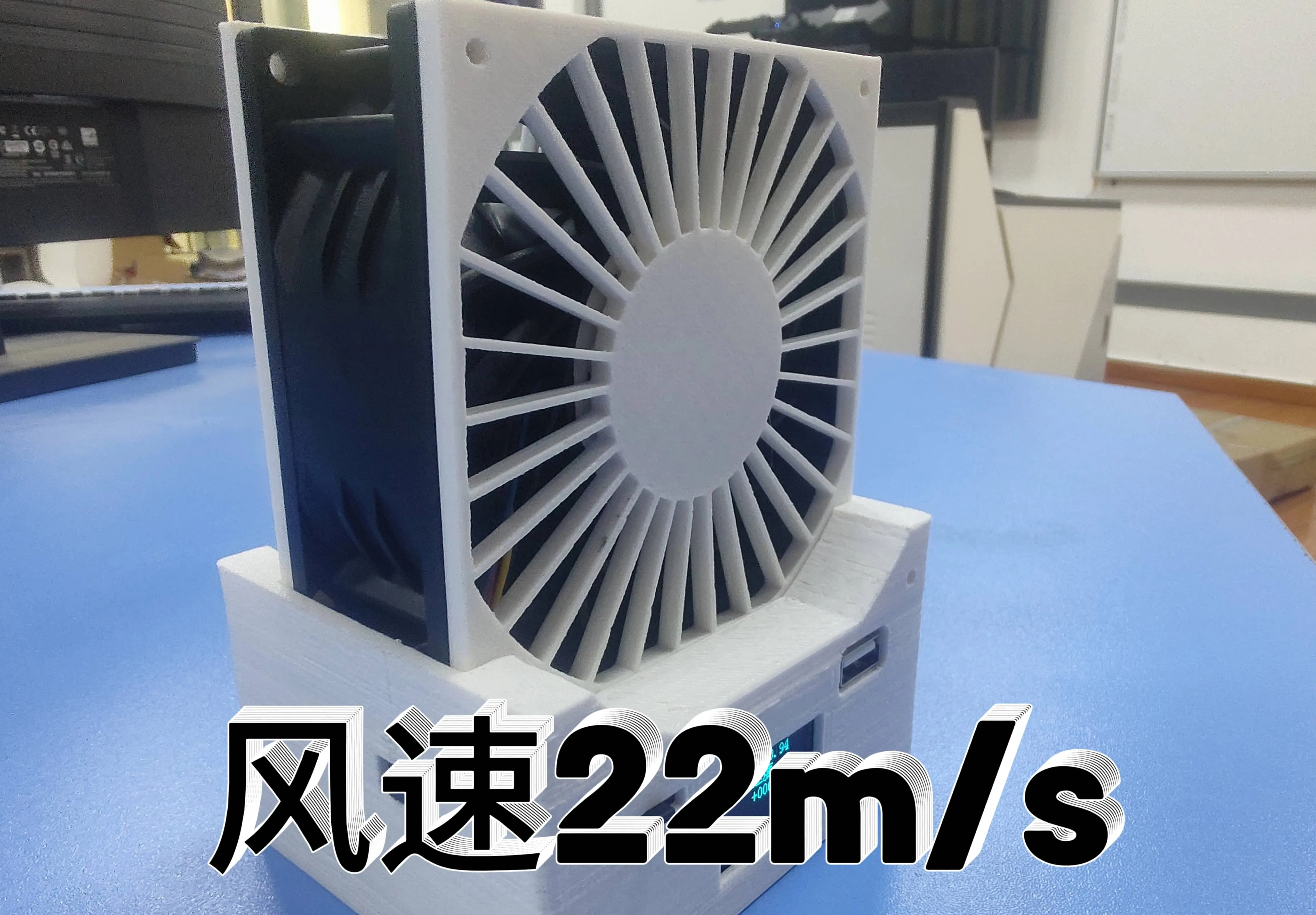

Summer handheld fan
Project Description:
Summer Handheld Fan; Adjustable speed settings 0-255, 22 m/s fan speed on full charge;
PWM (10KHz) 0-255 duty cycle control;
0.96-inch OLED display; Supports real-time voltage display;
Supports 9V, 7V, and 5V input charging; Supports power bank functionality, supports BC1.2, Apple, Samsung, QC2.0/3.0, MTK PE1.1/PE2.0, Huawei, and Spreadtrum fast charging protocols;
Uses a 9CM Delta PFC0912DE fan;
Uses the free AIR 001;
Programmed using Arduino IDE.
Special Note: This description does not represent the final version and more details are still needed.

Project-related functions
: 1. Fast charging function:
TYPE-C charging port, located on the back of the project;
supports 5V, 7V, and 9V PD fixed voltage inducement. The specific inducement voltage depends on whether the charger used supports the PD voltage of that level;
for more information, please refer to the IP2326 chip datasheet.
2. Button operation:
The side toggle switch is the main switch, powering the entire system.
The front has a two-position toggle switch; tossing it to the right increases the position by one, and tossing it to the left decreases it by one; pressing it turns on the power bank output function, and pressing it again turns it off.
3. Fan speed control function
: The speed is adjustable from 0-255; PWM drives the MOSFET to adjust the fan's VCC speed;
theoretically supports any 12V fan, as long as GND and VCC are connected correctly.
4. Power Bank Functionality
: Supports power bank functionality, compatible with BC1.2, Apple, Samsung, QC2.0/3.0, MTK PE1.1/PE2.0, Huawei, and Spreadtrum fast charging protocols;
for more information, please refer to the IP6505 chip datasheet.
5. 0.96-inch OLED Screen:
After toggling the side power button, the OLED screen displays the battery voltage and fan speed setting;

Image display:
Voltage 10.28V, 255 full speed setting, wind speed 20 m/s.
Detailed display.
Model display:
Fusion model.
Fusion rendered model.
