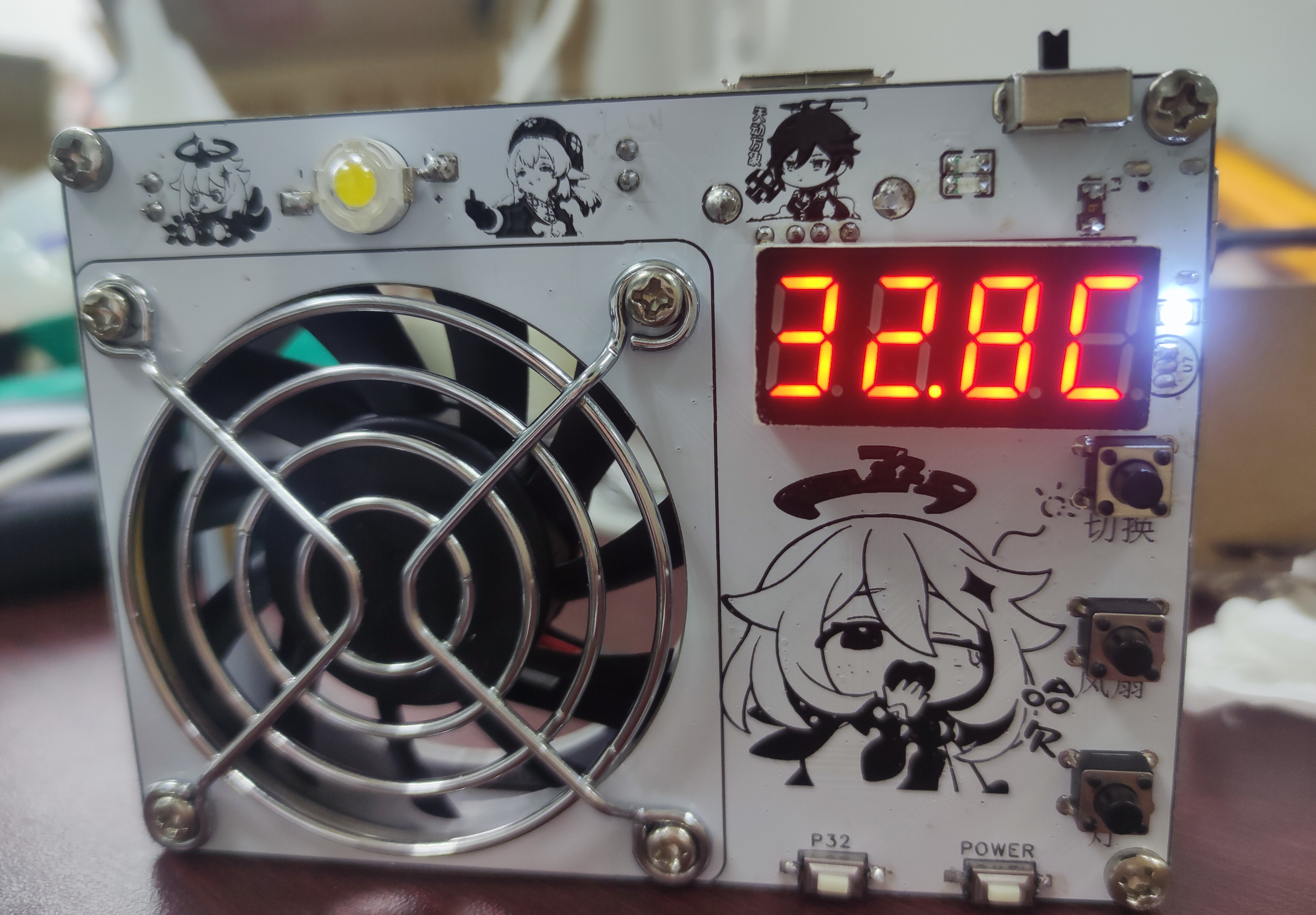

III. Physical Demonstration:

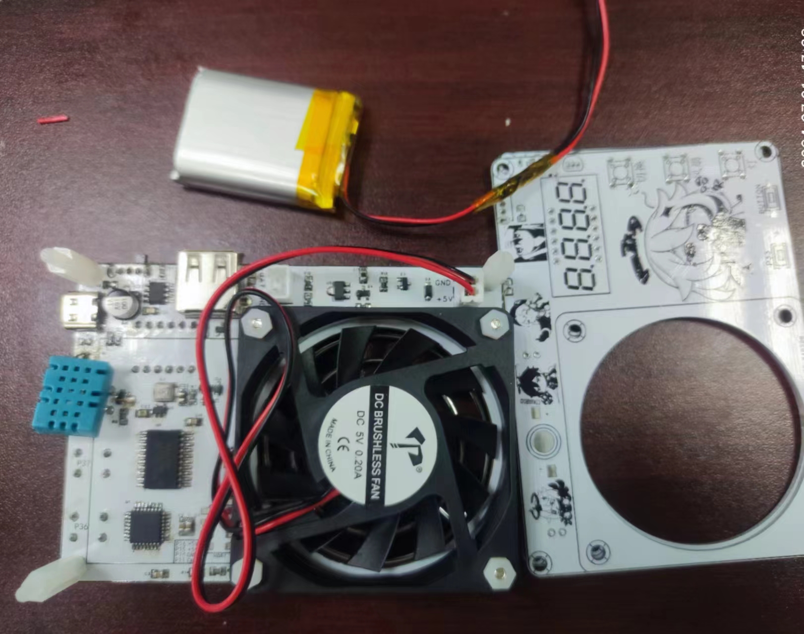

1. Internal components

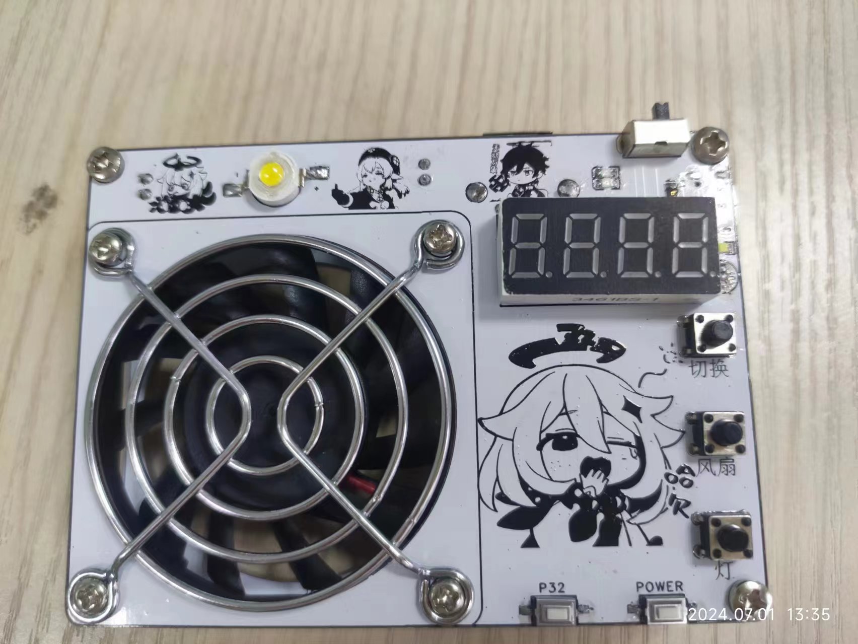

; 2. First interface (default no display)

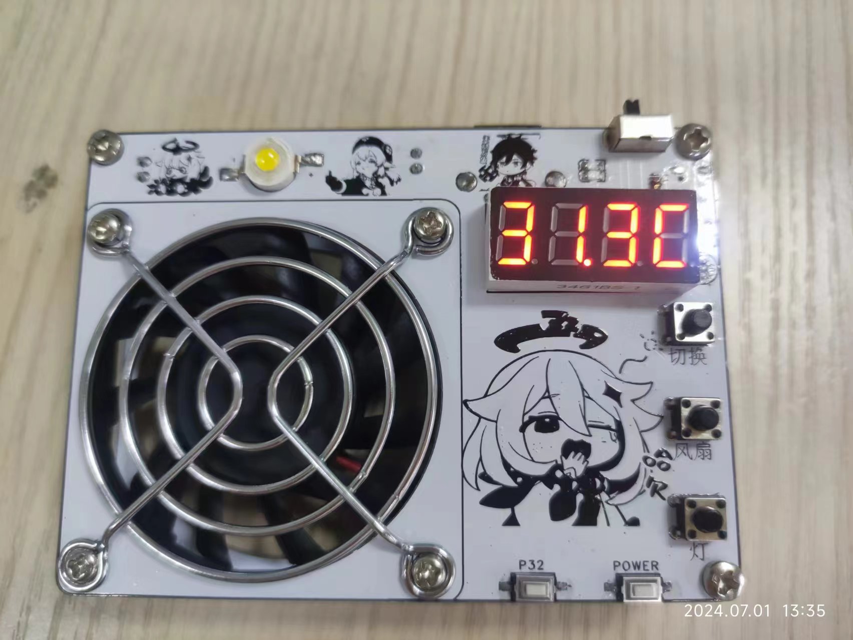

; 3. Second interface (temperature display)

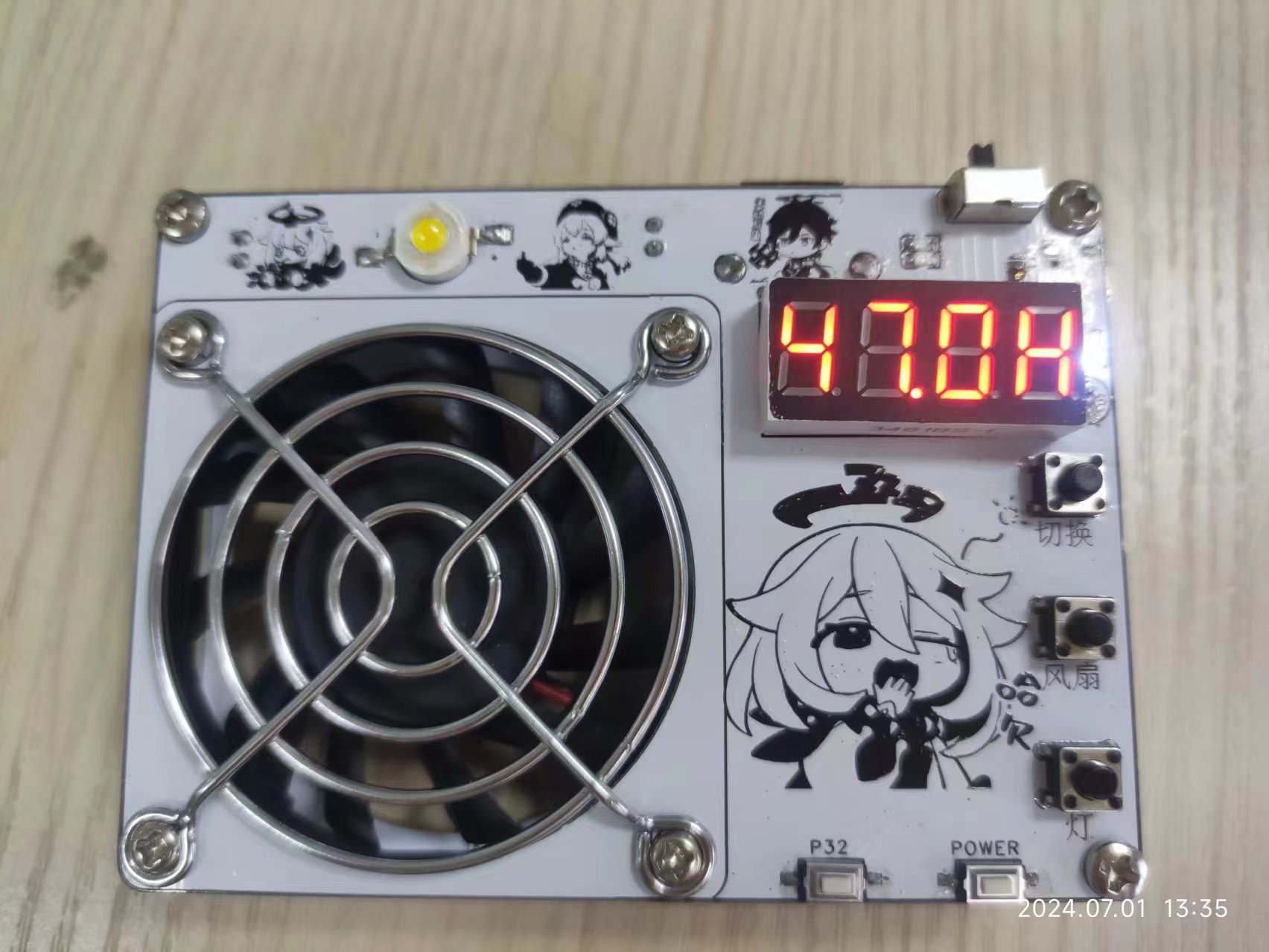

; 4. Second interface (humidity display)

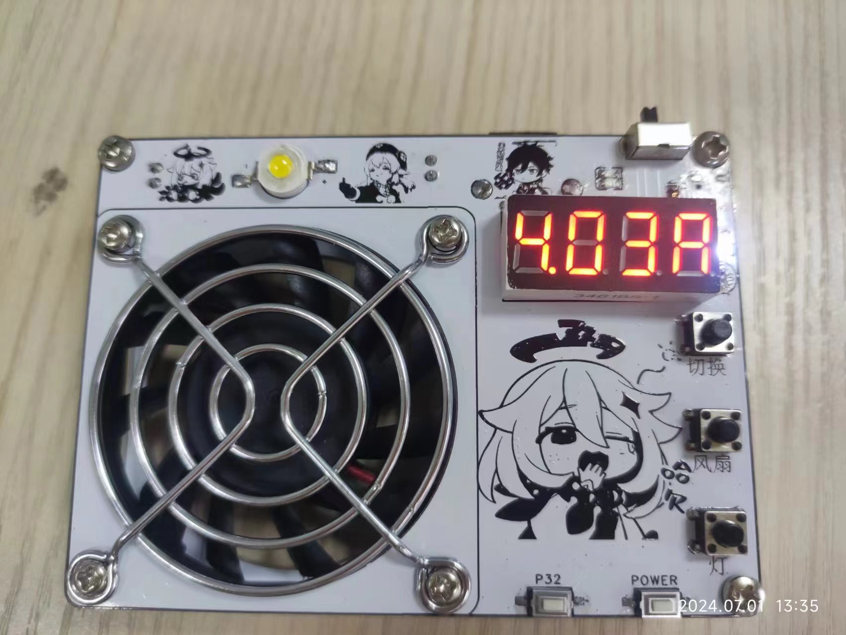

; 5. Third interface (battery voltage display).
