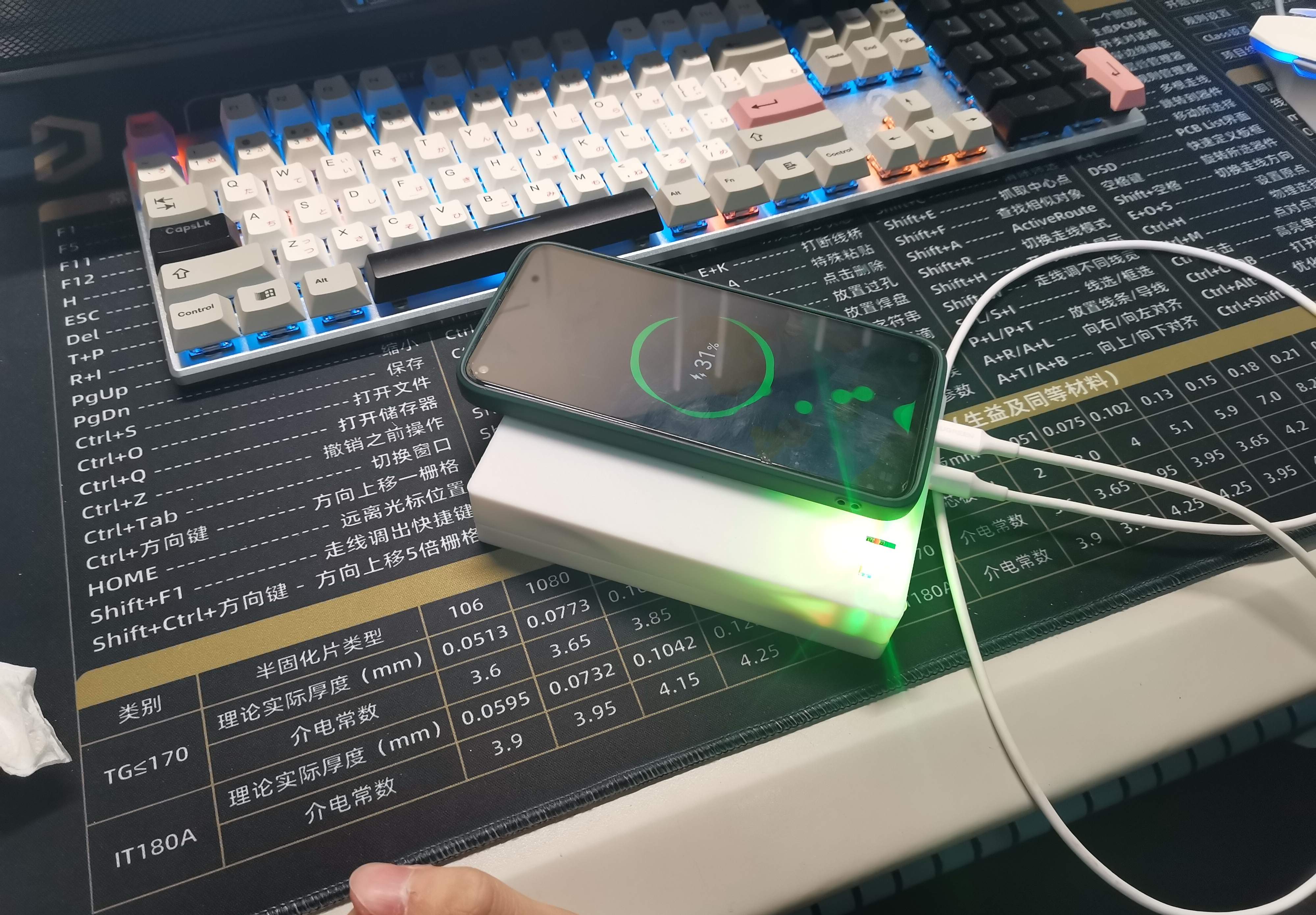

The circuit uses the Ingenic IP5389 and can be designed according to the reference manual.
Atomizing pads are used to simulate the smoke effect, with a wet cotton swab for water supply.
One USB-A port and two USB-C ports are designed. The USB-A port is a normal output port, and one USB-C port is a normal bidirectional port; however, the other USB-C port is designed for input only. In testing, it can steal battery from a mobile phone (doge). The atomizing pad is connected to this port, and it sprays mist immediately upon plugging it in, making it suitable for pranks.
