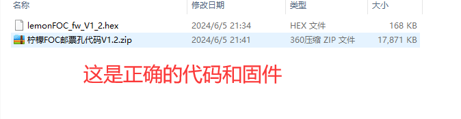

June 5, 2024 Update:
Sorry, the code and firmware were uploaded incorrectly. A correct version of the code and firmware is now uploaded. June
8, 2024 Update:
Updated the PCB for the motor and encoder carrier boards; it's the attached "Motor + Encoder Carrier Board V1.1.zip".

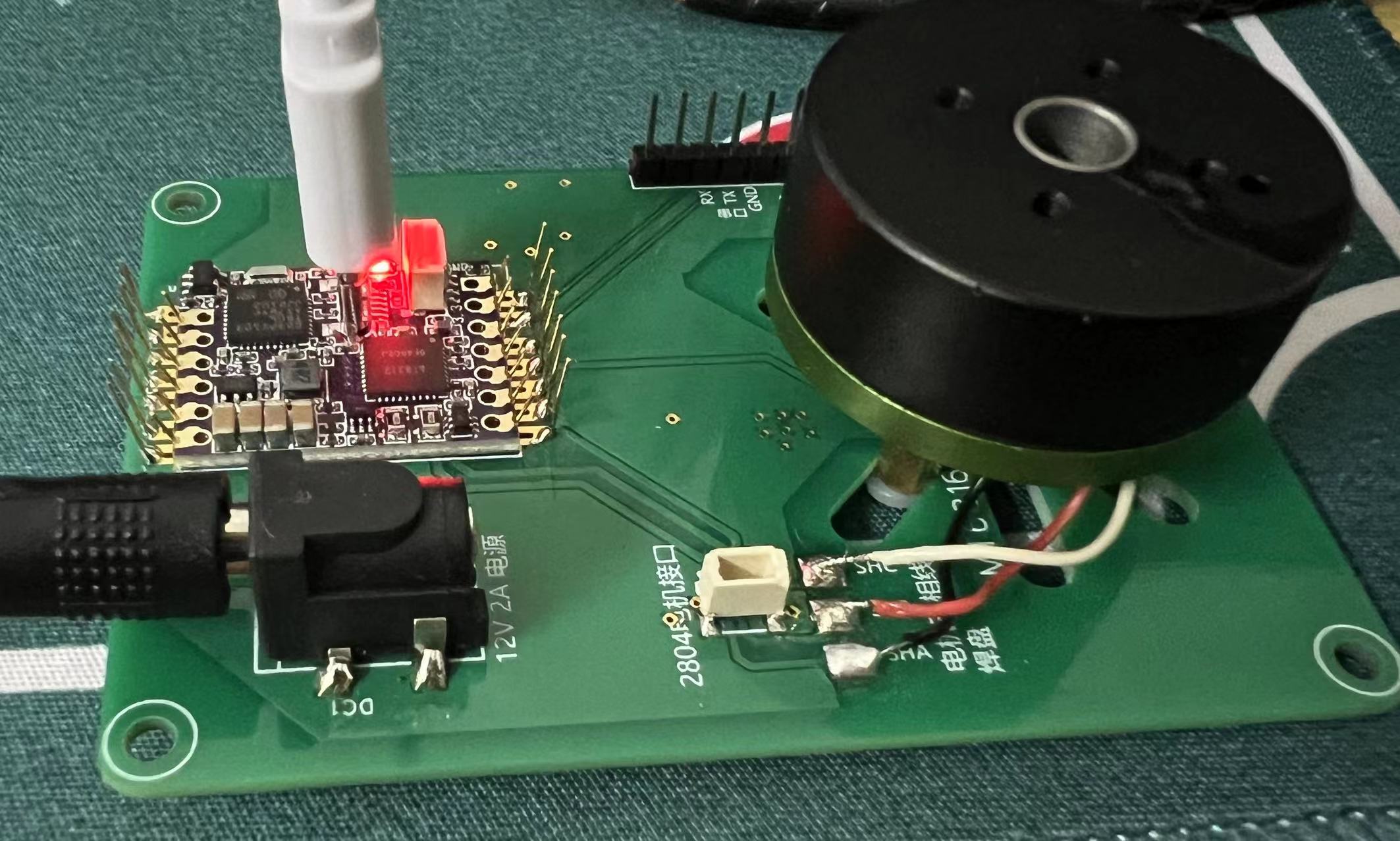

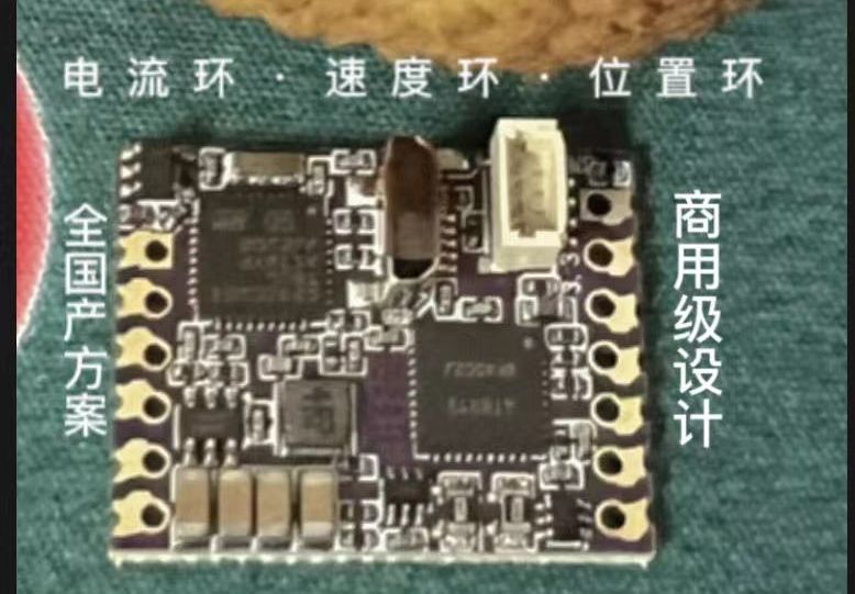

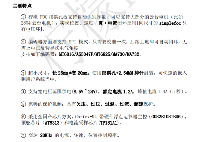

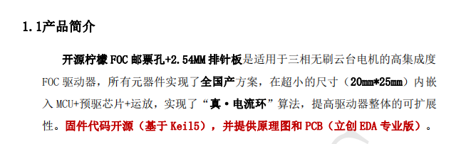

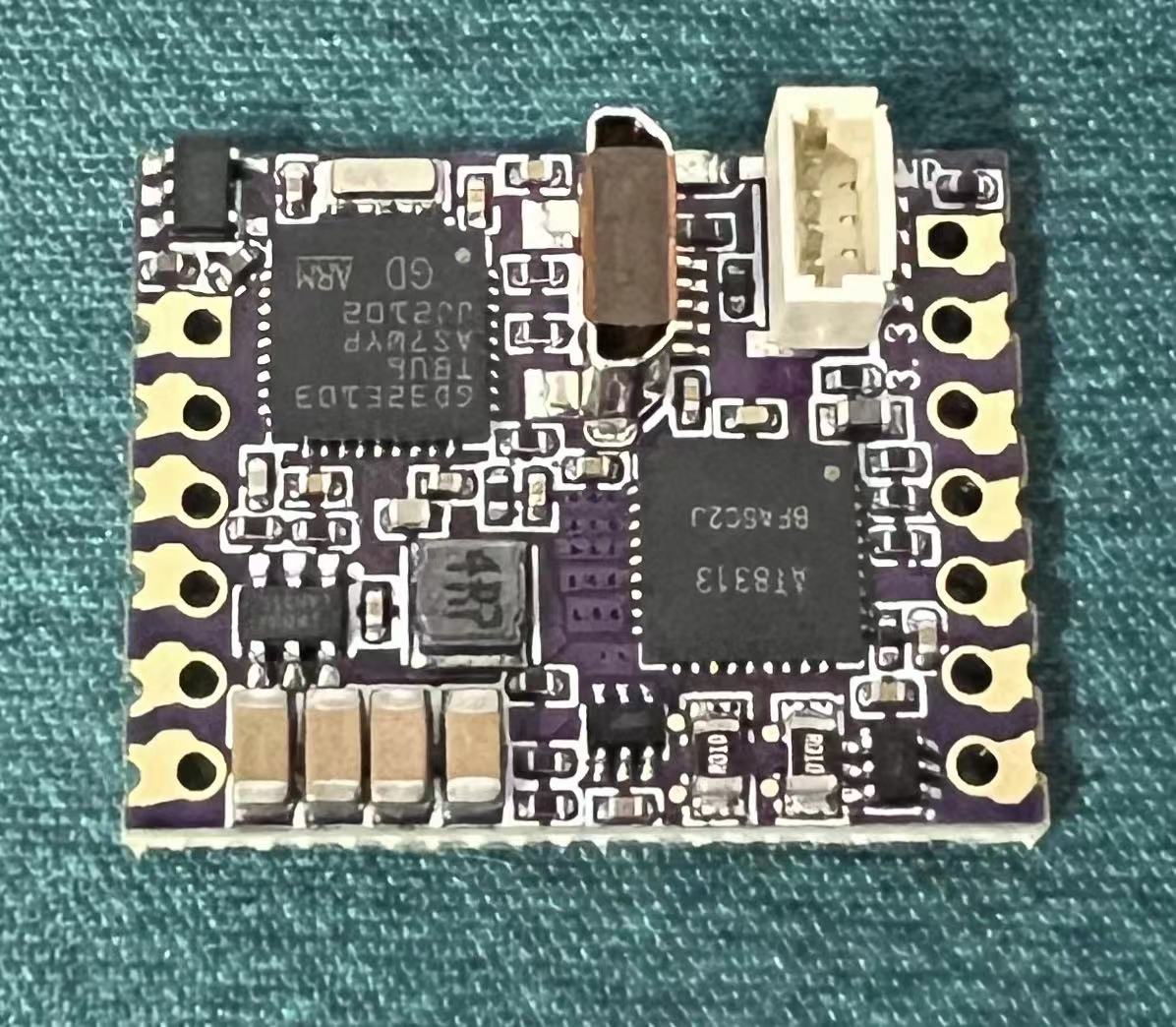

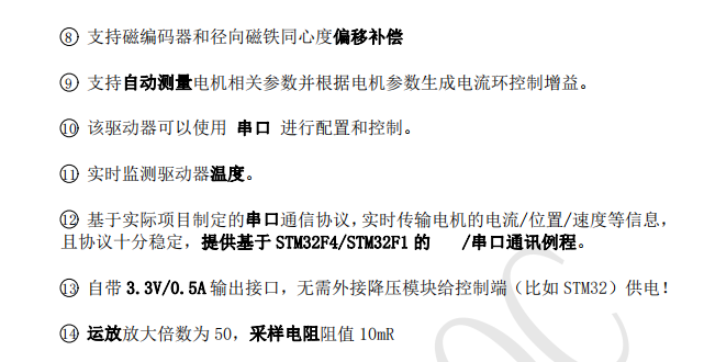

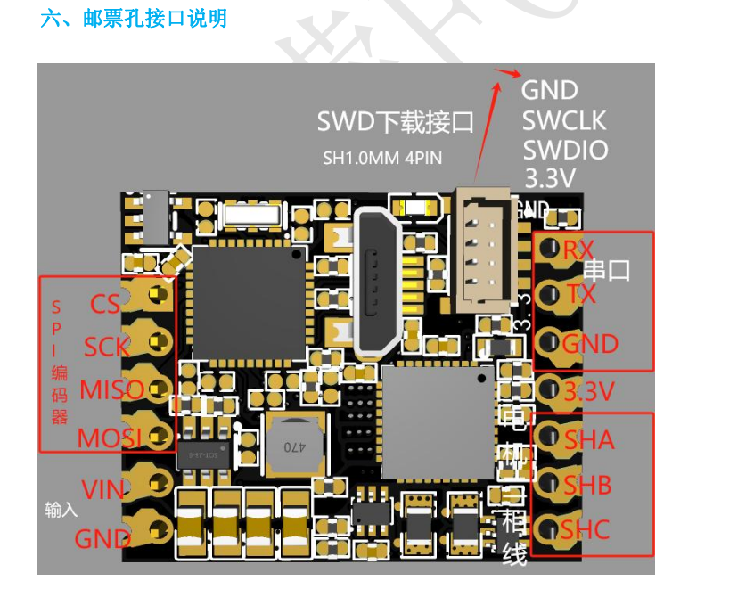

Lemon's FOC open-source stamp perforated board code is compiled using Keil 5 for easy debugging. The FOC algorithm is ported from Odrive, with performance stronger than Simplefoc but slightly weaker than Odrive. It uses a fully domestically produced solution: the MCU uses GigaDevice's GD32E103TBU6, the pre-driver chip uses Zhongke Microelectronics' AT8313, and the current sampling chip uses TP181. Most components are domestically produced or readily available on Taobao, greatly reducing DIY costs. It's an essential tool for beginners learning the FOC algorithm.
III. JLCPCB Prototyping Instructions:

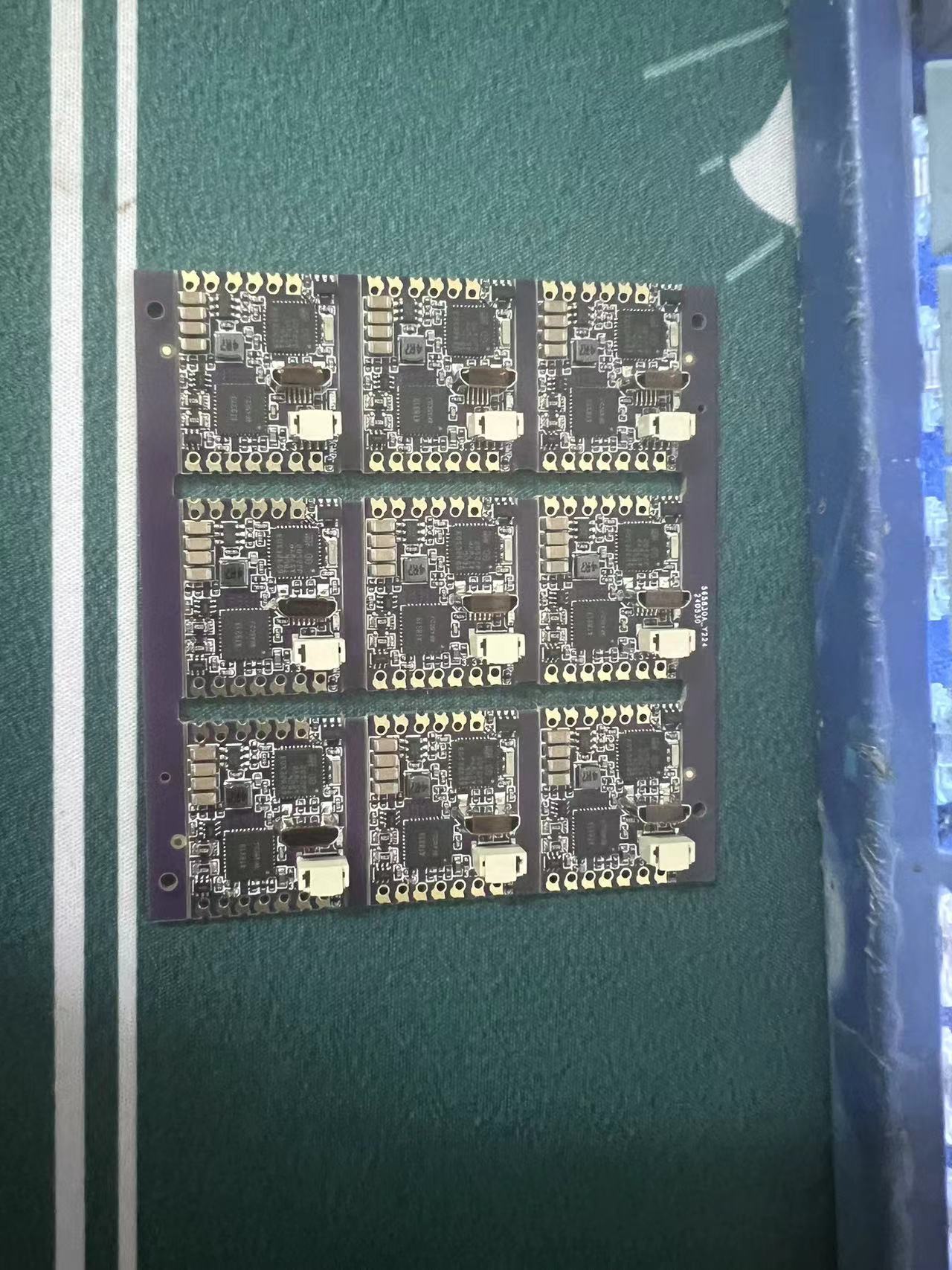

1. The stamp perforated board uses a 4-layer design, with dimensions of 25mm*20mm. Purely manual soldering is quite difficult. It's recommended to use JLCPCB's SMT service if possible; you can simply attach capacitors and resistors.

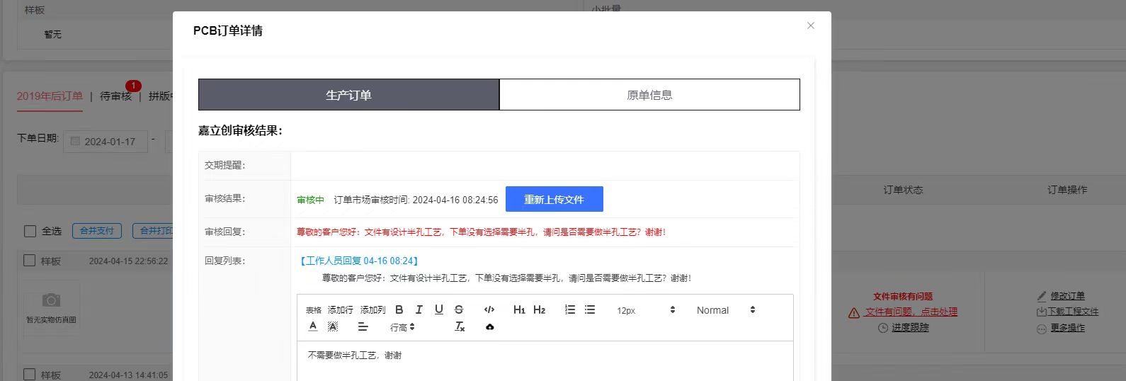

2. The stamp-hole board uses a half-hole process. When prototyping with JLCPCB, you can directly prototypify without using the half-hole process (it's too expensive!), as shown in the image below. Just make a note during prototyping. However, the edges of the stamp holes will be rough, requiring manual polishing later.

Many friends have privately messaged me saying that their foundation is weak, and even with open source, it's difficult to reproduce and learn! To make it easier for everyone, I have listed a batch of finished stamp-hole boards on Taobao. You can integrate them into your board more easily through the stamp holes (good news for students doing graduation projects)! Welcome to inquire by searching "Lemon FOC" on Taobao! For those who need customized FOC designs, please contact me.
