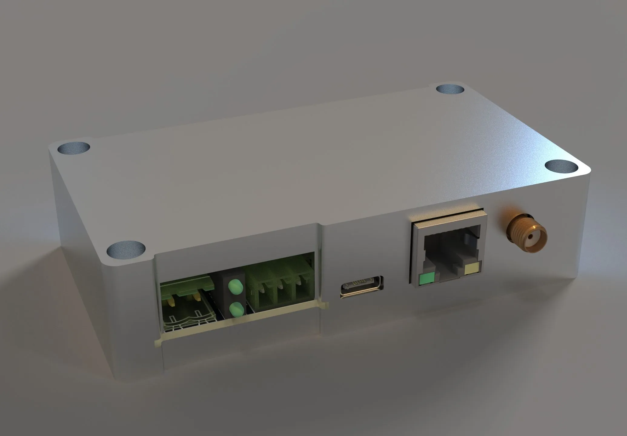

Project Introduction:
This project designs a DTU edge gateway based on the Espressif Systems ESP32-S3 module. Utilizing the high performance and low power consumption of the ESP32-S3 chip, a device capable of remote data transmission, real-time monitoring, and control is built. This project is applicable to multiple fields such as smart homes and industrial automation, supporting network connectivity and data transmission to the cloud via the chip's built-in Wi-Fi and an external Ethernet interface via SPI.
Core Functions:
Edge Computing:
Utilizing the performance of the ESP32-S3, secondary development is performed to collect data from various sensors or devices and upload it to the cloud for further processing and analysis.
Data Acquisition and Cloud Upload:
Through the module's Wi-Fi/Ethernet interfaces, the device can access Ethernet, supporting RS485/TTL to TCP data pass-through. (Other software functions are under implementation)
Serial Port
Terminal: Users can connect to the module terminal via USB interface and configure relevant parameters via command line.
ESD protection:
The RS485/CAN and power interfaces are equipped with TVS diodes to prevent damage from abnormal overvoltage.
Peripheral interfaces:
24V input,
WIFI/RJ45 10M/100M Ethernet networking,
RS485 interface*2,
TTL interface*1,
CAN interface *1
, output interface*2,
input interface*2.
Hardware solution
: Main controller ESP32-S3-WROOM-1U
24V-3.3V, SGM6232
, RJ45 Ethernet CH390,
RS485 UMW SP3485,
CAN SIT65HVD232DR
, input interface PC817, optocoupler isolation, input
/output interface HF46F-024-HS1 24V relay driven by ULN2003 .
