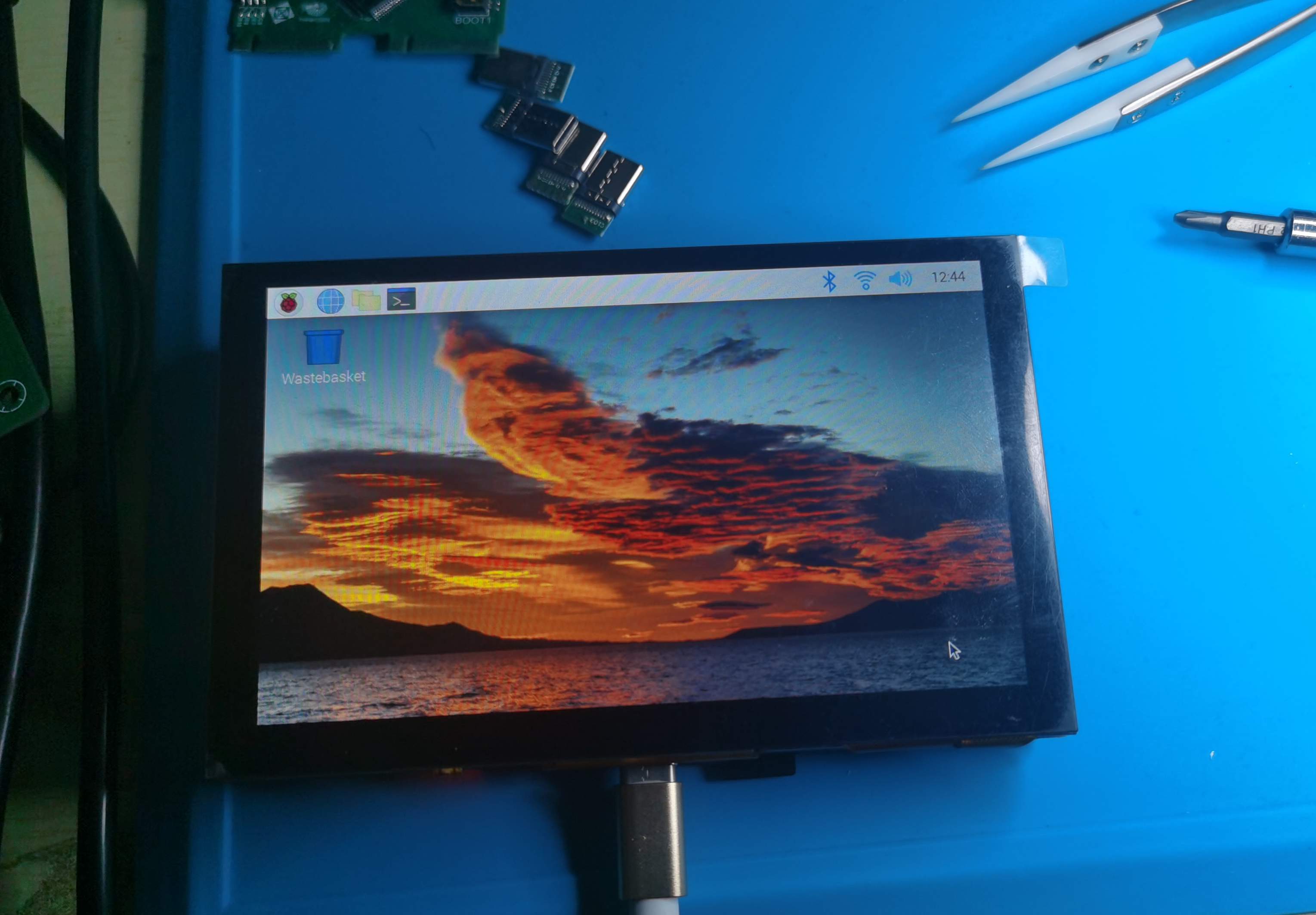

This project describes
a PC device designed based on the Raspberry Pi CM4 core board, running an Arm64 Linux system. Peripherals include:
a 5-inch 800x480 capacitive touchscreen, a MIPI interface
, an HDMI interface (supporting 4K 60fps according to Raspberry Pi's description),
a wired Ethernet port (for fast LAN access)
, two USB 2.0 ports (the CM4 only has one USB 2.0 port; these two are extended using a hub chip),
a MIPI webcam interface (supporting Raspberry Pi webcams)
, an M.2 4G interface (connecting to the USB 2.0 interface)
, an SD card slot (for SD card booting),
a Type-C power OTG interface, and
a Type-C power USB 2.0 interface
(the two Type-C interfaces cannot be used simultaneously; interface selection is controlled by BOOT. OTG master/slave mode is controlled by USBID. If BOOT mode is enabled, all USB 2.0 ports except OTG will be unavailable).

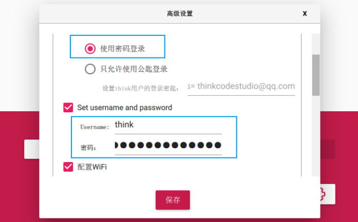

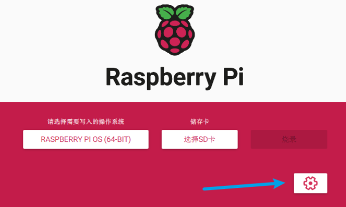

Burning the System
: Prepare an SD card as the system disk.

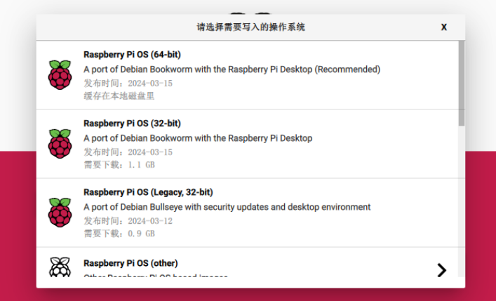

Download the Raspberry Pi system burning software. Download address: https://www.raspberrypi.com/software/
Select the 64-bit desktop system.
Open settings.
Open SSH.

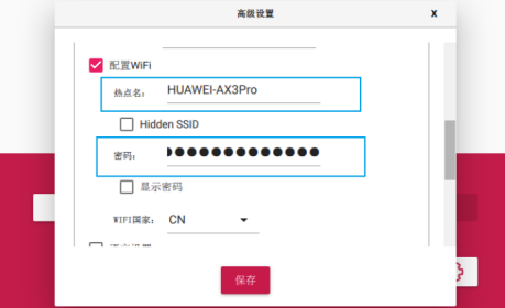

Set the username and password, and WiFi connection information.
Click save, then click burn.

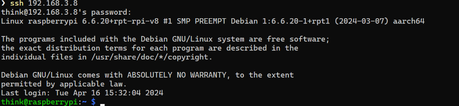

After burning, insert the SD card into the motherboard and power on. If normal, the Raspberry Pi will connect to your network; one status light will be constantly on, and the other will flash approximately every 5 seconds.
If it does not automatically connect to WiFi, try connecting the network port with an Ethernet cable.

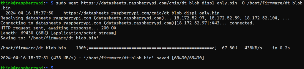

The Raspberry Pi does not display the MIPI screen by default; a driver needs to be installed.
To drive
the MIPI display
, log in to the Raspberry Pi via SSH.
The Raspberry Pi MIPI interface driver is available at this website: https://datasheets.raspberrypi.com/.
Use the wget command to download the driver and save it to the specified location.
Restart the Raspberry Pi.
After restarting, the MIPI screen will display. The startup process may be a bit slow,
with a black screen and only a blinking cursor in the upper left corner (encountered in newer systems).
This is due to insufficient power supply, possibly due to the new system. I am using 5V/3.1A. The software needs to restart after startup for the screen to display.

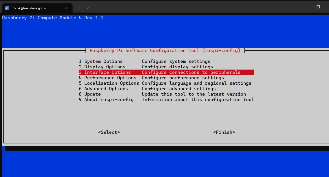

For touch input
, use commands to enter the system settings interface
and open the I2C
interface. Open the I2C
project .
