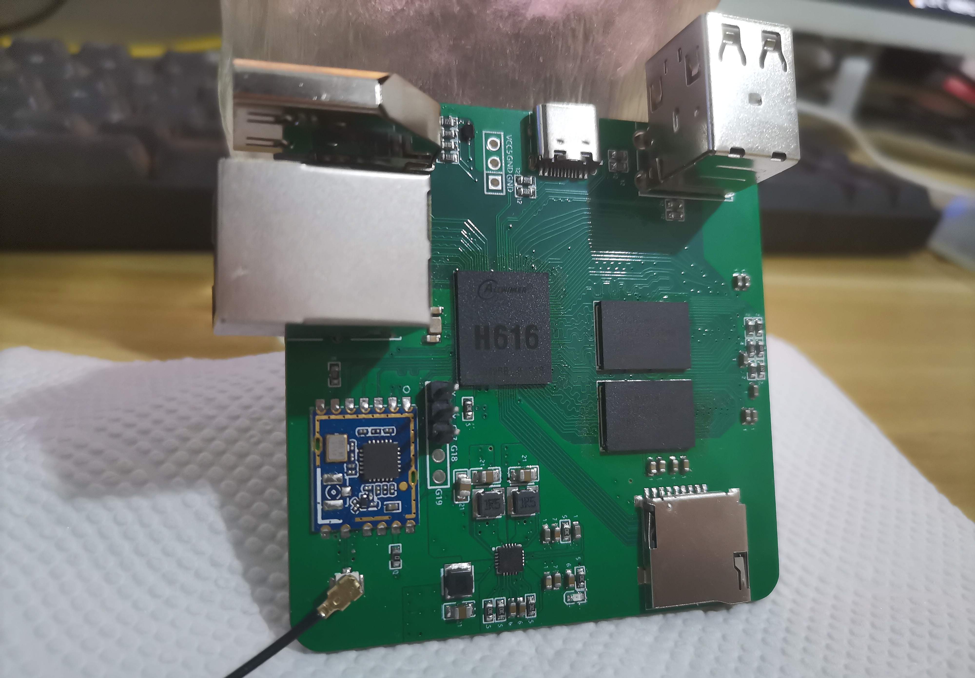

Allwinner H616 4-layer dual-layer memory Linux Ubuntu card computer
Onboard Resources
: CPU: 4 * A53
; Memory: DDR3(L) * 2
; Network: Ethernet 100M + RTL8189 WIFI;
Display: HDMI 4K@30;
Interfaces :
1. TF Card;
2. USB 2; 3.
Type-C 1 ; 4.
HDMI 1;
5. Ethernet 1; System:
Tina Linux (32bit)
, Ubuntu 22.04;
Deban11
; Deban12
; Android TV;
Performance :
CPU clock speed 1.4GHz;
Memory can run at 1056MHz on Allwinner HD (Tested NAND flash: H5TC8G63AMR-PBA DDR3L 1GB)
; Cost Estimate:
H616 + AXP313A = 42;
H5TC8G63AMR-PBA = 12;
RTL8189F = 5
; RJ45 Ethernet Port = 2;
Others = 10;
Notes:
The automatically generated BOM list below is incorrect. Please do not use it.
Select JLCPCB when placing an order >>> 4-layer 3313 laminated board <<<
Free vias, 0.3/0.4mm
board thickness, 1.6mm. [Link to
BOM purchase link] [Link to
finished product purchase link
] Revenue will be used to support the author's open-source project and future open-source efforts. Ubuntu Deban image and source
code
will be provided in the QQ group files. Other
discussion QQ group: 169300702.
Special thanks to @caowoye for supporting this project
. [Image]
