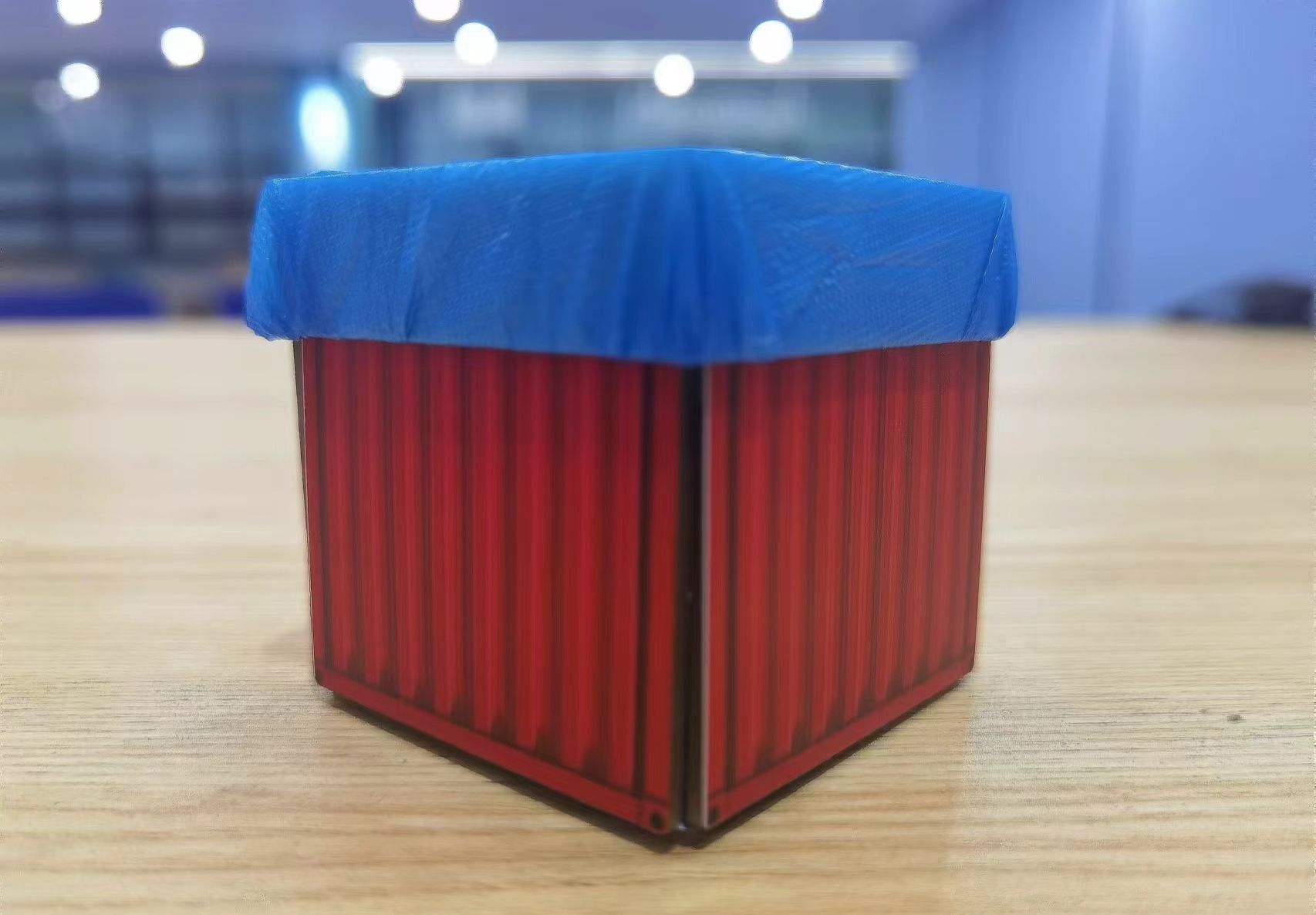

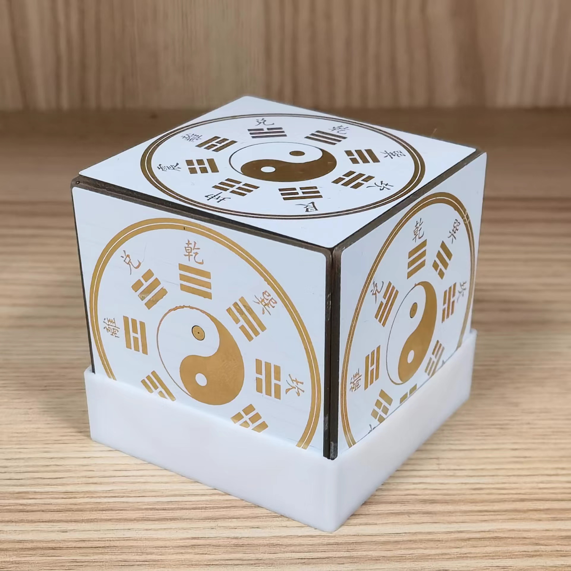

        consists of two PCBs: a PUBG-themed airdrop shell PCB (with color silkscreen printing) and a timed "egg-exploding" PCB . The
"egg-exploding" PCB
        is powered by a 3.7V lithium battery. The main controller is an STM32F103C8T6. TouchCheck pads connect to the gold Tai Chi pads on the shell for touch button activation. After activation, a countdown is displayed on a digital tube (with a buzzer indicating the interval between seconds, and the buzzer becomes more rapid during the last 3 seconds). After 10 seconds, it "explodes" (the digital tube displays "hhhh," and a passive buzzer plays Canon music).

        Four 0-ohm resistors configure the touch chip's touch adjustment mode (OP1, OP2 set to high/low level). During actual soldering, select OP1=OP2=1, i.e., solder R11 and R13 (R12 and R14 are not soldered).
        The minimum system board can be removed for other projects when not in use. The blue cap
on the "PUBG Airdrop Shell PCB"
        is composed of a 3D-printed blue shoe cover fitted with a cut-out piece. If blue paint is available, it can also be sprayed blue.
        After April Fool's Day, it can be flipped over, with the yin-yang symbol facing outwards (as shown in the picture), for enhanced decorative appeal and long-term use.
