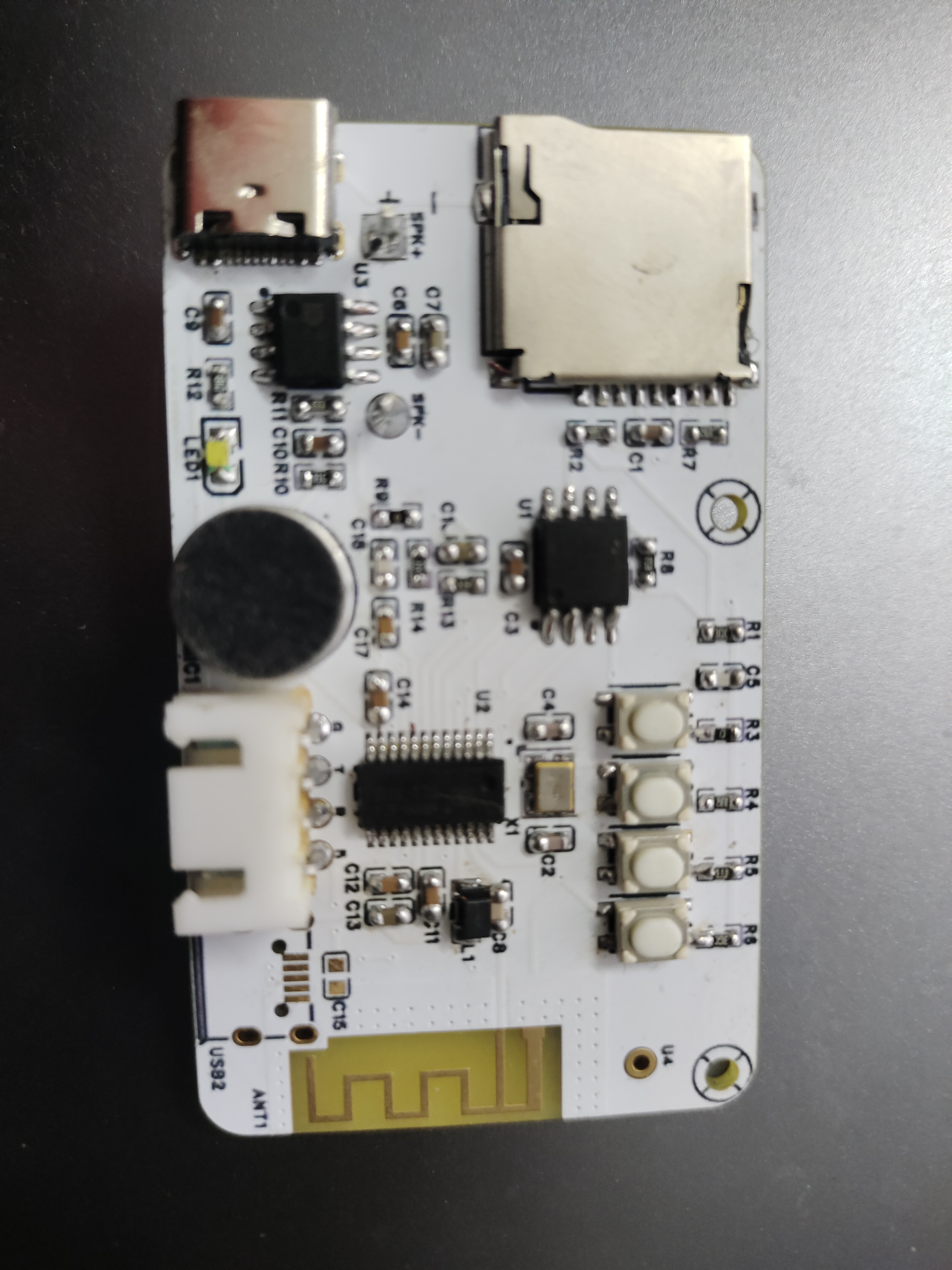

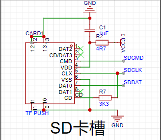

This is the SD card

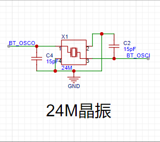

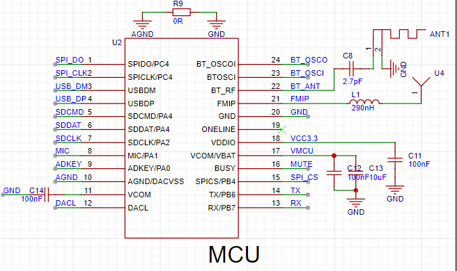

circuit. I used a 24MHz crystal oscillator and a 4-pin
N8900 main control circuit. I designed a Bluetooth onboard antenna and an FM port.

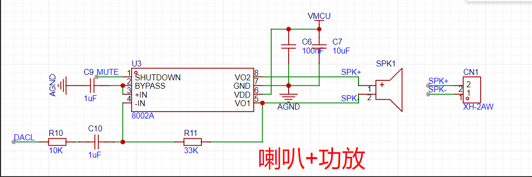

I used an 8002A power amplifier chip to amplify the signal.

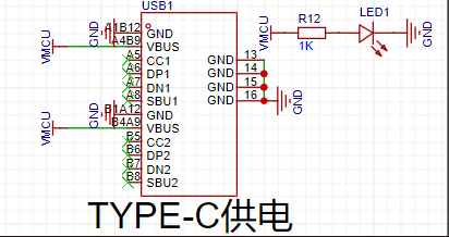

I used Type-C for power supply, mainly because this type of charger is becoming increasingly common, and other types are less suitable. Of course, I also have a serial port and a USB port, which can also provide power.

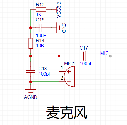

This is the microphone circuit;
I won't go into detail about the others, you can refer to the project files.

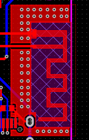

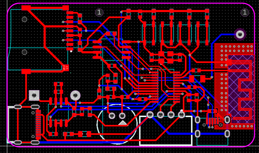

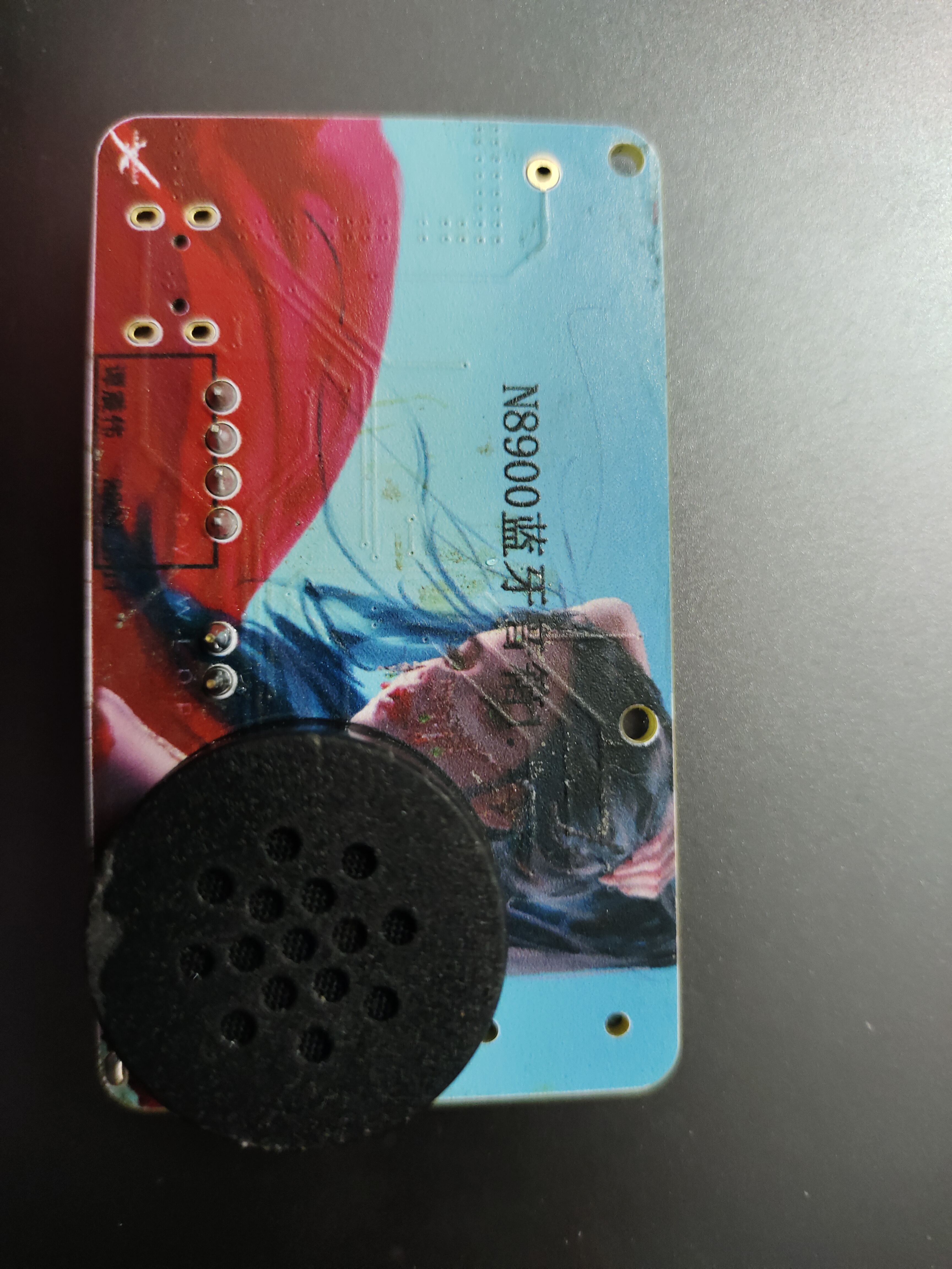

III. PCB Design Description:
This mainly concerns the Bluetooth antenna. I revised it twice, and this is the final version. Fortunately, it works.
I didn't do copper plating on the entire PCB because I tested it once after doing so and found that the sound quality became very poor.

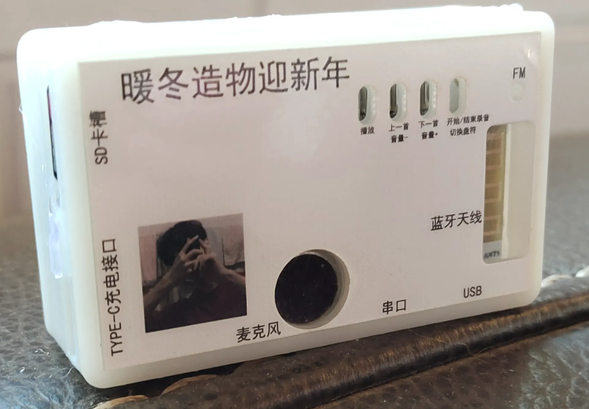

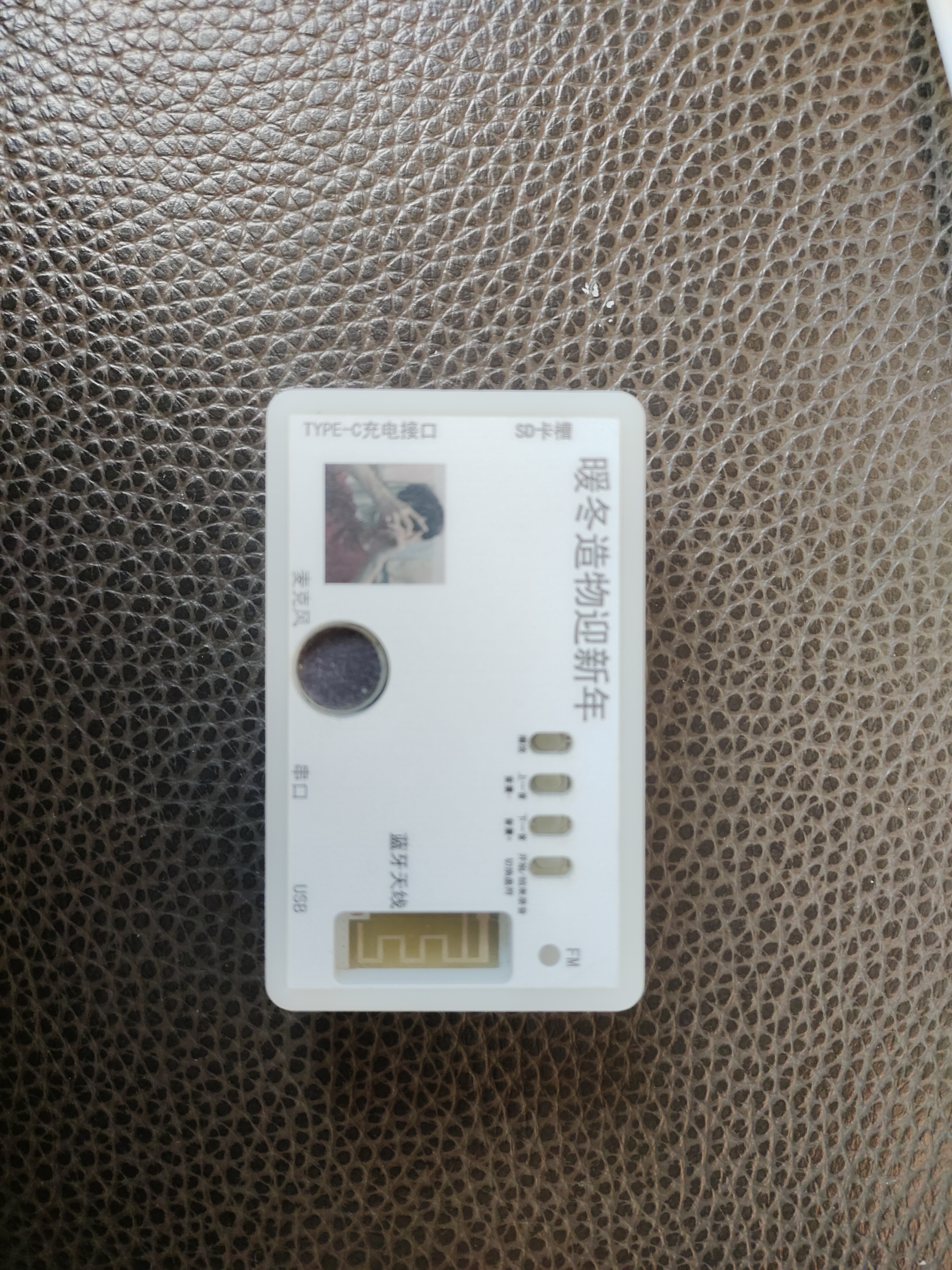

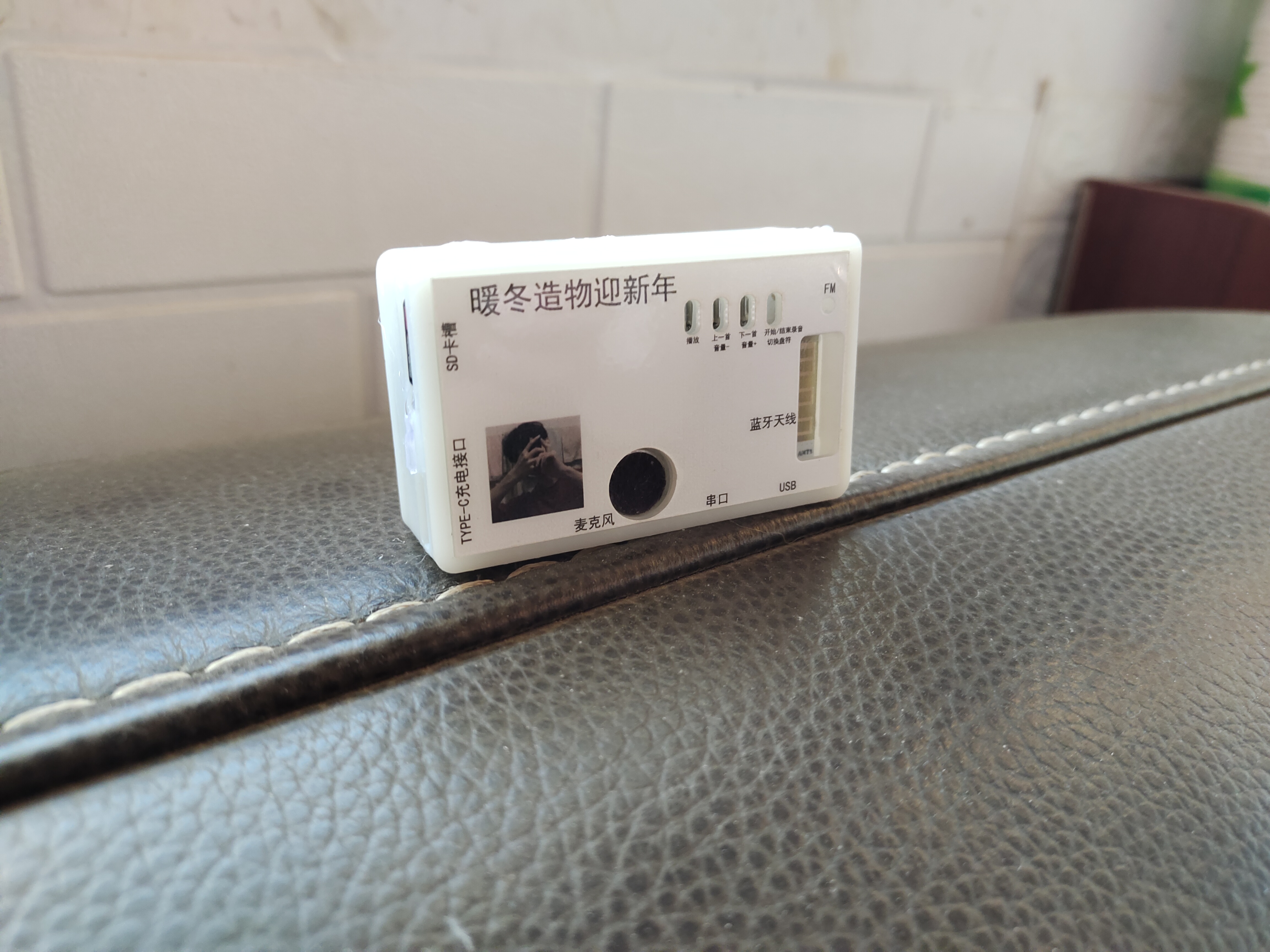

V. Physical Demonstration:

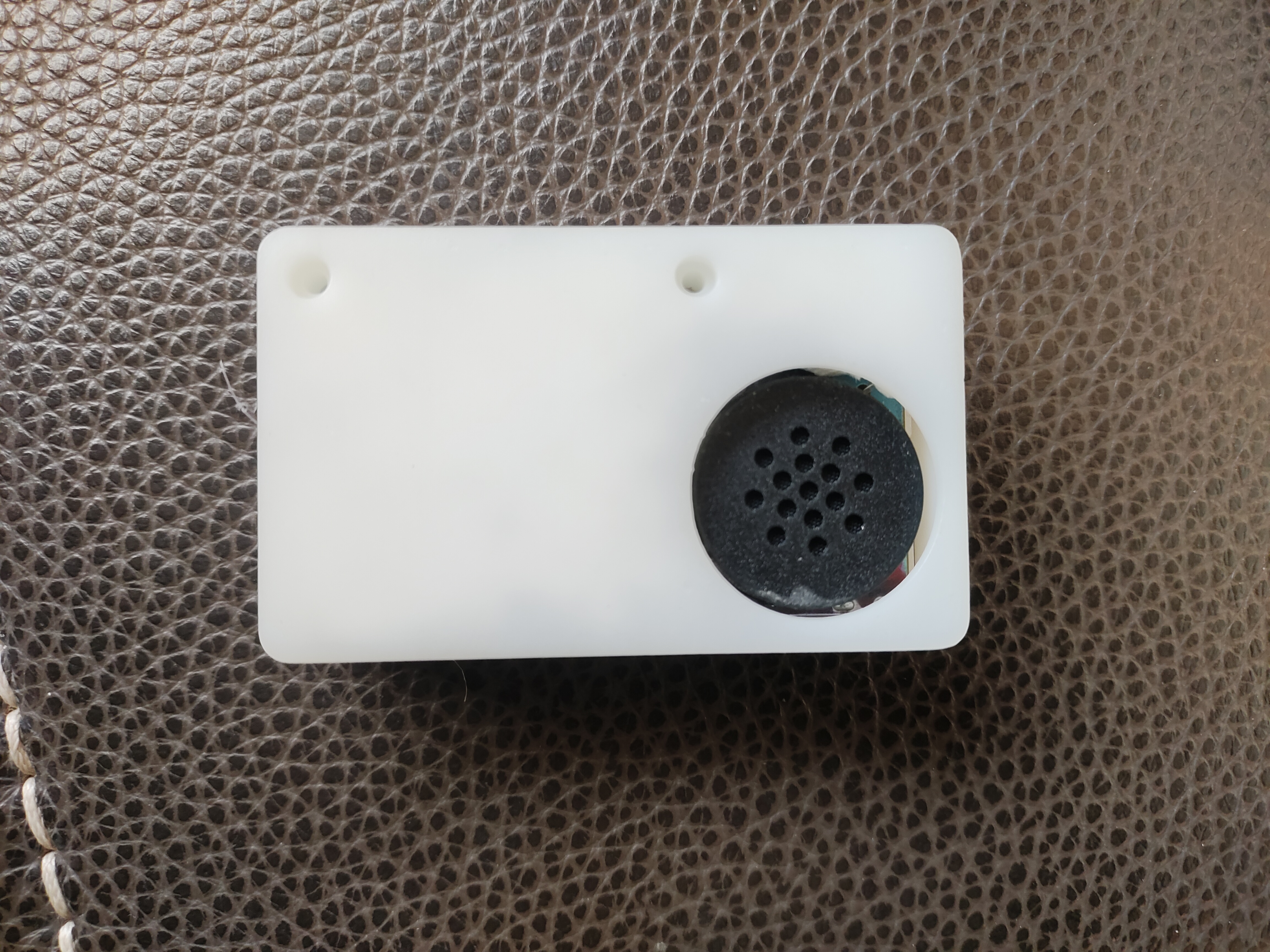

It looks pretty good. The back is nice, and I used a colored finish
. I soldered the microphone on the back. During installation, I found that the outer shell wouldn't install, so I had to use needle-nose pliers to cut off a portion and then apply glue. It's not noticeable unless you look closely. The panel design is also good; it fits perfectly.

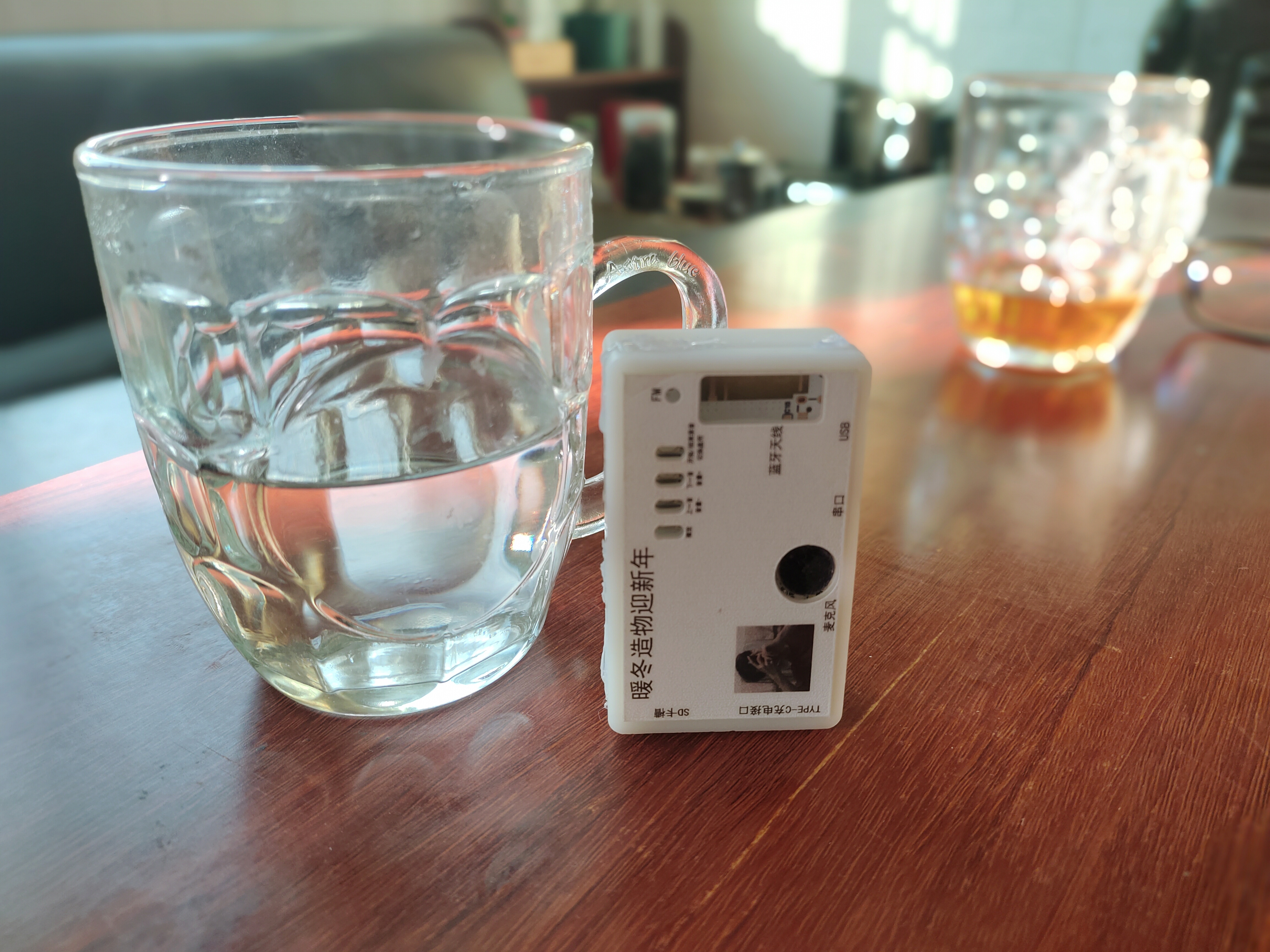

Here is the final product. It looks pretty good; I personally think it's quite beautiful and compact. Note that if you want to use it, it's best to design your own outer shell. Mine is too cheap.
