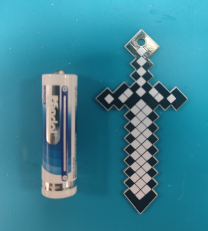

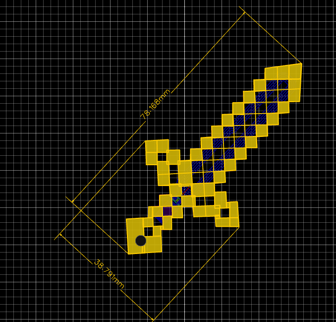

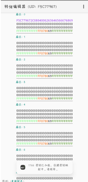

NFC version iron sword
1. Size;
2. Size comparison with AA batteries;
3. Functionality verified successfully.

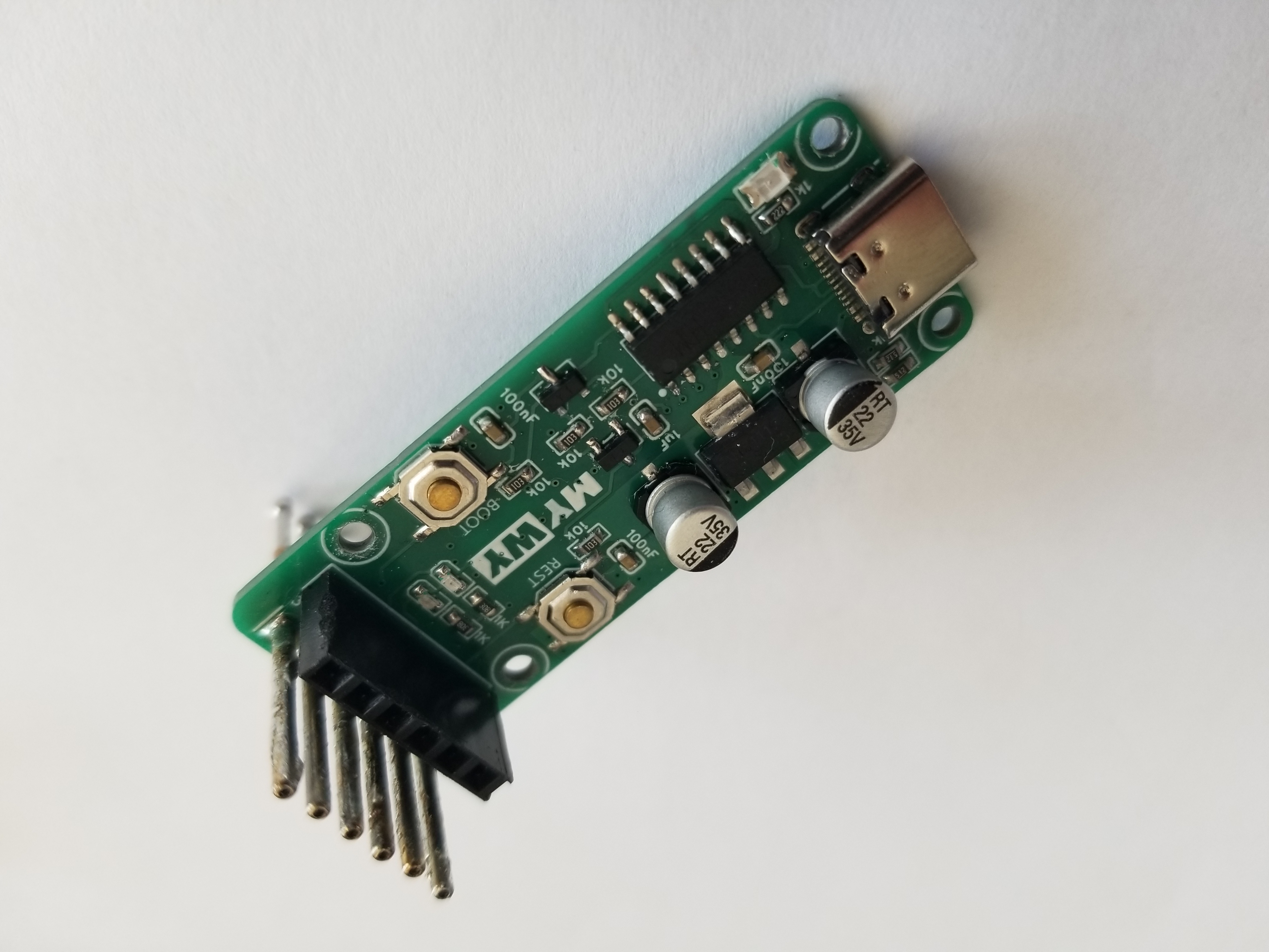

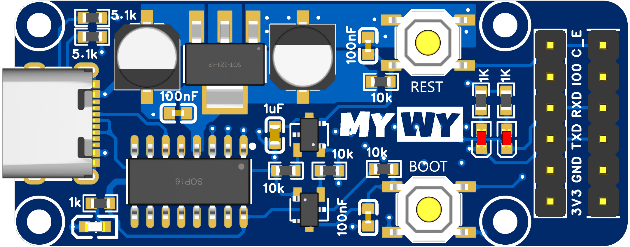

ESP Universal Downloader - Probe (Verified)
The CH340C-based serial port programmer can be used with Espressif ESP series and Holtek AIR series chips for serial port downloading.
This is a serial port programmer based on the CH340C chip, compatible with Espressif ESP and Hexagon AIR series chips.
The circuit design references the ESP Air Burner circuit by Xiaole.Tao on this platform
based on the CH340C, simple peripheral circuitry;
automatic downloading circuitry for easy manual operation;
TX and RX indicator lights for clear download status;
2.54mm header pins for general-purpose use;

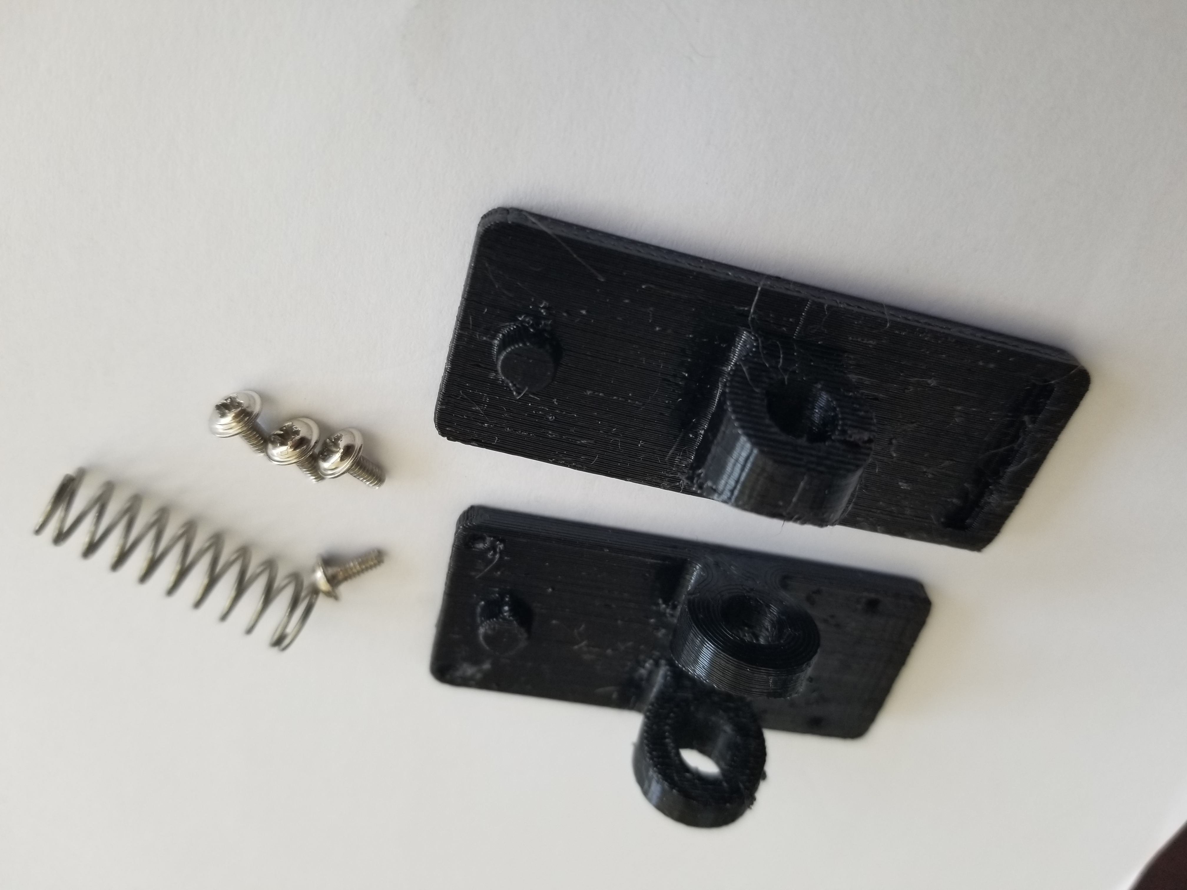

P100-D2 probes; designed with a programming clip for easy onboard programming.
The design has been verified; 3D printing files are attached.

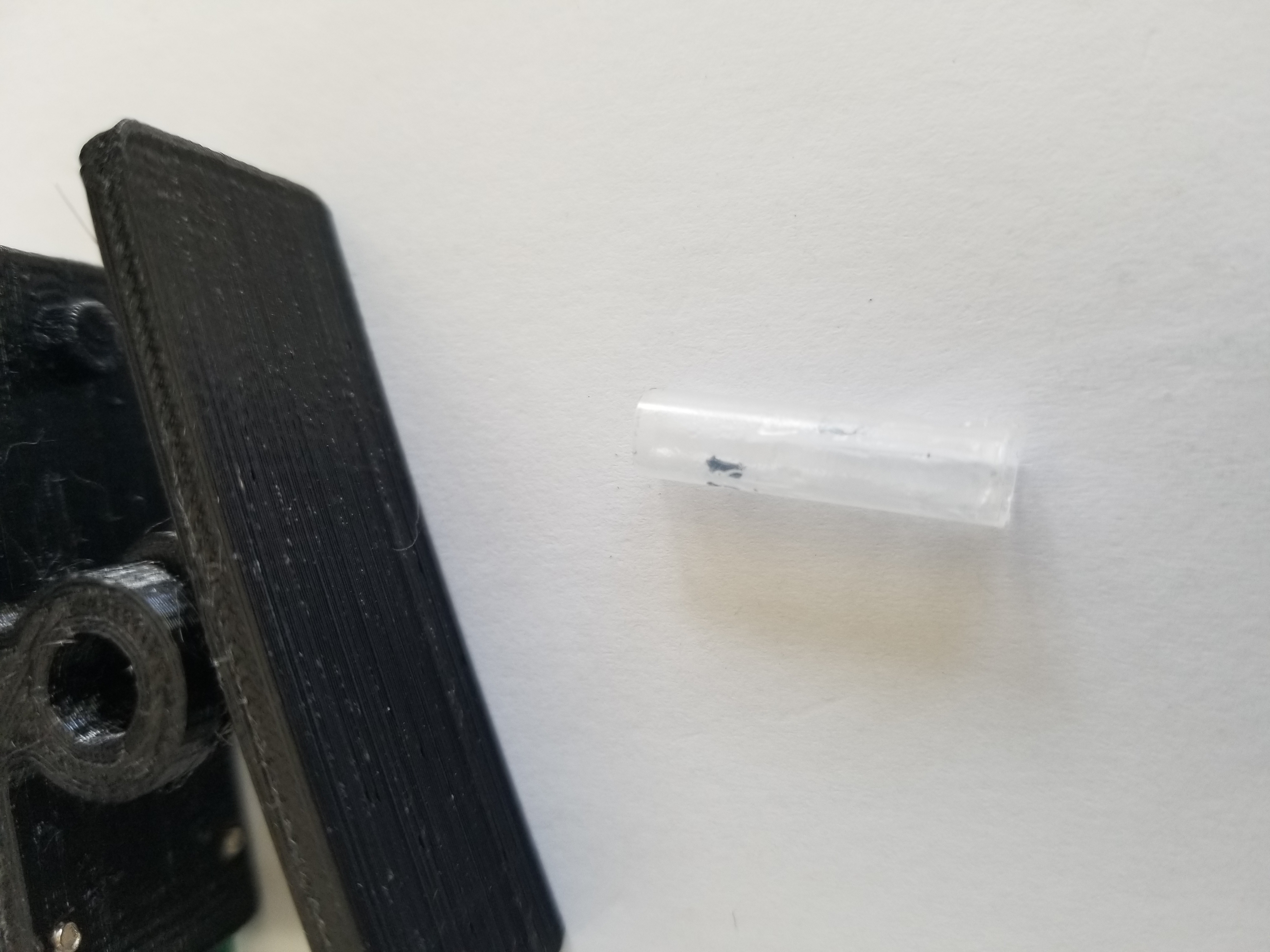

A section of the clip's shaft was simply cut from a water-based pen refill.

PDF_ESP Universal Downloader_Probe (Verified).zip
Altium_ESP Universal Downloader_Probe (Verified).zip
PADS_ESP Universal Downloader_Probe (Verified).zip
BOM_ESP Universal Downloader_Probe (Verified).xlsx

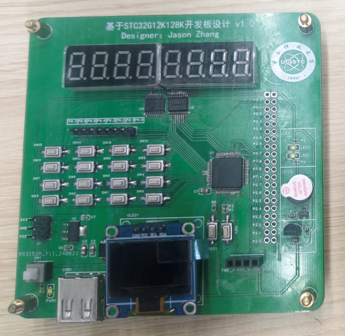

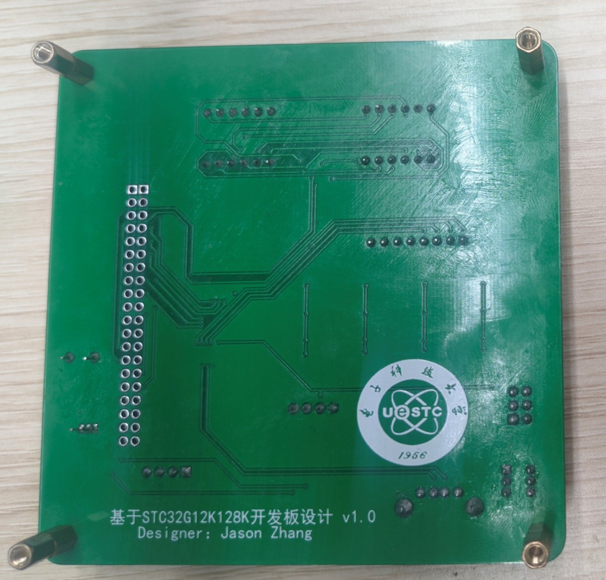

Design based on STC32G12K128K development board
This development board design is based on the STC32G12K128K microcontroller and integrates a digital tube, matrix keyboard, OLED, buzzer, and DS18B20 temperature sensor.
This development board design, based on the STC32G12K128K microcontroller, integrates a digital tube display, a matrix keyboard, an OLED screen, a buzzer, and a DS18B20 temperature sensor.
The 8-digit common-cathode digital tube is driven by two 74HC573 chips.
The matrix keyboard has 16 keys and is driven by 7 I/O pins.
The 0.96-inch OLED uses the II2C protocol , and
the DS18B20 uses a single-bus protocol
. The buzzer is an active buzzer driven by an SS8850 transistor
. Power is supplied via a USB direct connection and includes a self-locking switch for easy switching.
An AMS1117 step-down chip is added to convert +5V to 3V3V for future power supply of other devices.
A Bluetooth module interface is also provided for future wireless data transmission.

PDF_Design Based on STC32G12K128K Development Board.zip
Altium_Design based on STC32G12K128K development board.zip
PADS_Design Based on STC32G12K128K Development Board.zip
BOM_Design Based on STC32G12K128K Development Board.xlsx
