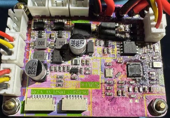

Photo of the PCBA.

A 24V power input is used, controlled by a P-MOS transistor. When the ON/OFF button is pressed, PVCC+ conducts, powering the chip and turning on the MCU's P_ON for continuous power-on. Power-off is achieved by pressing and holding the ON/OFF button for 3 seconds. The MCU determines the P_SW press duration and turns off the MCU's P_ON.
Additionally, in the power-on state, a light touch of the button controls the WS2812's LED effects, switching between different LED strip effects.
