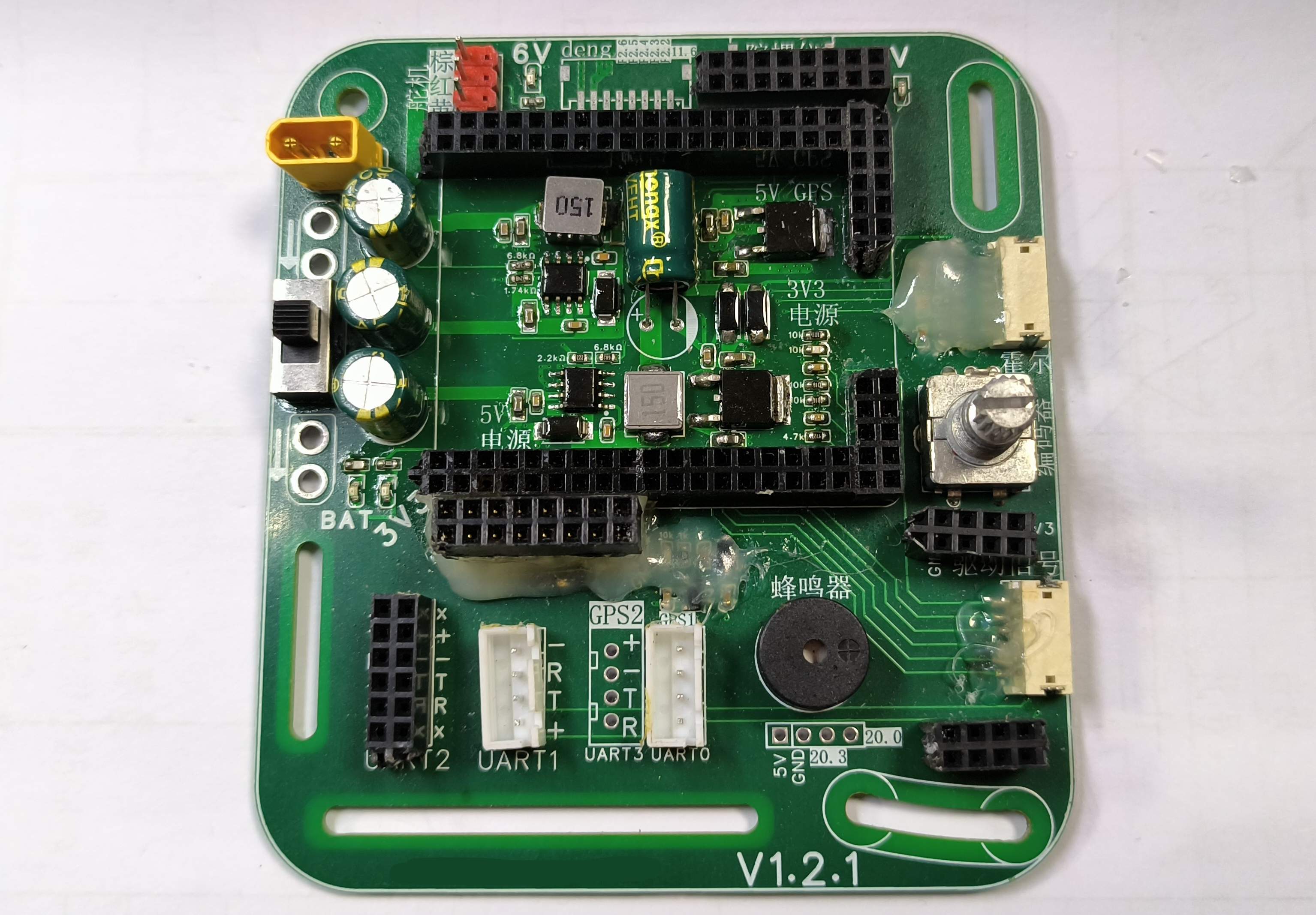

The PCB design of the Infineon motherboard for the 18th National Undergraduate Intelligent Vehicle - Extreme Off-Road Group
has a rather bulky appearance due to the mounting holes.
The schematic diagram
, power supply circuit, and interface section can be used as a simple reference, intended to spark further discussion.

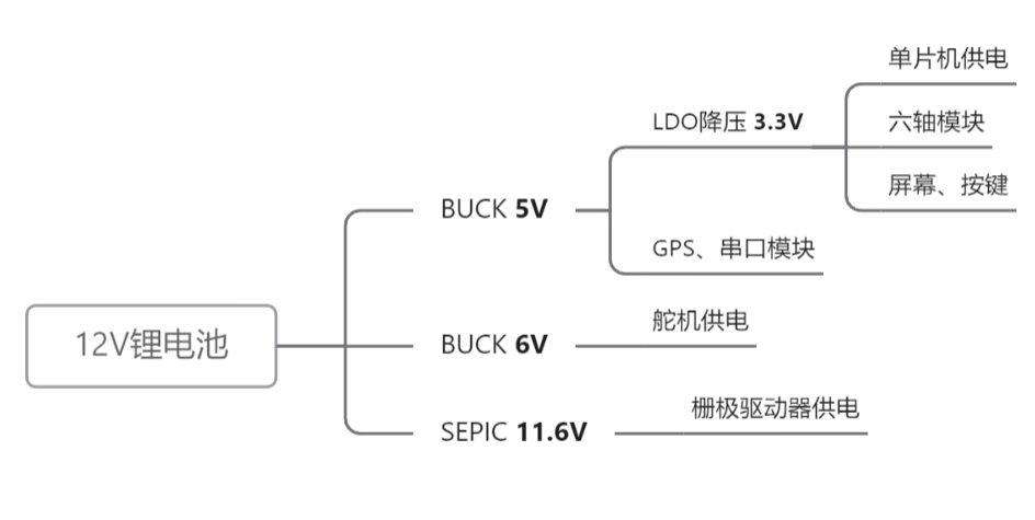

A power supply voltage
of 12V-16V is recommended; theoretically, higher voltages are possible, but please test according to the voltage tolerance of your components.
The power supply voltage diagram is shown below.
The interface
section includes redundant designs to accommodate modules with different interfaces.
Please insert the Taobao-Zhufei Technology-Infineon TC series core board.
Please insert the Zhufei Technology-Gyroscope sensor.
The button board project (5 button modules) is attached; please open it with JLCEDA Professional.
