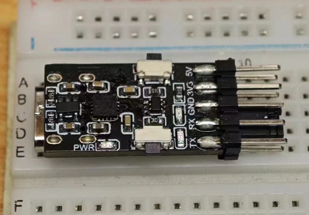

ESP32 CH343P programmer
Main reference: [Verified] The ESP32 CH343P small-size programmer
brings out the VIO pin of the CH343P, allowing users to select between 3V3 and 5V TTL levels for serial communication.
Using a jumper cap, shorting the VIO pin and 3V3 outputs a 3V3 TTL level. Leaving the 5V pin connected or shorting it outputs a 5V TTL level.
Verified to successfully program the Heze ESP32-C3.
A BOM and link are attached.
Connection for programming the Heze ESP32-C3:
Programmer
Heze ESP32-C3
3.3V
3.3V
GND
GND
RX
TX
TX
RX
IO0
IO09
EN
EN
