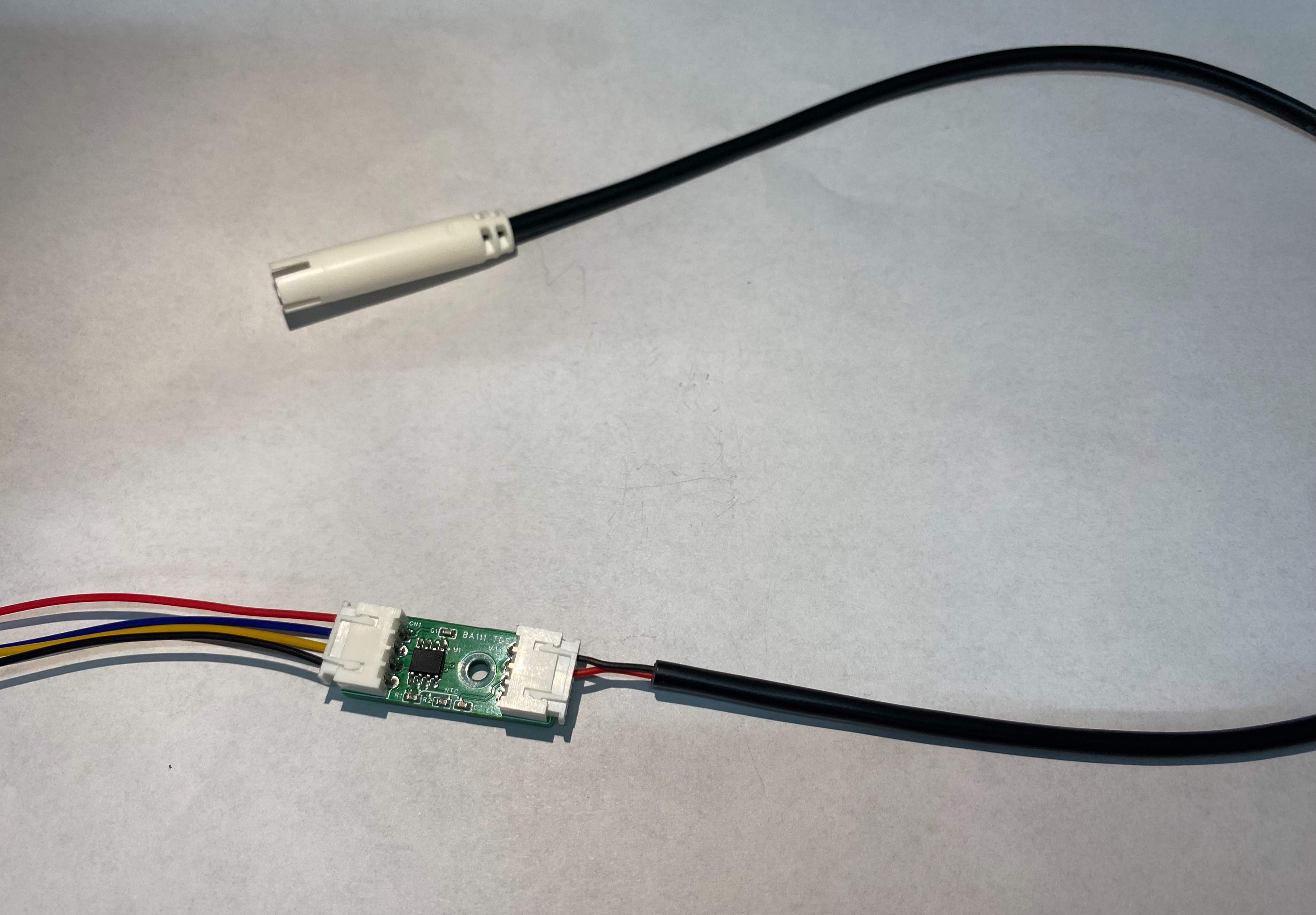

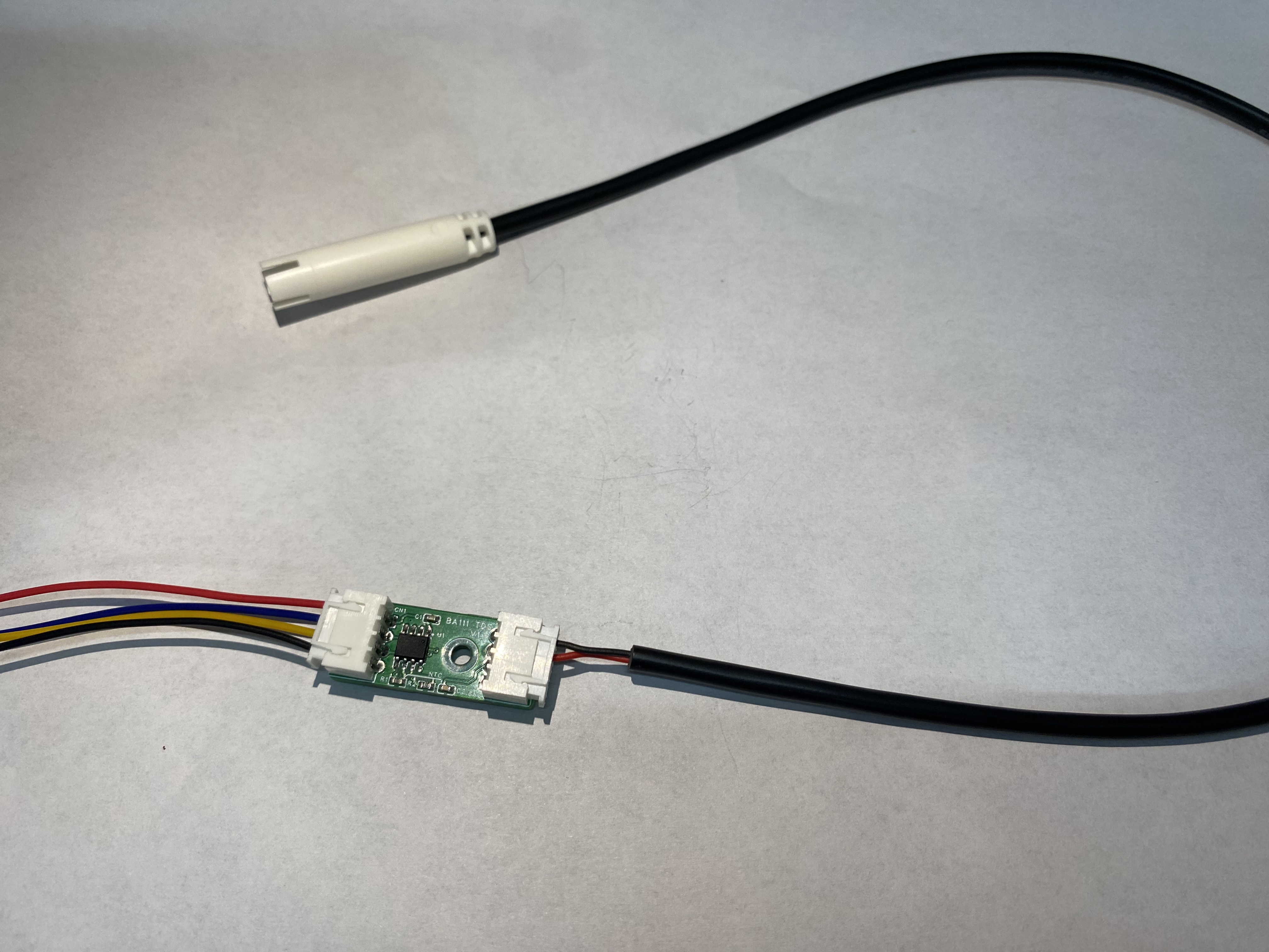

Based on BitAtom's BA111 TDS water quality sensor module.
A dedicated chip suitable for total dissolved solids (TDS) and water temperature detection, integrating a high-precision oscillation circuit, analog-to-digital conversion circuit, and floating-point arithmetic unit. Employing a patented conductivity-TDS conversion algorithm and temperature correction algorithm, it quickly detects water TDS and achieves automatic temperature correction over a wide temperature range, reducing measurement errors caused by TDS value changes with temperature. Suitable for domestic water quality detection.
Project Functions:

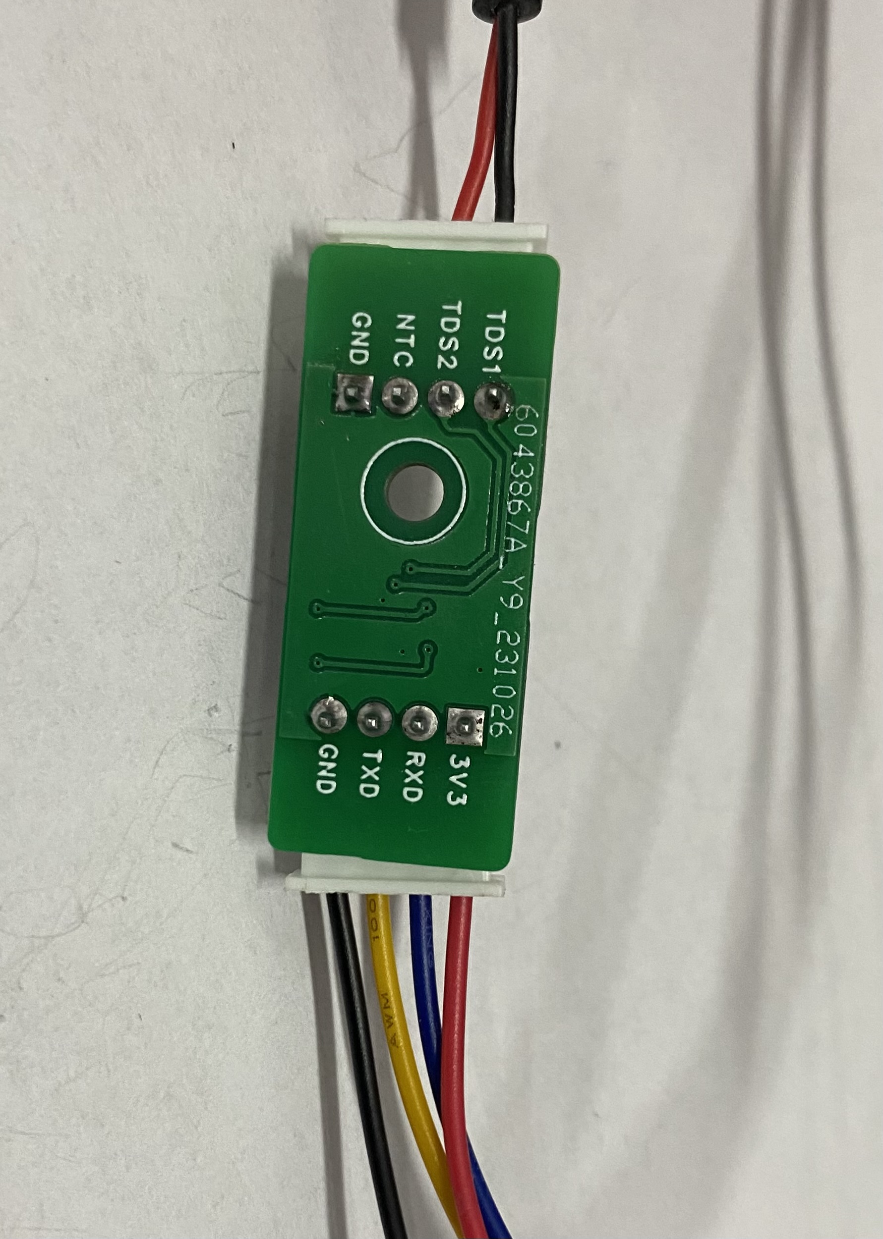

BA111 single-channel TDS water quality sensor.
The sensor uses BitAtom's BA01 NTC-free temperature sensor.
Power supply uses DC 3.3V input.
XH 2.54-inch interface, with the interface silkscreened on the bottom.
M3 mounting holes are provided for easy installation.

1. When soldering, please pay attention to the soldering sequence to ensure the power supply is correct and to avoid burning out subsequent circuits! The soldering sequence should follow the principle of from shortest to smallest, and from inside to outside.
2. Data calibration: Follow the steps in the official manual and select the appropriate NTC resistor according to your needs.
