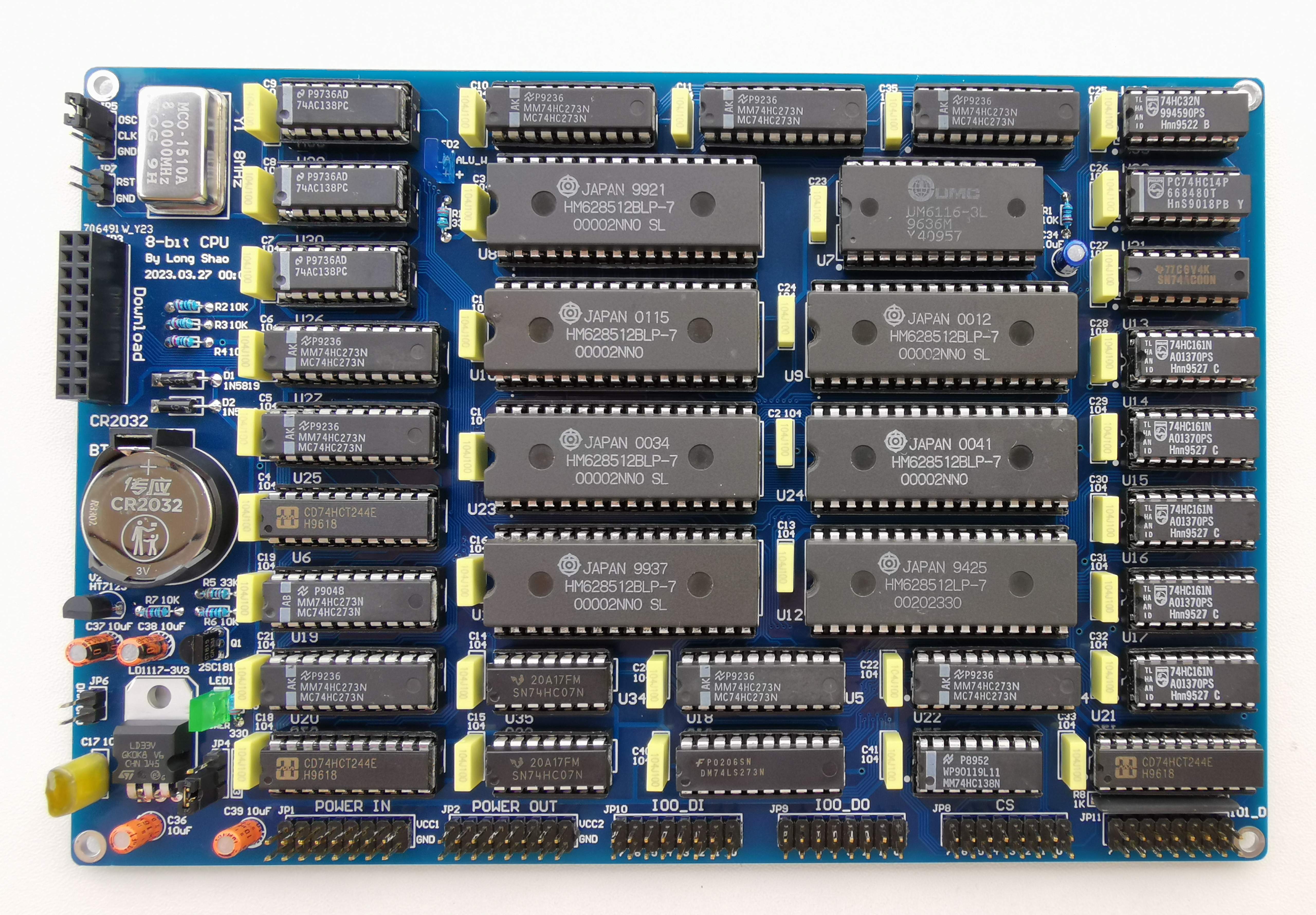

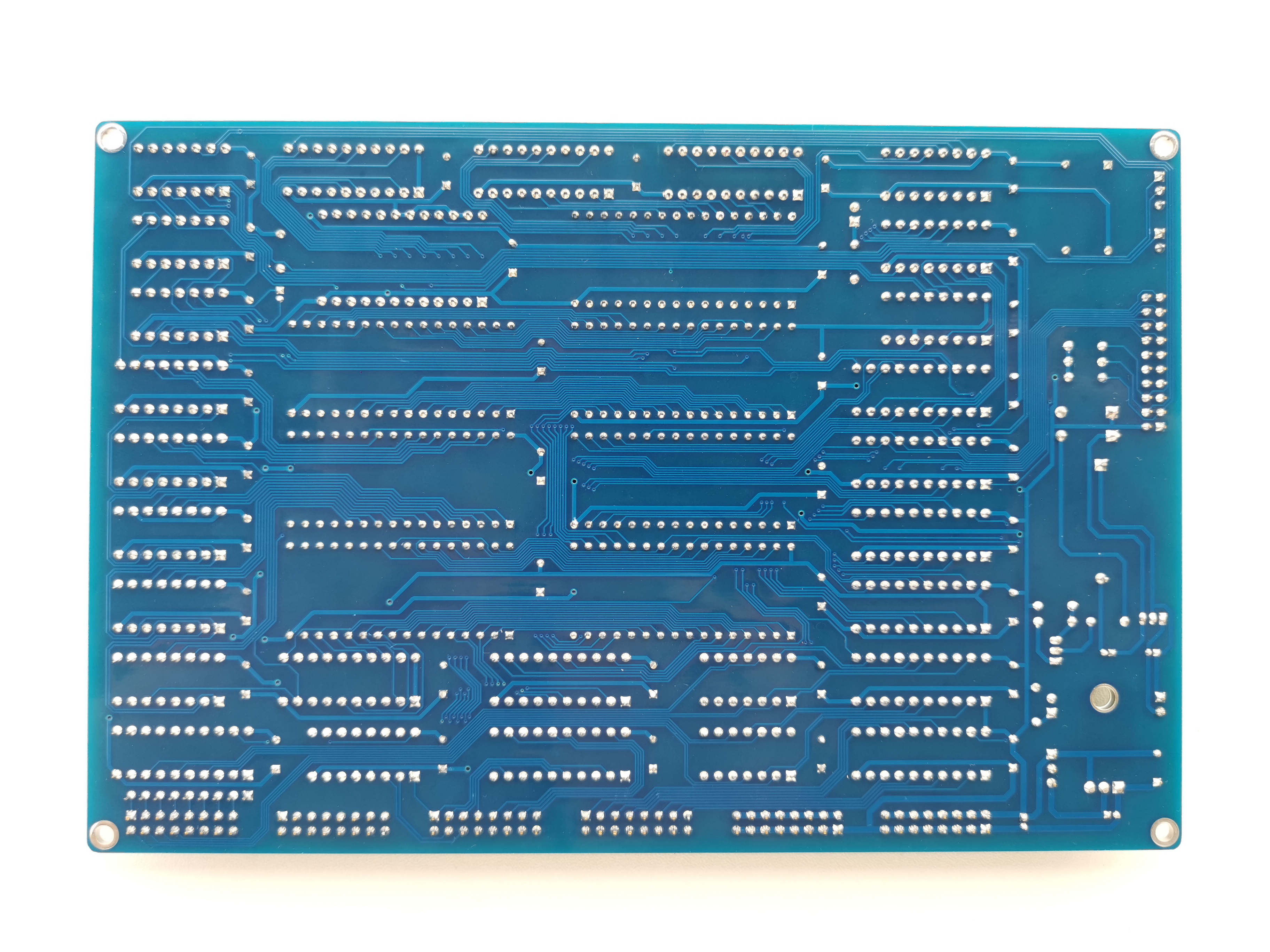

Longshao CPU - 10th Anniversary Collector's Edition - LCEDA Professional Edition
This is a Longshao CPU-74HC logic gate direct plug-in version - LCEDA version, convenient for those without AD to view and replicate. Video: https://www.bilibili.com/video/BV1Pp4y1F7ix
Data: Link: https://pan.baidu.com/s/1n2U553-tAYNSQ06JEb88gA Extraction code: 7777
Clock speed: 8MHz
ROM: 1MB
RAM: 1MB
The main component models and quantities required are as follows:
74AC00
74HC00
74HC07
74HC08
74HC14
74HC32
74HC74
74AC138
74HC138
74HC595
74HC161
74HC273
74LS273
74HCT244

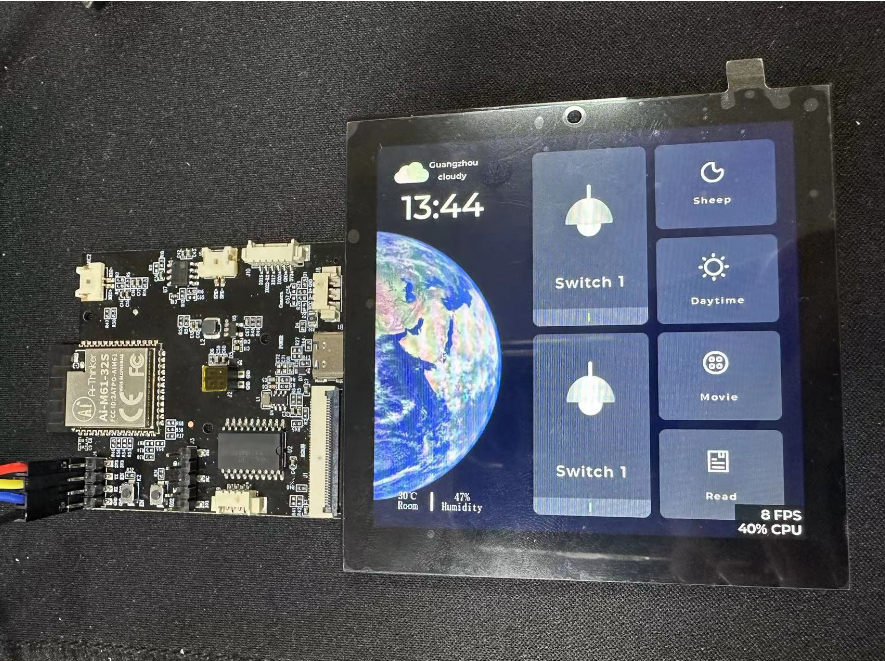

AiPi-Eyes-R2_V1.0
Anxinco Technology 4-inch RGB Interface Display Driver Board
I. Introduction
The R1 isn't the only board capable of directly driving a 4-inch RGB interface display; there's also its smaller version: AiPi-Eyes-R2.
This board has several improvements over the S2:
the DVP camera interface has been removed;
it uses a 4-inch RGB interface display (capacitive touch), with a higher frame rate (maximum 50fps, stable 30fps); and
it's smaller and more refined.
The biggest change is the use of a 4-inch RGB interface display with a resolution of 480*480, and it's smaller than the R1.
II. Interface Description and System Block Diagram
The R2 is smaller than the R1, but it can also drive a 4-inch RGB interface screen. The difference isn't just in size, but also in the audio chip. The R2 uses the BL618 built-in voice chip for unidirectional audio input and output.
III. RGB Interface Screen Circuit
RGB screens require a significant number of I/O ports; the GPIO of the M61 module alone is far from sufficient. Therefore, latches are needed for GPIO multiplexing.
Thus, the R2 still cannot fully utilize the refresh performance of the RGB screen.
IV. Wiring and Programming:
Compared to the AiPi-Eyes-R1, the R2 features a download header, allowing for programming via TTL connection.
The AiPI-Eyes-R2 is factory encrypted, so a specific boot2 and verification firmware must be specified during operation.
